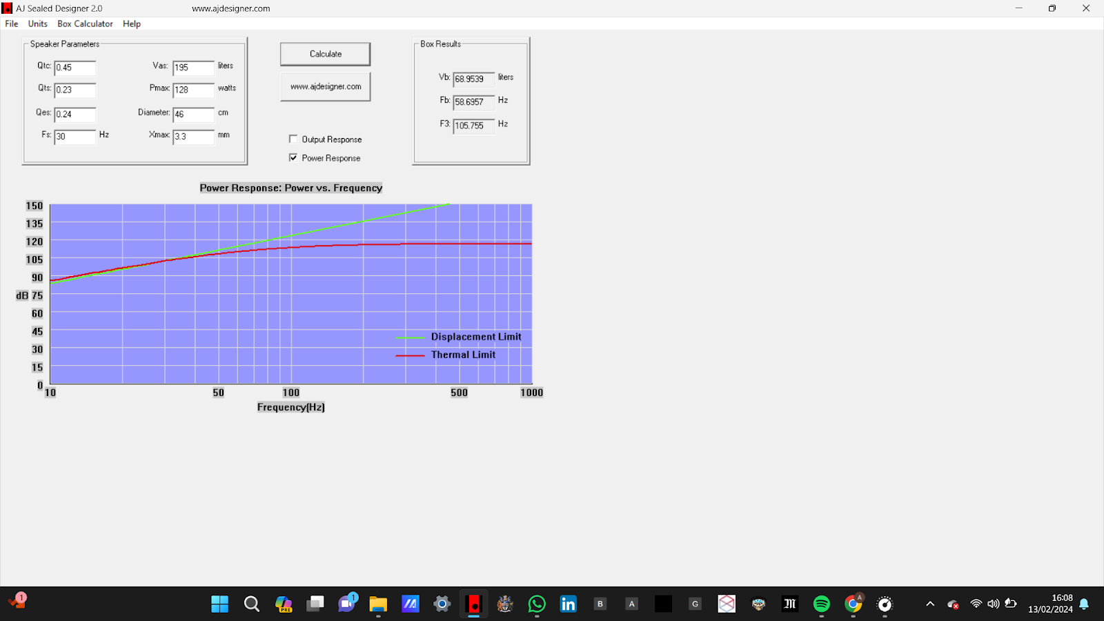

I have just ordered a pair Beyma 18 QLEX 1600 Fe...
With 128 watts = 103dB SPL @ 30Hz. Pair = 106dB plus 3dB room gain = 109dB with +/- 3.3mm cone travel (26% of 13mm Xmax). Vb = 69 liters + 8 liters driver = 77 liters.
PS I needed to keep the cabinet volume small as possible so am happy to trade sensitivity for happy wife!
If I want to increase SPL I can just feed in more power and accept a bit more cone travel, but to be honest for family room music and movies this is plenty loud!

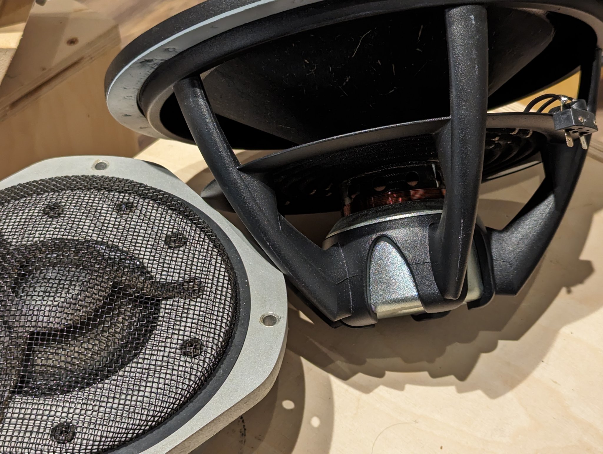

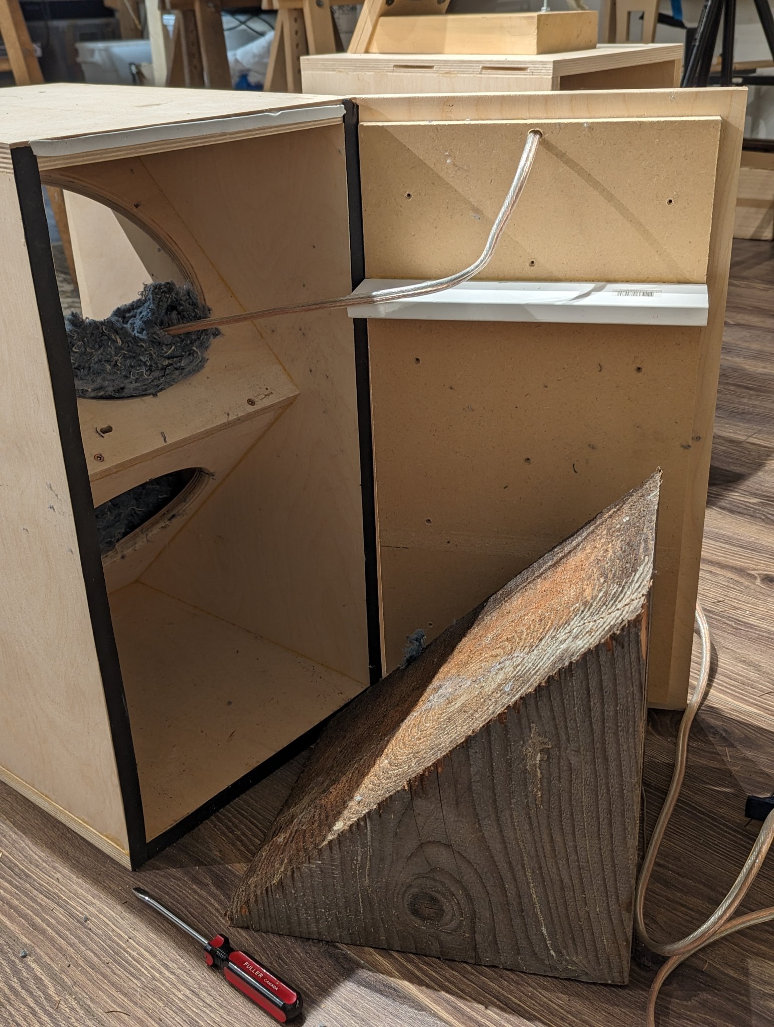

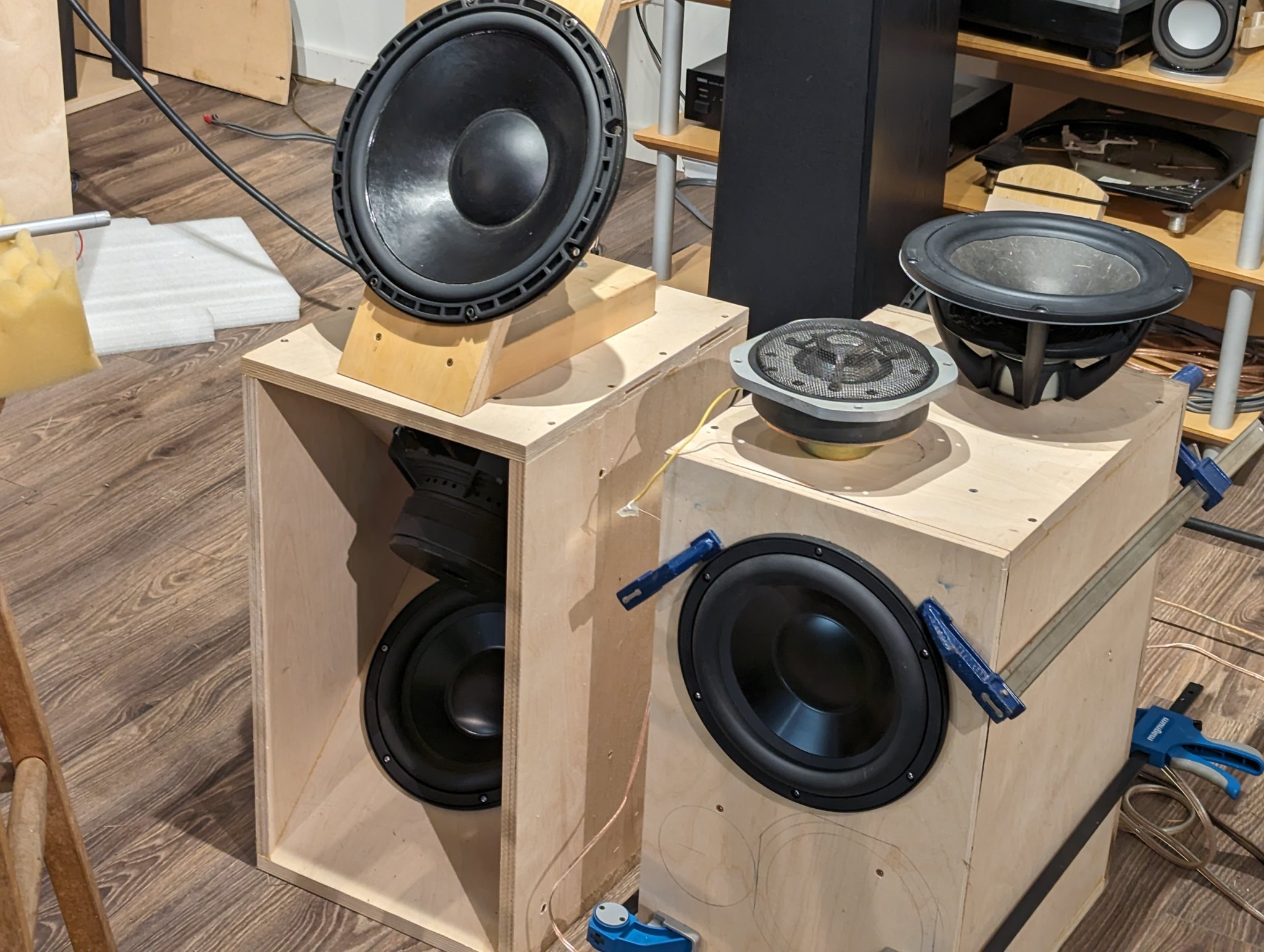

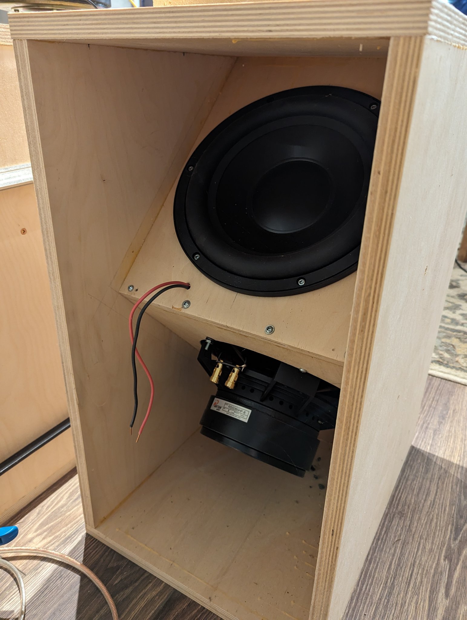

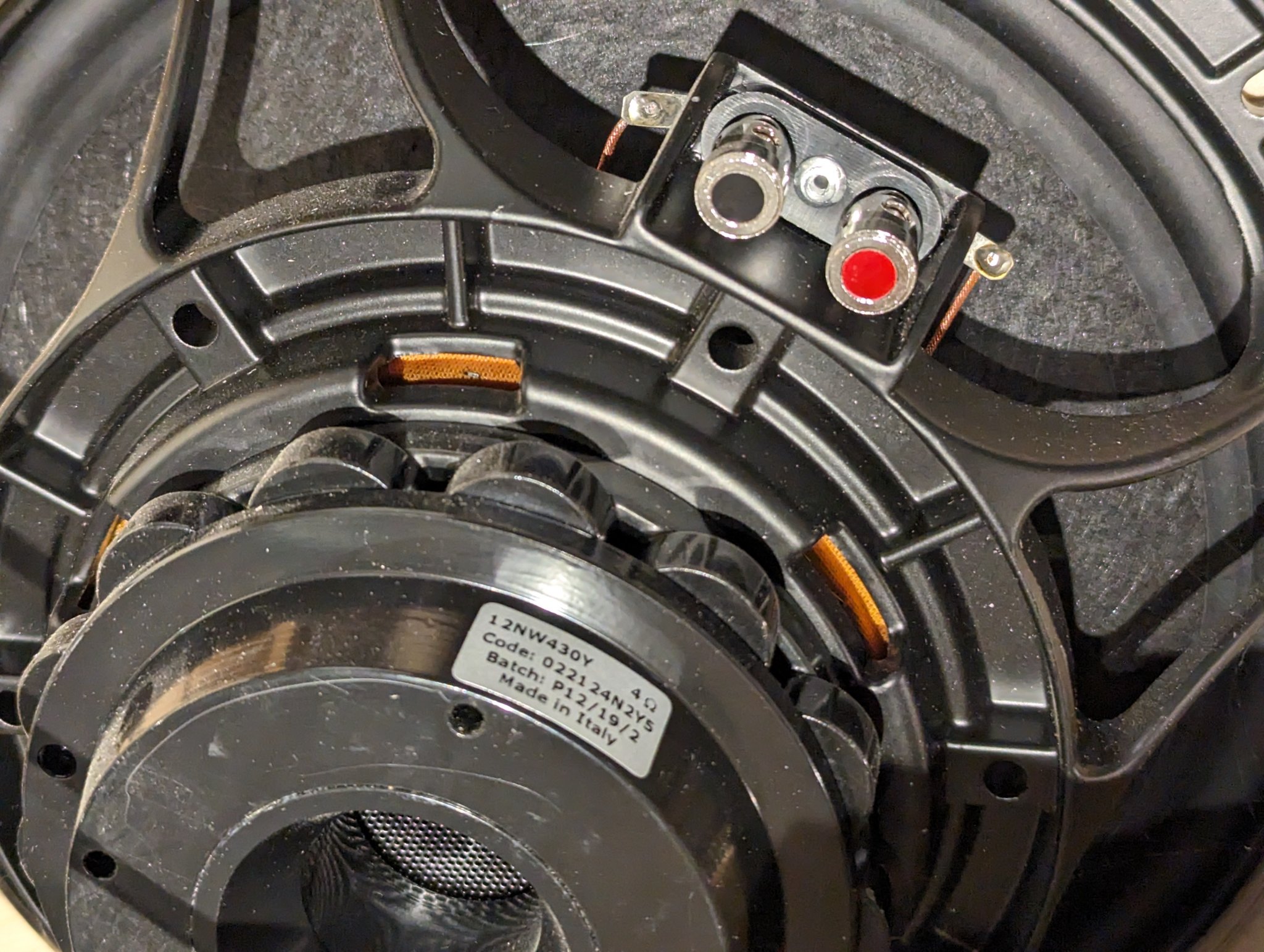

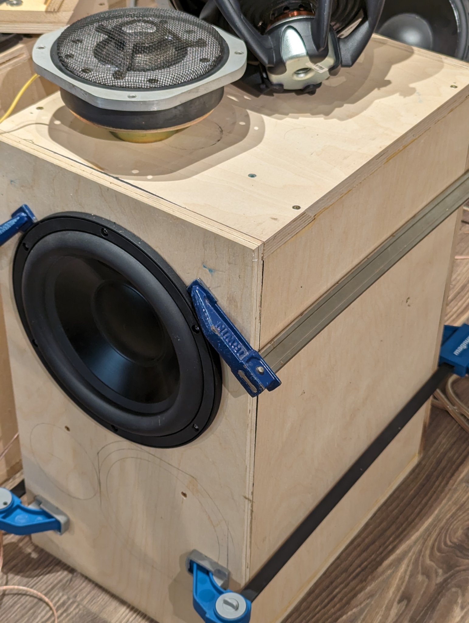

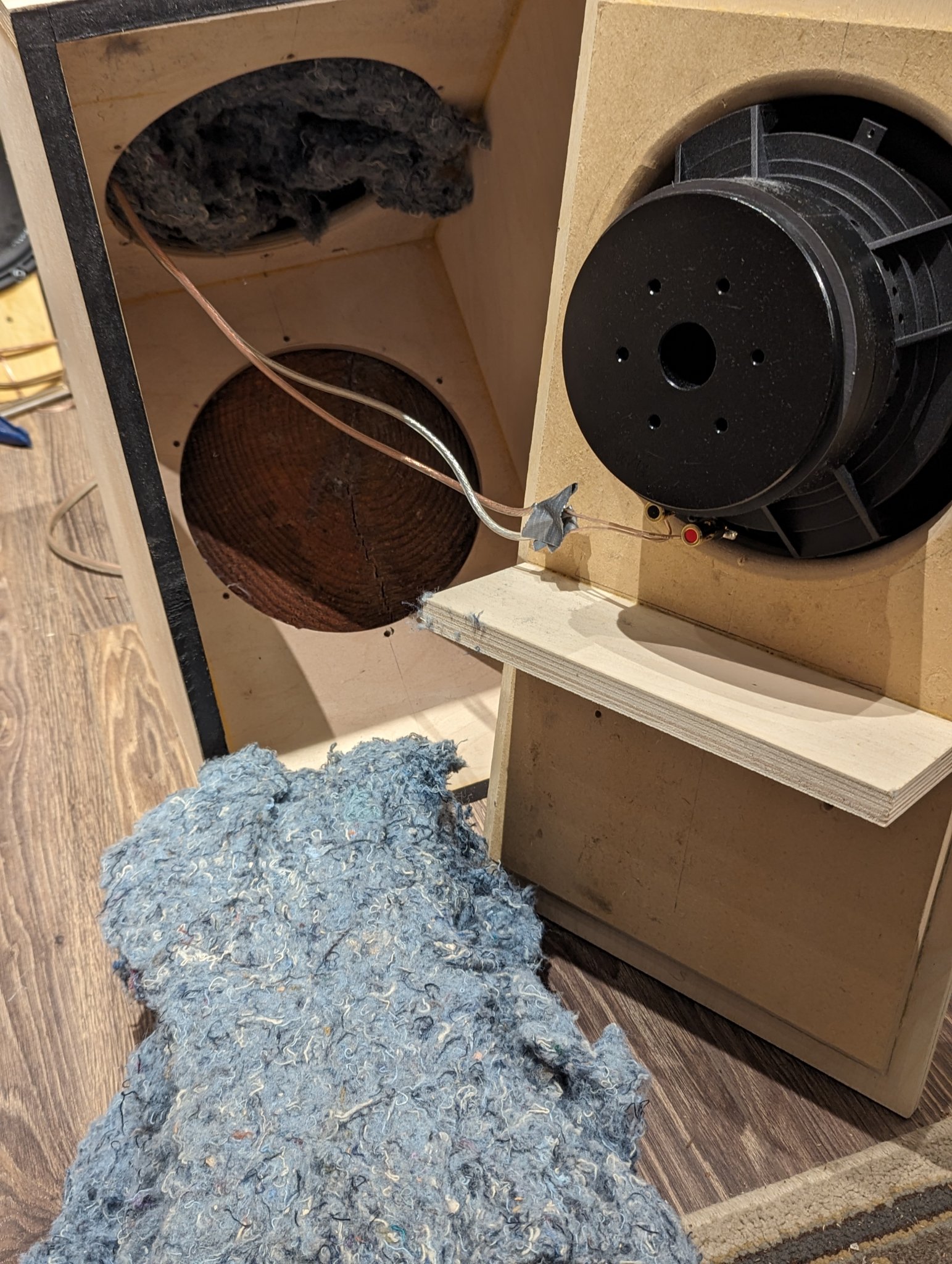

Here are some pics of the test enclosures and various drivers being considered.
Clockwise, from bottom left:
1. 90 degree opposed OB bass enclosure for LX521 inspired build. It was abandoned after I discovered how much the cabinets vibrate with bass energy. 180 degree vibration cancellation "W" OB bass is far better in this regard. Two Dayton RSS265HF-8 are still there. They were my original choice for the LX521 clone.
2. 12" Eighteen Sound 12NW430 woofer. Anyone who has seen @Juhazi 's Aino Gradient project will understand the odd way this driver is set up.
3. One of the old Yamaha JA0801 beryllium 68mm mid domes atop the other original enclosure for LX521 bass.
4. Vifa/Tymphany NE265W 10". It's an impressive looking driver.
5. Dayton RSS265HF-8 on test baffle clamped along with back panel, using the original enclosure for LX521 bass. The enclosure is stuffed with at least a pound of poly fibre from a sewing shop (meant for pillows). This test enclosure is easy to set up and take apart; the seal with the clamps and heavy foam weather-stripping along the joins is good enough.
The18S woofer is very well ventilated. Weighs just 9 lbs due to the neodymium magnets.
The internal "V" baffles of the abandoned LX521 bass box were left in place. They brace the sides. Top & bottom panels need better bracing, but I think it's OK for sweeps. For now anyway.

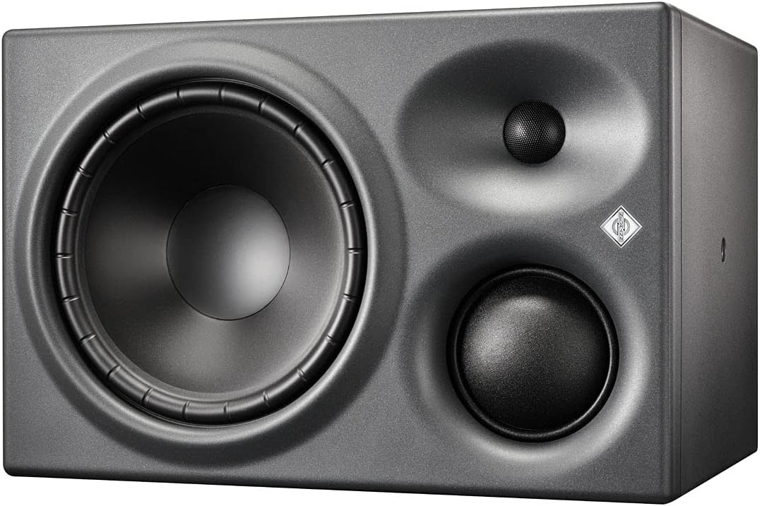

The reference Neumann KH310 has external dimensions of 10" x 15 1/8" x 11 1/2". My text box is way bigger -- 13"W x 23"T x 17". Estimating 3 liters for the driver & internal panels, internal volume is 60 liters -- 50% bigger than the 40 liter target for this build. I will stuff the box with a couple of big blocks of wood or concrete to bring it closer to 40l.
