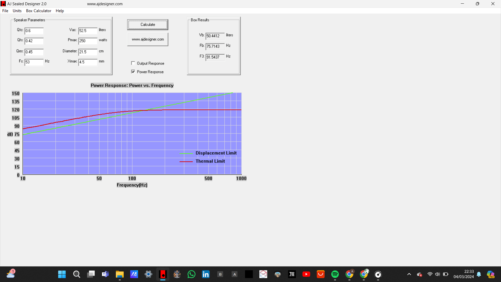

I did find a 10" Eminence that could kind of work. 10.25" diameter! Is it robust enough for such bass EQ boost? https://qcomponents.ca/collections/...2510-8-ohm-10-250w-neodymium-pro-audio-woofer
WinISD tells me in a 34 liter sealed box, Q=0.6, rolloff begins >200Hz, and is -14.5 dB at 40Hz. Rated for 250W, 97 dB/W. Assuming perfect power linearity, 200W could drive it to ~118 dB with 15 dB boost at 40 Hz.
Sounds too good to be true!
Of course, it is: Xmax is just 4.2mm

A pair would hold 103 dB at 4.5mm Xmax at 40 Hz but that is on the limit... I would avoid this if possible.
Yeah, for sure, the 10" Delta Lite is definitely out. 4.5mm Xmax!

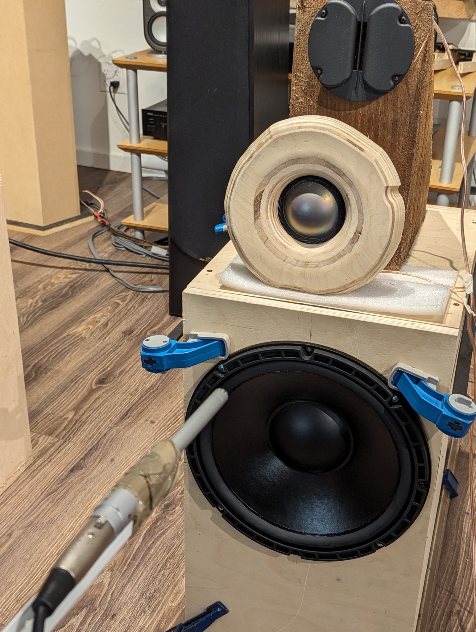

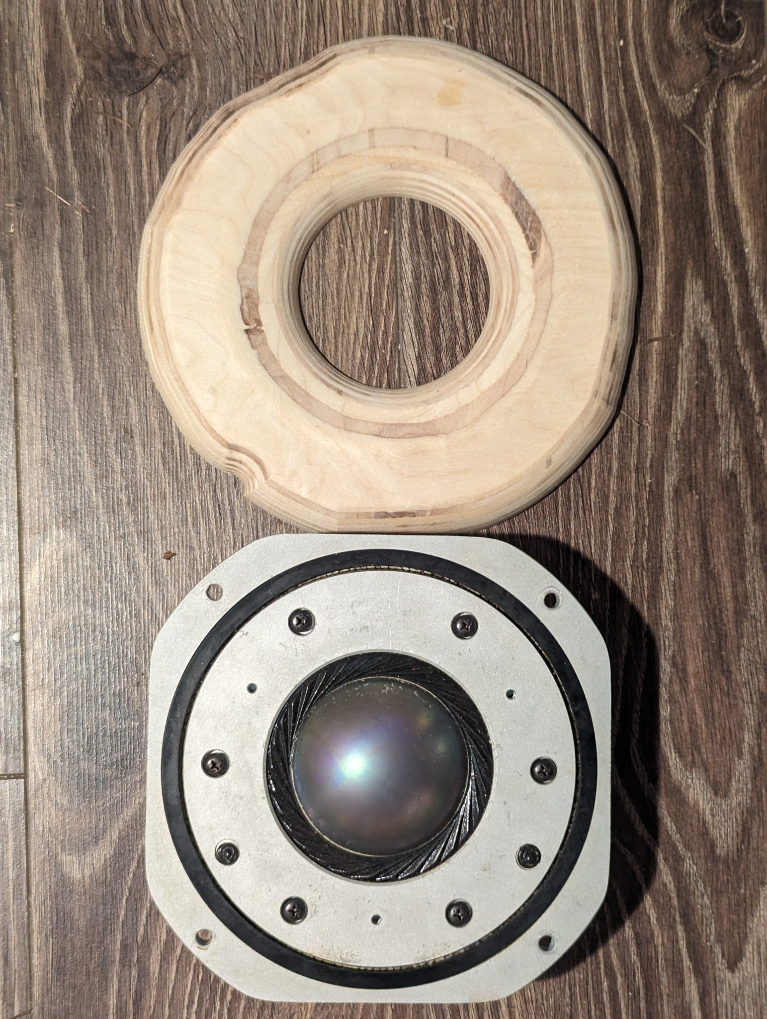

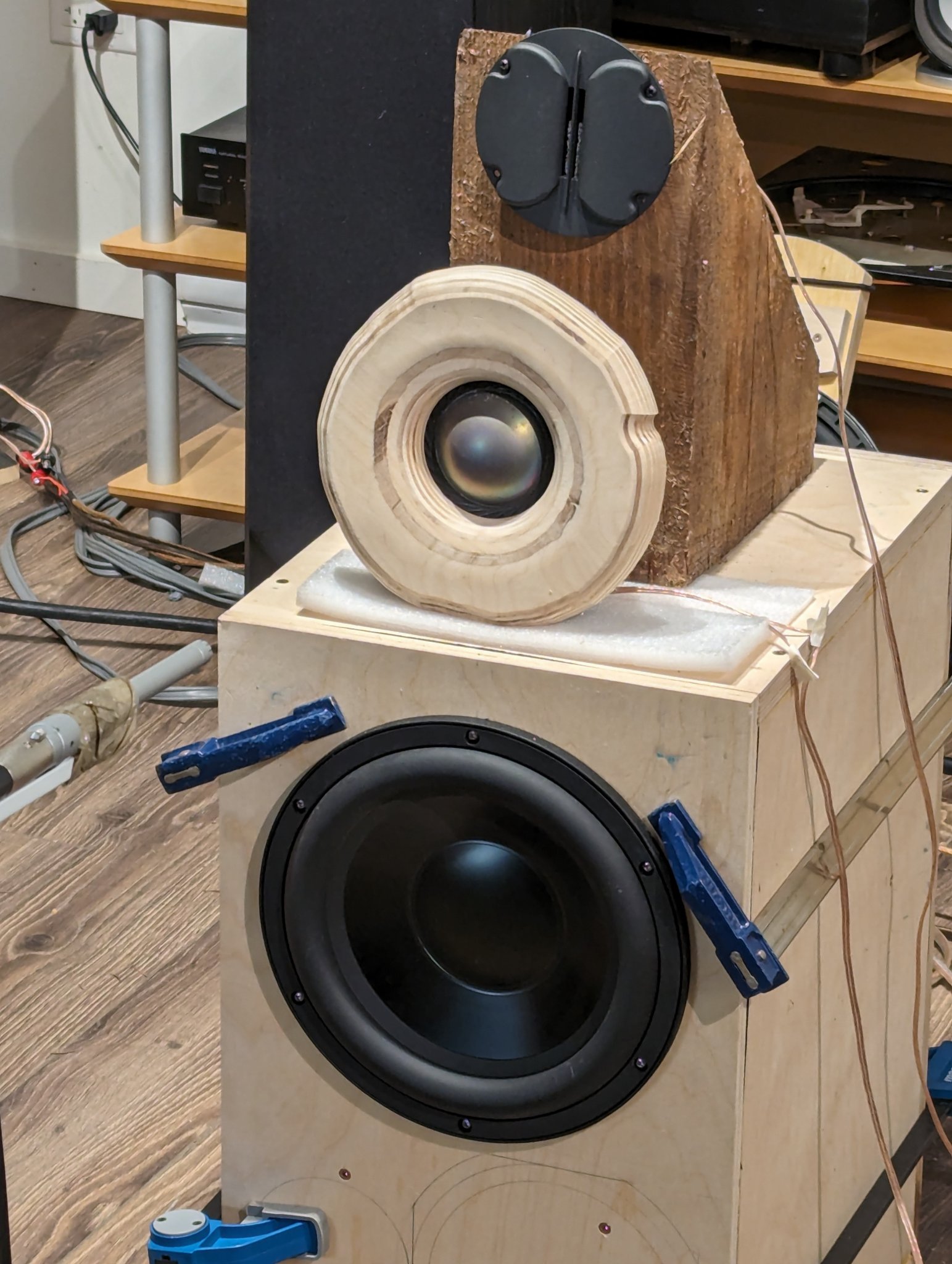

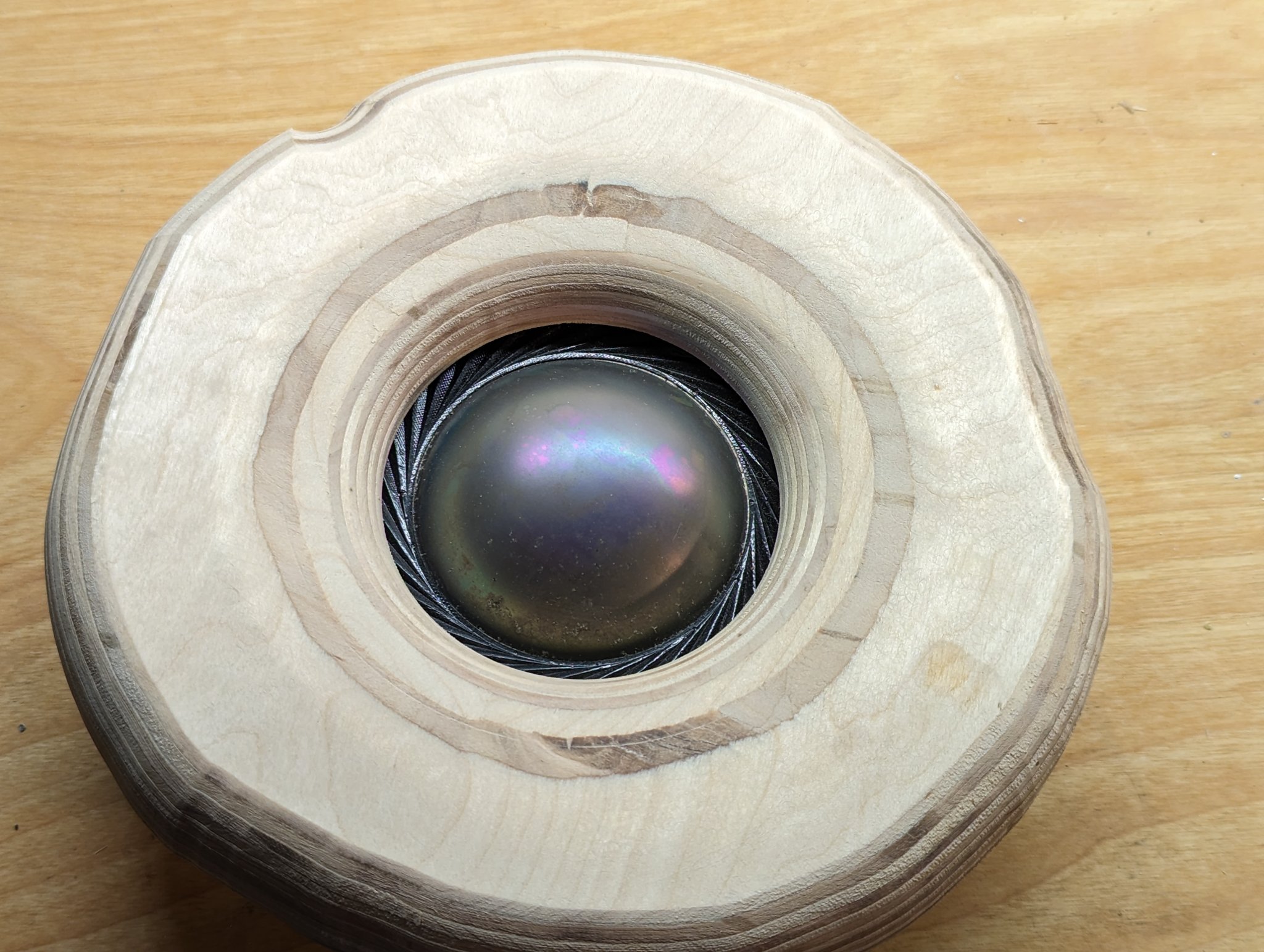

For fun & laughs, here's some of the worst routering I've ever done. Working outside in near freezing temp... Whatever. I mounted the waveguide on a "nuded" JA0801 and tried it out. I can say it immediately sounds smoother than in stock form. The rest is just some really rough manual tuning by ear & REW. It's not bad. Sometimes I just need to remind myself that there's a pot of gold somewhere out there that I'm chasing by listening to something.
Is this just a 10mm radius? These midrange "waveguides" are often pretty simple. Straight 45° or simple radius are sometimes working good up to a few kHz.For fun & laughs, here's some of the worst routering I've ever done.
I would try to start closer to the dome and keep 1-2mm distance to the surround, should be enough.
That's what I did at my last project to reduce the influence of the mid dome to the tweeter. Looks strange but works.
It's a 1" radius quarter-round bit applied at 3/4" height to an 80mm hole I cut in the center.
I forgot that the BB I used is a 18~19mm piece that came from cutting a woofer hole. Tried to round off the outside with the bit at full depth. The BB board was raised up off the working surface with a 1/2" board -- which meant the bearing guide wasn't guiding anything. Hence freehand, more or less.
It has an organic look.
Brandon (@augerpro) suggested to me that the surround is best left clear of the waveguide, which is why I used an 80mm hole. (Besides my next size down is 70mm, which is too close for comfort. Maybe 75mm would work OK.

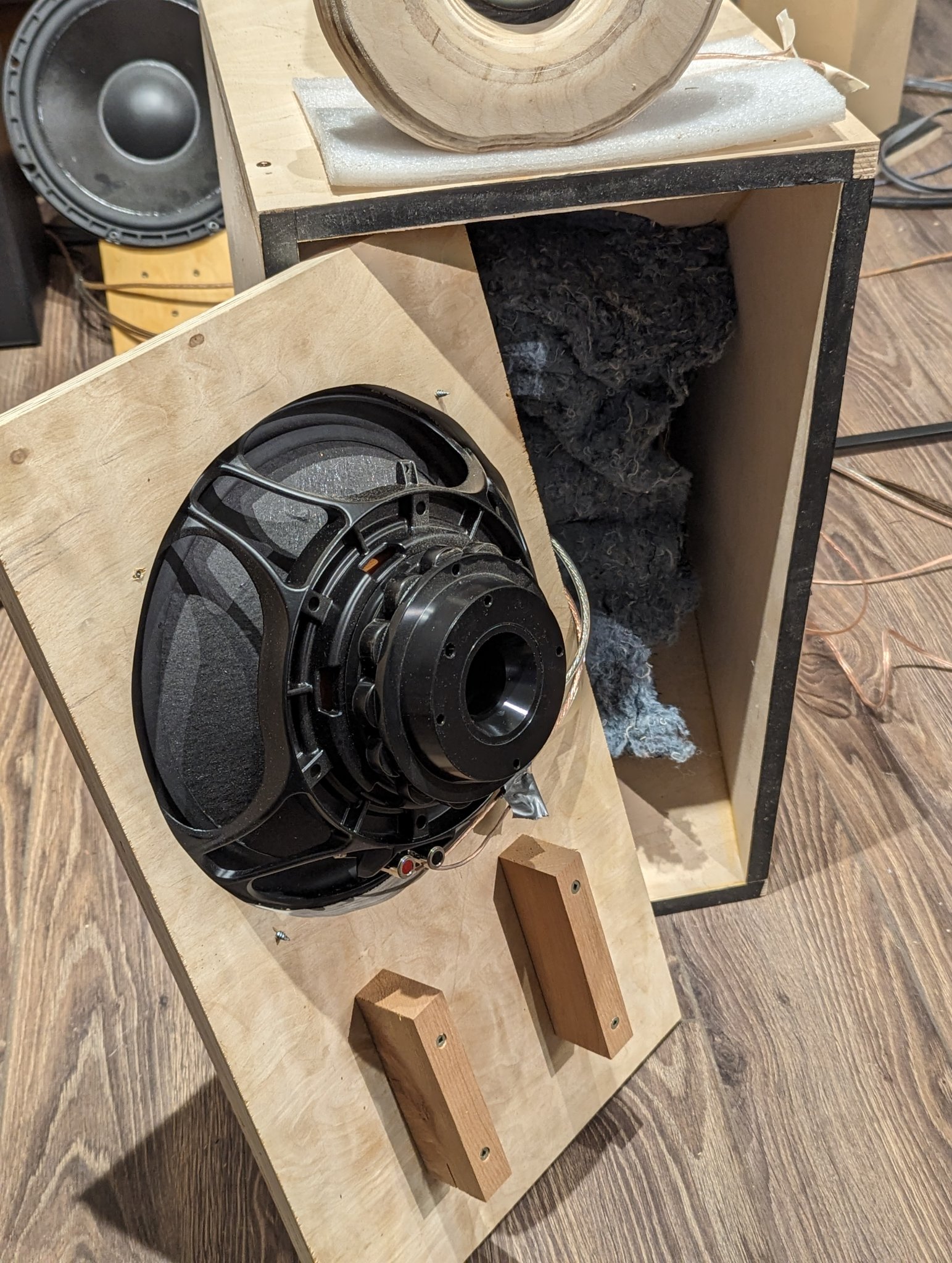

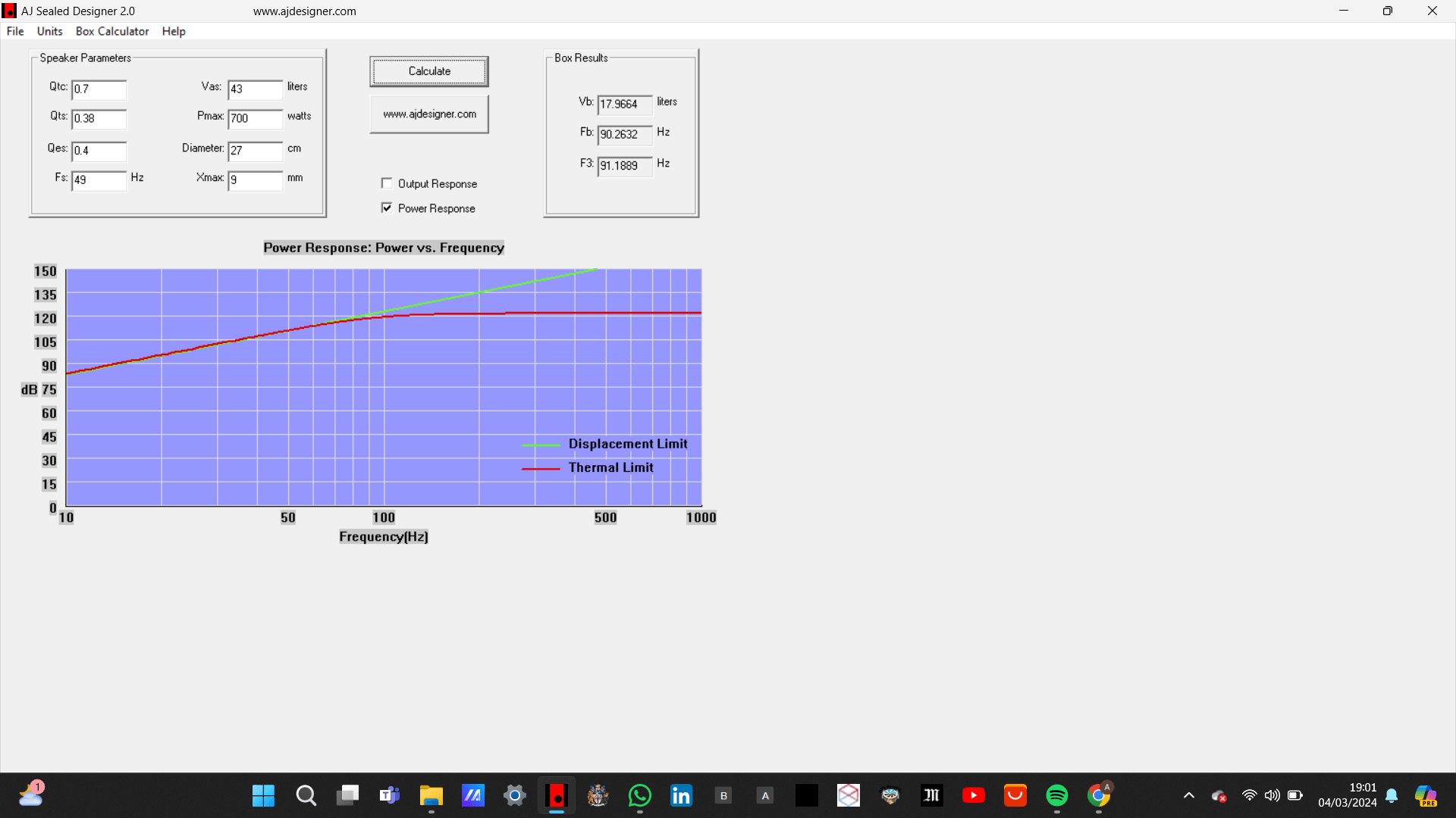

Back to the woofers. Yesterday, I made a new baffle for the Eighteen Sound 12" woofer. This baffle isn't quite as heavy as the one for the Dayton 10" sub, but it's decently rigid.
As expected, with 43~45 liters sealed volume, the 18S pro woofer starts rolling off at around 100Hz. Don't have the Fb in hand; suffice it to say it's quite high. A 12 dB Q=1.0 peak boost at 35 Hz brought F3 to ~38 Hz. And increasing gain to >100 dB @1m showed the driver can handle the boost to that level without obvious signs of overload.
Obviously, it's way too early to determine whether it sounds good or measures well.
I had Qobuz streaming through it while I worked on other things in the workshop. This is with a quick & dirty setup of driver levels, basic PEQ, and LR4 crossovers at 600 & 5000 Hz. I can only say it sounded decent on some tracks, terrible in a few. Source material was random so, impossible to draw any real conclusions. It's just a start.
