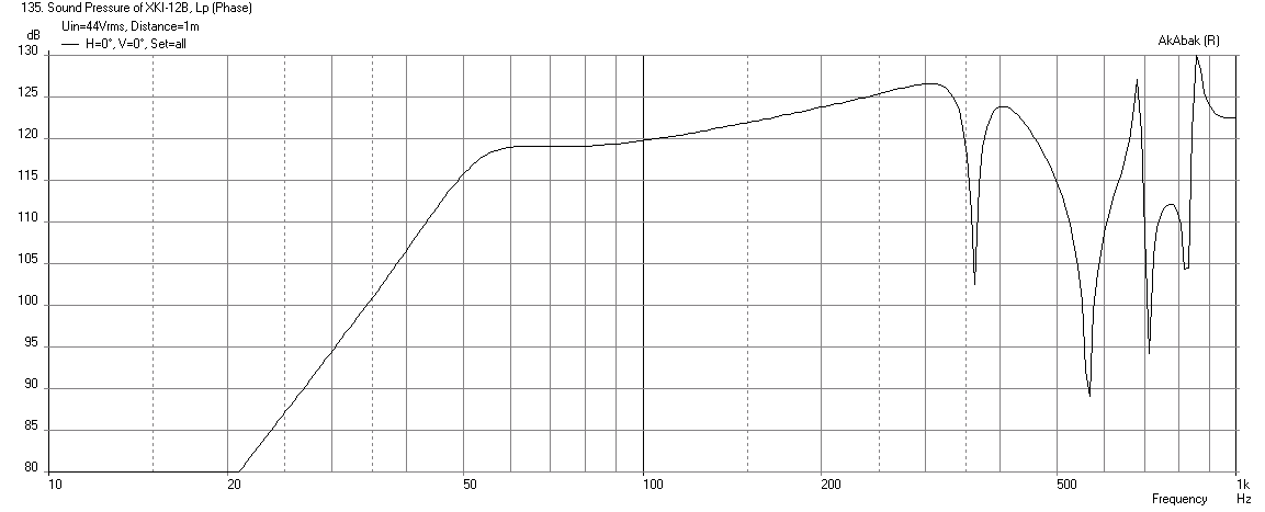

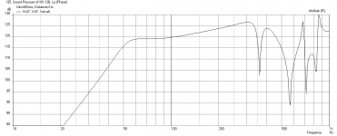

Here is a design I came up with for the JBL 2262HPL: 48 liter box, 14in wide with 2.5in x 19in long vent, make the rear chamber 80% of volume and front chamber 20% of total volume, front triangular K aperture about 12in wide at base x 14in tall with curved profile that has about a 30in rad of curvature.
You should be able to hit 119dB at 43v with a 35Hz BW1 HPF (I used low order to reduce group delay). The f3 is ~50Hz. Sensitivity at 2.83v is 95.3dB. I am trading a few dB sensitivity for some extended bass reach as the driver is ideally designed for 70Hz tuning.
The long vent has a resonance dip at 360Hz and 570Hz though, I would suggest using this as a bass unit below 400Hz and having a real mid driver and tweeter above.
The prediction doesn't account for the direct radiation from the front of the cone so above 300Hz is going to follow mostly natural response of manufacturer's specs except for the dips near 360Hz and 570Hz. I am not quite sure what upper reach you were looking for. If you want extended upper to XO to a CD at 1.2kHz for instance, then vent needs to be shorter and 70Hz or so is really the design limit.

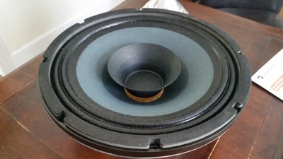

While reading through this thread again, I noticed in post #12 you mentioned the beta 10cx could go in the same cab that you came up with for the 1772 if the vent was extended to 9". I already have an eminence b102 laying around that has ts params that are very close to the 10cx's bass driver half.
The b102 does have a whizzer, and I recall it stated that a whizzer might not be optimal behind a k. Besides that, would it do ok in that enclosure with the 9" port? How close do the parameters need to be to work?
B102
Fs 48hz
Qts .39
Vas 2.3 ft3

here's the old B102 vs the current one with both in a "Druid" size pipe - a decent piezo or K-tube could provide the treble. It should work pretty well in XKi, scaled K15 and Karlsonator applications. A K-tube made of 1"ID pipe 5.3" long with a half ellipse slot works well.

the lighter magnet model B102 has the same external diameter magnet slug as the early model so bot magnets look about the same. I think the cloth surround is the key. Similar changes were made in Beta10cx as to qts, cloth surround, and cone.
The early 56oz magnet model had a multi-pleated accordion surround, black cone and a lot more high frequency extension.
While the newer higher Qts model had a double roll surround and bluish cone

Thanks for all that info Freddi! I have the newer, higher qts model of the b102. I was kinda hoping I had the older model but oh well. Do you think it would work in the XKi for the 1772 with the longer 9" vent? Are the parameters close enough to the 10cx? I guess I should just build it and see, good practice anyways.

xrk971 can simulate in Akabak the situation. B102 should work well in K's anywhere from one cubic feet to two cubic feet rear chamber - it may simulate nicely in GregB's Karlsonator 12.
a K-tube's dispersion patterns nicely mate with Karlson type. You might find something like a KSN1005 type piezo if tamed to make a nice tweeter for B102, and sit it on top of the XKi or Karlson.
here's my later B102 mounted in a very old approximate 0.58 scale K15 - the cutout is for an 8 inch - I could consider this size
