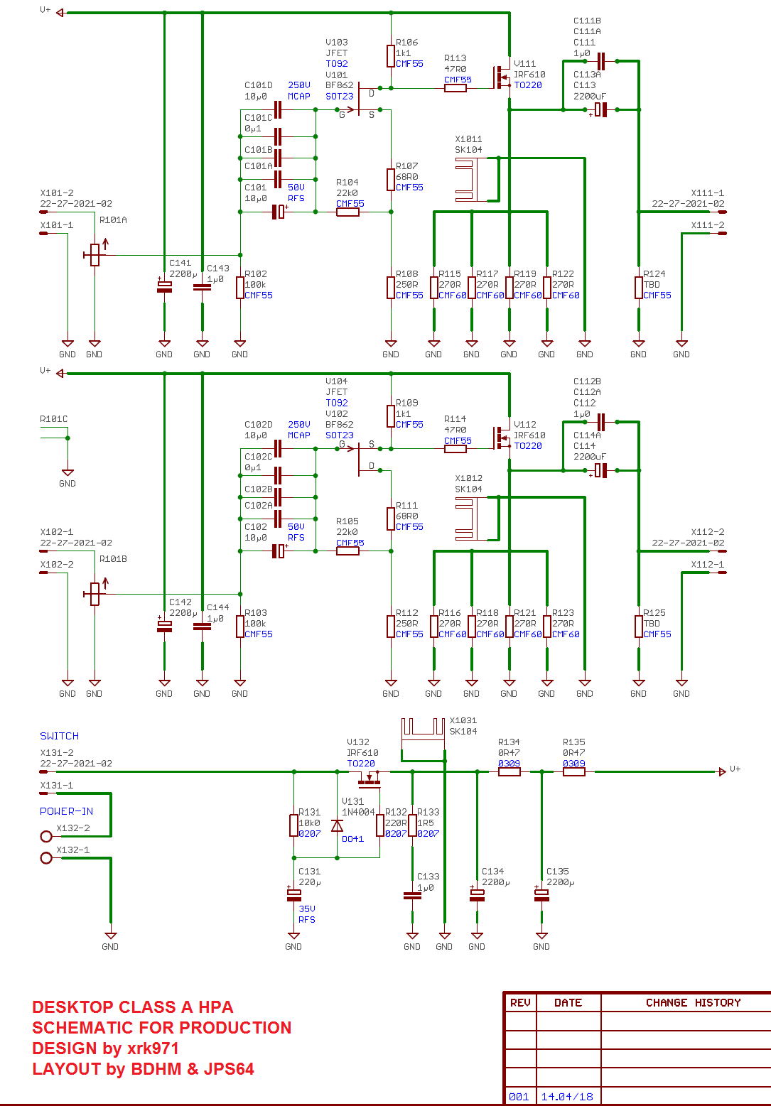

Same simple design but with built in low ripple cap multiplier PSU and uses TO220 MOSFET (like IRF610).

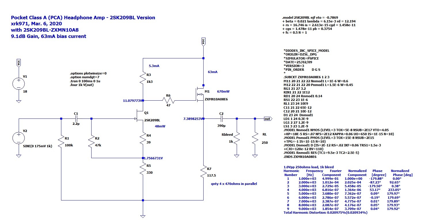

48ohms is on the low side for 60mA bias current if you like to play loud or have lots of dynamic range.
Let’s say you want 12dB of headroom on top of nominal 1mW at 90dB. 12dB is 4x3dB (3dB is doubling). That’s 16mW needed.
Sqrt(0.016W x 48ohms)=0.88Vrms=2.5Vpp
V=IR solve for I=V/R=2.5V/48ohms=52mA peak current.
So if you keep bias current at least 52mA you are ok and not current limited. But if you play at levels higher than 1mW and dynamic peaks exceed 12dB, it will distort or clip.
If your headphones are 100dB sensitive - you are probably fine if you listen at 90dB (and that’s loud).

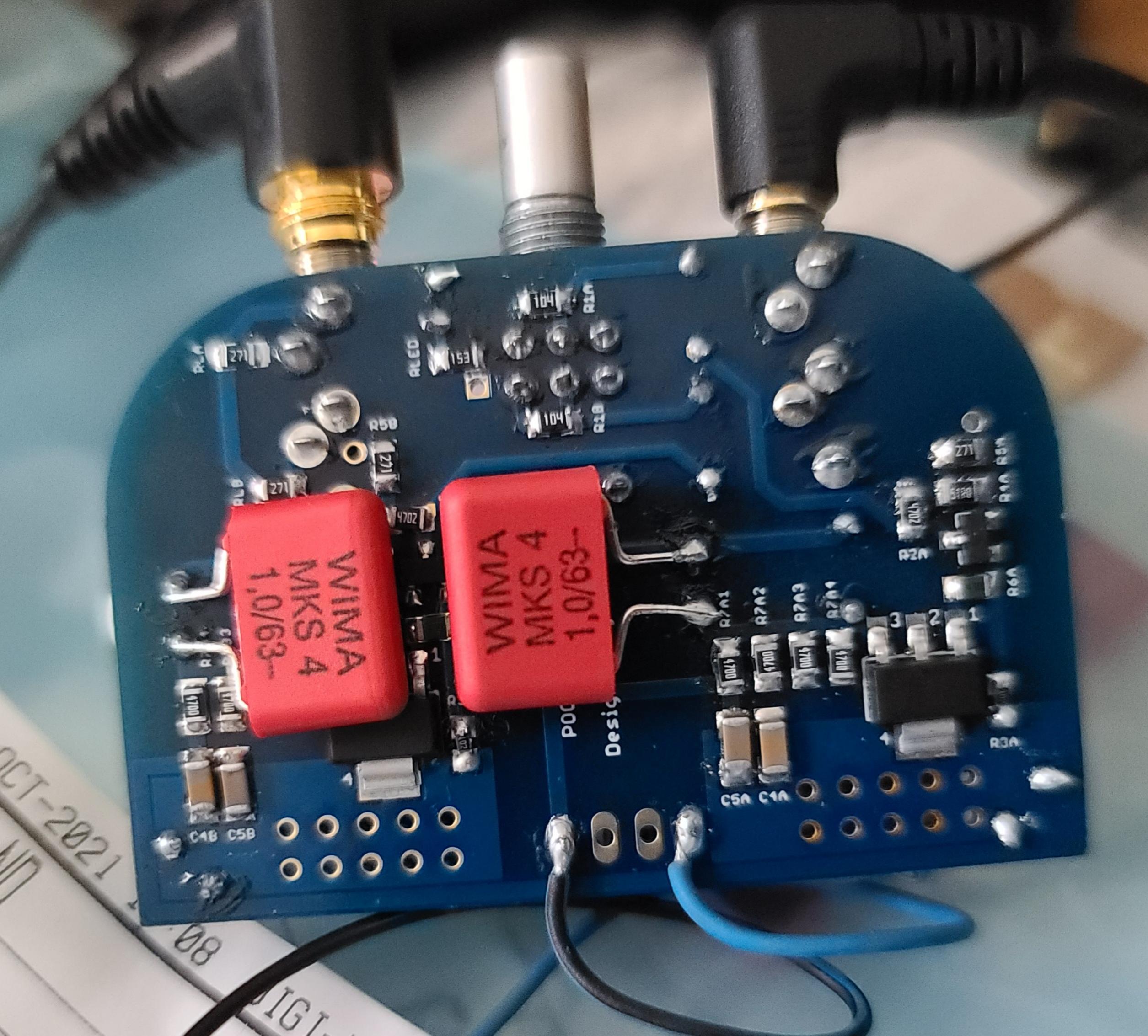

I just found some Wima 1.0uF (and 2.2uF) caps that I had stashed for a second SLB build! Where should they go on the SMD side of the PCA, across C2_1 or C2_2? I have 1000uF 16v OSCON on the top side C2_1 and C2_2 spots.

Bypass film caps go across output caps C1 and C10. I have soldered them to the legs sticking out of the SMT side.

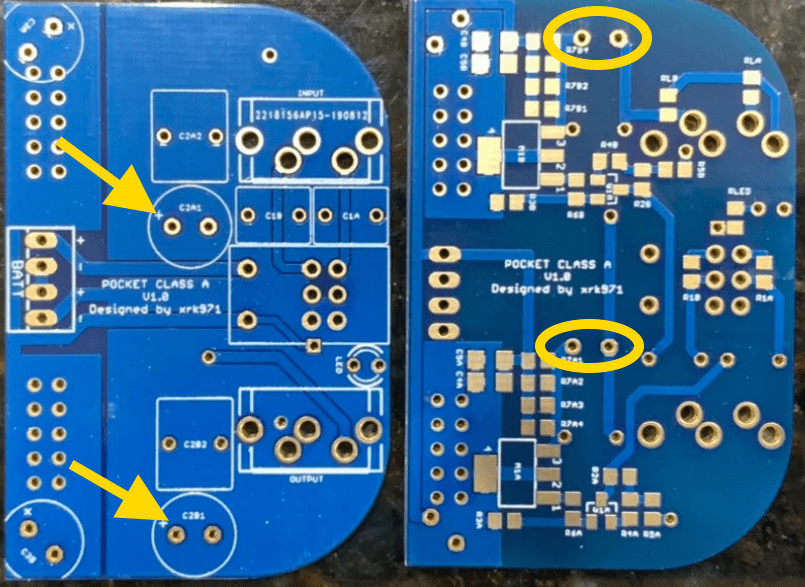

I'm looking at the PCB itself which has different identifiers for the components. So if I'm understanding correctly what you called C1 is marked as C2A1 and C10 is C2B1 on the PCB.
