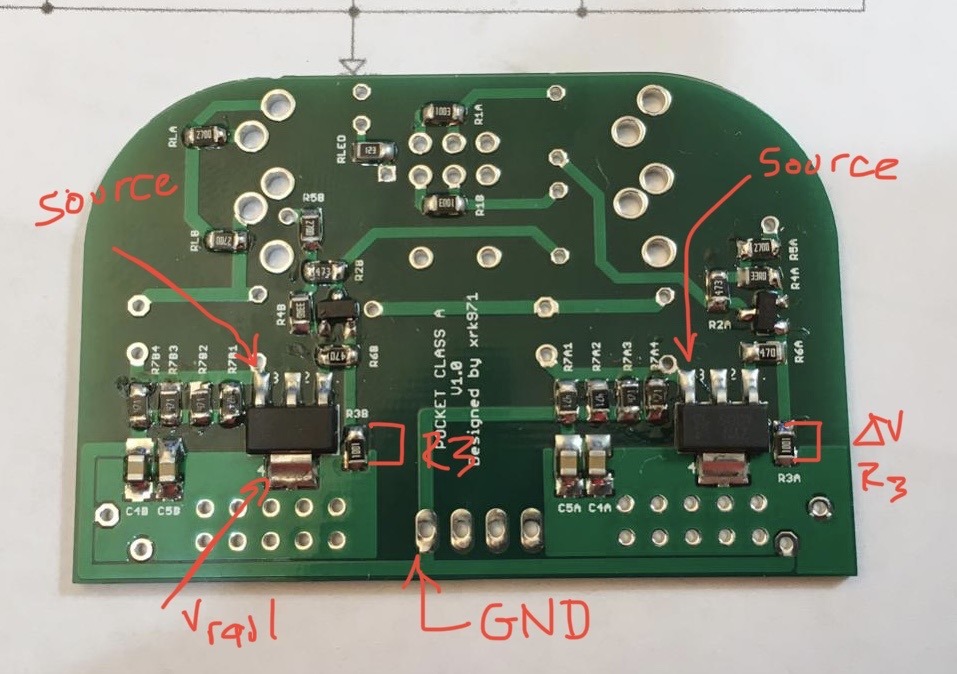

Hi Paul,
Sorry you are having issues.
Well you are the first user to ever report this experience. There are literally over 200 happy builds out there. I have listened with IEMs before and it sounds great. I suspect there may be an issue or something is not right. Can you please take a few high resolution closeup photos of the amp at oblique angles (not straight from above). Top side and bottom side.
Also, with the amp powered up, use a DMM and measure the DC voltage at the source pin of the MOSFETs (pin 3). Measure pin 2 to get the battery rail voltage.all with respect to GND (-ve of battery).
Finally, measure the voltage across resistor R3 to get a value of the bias current across the JFET.
Are you using a genuine BF862 JFET? Or maybe 2SK209GR or 2SK209BL? They all have different values for R3 to allow them to work well.
Also, what is the impedance of your IEM? What rechargeable battery are you using and is the voltage full? If you use a 9v alkaline, battery is going to be dead after 2-3hrs.

Here are relevant test points:
