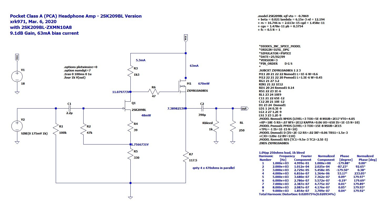

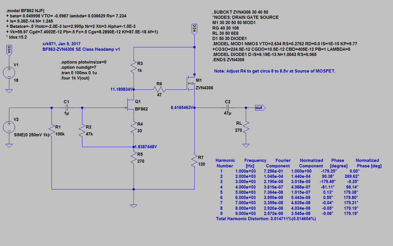

I haven’t changed schematic since original was released. Through the years, parts upgraded for caps, and MOSFETs changed. If you can’t find BF862, then need to use 2SK209. In which case resistors changed. I know it’s a lot to follow.
The major changes:
1. MOSFETs use ZXMN10GTA (2 needed)
2. Pot now use AliExpress since Alps discontinued:
https://a.aliexpress.com/_mLF5Cyk
3. Output caps use a pair of Panasonic SEPF 1000uF 16v per channel (4 needed) where C2A1/2 and C2B1/2 go. Alternatively, a pair of SEPF 390uF are also great. Larger values needed for lower impedance headphones.
4. Input caps still 2.2uF 50v Wima MKS or Elna Silmic 10uF 35v electrolytics, C1A and C1B
5. JFETs use Toshiba 2SK209BLif you can’t find BF862.
Use resistors shown here (R1=1.3k, R3=39R, R4=330R):
6. Changed resistors to accommodate 2SK209 per recommendation in thread. See schematic above.
7. Rail caps use Nichicon 2200uF 16v where C5A/B are.
But this is DIY, feel free to cap roll and see what you like. Some people like Panasonic FC as outputs. Some people like an MKP filmcap for bypass. Etc.

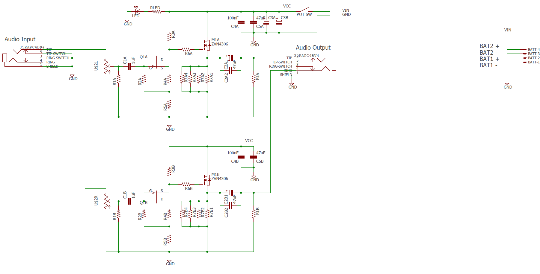

I can find BF862. Because last time I can not follow Output Cap, I saw 47uf and other Capacitor without value in the schematic so I can not find value.I haven’t changed schematic since original was released. Through the years, parts upgraded for caps, and MOSFETs changed. If you can’t find BF862, then need to use 2SK209. In which case resistors changed. I know it’s a lot to follow.

Hi Can I use one more bypass capacitor 0.01 uf with input 2.2uf capacitor ?Use as large a value of output cap as you can fit. Dual 1000uF SEPF 16v is one of my favorite. Alternatively, a single 2200uF laid on its side works too. You can use a small 1uF film bypass cap on the other side if you want.
