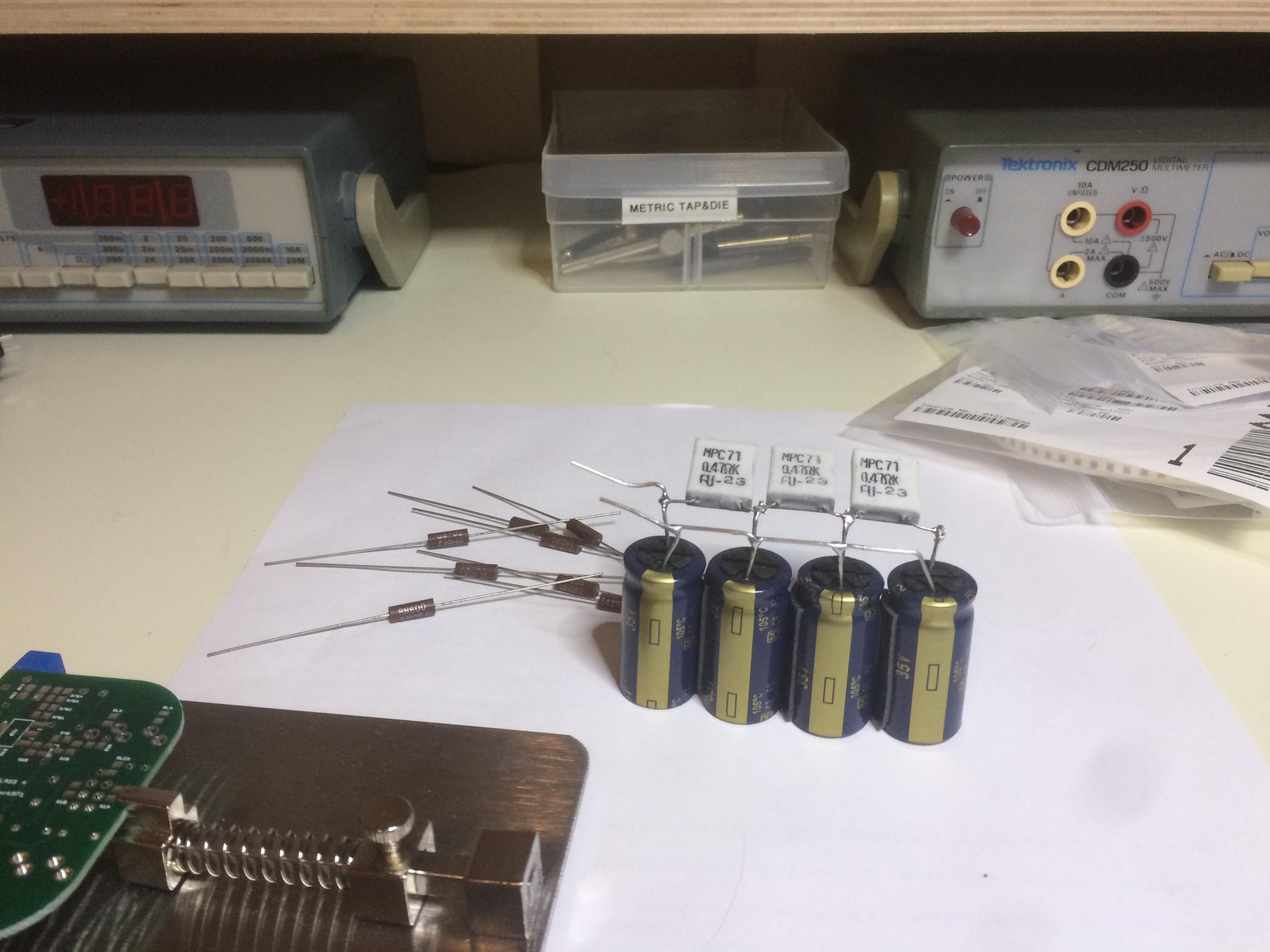

Awesome, thank you for the tips X!
I'll see if I have the right bits on hand to make a cap mx, I just ordered some of the cap mx boards that raptor was kind enough to post.
I used the mpc71's because I had them lying around, I may have something more appropriate in the stash if I dig deeper.
Will re-do rcrcrcrcrcrcrcrcrc(however many letters it is...) with the r's on negative side.
Will match the irf's as best I can, I think I only ordered 10 or so.
Thanks again for the pointers, and thank you Raptor for the cap mx board design gerbers.
