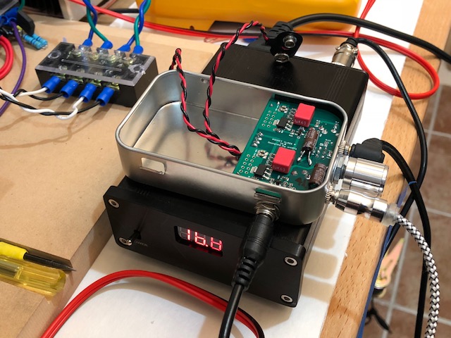

Another Desktop Capable NHB amp
Just got done building and testing this one for a customer in Texas. It has a 5.5mmx2.5mm barrel connector on the side to allow connection to a PSU when used as a desktop amp. The jack disconnects the batteries when plugged in. This particular unit measures really nice at only 0.013%THd for 1Vpp into 270ohm load. This particular PSU is from eBay and uses a transformer and LT voltage regulator. It has very low (almost non existent 60Hz and 130Hz peaks and a -115dB 240Hz peak. Inaudible at that level.

I recently got a pocket amp from the swap meet here on diyaudio. It sounds fantastic both for headphone and as a line stage. I replaced the Oscons with some Panny FC, and now I am even more impressed.
I am feeding it 14v with a lab supply and an Allo cap mx. I smoked two of the mt3608 boosters when I hooked them up to the Allo cap mx. Polarity and voltage levels were fine so it must be a load issue. I am wondering if I can hook up an mt3608 booster board directly to the amp to get the more optimal 16-18v. Would that work? I have 2x 1500uf on the board, and would unplug my headphones when switching on/off.
Founder of XSA-Labs
Joined 2012
You can connect the MT3608 directly via a 2W 3.3R resistor in series. I would try the Juma cap Mx because perhaps the Allo does not have the gradula startup capability? It is a different topology altogether. Have the 14v lab supply feed the MT3608, then feed the Juma cap Mx, then feed the CRCRC then the amp. You could connect the MT3608 to the amp directly but the 2200uF caps on board will cause in-rush and the MT3608 will shutoff. Since you are using a lab supply, having lots of power is not an issue so use a 3.3R 2W resistor between the MT3608 and the amp. It will get warn but MT3608 won't shut off.
