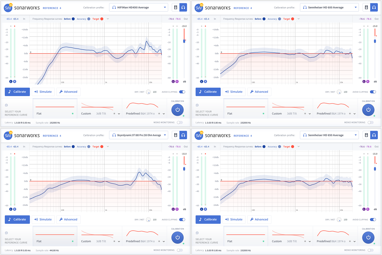

Other thing is to let you know that looking into free trial of "Sonarworks reference 4" then average response of HE400i looks more a bit like a +9dB resonator thing than real resolving high end stuff doesn't it.
For reference also added DT880 and HD600 plus HD650 (OB-1 is not yet baked into package).

I am out of it, what is Sonarworks? Anyhow, the response indeed is a bit peaky and long term listening is showing this. So without EQ, they can be somewhat fatiguing with pop music and rock. Jazz and classical seem ok still. The HD600/650 look really smooth. My main reason for getting the HE400i was for research rather than listening enjoyment. I do know for sure that my amps can drive them now.
Okay if long term listening changed your HE400i view to be peaky and somewhat fatiguing then that software package probably have it right, info for Sonarworks can be seen here YouTube, in general its a correction package for studio monitors or headphones and it can correct in two ways either via a plugin in ones player or DAW software or it can make a system-wide correction for hole operating system sounds, when up and running with your corrected device it can even simulate another set of headphones or speakers

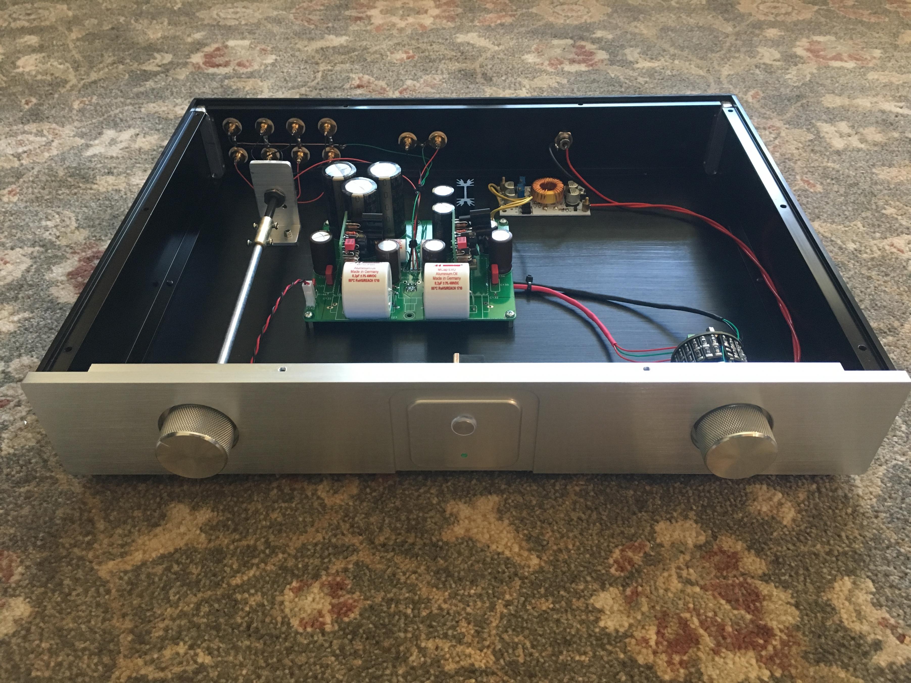

I have another solution for you that is simpler. Have you considered building the Aksa Lender preamp as a HPA? It is capable of high rail voltages so you can get the drive level you need with a single ended output amp. I currently have mine setup at 24v rails and it sounds really nice.
Aksa Lender HPA
Use these daughterboards where the core amp module resides:
Here is the circuit:
For a HPA, the Vcc goes down to 24v and the KSA1381 is replaced with a Tosiba 2SA1837, and BSP129 is replaced with DN2540, plus a few resistor changes:
Here is 2.0Vpp into 43ohms:
Anyhow, a GB is underway and you could just build this as a desktop amp.
You could use a really nice case like Vunce did:
I suspect if you made this amp, it would really outperform two PCA's in balanced drive mode even.
