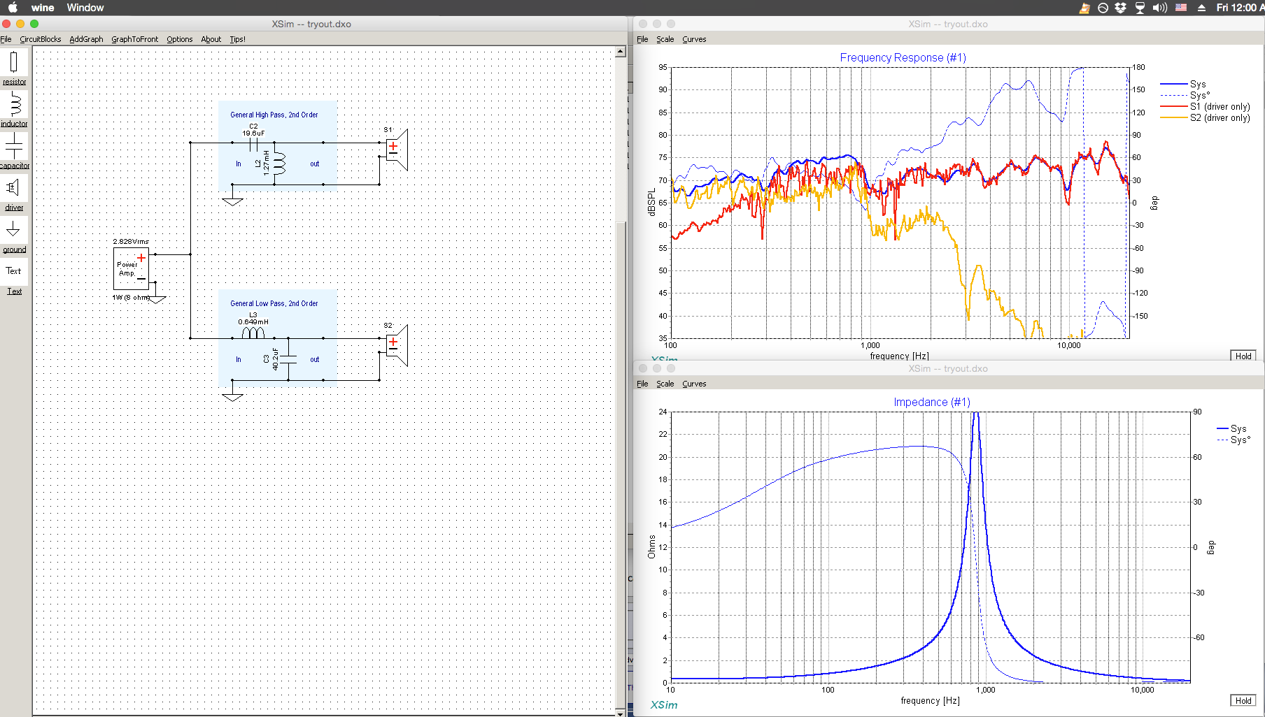

There's something I don't get completely...
I made my frd and zma files that I added to the driver.
I get the frequency response as is.
When I add any kind of filter, I see the changes on the impedance graph, but the frequency response graph never changes. It always stay to the initial rendering...
Is there something else? I thought I could see the impact of adding lowpass / highpass filters on the frequency graph...

Ok, I've made a dummy run at it... added a lowpass and a highpass but still doesn't show.
Here's the picture... and the dxo file (zipped).
it's not the actual file I was trying to work on, but it should have showed some frequency changes as I added 2nd order at 1k for both high and low pass filters.

At first look at that picture is that zma file show low impendance close to zero ohm, will have a look into dxo file also.

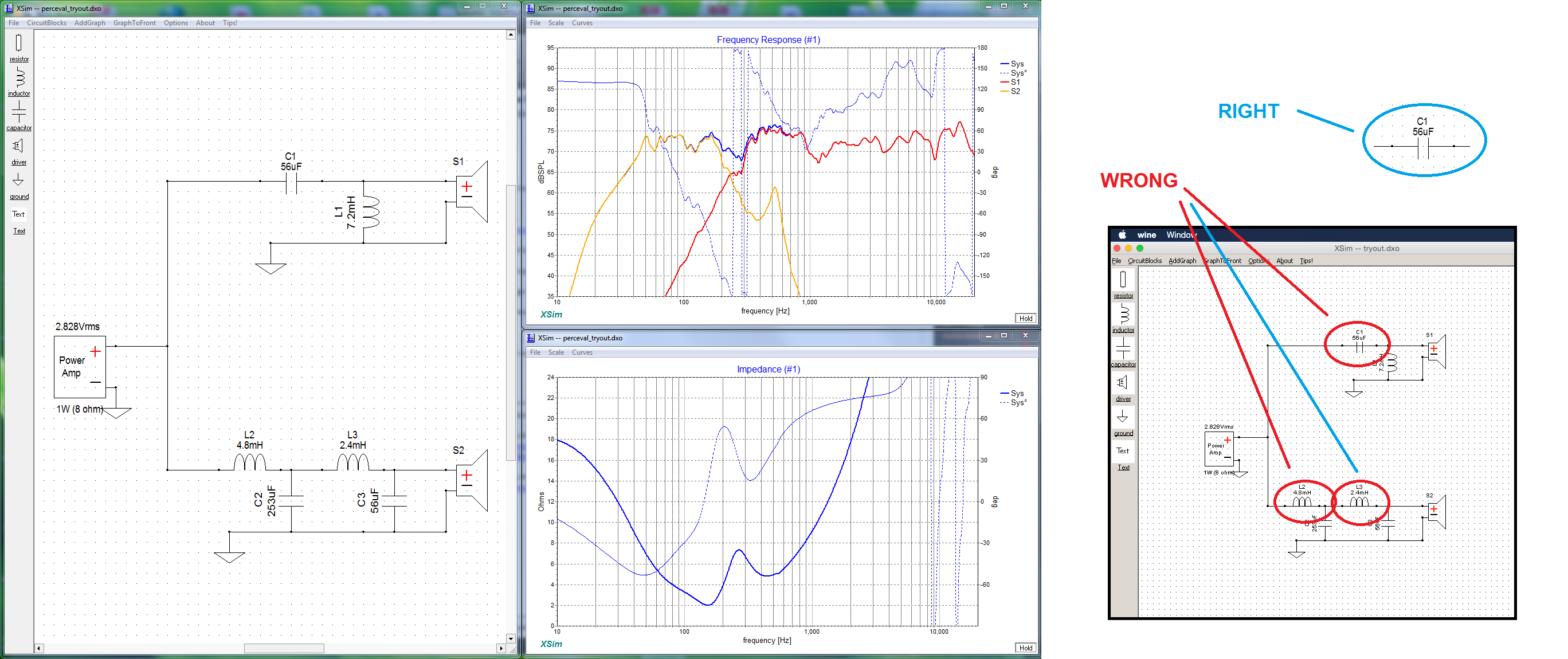

EDIT found error, see below when we lift HP and LP section away you have strait wire underneat direct to drivers, so delete those and lift HP/LP filters back and make new multiple shorter wires between terminal points.

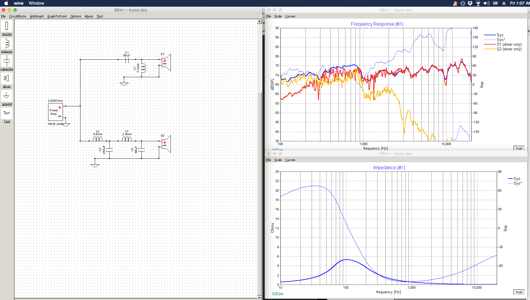

I redid my original XO... Here what it looks like.. it didn't change from the other picture, even though the values are totally different.

Ha!
BYRTT, you had it.... and just about everybody else but me!
I initially thought I could just drop HP/LP/inductors/capacitors onto a line and it would lock in and add itself to the line.
Now, I see, I have to stop the conductive line between components.
Sorry to be so obtuse.... now I get it....

: ) perceval, same mistake you place components or circuits upon wires, don't do that place components/circuits and then wire between terminal points. Look below where your own circuit seems to work.

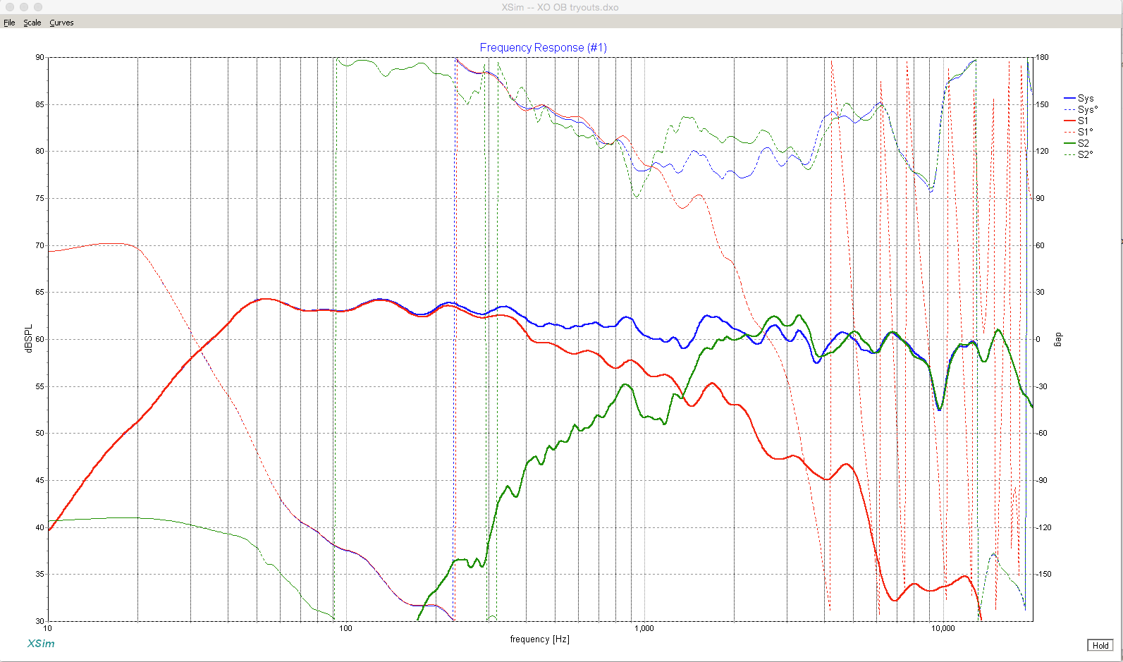

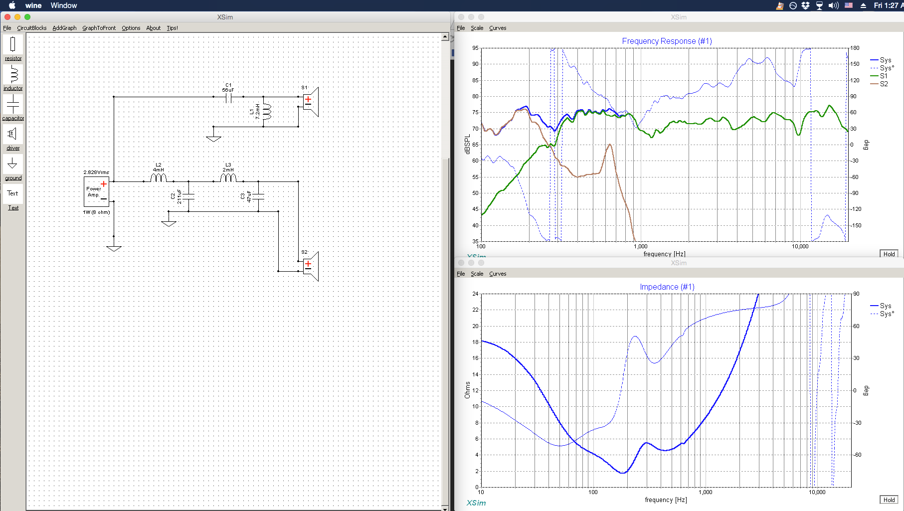

It doesn't look too bad, and should sound quite good as is. The impedance looks very typical for the circuit and shouldn't cause your amp any trouble with it's 8-ohm nominal load.
It would help if you could include individual speaker FR's with their phase in your FR graph, that way we see any potential issues/interactions from break-up on the woofer. We can also see if the phase is a concern at this point too.
