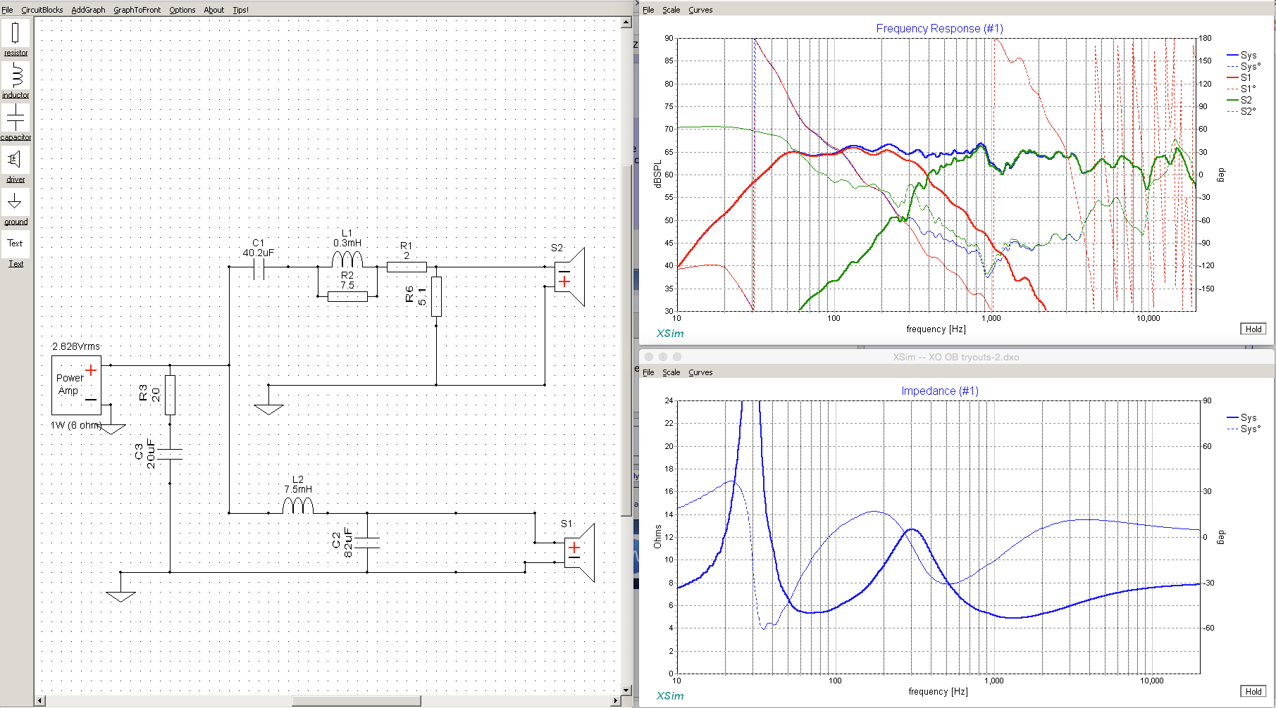

like I said, it looks good and probably would sound good as is.
IMO - it would sound better to get that woofer out of the way faster and go 2nd order, by adding a Capacitor to ground after the coil and see what that gets you. You might be able to lower that coil a little and save some cash, since Caps are much less.
Also, this would allow you to move the F-R lower and get more use out of it crossing right after the baffle-step, or about 500-800Hz.
Both of these will change your phase and should get your XO point and the 90-degree phase switch (200-300Hz currently) closer together which will just be that much better.
Doing good for your first try at this.
Thank you for the feedback.
Here's the plot, with individual driver and phase, plus overall FR.
Looks like phase curves for individual drivers is not minimum phase that follow actual amplitude, that could be because they not zero aligned before exported as frd file or because of non minimum phase acoustic interference. Am i wrong here or is it because you tweaked "mod delay" that phase lag the higher the frq goes.

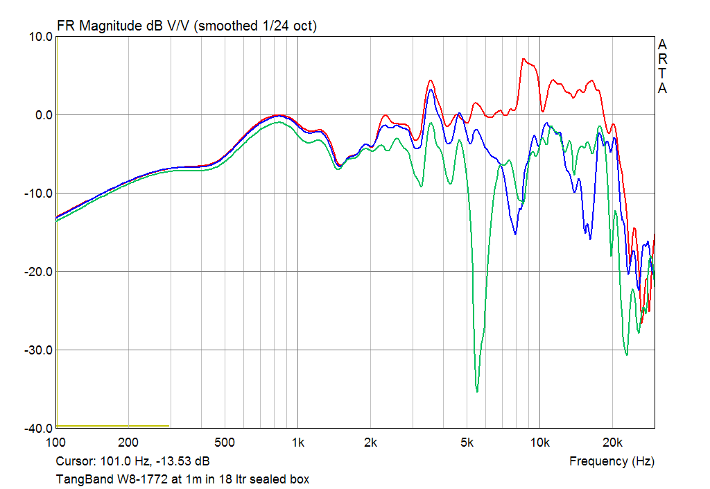

The drivers are the AHE 38P00A 15" driver (a locally made driver)
ÅS¤Ñ©ç½æ-¥xÆW NO.1 ©ç½æºô¯¸
And the TB W8-1772 (but TB is famous for letting their marketing department draw the FR line)

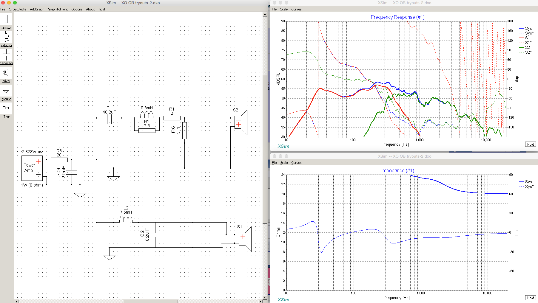

If you want to make the impedance look nicer, just put a 20ohm 20W resistor in series with about 20uF of capacitor, and put those across the crossover input (amp output) terminals. Wastes a little power but won't affect sensitivity. Probably not worthwhile though, unless the speaker is used with a high output impedance amp (like a SET, Zen, or some low feedback tube types).
Hmmm... that didn't work so well. See picture.
My amp is the NuPrime MCH-K38, and they don't mention output impedance anywhere, only input impedance at 47k Ohms. But, they call it a class A/D amp, so, I think I'm fine with it.
No, no, no. Don't put a network between the crossover and the amp -- put the speaker back where it was and THEN put a resistor and capacitor (which are in series with each other) with one lead to crossover input[+] and the other to crossover input [-]. You want to shunt the speaker impedance with the series RC impedance.

Told you this was my first time!

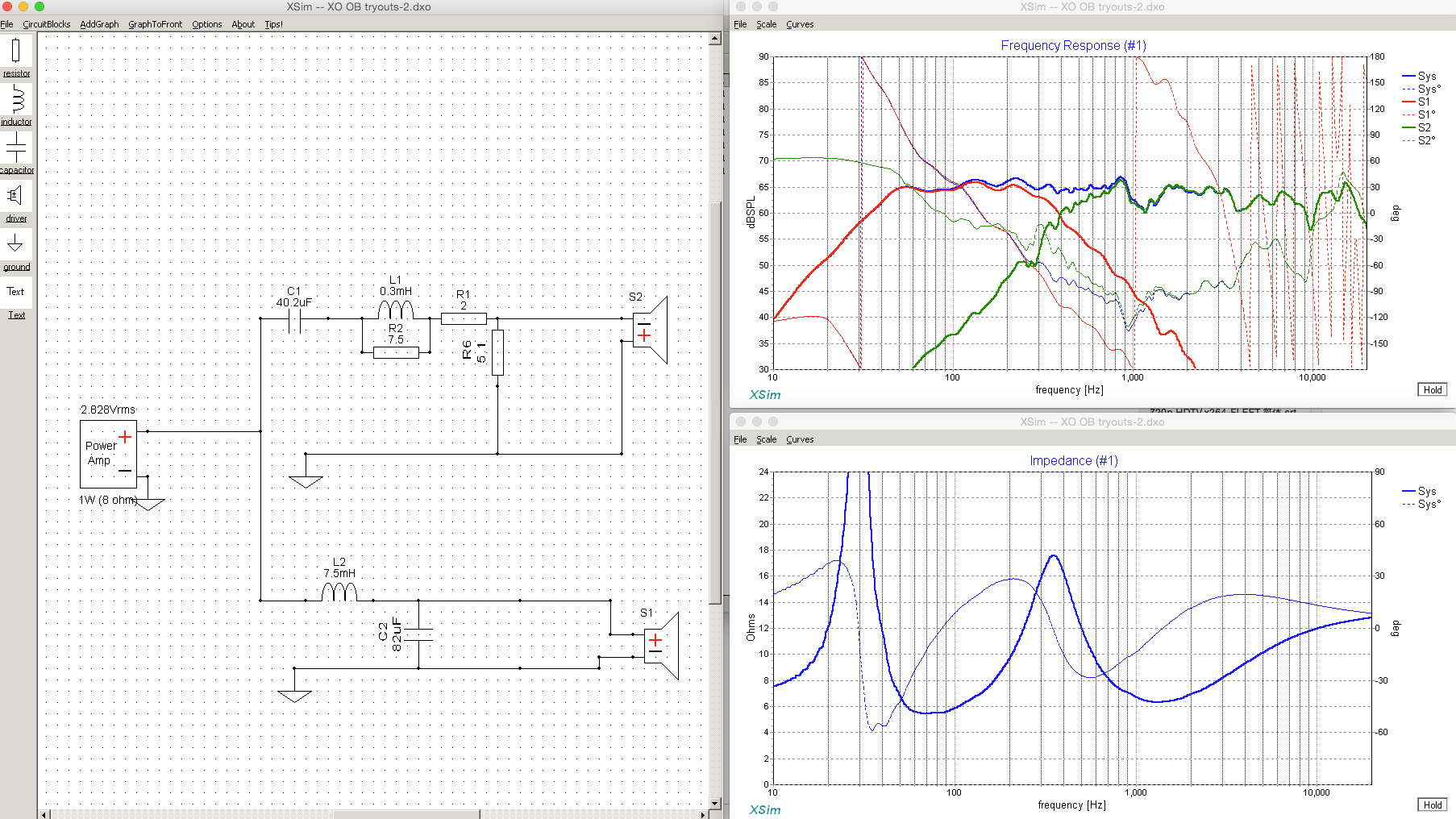

Ok, I think I got what you said. It moves the second impedance peak down by about 5 Ohms, and lowers it from 350Hz to 300Hz.
Or, more simply, it throws some dissipation and yanks everything down from about 300Hz and up. You might want to make the cap bigger (maybe 33uF or 47uF?) to get the lower midrange peak down a little further. Not so low that it gets into the bass, though. (But again, if you're using a high damping factor amp, probably don't use the network at all
Thanks!
Ron
Or, more simply, it throws some dissipation and yanks everything down from about 300Hz and up. You might want to make the cap bigger (maybe 33uF or 47uF?) to get the lower midrange peak down a little further. Not so low that it gets into the bass, though. (But again, if you're using a high damping factor amp, probably don't use the network at all)
I did try to change the values a bit, and best I got was a 20 Ohms resistor and a 40uf cap.
My amp has a damping factor of 400. So, I might not need it, but thanks anyway. It's all part of the learning process!
