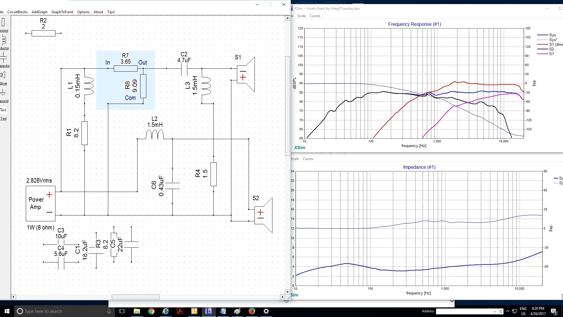

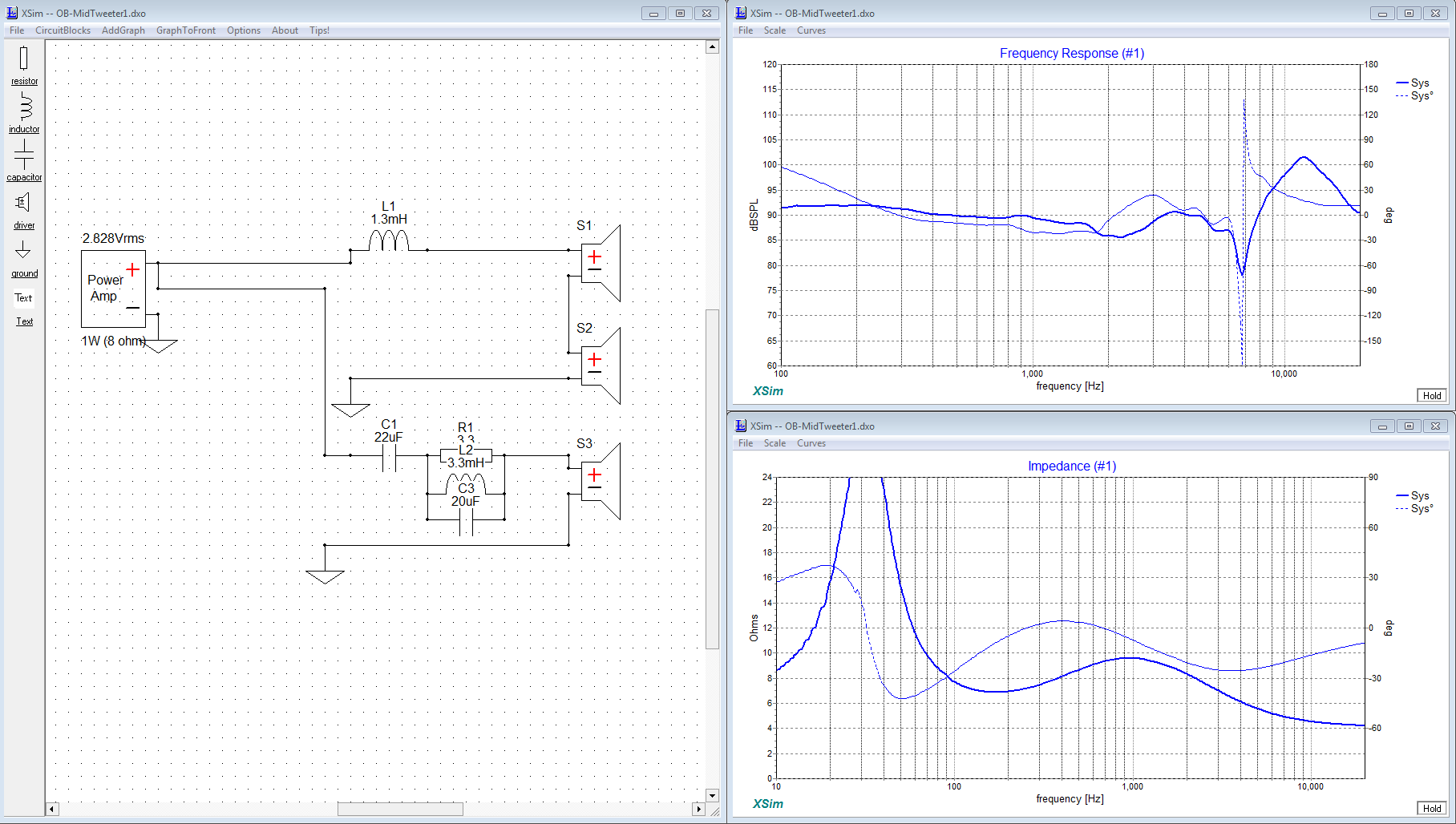

Question here...
In this picture, I was suggested to add a shunt at C3 and R3, 20uf and 20 Ohms respectively.
But... I tried removing C3 and only have R3 in the shunt and it looks even better.
Can I forego the capacitor in that shunt and only use R3 to lower the impedance plot?

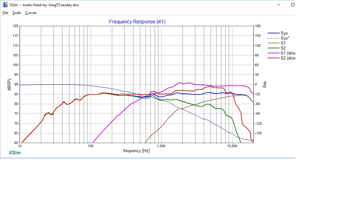

A famous Dane designer had a design posted I wanted to build but my tweeter is a Scan 2705/9500 not the 9700 in his design. He kindly modified it and sent me the plan privately.
This was 10 years ago and I still haven't built it. I finally bought all the xover parts (hundreds of dollars). I discovered this Sim a few days ago and entered all the values, traced the FR and Z curves from the ScanSpeak site correctly.... and the system response curve is appalling. It is slightly better with inverted tweeter polarity but not anything acceptable. I spent a few evenings and mostly using the same parts, in a completely different arrangement, designed a decent System response and an AMAZING System impedance curve. But what the heck with the circuit I was as given?? I hate to look a gift horse in the mouth but on no planet 10 or otherwise would that cross over have worked.
And hi Dave and welcome back!

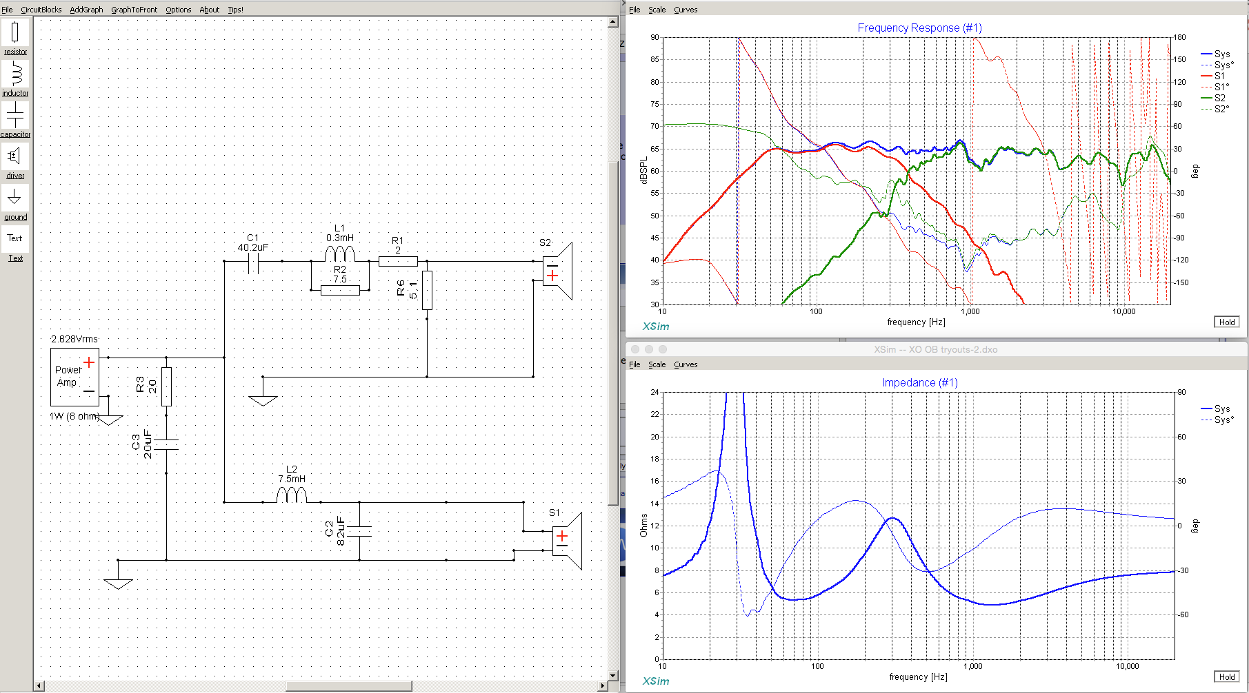

Another learning curve question regarding this simple 1st order butterworth crossover.
The tweeter is a NEO 8 clone which supposedly has a 10Khz peak that there is a well defined notch filter for. I attempt to add the filter and it has little impact on the resulting frequency graph.
The graph also looks much nicer with the tweeter inverted, but again there is no appreciable affect in adding the notch filter.
Did I get the filter wrong?
I didn't even see the manual so I figured it out by guess and by golly. So you have obviously drawn the crossover right? Oh I see that just now you posted it. Yes you just need to add the rest of the curves using the pulldowns. And for the drivers have loaded the FR and Z curves. The two graphs that pop up by default are the FR and Impedance(Z) graphs. The File, Scale and Curves' pulldowns are on the top bar. Use 'Curves' on the right of each graph. It has a number of options: System, S1 and S2 in my case as I have a 2-way system drawn, and S1(driver only), S2(driver only). Click on any of these you want drawn. S1 and S2 are the response curves of the Tweeter and Woofer crossover sections in my case. And System is the overall response. You can choose colours for all these curves to be different for clarity. You have to do this for both graphs.
ScanSpeak 8530-K00 and 2905-9500.
I attempted notch filters for the bump at about 750 Hz and saw no effect either. So I don't know ...
Both Troels and ZAph have implemented notch filters for this bump up in response so I figured I had better too. But since they appeared to do nothing to impedance or FR I removed the notch.
