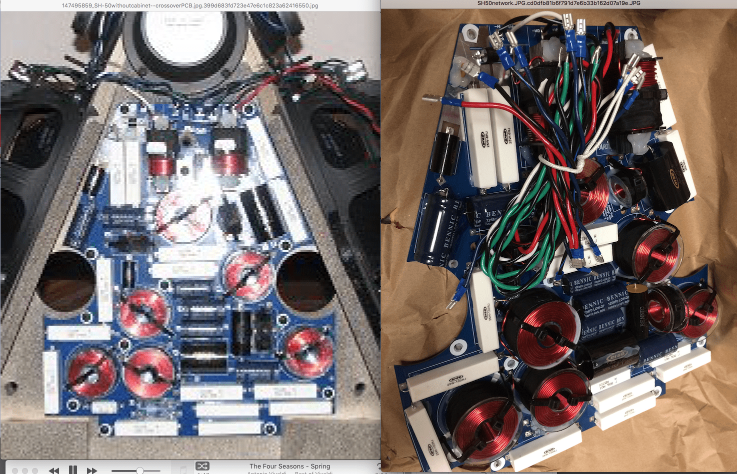

With at least 10 inductors and 9 capacitors in the SH-50 passive crossover, there is a lot to dissect.
Hefty.
I take back relatively 'easy-peasy' with the SH-50's low-order xover .......Lol
Yikes! what a piece of gear. Makes me wanna run away from passives even faster (if such were possible haha)
I've seen that the SH-50 can be ordered active, and with presets provided via their processors, or DSP amps.
I haven't looked in a while, but this thread has me wanting to revisit what the active presets are. I'm going to pull out the Danley ASC-48 processor I have from the days I was trying to see if getting involved with live sound was a good idea. Update firmware, software, and preset library...plus I see it now has Q-Sys integration which I'm already thinking of ways to use.
In addition, if I see a decent deal on a used SH-50, I think I'm going to grab it....to dissect. Wanted to do this forever.
I want to take transfer functions of the crossover outputs, and make them the targets for equivalent FIR files. I'd like to compare....both the digital replication of the passive xover, and then also my own standard high-order lin phase xover method.
Question for you...when taking a transfer function of a passive xover, with the goal I have in mind of digitally replicating it, do you take the transfer with the drivers connect to xover? I would think so, but not sure here....out of my depth.
Many more state side than over here.In addition, if I see a decent deal on a used SH-50, I think I'm going to grab it....to dissect. Wanted to do this forever.
If you buy a SH50 digital version 2nd hand, I suppose the XO 'rights' transfers with them?

As Tom Danley wrote in 2012 regarding the SH-50:I take back relatively 'easy-peasy' with the SH-50's low-order xover .......Lol
https://www.whatsbestforum.com/threads/question-about-danley-sound-labs-50s-or-60s.5738/
"with a passive crossover, there is a practical limit to how many of the response features you can address, each usually requires 3 passive parts, all sized for stability up to high power operation."
The SH-50 passive crossover, as complicated as it is, obviously does not come very close to the goal of a flat phase and frequency response.

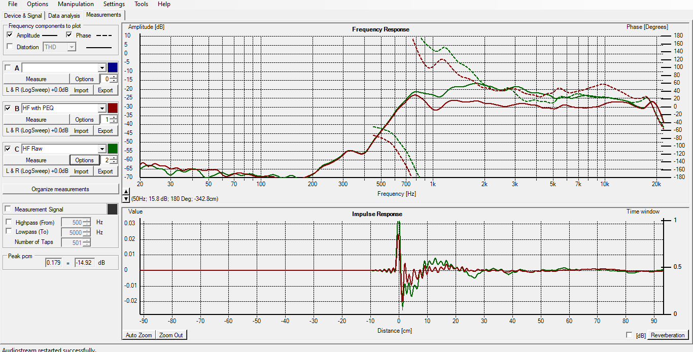

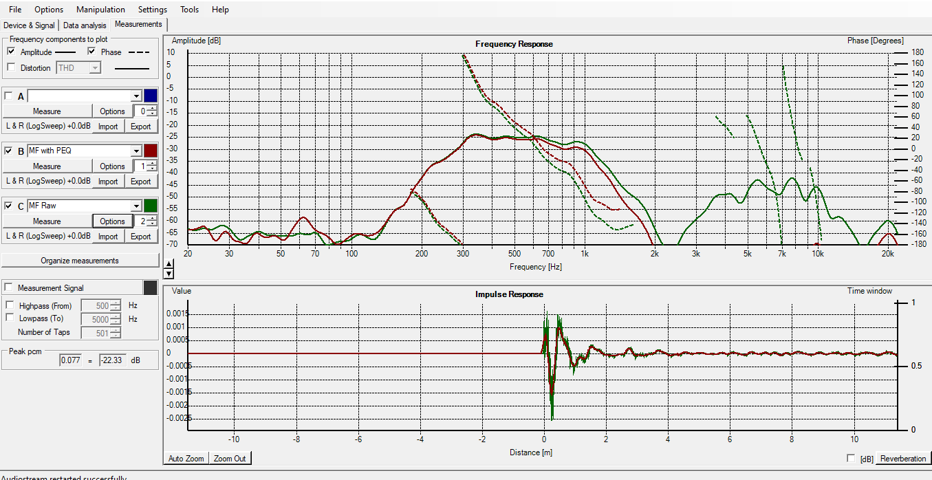

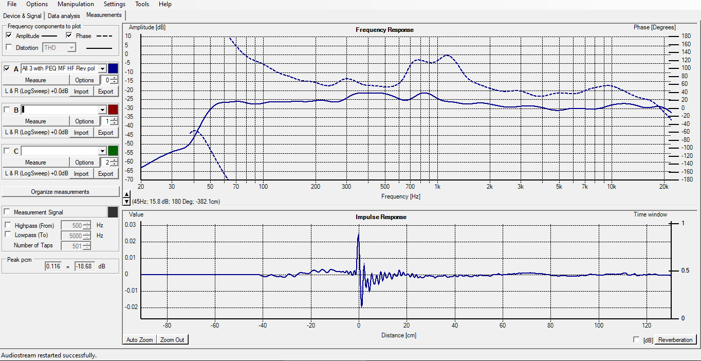

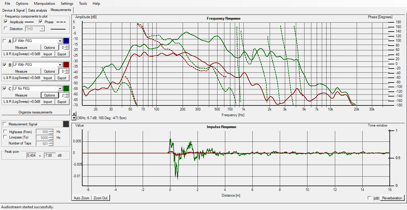

Yes, will do.Hi Speedysteve,
Maybe post your raw measurements of bass, mid, tweet so that people can see what you are starting with. I know for sure my 4" celestion mids on a 50x50 horn the same size as the SH50 had approx 6th order acoustic slopes at both ends (raw measurement no EQ). Not even close to 10dB/octave .
As you say I've seen much steeper acoustic slopes when measuring with horn cutoff and driver roll off too.
True of all the horns I've used over the years.
When I've got the second one made and something to listen to, I will seriously look at FIR with my Najda DSP. I know little about the subject other than scraps I've read.
Will keep my mind active if nothing else😀

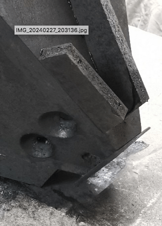

I'm about to do the taps for the MF drivers.
What are thoughts about shaping on the driver side (I've seen scalloped out versions, like a tuned gasflowed cylinderhead)?
Or widening on the horn side?
Or just a straight hole edges rounded a bit?
It would be good to see the response of the prototype before recommending changes.
The volume of the angled area in your prototype area lowers the acoustical band pass frequency compared to straight holes.
A cone filler to reduce the enclosed volume would raise the upper cutoff frequency.
Does the driver gasket provide enough clearance for the mid driver's excursion at full power?
Ah so that's the effect they have! Thanks!

The Celestion TF0510MR appears to have a gasket deep enough for it's very limited excursion, the spec sheet does not even include any information for it's coil or gap height or Xmax. It's response drops off at ~12dB per octave below its Fs of 482 Hz.What I did to mitigate driver excursion issues, rather than machine away thickness in the mounting baffle was to cut a ring into the sound deadening mat that's glued on, to provide around 1.5mm extra room.
I didn't take a pic of that though.
I'd seen pretty deep machined rings in other builds.
Many builds are using small mid drivers with enough excursion that rings to provide adequate clearance are required.
The Kappa 12A's Xmax is only 3.25 mm (Xlim 11.5mm), the gasket looks to be around 7mm past the surround, so more than +6dB power over Xmax would be required to start slapping the baffle.The 12" move more, but its pretty minimal - no where near the mounting face. I had perhaps falsely assumed that the basket / gasket was designed provided enough clearance.
Not had an issue mounting the Eminence Kappa Pro 15LFIIs in my Tapped horns, or Kappa 15As, & the Kappa 12As in various straight horn incarnations I've made over the years.
These don't not see PA volumes in their sheltered life with me - perhaps that is it..

Did with PEQ (no X/Os apart from 1st order on HF).
Then without PEQ
LF, Red with, green without
Is classic 1st order acoustic / work PEQ cutoff?
MF
Steep 2 or even 4th order?
HF
Steeper than 1st order I'm guessing.
All 3 with polarity reversed on MF
I tried all manner of X/Os on MF just to see.
None helped get it better then the last all 3 plot.
Played around with the LF gain to get more, and reduced HF a little, for classic fall off slope, but forgot to take a plot of that(dooh!).
Feels like I'm closer..
