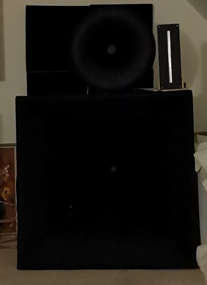

I lasted just over 2 weeks with the sound of the BMS 4550 1" drivers in the conical SH50 alikes.
Don't get me wrong, on a dance floor, or a wedding it would work just fine.
Some things sounded good.
Personally for me - long term hifi listening it just lacked that emotionally epic, draw you in performance and sound I get from my Vitavox S2s on the Le Cléac'h horn.
So here's what I'm listening to now 😂
Subs - Still the long tapped horns
LF and MF the SH50 alike Synergy horns
HF- S2s / Le Cléac'hs
HF+ Raal Lazy ribbons
I went back to my usual implementation of crossovers that are chosen for similar slopes to give good phase aligned overlaps (not trying to flat phase adjust outside of the Synergy horn).
To sum up, I like the LF bass performance from the Synergy, the MF is fine enough too (for now?).
Now I have the S2 magic back too, and if my daughters come and listen they will not miss the Raal HF+.

In my opinion, the tiny annular diaphragm on a BMS 4550 just doesn't sound very good (compared to a cone driver) crossed below ~1kHz on a conical horn.This evening I focused on the BMS 4550 compression drivers in the SH50s.
I've been having a bit of a hard time comparing them with the Vitavox S2s (latest issue diaphragms, fully refurbished) on Le Cléac'h horns.
Looks like you have enough mid overlap to move the mid/high acoustic crossover up to around 1200Hz, which would make them sound more similar to the Vitavox S2/Le Cléac'h horn.
Putting mid ports in close to the throat in a slow expanding horn like the Le Cléac'h would mess up it's HF response.
Art
Thanks Art. I tried various X/O points in the quest for a pleasing phase plot, but didn't listen to many of them - yet.
I've set it up so I can switch between the S2s / Le Cléac'h + Raals 5 way vs the BMS 4550 and full synergy in a matter of seconds.
I'm trying the old resistor in series trick.
Read about that on a Le Cléac'h discussion and break out thread by Patrick.
10ohm was a bit much, 6.8ohm or as low as 5ohm is nice and more subtle.
I'm trying 1200Hz X/O point for the BMS 4550 at the moment.
Together with the 5ohm resistor it's a more rounded pleasing sound.
Proof that it's the 4550 compression driver stock sound, not so much the horn..

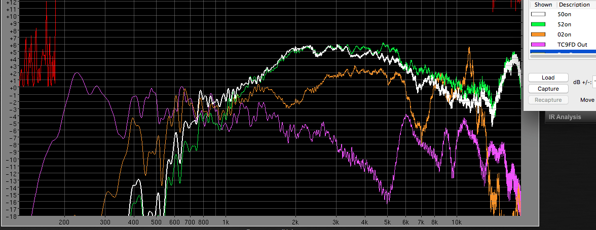

I've tested and listened to them both, the BMS 4552ND has about -3dB less output below 1kHz than the BMS 4550, but has ~+2dB from 5kHz up. The 4552ND is "brighter".Wonder just how much more pleasing the 4552ND (twice the price) or indeed the 5CN160 used in the SM60F, would be?
This graph shows four drivers on the same 13 x13 degree two part conical horn measured on axis outdoors from two meters, with around 1 meter square baffle behind the 300mm x 300mm horn mouth. For a 250Fc horn, the mouth is undersized, so there is more horn "ripple" below 1kHz.
BMS 4550 (50on) is the White trace.
The BMS 4552ND (52on)is the Green trace.
The Eminence 2002 (02on) is the Orange trace.
The 2002 has a 1" exit, 2" titanium dome diaphragm, used in PA cabinets made by Yamaha and many other manufacturers.
The Purple trace is a 3.5" TC9FD "full range driver" using a 1 liter compression chamber and a 2" exit.
This trace was done after the other drivers were evaluated, and is 8 ohms (all others 16 ohms) so the sensitivity may not be accurate by comparison.
I found the TC9FD subjectively to sound cleaner than any compression drivers at high volumes, melted it's voice coil off the former with no sound of distress, while a 3" diaphragm driver well within it's thermal range at the same SPL sounded harsh and IM (Inter Modulation) distorted.
The Purple TC9FD clearly is the winner in output below 600Hz, but with no phase plug, response is erratic above 3kHz.
The Orange 2002 has ~8-10dB more output (~twice as loud!) than the BMS drivers at 400Hz, showing how much less output below 1kHz the BMS have compared to an "average" 1" driver.
The BMS really "shine" above 2kHz, with smooth response up to the 17.5 kHz +6dB peak, response extending past 25kHz. Below 1kHz, not much to write about- more THD and IM than any other drivers I tested.
You could listen to all the compression drivers and many others with audio files in this thread:
Also, I'm not listening in a big cinema room where even sound coverage is important.
What next? Who knows
