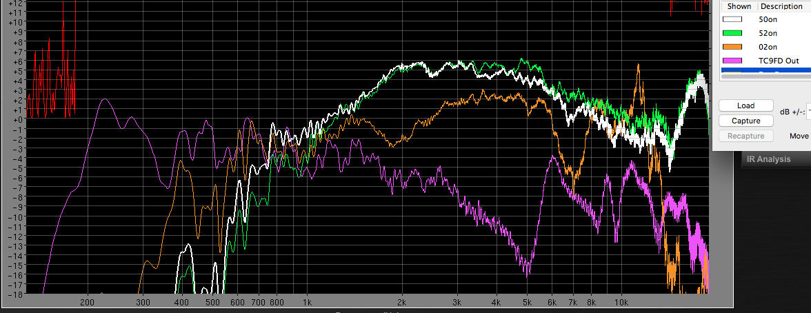

I've tested and listened to them both, the BMS 4552ND has about -3dB less output below 1kHz than the BMS 4550, but has ~+2dB from 5kHz up. The 4552ND is "brighter".
This graph shows four drivers on the same 13 x13 degree two part conical horn measured on axis outdoors from two meters, with around 1 meter square baffle behind the 300mm x 300mm horn mouth. For a 250Fc horn, the mouth is undersized, so there is more horn "ripple" below 1kHz.
BMS 4550 (50on) is the White trace.
The BMS 4552ND (52on)is the Green trace.
The Eminence 2002 (02on) is the Orange trace.
The 2002 has a 1" exit, 2" titanium dome diaphragm, used in PA cabinets made by Yamaha and many other manufacturers.
The Purple trace is a 3.5" TC9FD "full range driver" using a 1 liter compression chamber and a 2" exit.
This trace was done after the other drivers were evaluated, and is 8 ohms (all others 16 ohms) so the sensitivity may not be accurate by comparison.
I found the TC9FD subjectively to sound cleaner than any compression drivers at high volumes, melted it's voice coil off the former with no sound of distress, while a 3" diaphragm driver well within it's thermal range at the same SPL sounded harsh and IM (Inter Modulation) distorted.
The Purple TC9FD clearly is the winner in output below 600Hz, but with no phase plug, response is erratic above 3kHz.
The Orange 2002 has ~8-10dB more output (~twice as loud!) than the BMS drivers at 400Hz, showing how much less output below 1kHz the BMS have compared to an "average" 1" driver.
The BMS really "shine" above 2kHz, with smooth response up to the 17.5 kHz +6dB peak, response extending past 25kHz. Below 1kHz, not much to write about- more THD and IM than any other drivers I tested.

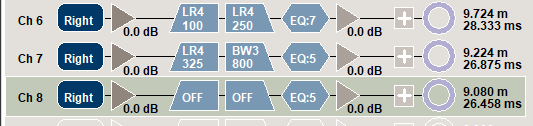

I can't cross much higher with the MF running out of puff pretty sharpish after 1000Hz.
BMS4550 at 1200Hz as you suggested knits well.

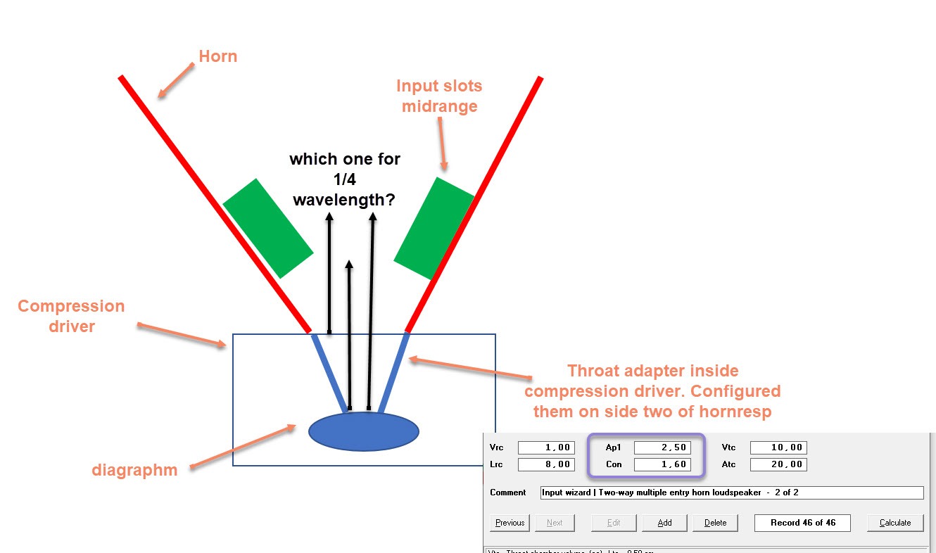

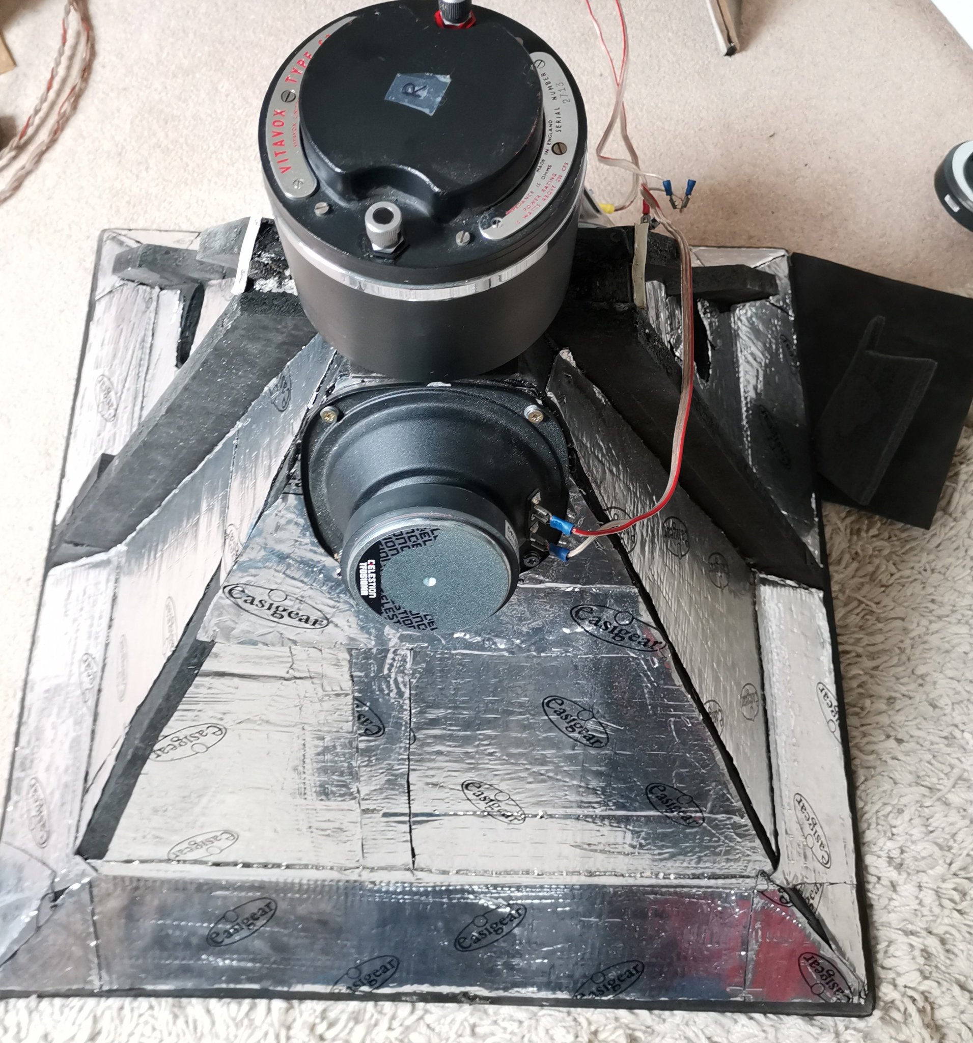

I'm of a mind to try the Vitavox S2s on the back of the SH50 alikes.
Mounting the CDs as close as possible to the MF drivers.
The horn throat can be adapted to add that 1/4" extra width either side.

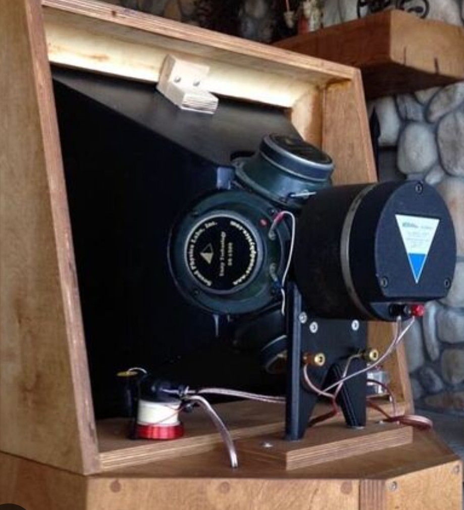

The S2s are pretty deep. Diaphragm near the rear.
However, then I read this
"It is my opinion that the 1/4 wave rule is not necessary and I believe that Tom's second patent removes it. One simply wants the drivers as close together and as far down the device as possible. Everything else is taken care of with EQ (to the extent that is possible.)" - gedlee
Source
https://www.diyaudio.com/community/...tanding-of-synergy-horns.309258/#post-5113817
How far does that rule bend?
Of course there is a picture of this.
Diaphragm well back from the CD exit.

I could also turn / make a throat adapter to refit the BMS4550s for my outdoor events..
I see from these older threads many have contributed who have helped me with this thread - excellent stuff.
So, would it work?

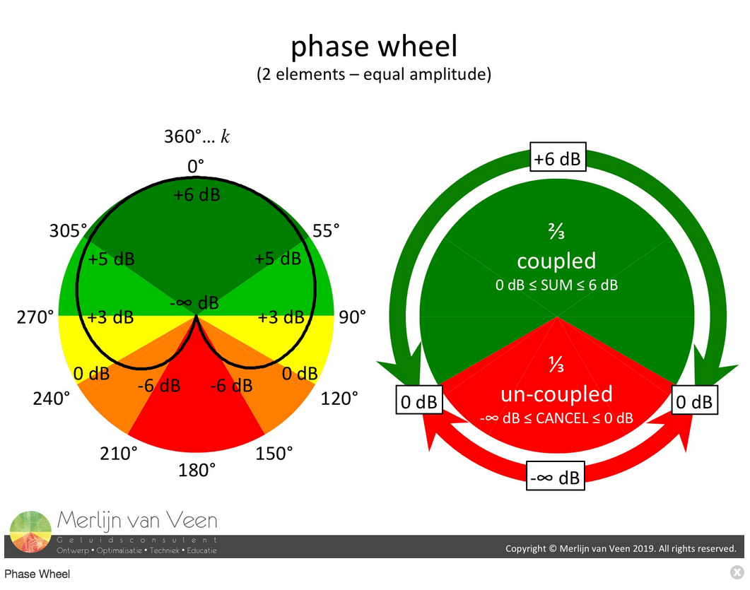

Short answer- assuming the S2 throat exit is not reduced, it will work fine on your MEH, but will require a different time/phase alignment and EQ than the BMS4550.
One quarter wavelength is a 90 degree phase difference.
Two elements at 90 degrees phase difference combine to +3dB, within 3dB of "perfect".
Close enough for rock and roll..
The closer to 0 degree phase difference, the better the acoustical summation.
While physically in front of the HF driver, the acoustical low pass of the cone mids through their exit ports may result in their output being in phase alignment with the HF driver.
The physical distance alone does not insure phase alignment within 90 degrees.
In combination with passive electrical filters (and polarity reversal if required) the outputs may be brought into phase alignment.
As has been pointed out previously in this thread, passive alignment (and adequate driver protection at high output) is complicated.
The HF to the MF virtual distance can be adjusted with digital delay to bring it to 0 degree phase difference for a +6dB summation.
The distance between the mid ports is fixed by the horn geometry, if they are not within ~1/4 wavelength distance apart relative to the horn axis, off axis cancellation will occur, and can not be changed with any filter type or delay.
This distance limitation can still allow central ports with small diameter mid cone drivers, but with larger drivers like the 8" in DSL's SH95, or the 15"s in EV's MTS series of MEH, requires the ports to be located on the throat side of the cone to be within 1/4 wavelength distance across the horn throat in the crossover region.
The low coax mid-high drivers in the EV MTS series are crossed over to the 15"s at ~450Hz.
1/4 wavelength of 450Hz is ~7.5".
The distance between the coax 15" exit ports and the coax drivers is around double that, near a half wavelength, 180 degrees, near total cancellation...
That "cancellation problem" is easily corrected with DSP.

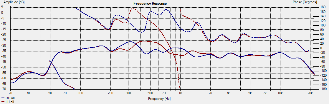

Interesting that Art would post that phase wheel.
To the OP ( @Speedysteve7 ): look at the top of that figure from 305 degrees to 55 degrees (i.e., ±55 degrees of phase). You'll notice that the output sums to 1 dB or less of the full 6 dB of overall boost in output for having two mostly in-phase sources playing in phase at the same frequency, and within 1/4 wavelength of each other.
My comment in another thread on the SH-50 about the loudspeaker w/passive crossover being "mostly linear phase" recognizes this fact. Once you're within something like ±90 degrees of phase (average across a particular passband), the human hearing system will pick this out as "linear phase". When you play complex waveforms of music with peaks in their output over time due to multiple frequencies being played at the same time (i.e., harmonics of the individual instruments/voices, and a summation of the different musical voices playing together at the same time produce periodic and asynchronous spikes in the time-domain output of the music that the human hearing system picks up--and the sensation that is heard is something called "clarity", i.e. (from slide 17 of Griesinger's "What is Clarity?"):
Below you will find an excerpt from one of Toole's JAES papers on the subject of inferring subjective fidelity from objective measures. The black lines represent the phase response of the best loudspeakers tested in that study from the mid 1980s (i.e., using only passive crossovers), and the red line represents the type of phase response which is easily achievable using DSP IIR filters only today, especially MEHs:
Now you can see the degree of phase distortion present is typically passive crossovers (yesteryear's and also today's passive crossover loudspeakers), as compared to the easily achievable phase response from a typical MEH. That's a huge difference--and one that's quite audible if you clean up the early reflections in-room.
So when you have a loudspeaker that has several hundred degrees of phase growth from high frequency to low frequency, (especially those crossover networks having higher order crossover filters)...the human hearing system perceives that as a loss of clarity...like having too many early reflections to muddle the direct arrivals) and a shift in timbre. And asynchronous spikes in the waveforms that were recorded faithfully by the recording microphone are now effectively wiped out due to the phase growth of the loudspeaker passive crossover networks alone.
This effect is the greater part of the reason why "Synergy Horns" (the trade name) --a particular type of MEH implementation which pays attention to minimizing phase growth--has such a following: a nearly linear phase combined with a fully horn-loaded loudspeaker having inaudible modulation distortion sidebands--even up to levels well above 100 dB/1m, and controlled directivity down to the room's Schroeder frequency.
So the threshold of phase swing audibility is something like (on the order of) ±90 phase swings. Any phase swings greater than this starts to become audible (just as Tom Danley himself has mentioned before). Less than ±90 degrees of local or full passband phase shift, and the phase distortion is essentially inaudible (IME).
Just gazing at a phase response waveform to guesstimate what amount of phase growth is audible or inaudible based on visually what the observer thinks might be audible with his/her eyes--this isn't the requirement. The threshold of audibility of phase distortion is what's important.

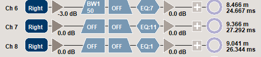

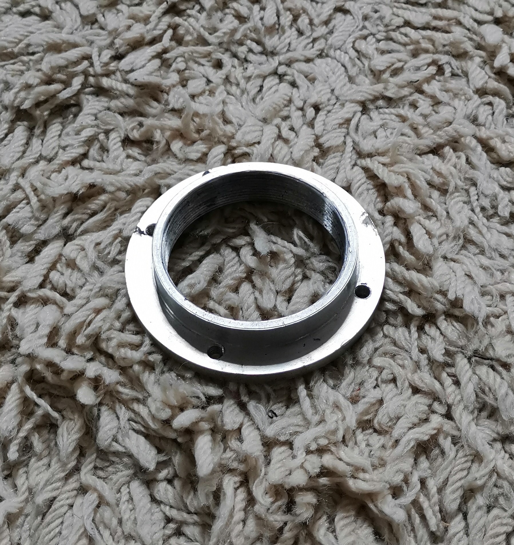

Assuming DSP time aligning can compensate for the extra distance, diaphragm to MF taps, this morning being perfect indoor weather, I cracked on and modded the horn throat to be a perfect 1.5" / 38.1mm.
Will be fitting the spare screw on ring adapters, I turned / thread cut ages a
go..

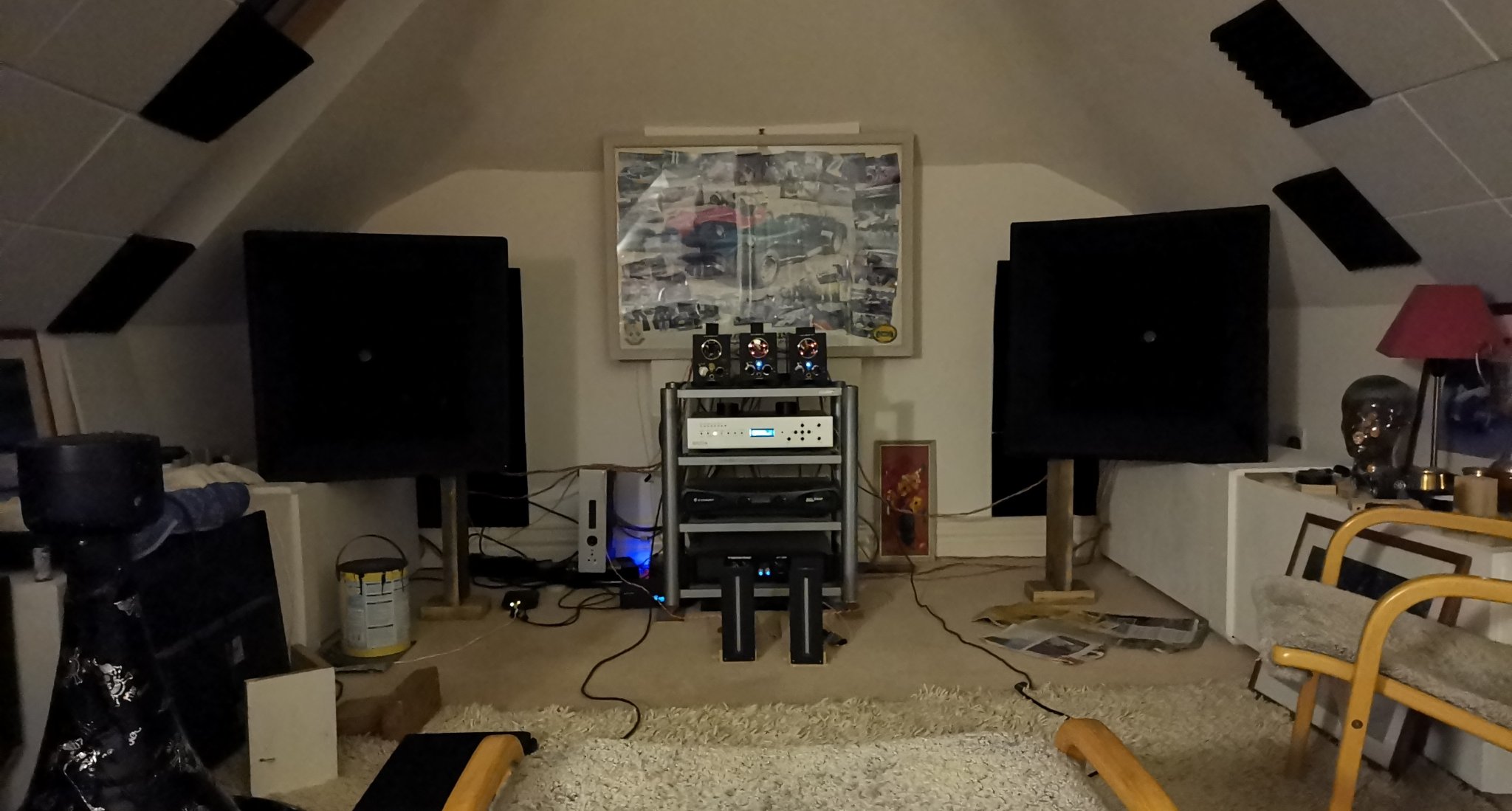

All done and set up pretty well!
It's like staring into the abyss with low evening lights.
Back up in the right position - to my ears.
I can report, there's absolutely nothing wrong with the Synergy / SH50 concept, design etc. I just had to use a HF driver I love the sound of.
I could hear their potential, hence sticking with them and trailing
I enlisted the help of wifey’s ears too.
She thought she loved the S2s on Le Cléac’h, the latest hybrid Le Cléac’h/Synergys were a hit with her!
However, hearing the Le Cléac’h side verses the Synergy with S2 side, it was not so clear.
The Synergy side made the Le Cléac’h side sound a bit congested and even dare I use that word, coloured!
More horn somehow!
The Synergy side was clearer, cleaner, more revealing, accurate and crisper.
Still had that richer 1.5" throat, 3" diaphragm CD tone though. Neat trick!
Now with both sides dialed in I'm born away!
Man these things can boogie too!
Thanks for all the help guys!
More horn somehow!

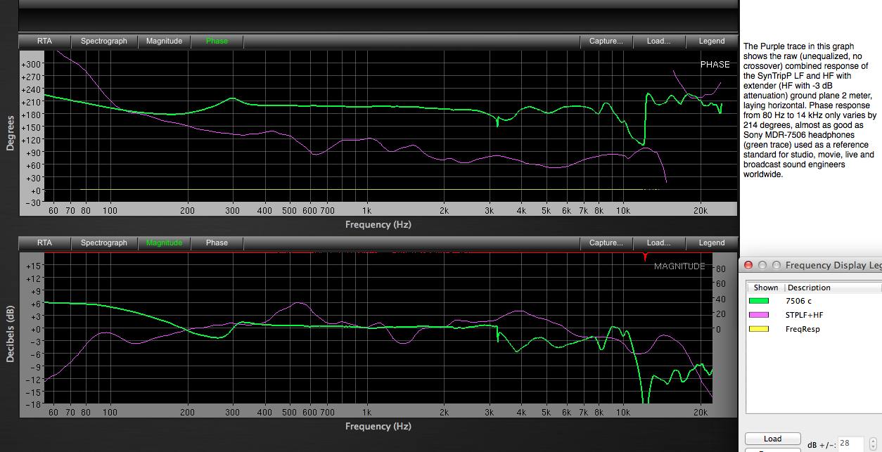

Just as a reference point, in the two-way MEH cabinets I built, the HF had to be delayed a fraction of a millisecond to line up it's phase response with the LF after using EQ and 24dB/octave electrical filters.
With no crossovers or processing at all, the combined raw response of the HF/LF phase varied by only ~50 degrees in the acoustical crossover region:
50 degrees is nothing compared to the ~180 degree phase inversion of the bass reflex port output

Here's the delays in Najda for trad'ish XOs
Here's what I have to do to get the LF in the phase ball park.

Did some playing around this afternoon.
As per advice above👍, I took off all the XOs (bar on the comp driver), removed all PEQs and ran the Freq / Phase.
This is with the time delays that work best, blue plot.. the LF being earlier than the others!🥴
Red plot was with the MF out of phase, just to see..
I then tried the LF where you'd expect it to be, about 30-40cm behind the rest.
Only ever got this.. and worse
Tried less delay and more delay, way in excess of what's reasonable, in fine resolution.
The only thing that gets me on the same graph (not wrapping around), is with the LF earlier as previous post above.
With the LF some 46cm in advance of the HF, I'm getting near - phase plot not wrapping around.

I've been throwing everything at this setup this evening.
It just sounds so good!
As if everything has snapped into focus!
The potential I has been realised.
All lower vocals are smooth and balanced, stunning insight into bass and mid bass detail. I could go on but I won't🙂
Thanks to @weltersys and @SpeakerBob for some wise insight that got me thinking along the right lines👍
