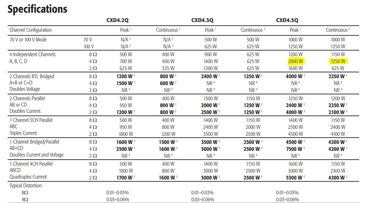

What amp is best to use on the MF cones? Hifi room setting.
I don't know for a hifi room setting....where I take it that means a very quite amp (fan-wise etc).
I se proaudio amps for all but the CD's (and sometimes for them too), and have reduced/abated fan noise, but it's still there.
My mids are four 16 ohm 4ndf34's in parallel for 4 ohm nominal. Which combined have a 800W program power rating.
Amp used is one channel of a QSC CXD4.5-Q. (and with both RMS and peak voltage limiting)
![amp for mids.JPG amp for mids.JPG](https://www.diyaudio.com/community/data/attachments/1204/1204099-d2e3274ac308f8ccb8a6b9ea7805e6be.jpg)

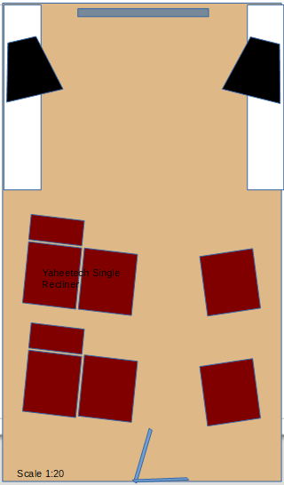

Room plan idea. 6 seater.
Eventuell centre and rears, not shown.
The white things are the tapped 😈
A low wide hifi equipment table also required.

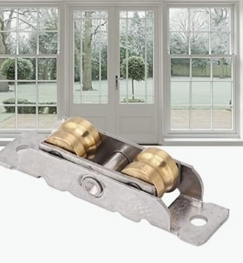

Today I made a track that 2 patio door runner wheels can glide in.
This allows me to lift the SH50 slightly off the support foot and elegantly slide them between the 2 positions.
