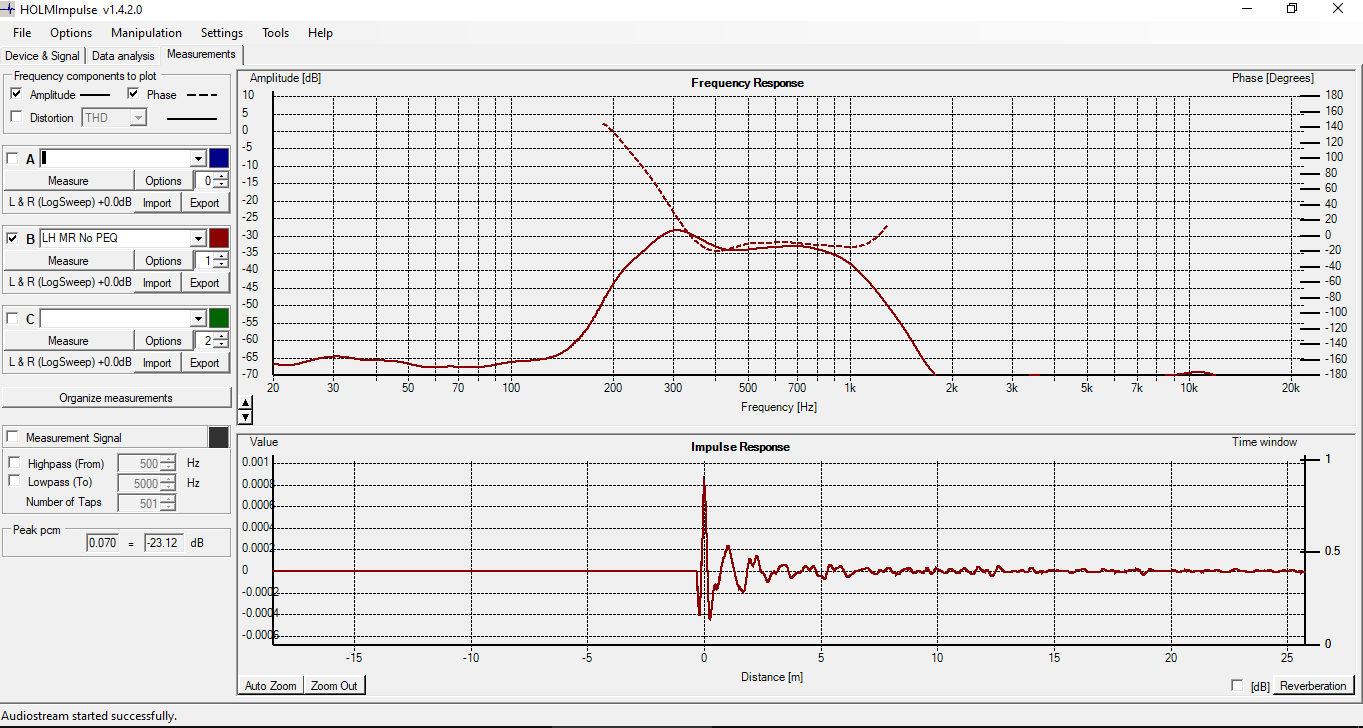

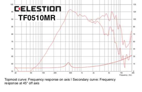

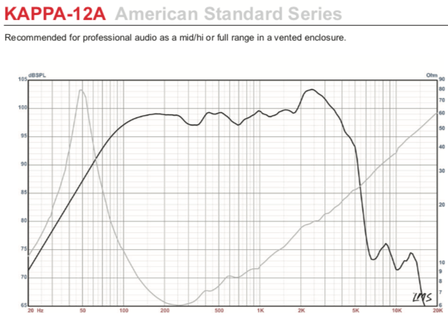

The Eminence Kappa 12-A LF on the MEH looks like it has a 2nd order acoustic bandpass LP at 500Hz, with its 2-4kHz frequencies "beaming" through the ports.
MF looks ~ 2nd order <320Hz HP (surprised it makes it that low) 4th order 1kHz acoustic bandpass LP, with upper frequencies leaking through the ports. Anywhere from ~320-500 Hz between the LF & MF should sound good.
Smooth response up to 1kHz, I'd suggest a electrical crossover in that range.
HF has a 4th order acoustic HP ~700Hz, plenty of overlap for a higher crossover point around the HF driver's 1kHz dip.
What distance where your measurements taken from the horn mouth?

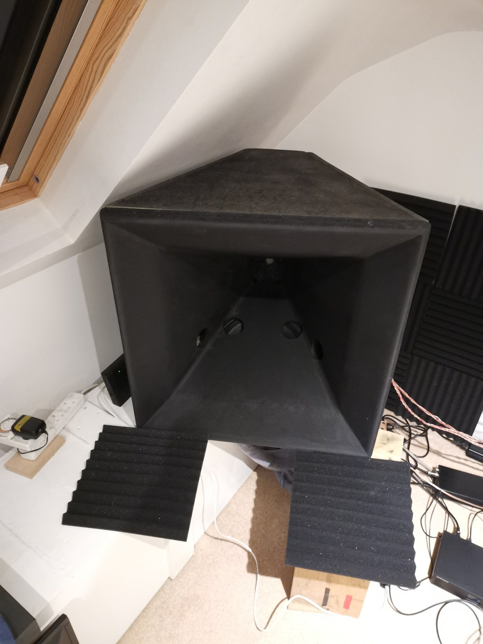

2nd completed today.
And lifted into place. Angled to the side wall, as per Danley wisdom

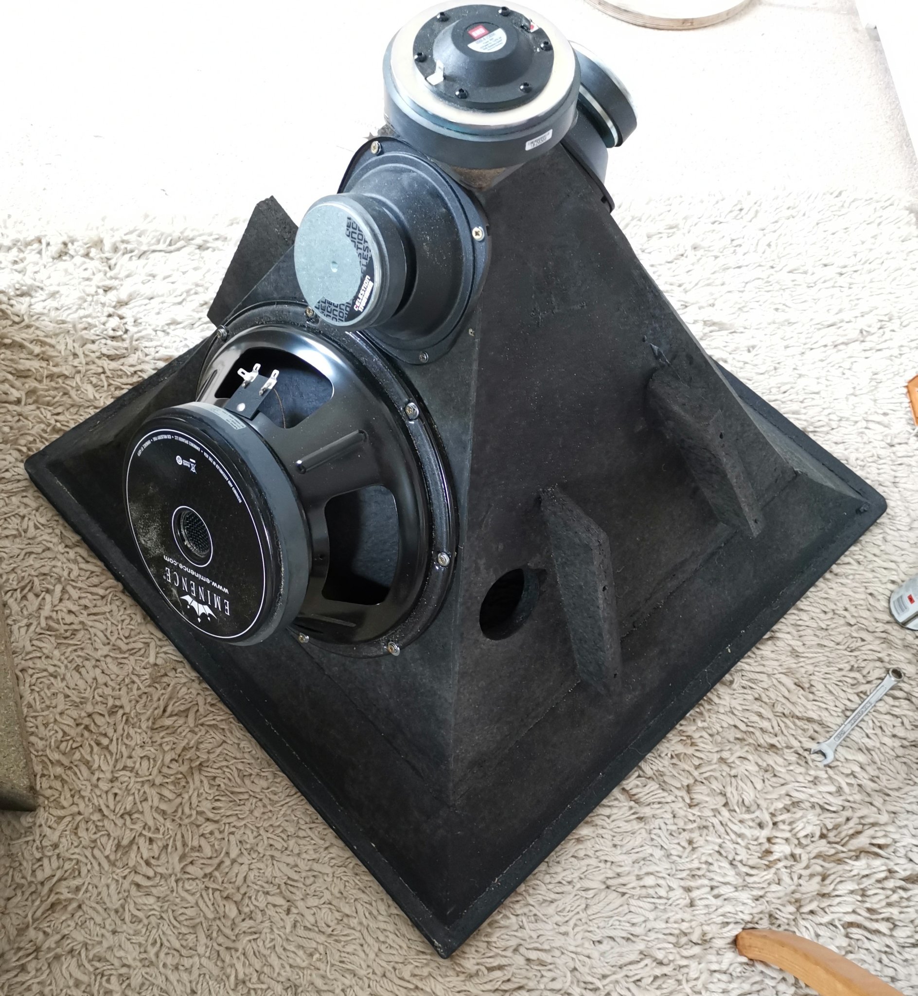

Did my driver checks as usual.
Wiring all okay.

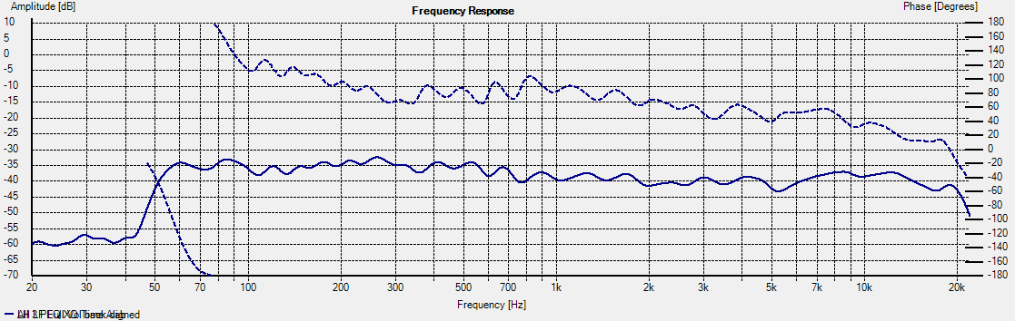

Ran some sweeps, all looked okay.

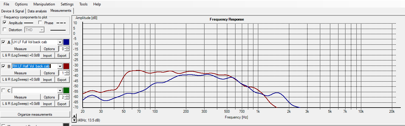

On this cab I decided not to do any dishing driver side of the MR taps.
Resulting sweep
No XO or PEQ. Forgot to click up to 1/6!
Plenty low!
I also made a full volume rear cab cover for this one.
This has double the volume of the first one I made.
Other thing I tried was omitting the sound deadening sheeting, just to see the difference.
LF was down on SPL!
Upped it on the amp.
The LF plot isn't quite as nice either
(Pretty sure the sound deadening isn't what giving me less SPL on bass only. Other thing is the bass drivers are fully run in of course).
Wiring all okay.
Resulting sweep
Plenty low!
LF was down on SPL!

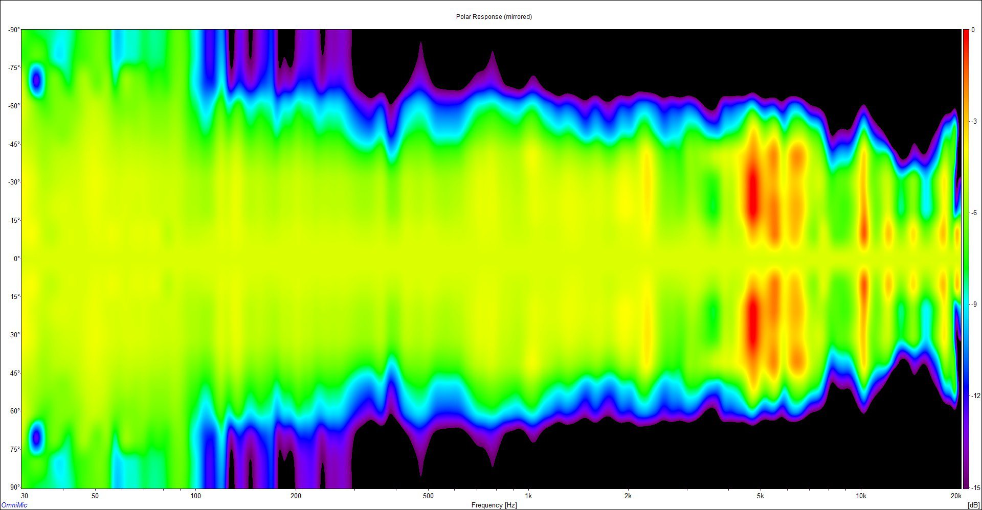

If you have a polar sonogram of the Le Cleac'h horn vs. the straight-sided MEH, I think you will see the difference in coverage response that likely gives rise to the subjective listening sound quality difference.If you could some how put that Vitavox S2 / Le Cleach horn sound inside the SH50 it would tick many boxes!
Since I can cursorily find no polar sonogram plots of the Le Cleac'h horns, I can't help you very much on that subject. (JMLC himself told me before his sudden passing that this was the biggest single difference in acoustic performance of his horn designs vs. "North American" horn designs having consistent off-axis response.)
But you can take the off-axis measurements of the two horns/compression drivers to produce a polar sonogram using something like OmniMic or similar app to produce the polar a polar sonogram of the Le Cleac'h horn/S2 combination from multiple off-axis measurements of increasing angles (e.g., 10 degree increments). Unfortunately, this is best done outside in order to avoid in-room reflections.

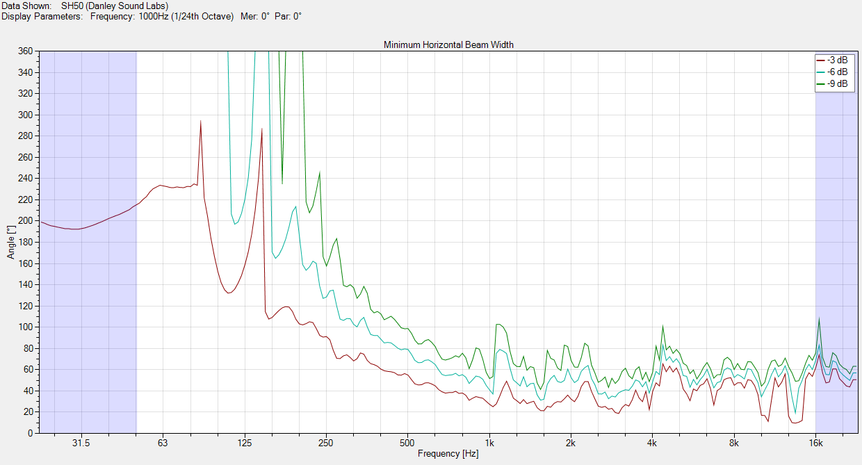

My biggest gripe with the SH-50 is that its polar coverage angle is far too narrow, leading to a subjective "hole" in the phantom stereo image when you move your head left or right from the symmetrical stereo axis pair in-room. I find that I would need two SH-50s side-by-side in each loudspeaker position to get the 90-100 degrees of horizontal polar coverage in-room that, to me, sounds correct. YMMV. That's why I used the K-402 horn for the K-402-MEH design. The following polar sonogram was made from data measured in my back yard using a spare K-69-A driver I had on-hand at that time (2015). The -6 dB polar response is in light blue color:
Here is a SH-50 polar plot (horizontal beamwidth) pulled from an EASE data file provided by Danley Sound Labs, for reference:
Chris

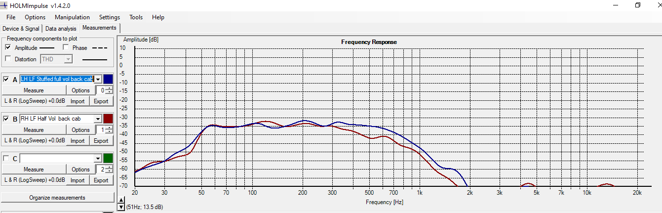

Meanwhile, I took some LF sweeps in the cold light of day!
I was tired last night, I Def heard this today😂
This (blue plot) is what double the volume of back cab does to the low freq resp!
I'll be adjusting this PDQ!

I've since followed advice and raised the HP X/O on the HF.
Took the back of the full rear cab.
Filled the driverless half with study IKEA zip bags I'd stuffed with needles felt.
Had a measure. That's better. Love it when a plan comes together.
