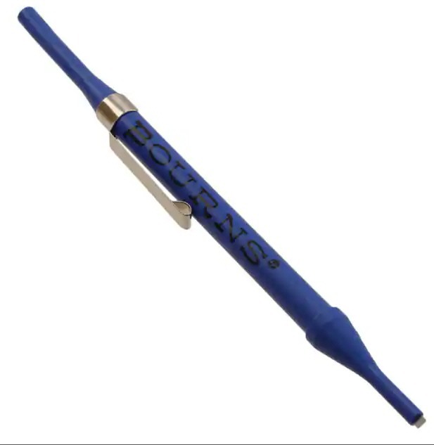

Nervous builders may want to insulate the metal shaft of their screwdriver with blue painter's tape, all but the last 1 cm of the blade, so that any accidental touches between the screwdriver and the circuit, don't create a short. Or use an all-plastic screwdriver. Or perhaps a Bourns H-90 (sales link) purpose-made adjustment tool -- AFTER removing the metal clip that holds it in your shirt pocket.
None of this is strictly necessary, as Kevin's video proves conclusively. But if you want a little bit more peace of mind, why not?
