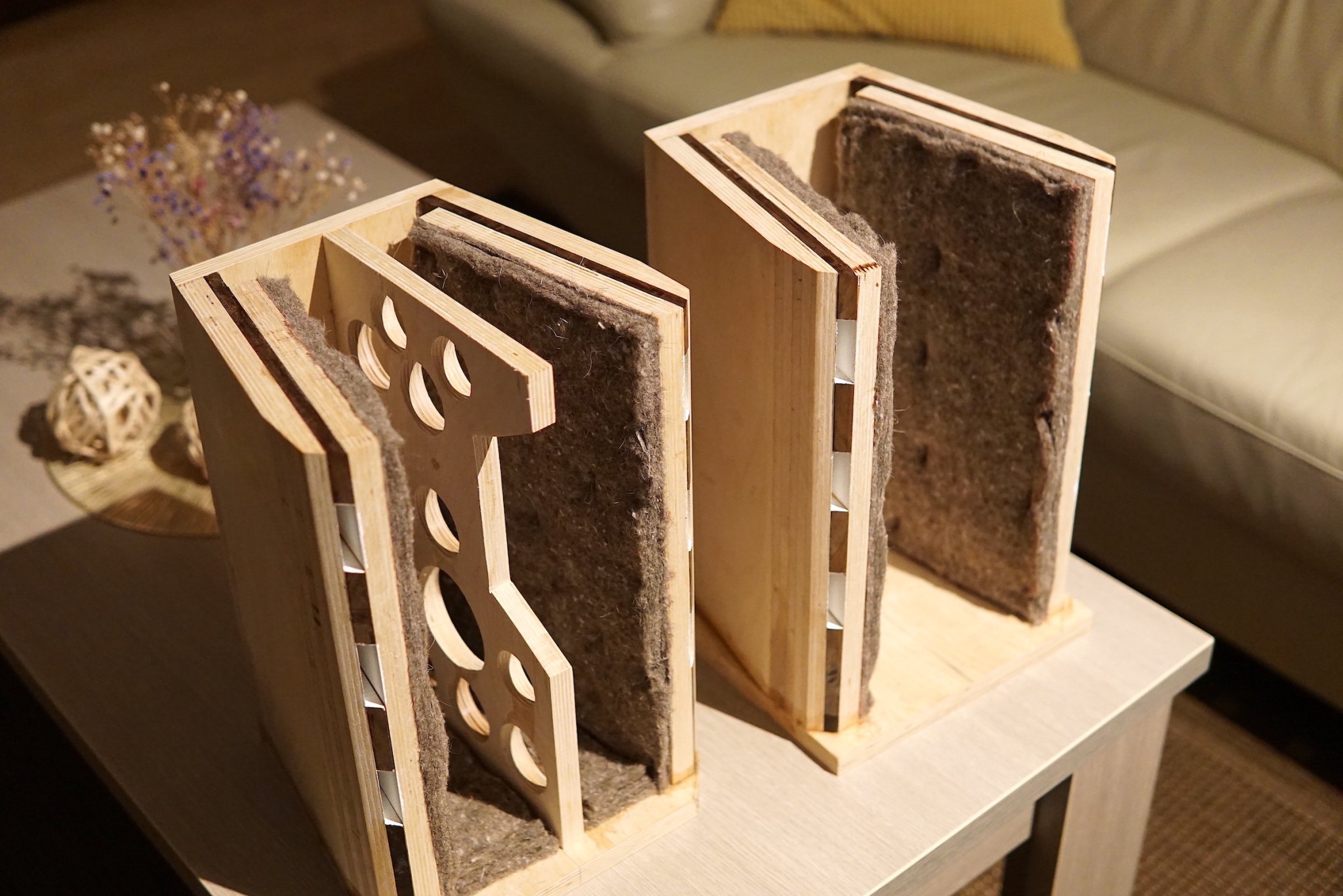

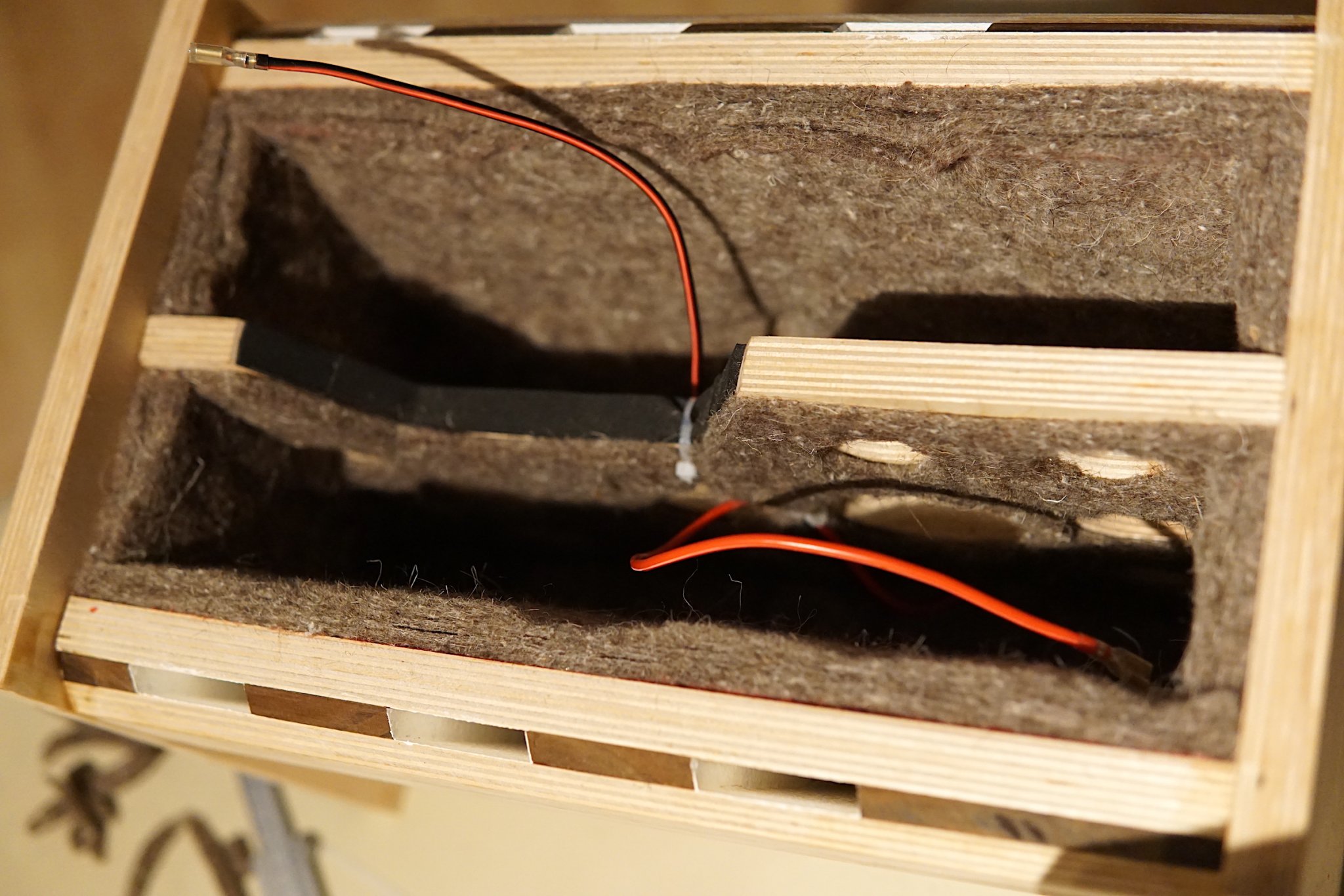

Update. Bumped the acoustic stuff to 65g. 5 g at a time. Actually helped damp bass and tame the room modes.I put about 50 g of Acousta stuff in the front. i’m going to bump that up, but I don’t think this will be enough to correct for the room nodes.

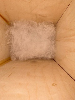

I set speaker on its head on a carpeted floor and methodically dropped tiny wisps of angel hair like bits of acoustastuff into rear slot while giving the speaker a shake and tilting it side to side back to front. Then gently tamped down with a washer on a string. Took photos with cell phone as I went to monitor progress.
Wide angle. Stuffing is about 9-10 inches “below” (speaker upside down) rear slot.
If you’re in a small room, I’d recommend starting with 50 and then add 5 g at a time until happy.

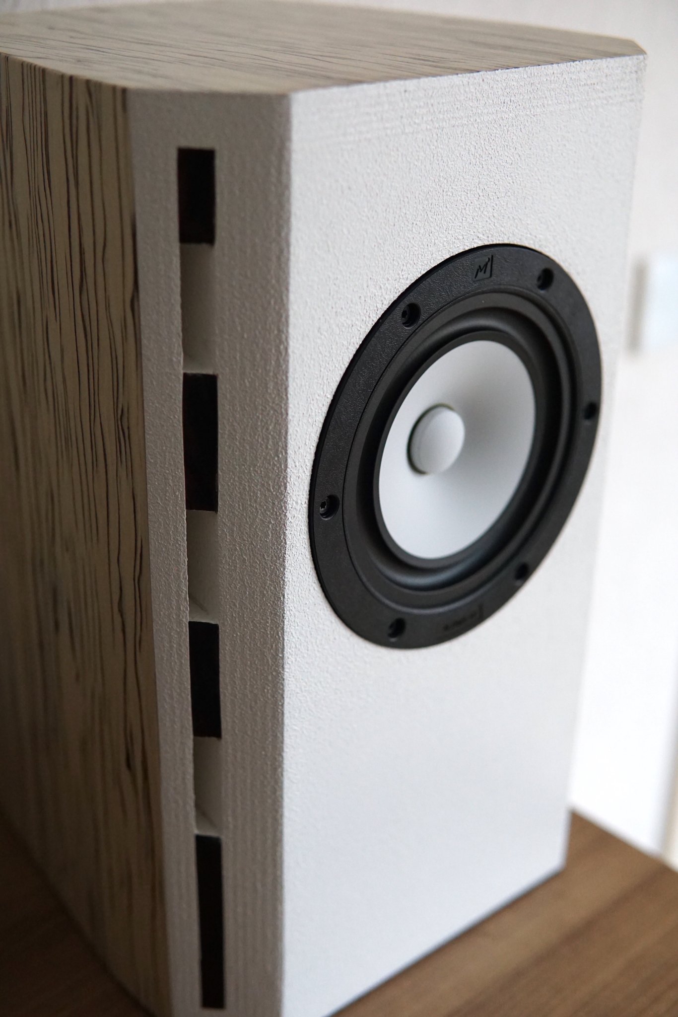

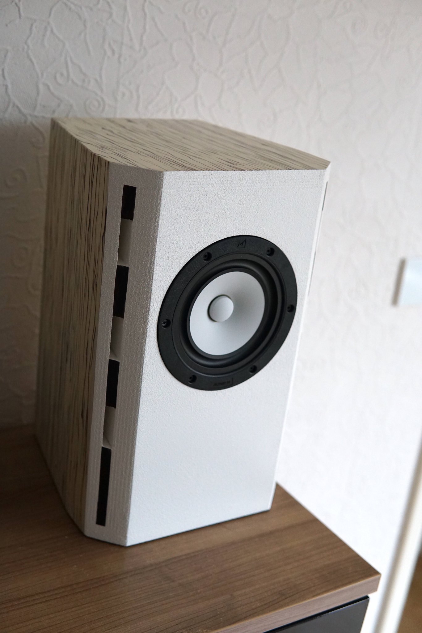

My Mar-KenM10.2T is ready 🙂

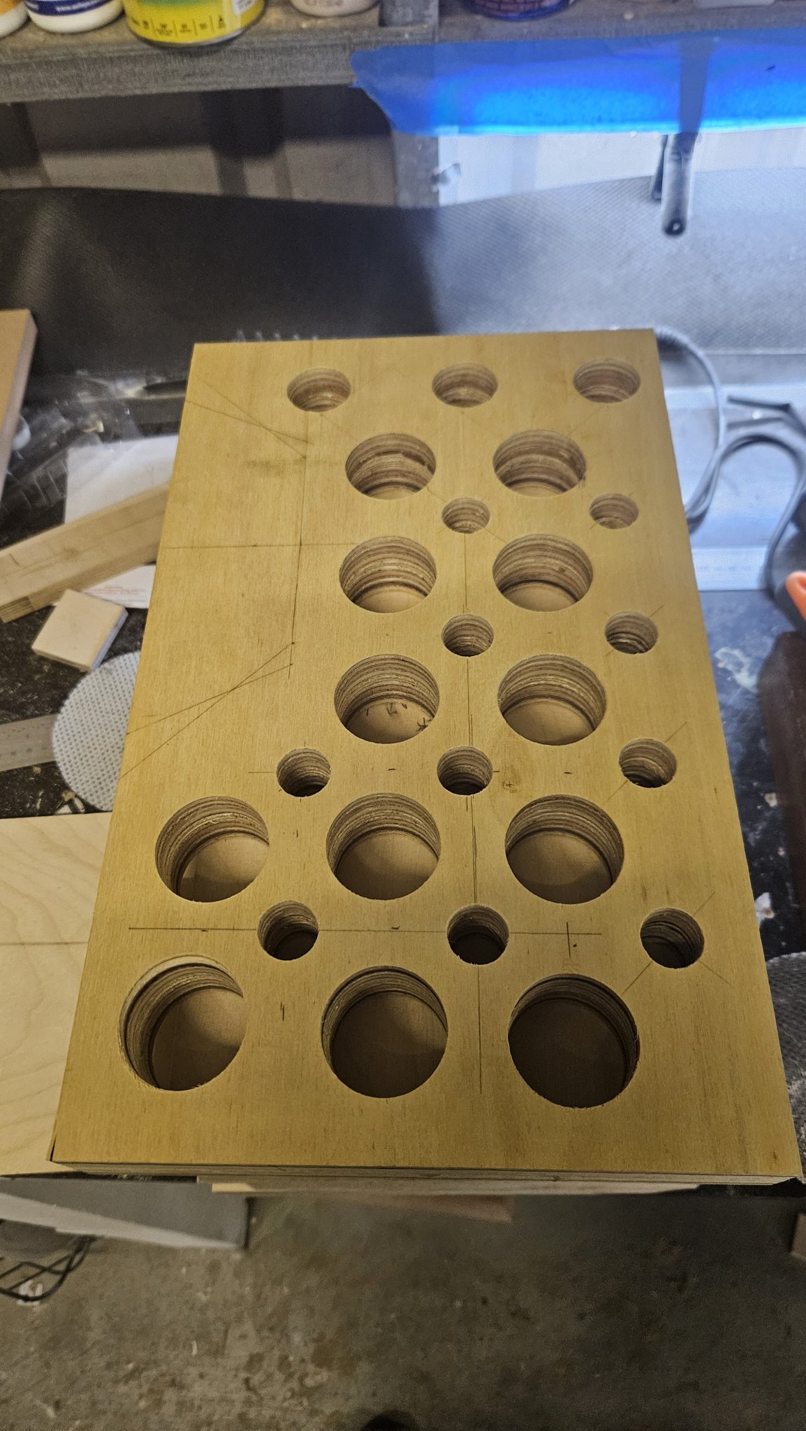

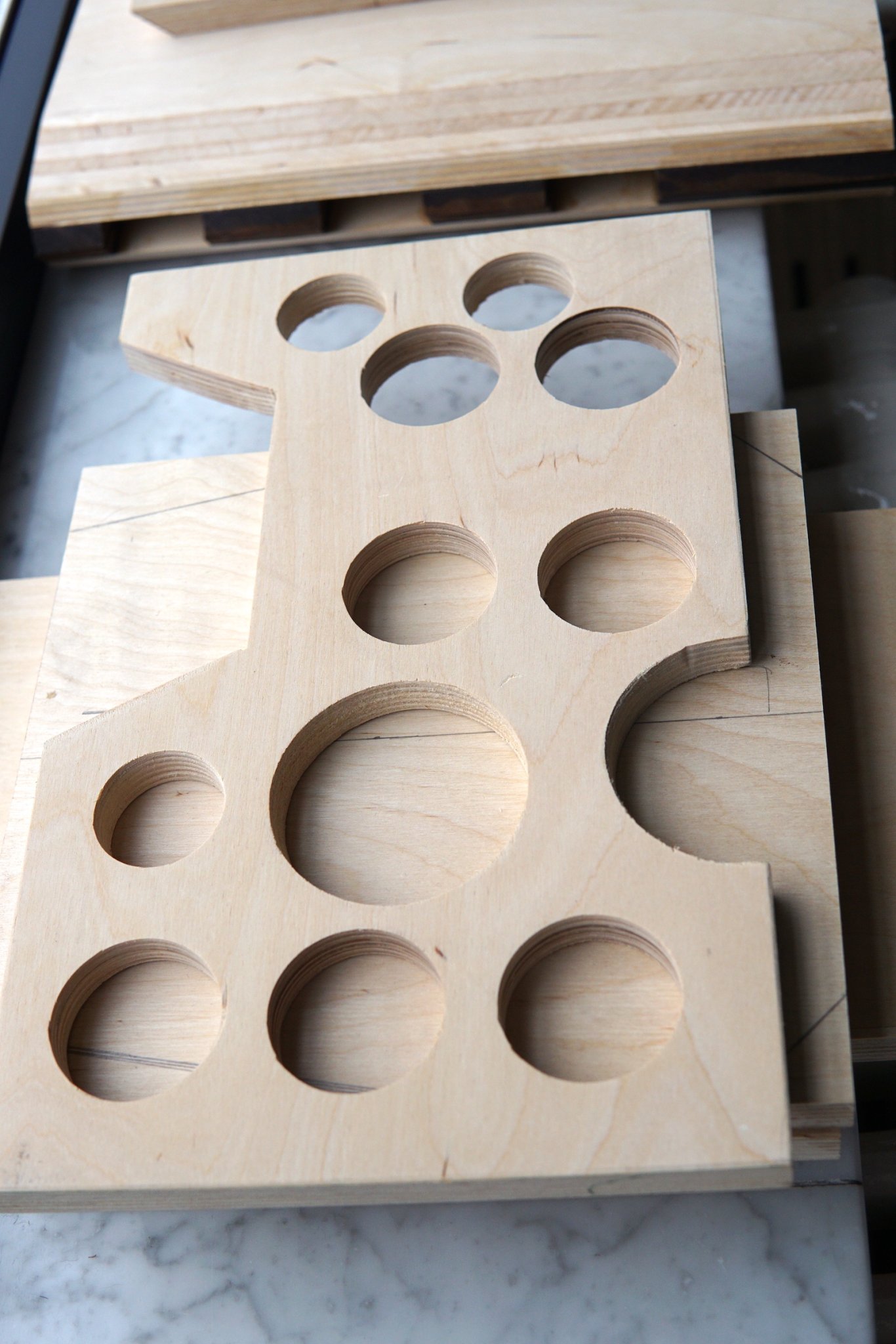

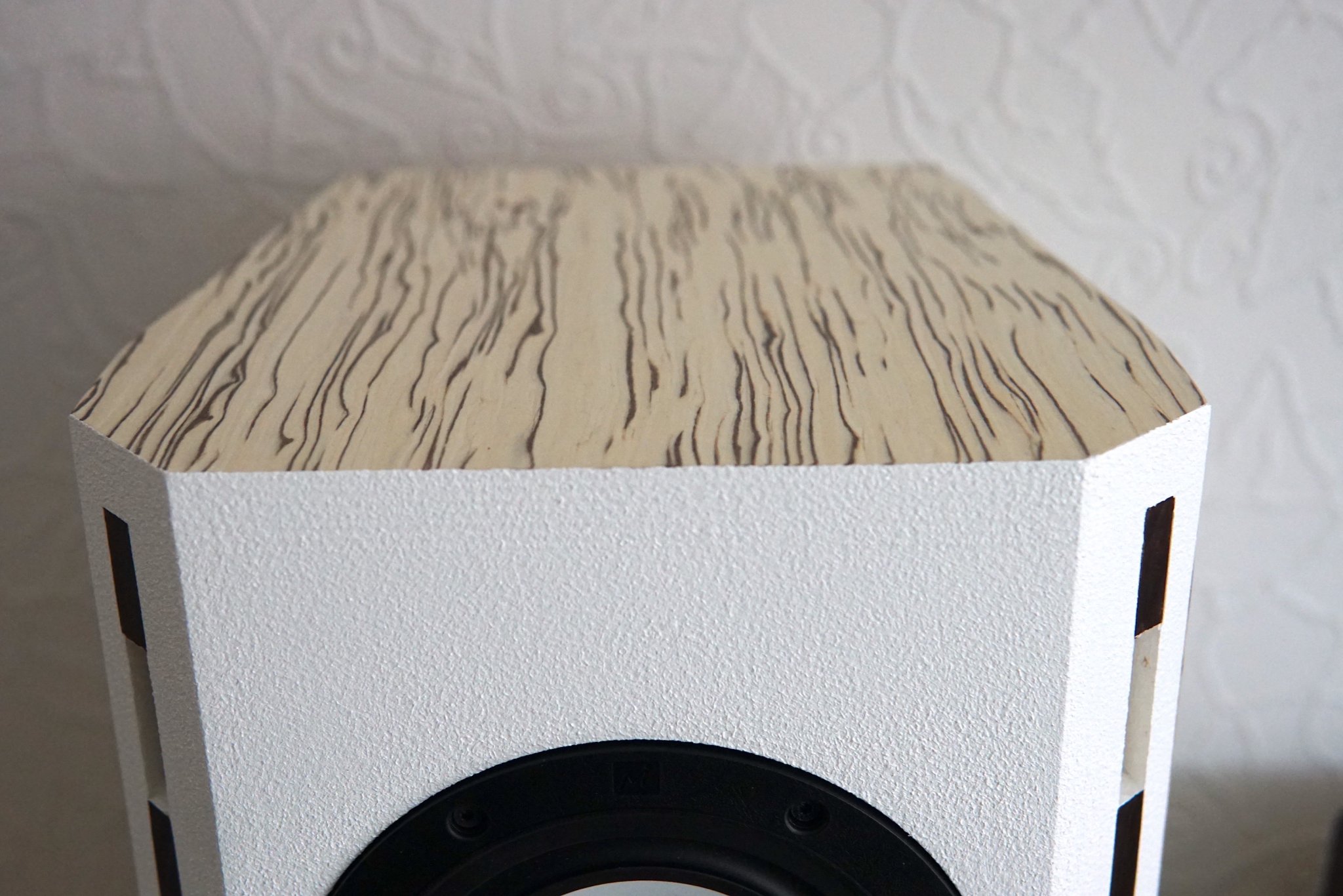

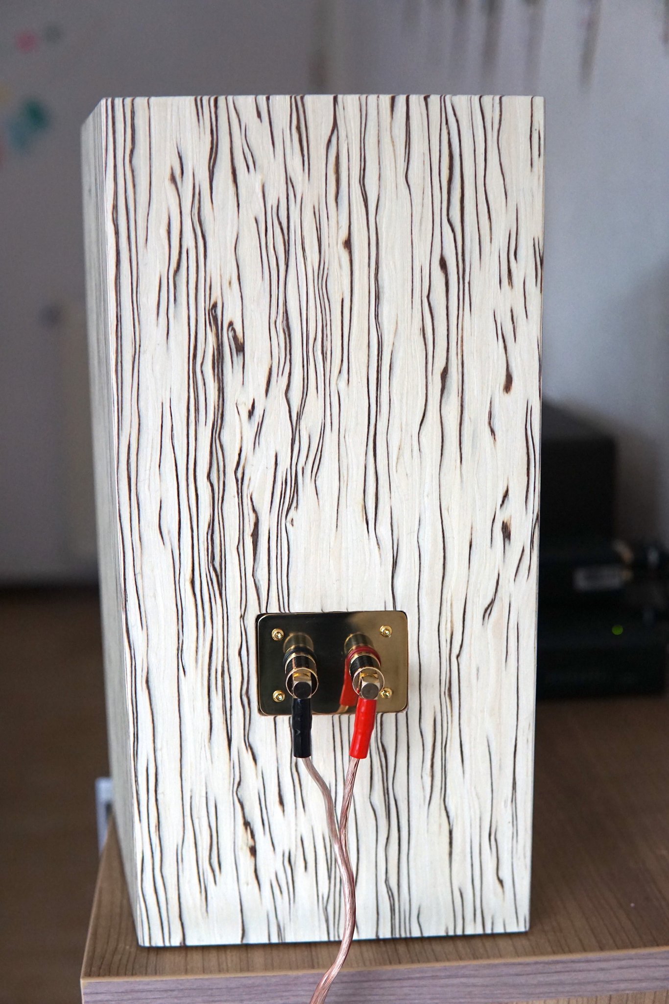

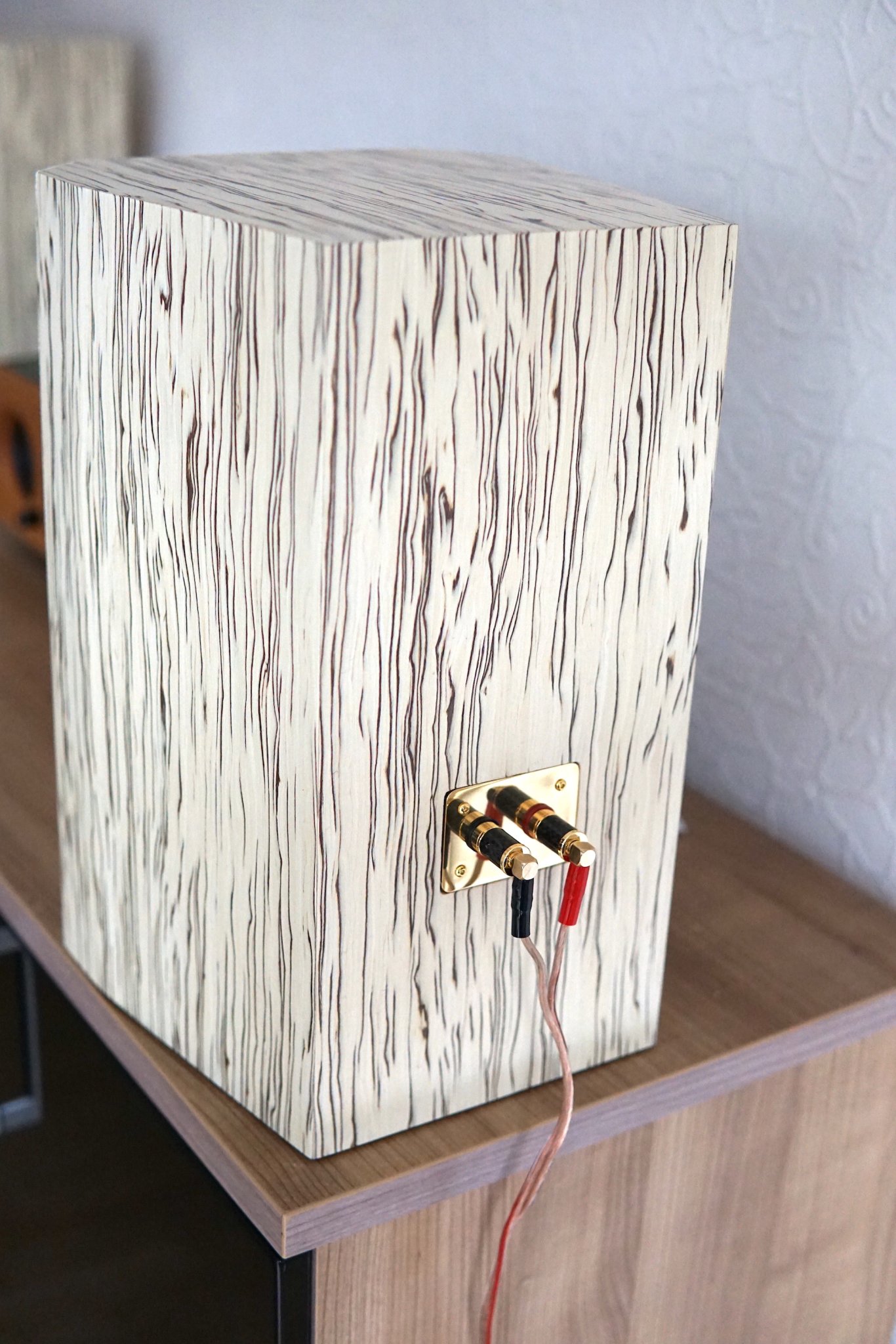

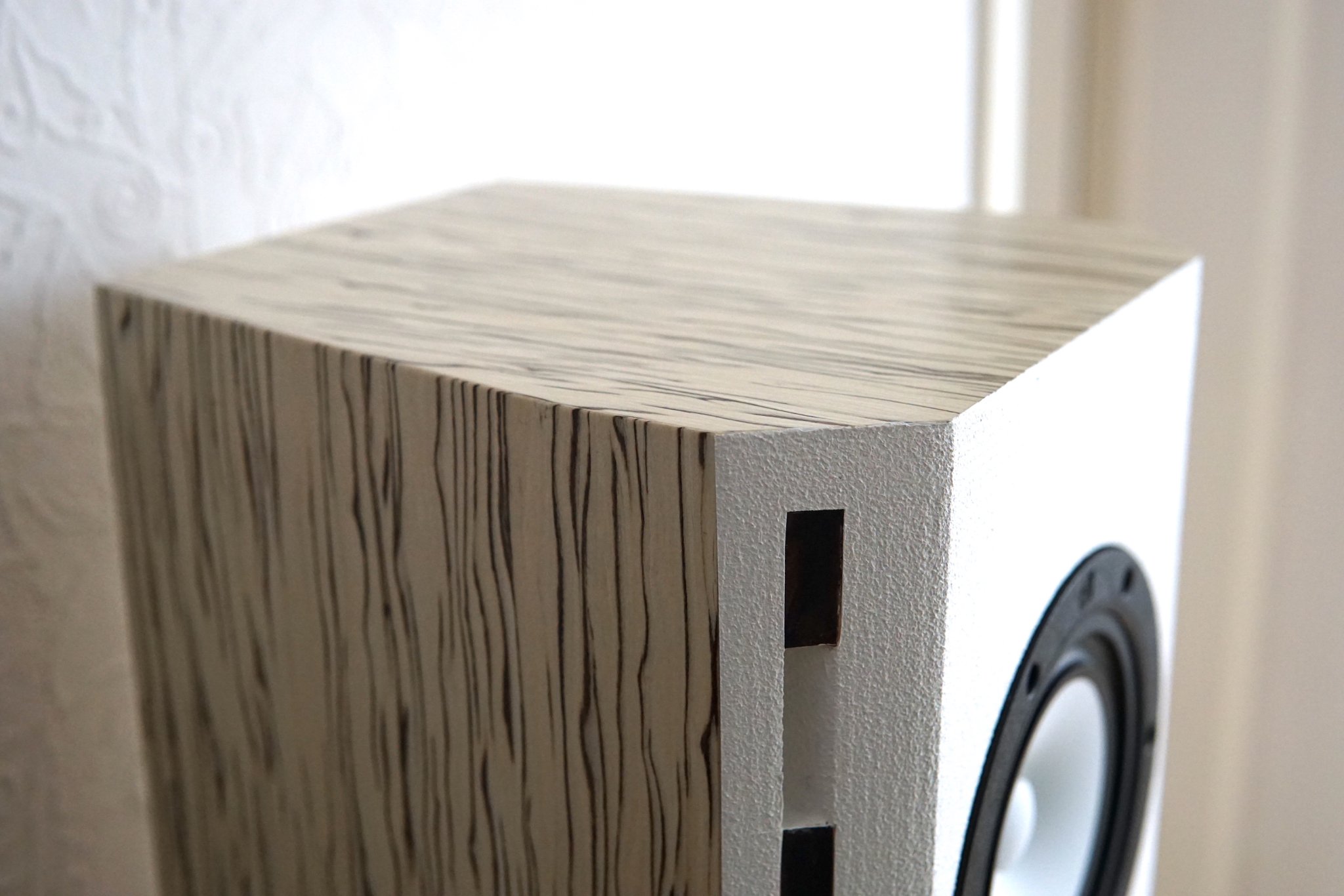

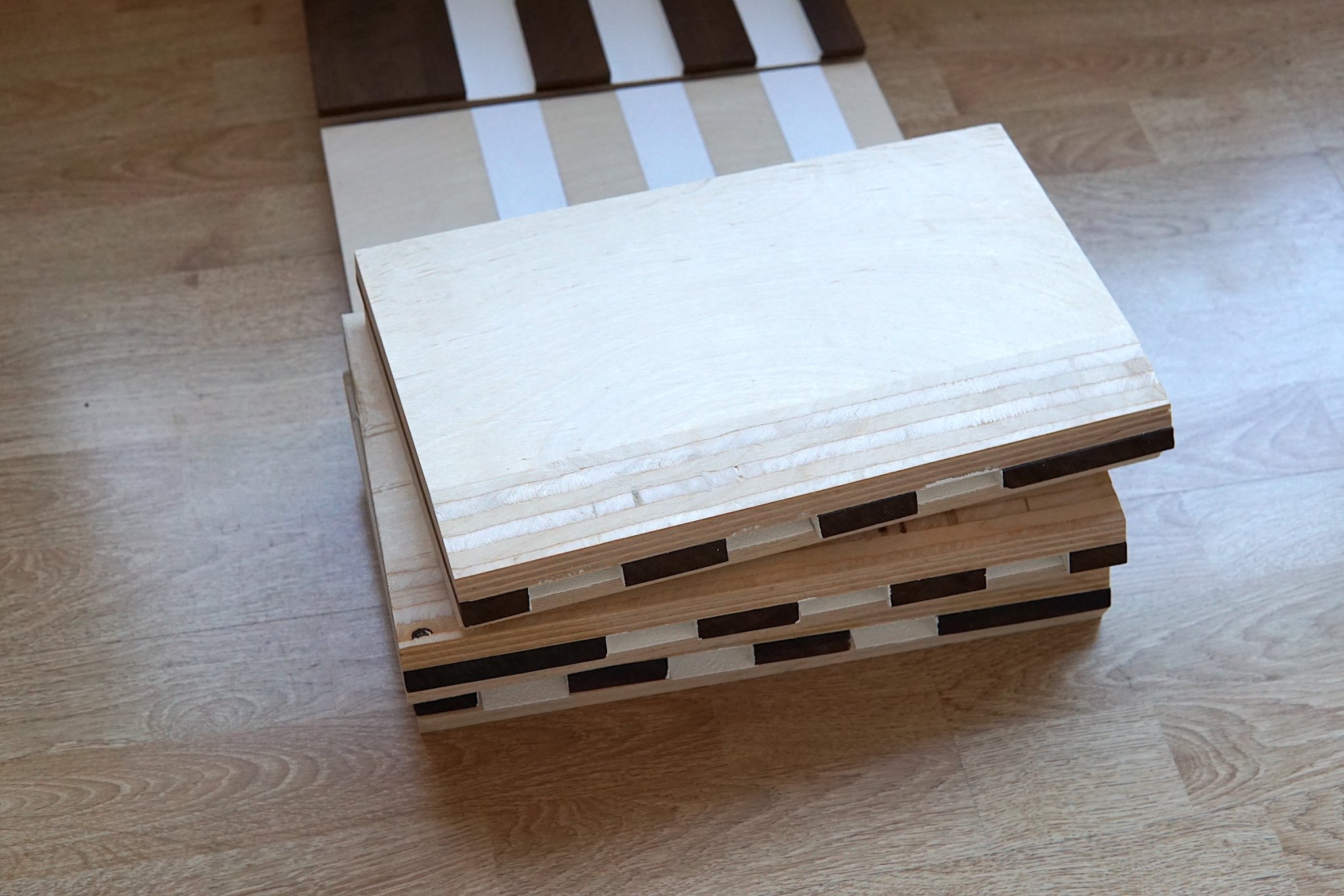

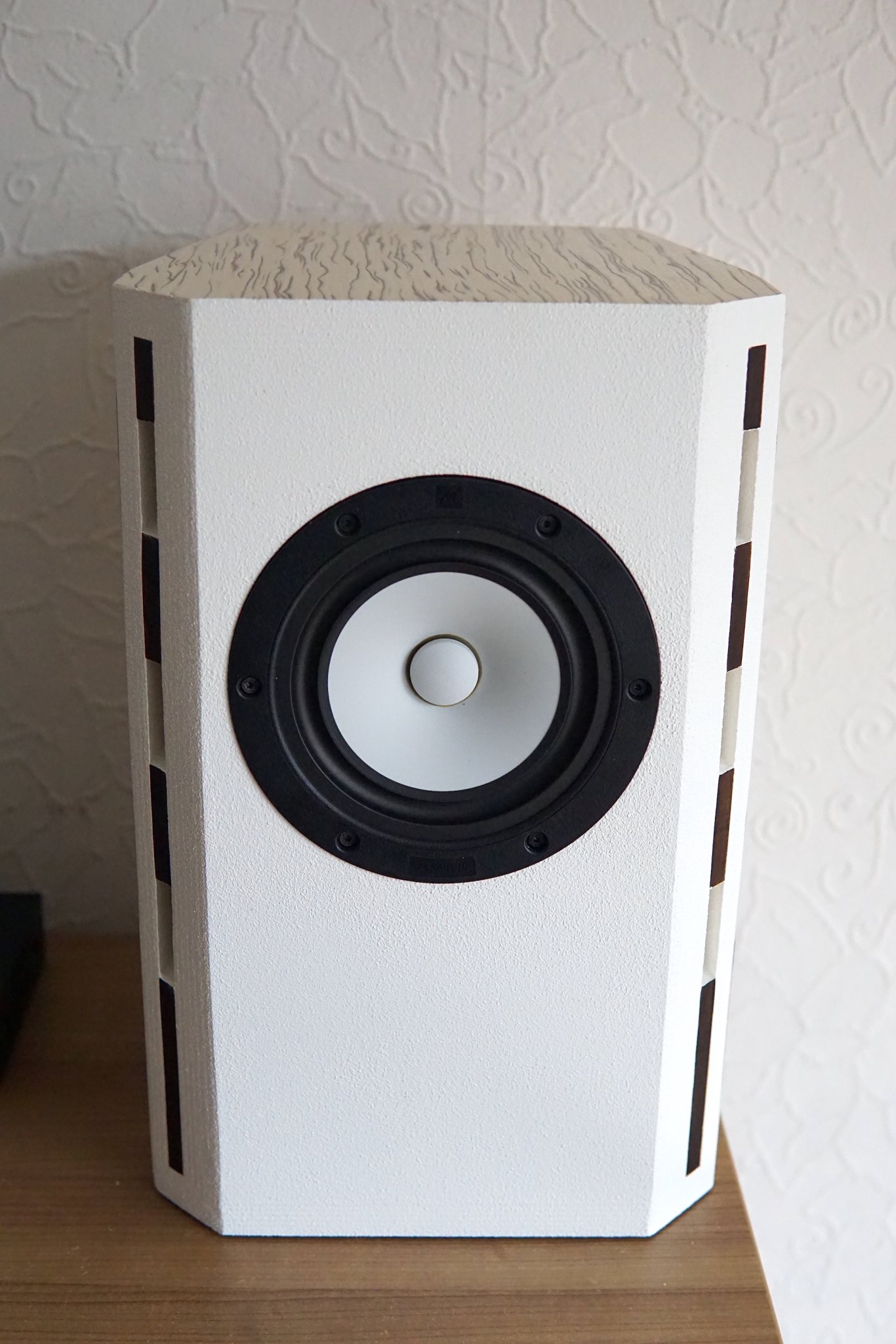

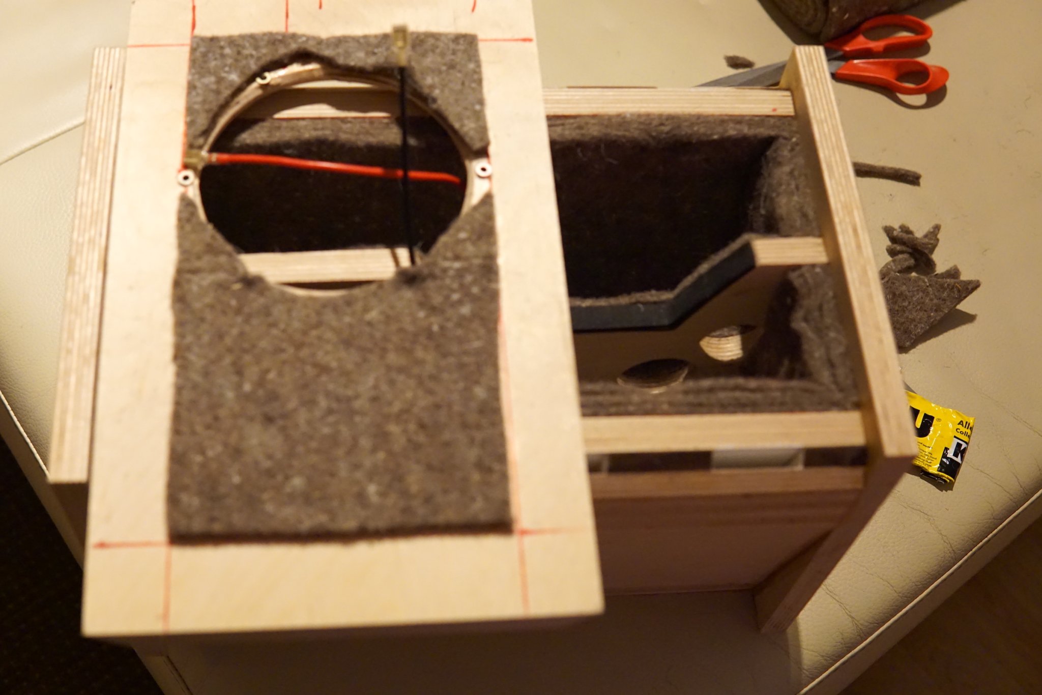

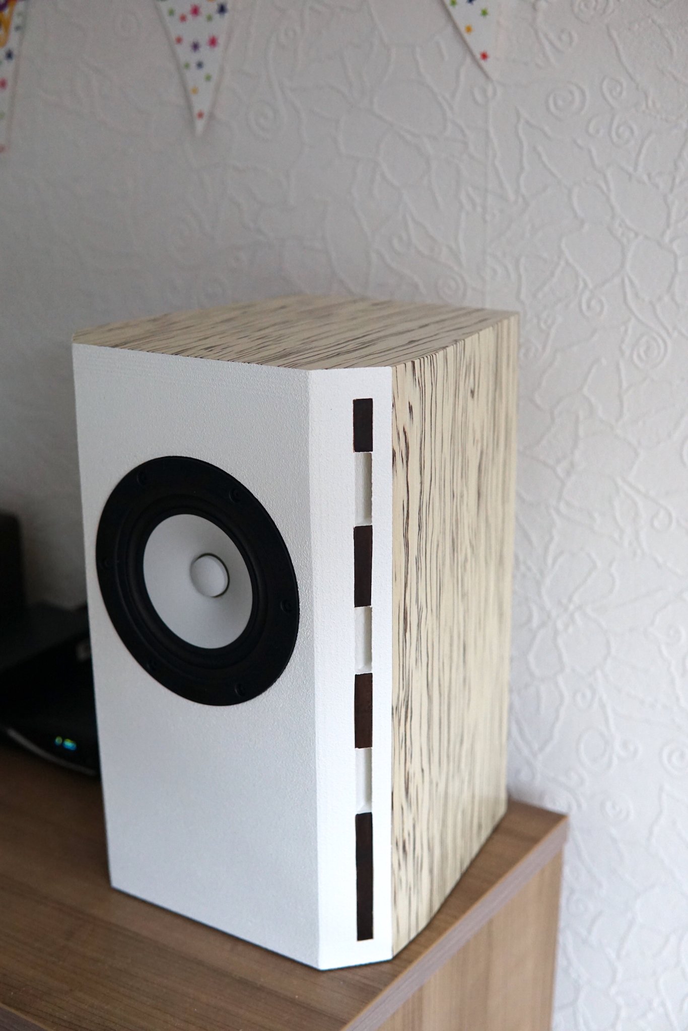

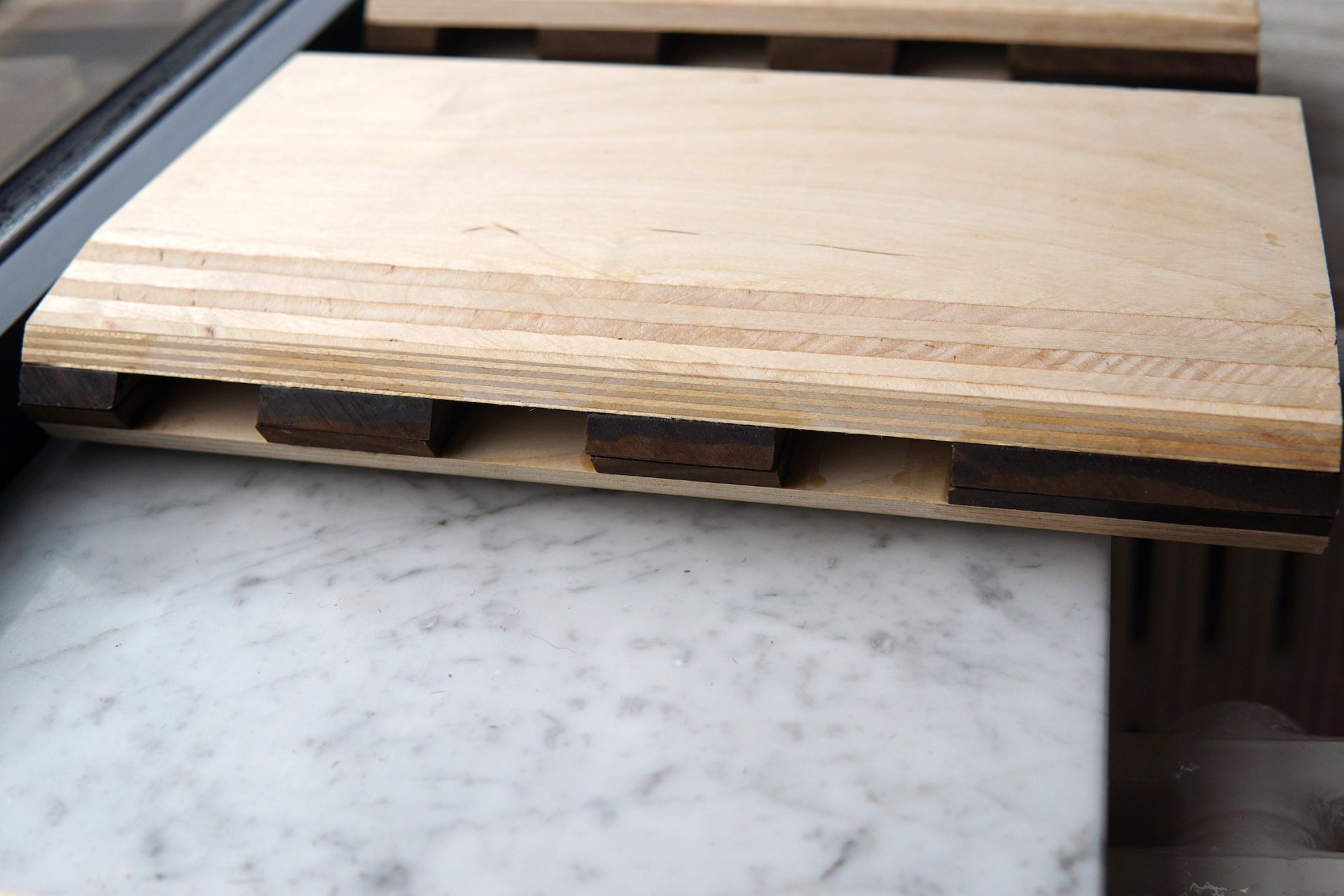

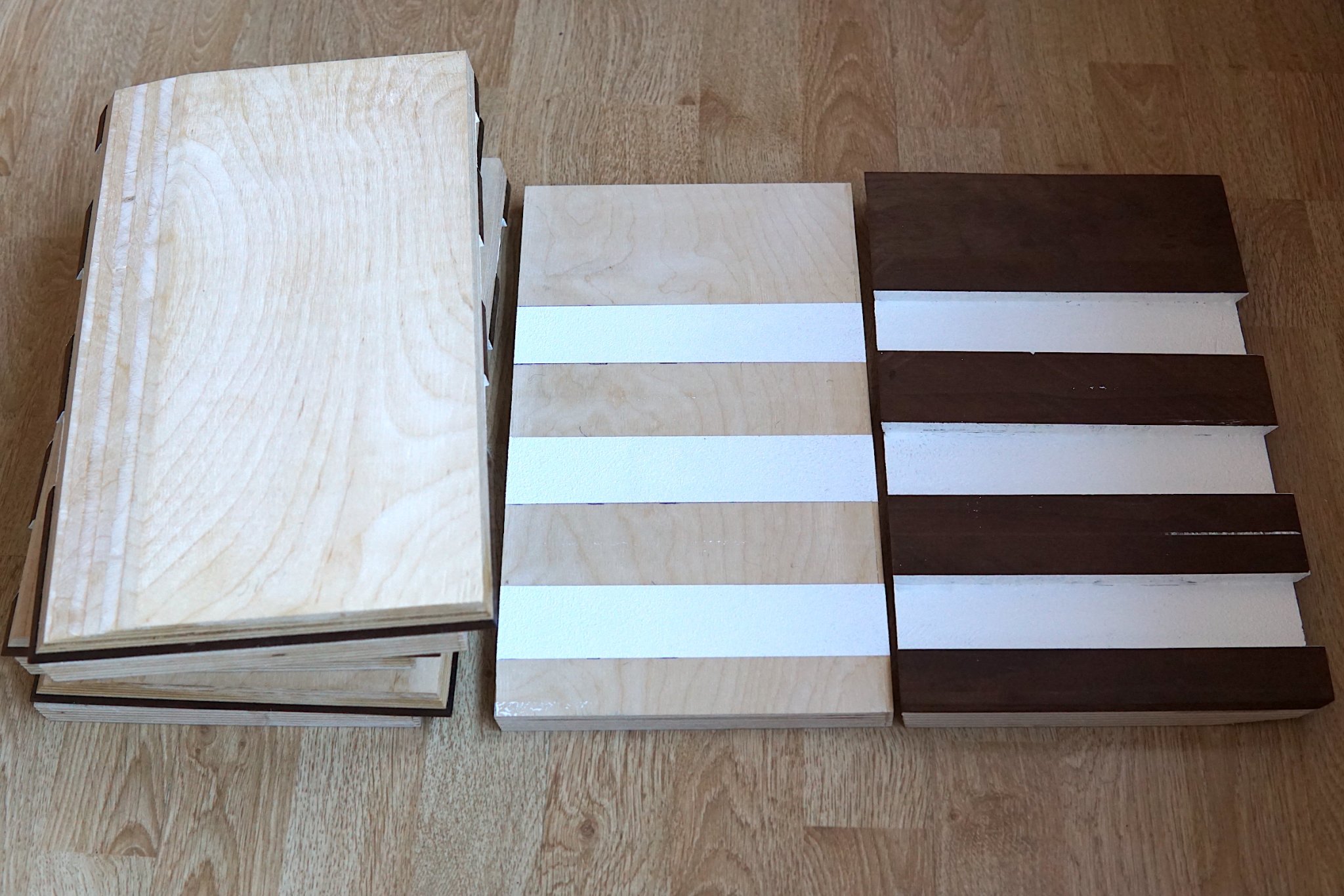

Thank you Dave for your plans. It was not easy to realize, but I did it with joy. Here are some photos of the workflow and the finishing result. After 100 hours it will be possible to say exactly how they play. I listen to the "Last Testament" of Dan McCafferty at low volume, impressions are beautiful.

Awesome job!!!! I'm sure they sound as good as they look.
This build is so tempting, especially when I see such a fine example of it.
I love the textured paint + veneer. Lovely build.

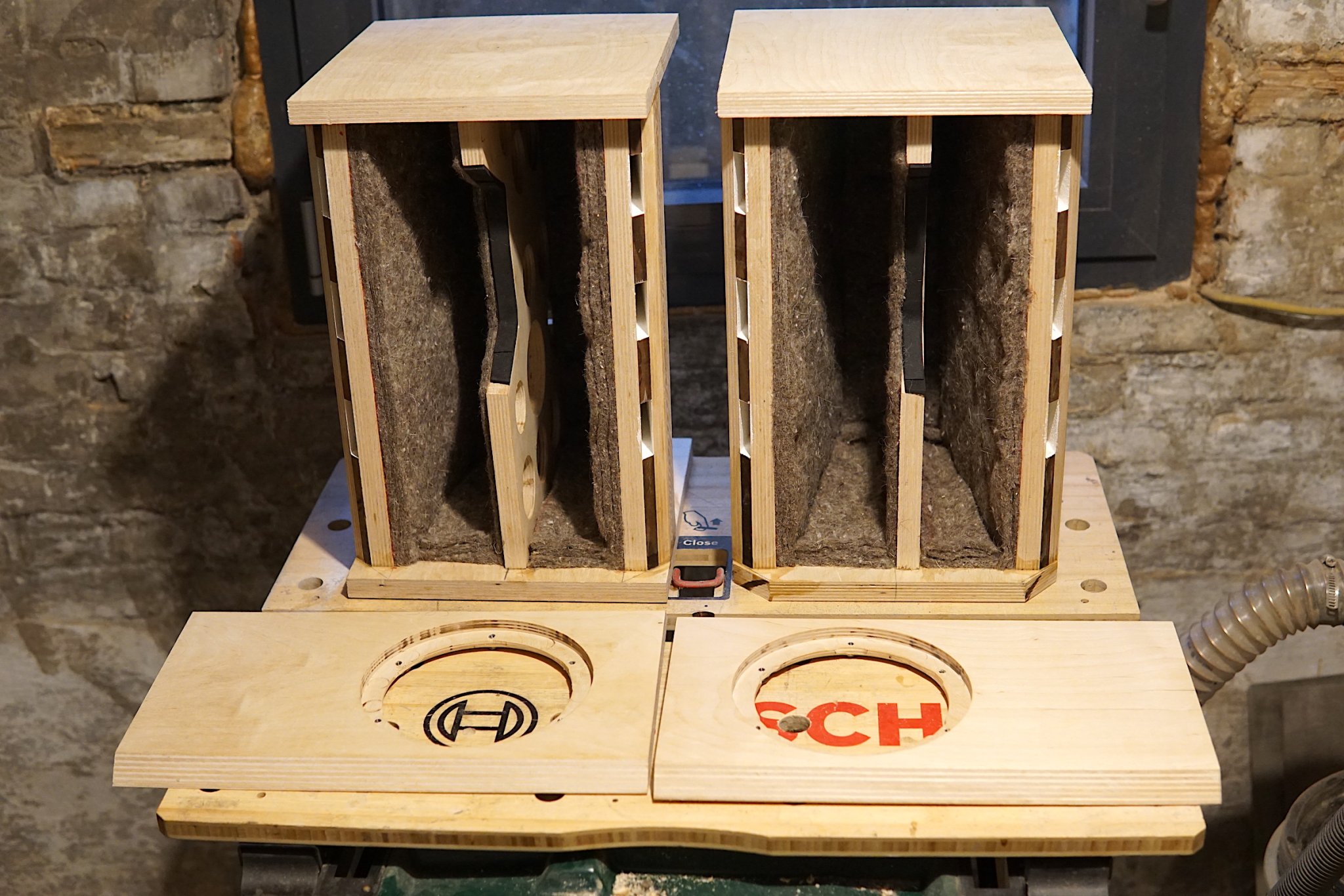

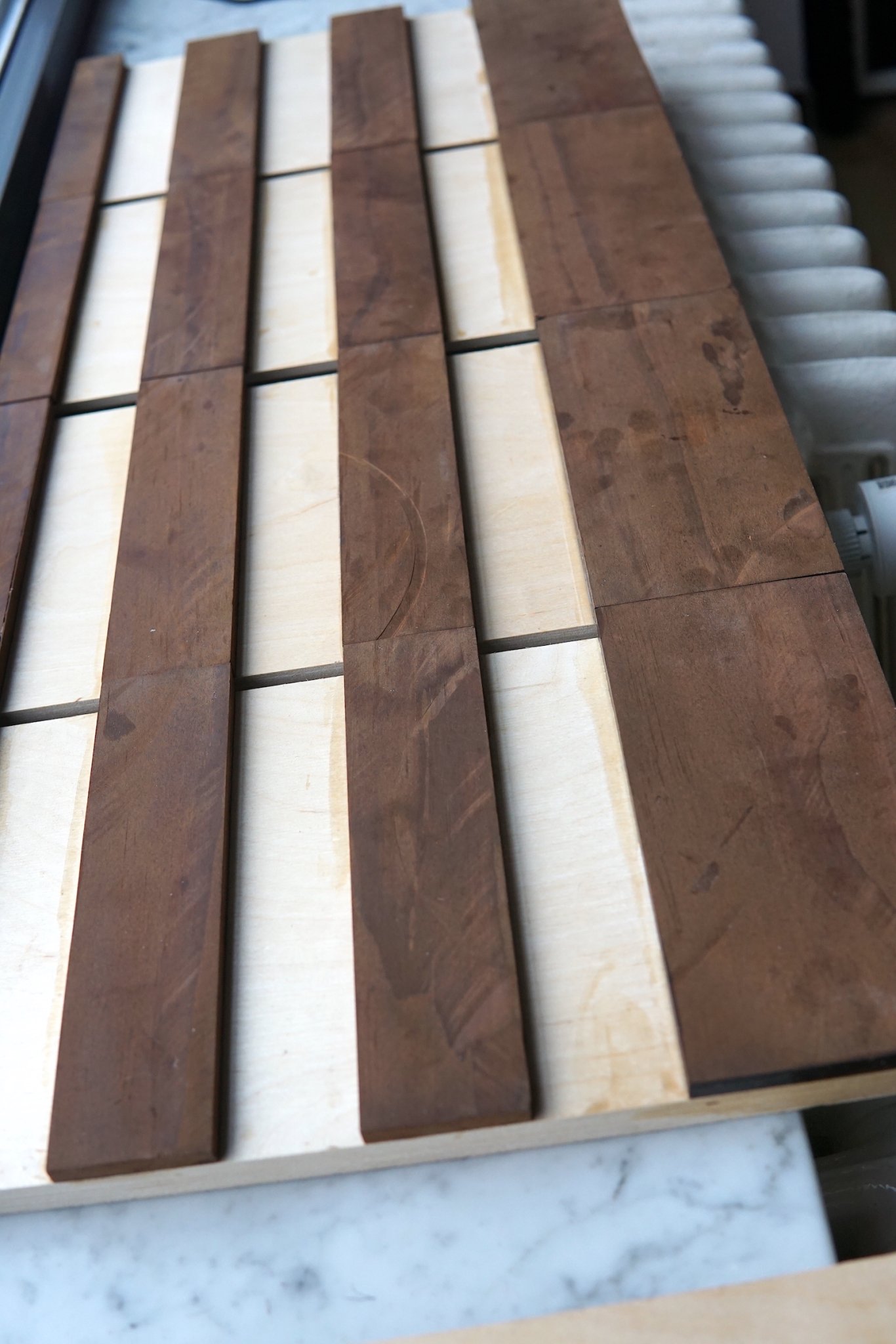

Thanks to these members and some friends who I have constantly asked for advice I'm embarking on building my ultimate mark audio driver build. Spent way too long choosing the panel grain, I'm planning on doing a shellac top coat to bring out the Baltic birch. Here's a progress photo, dry fit at the moment. Maop 10.2 drivers should arrive mid Jan.

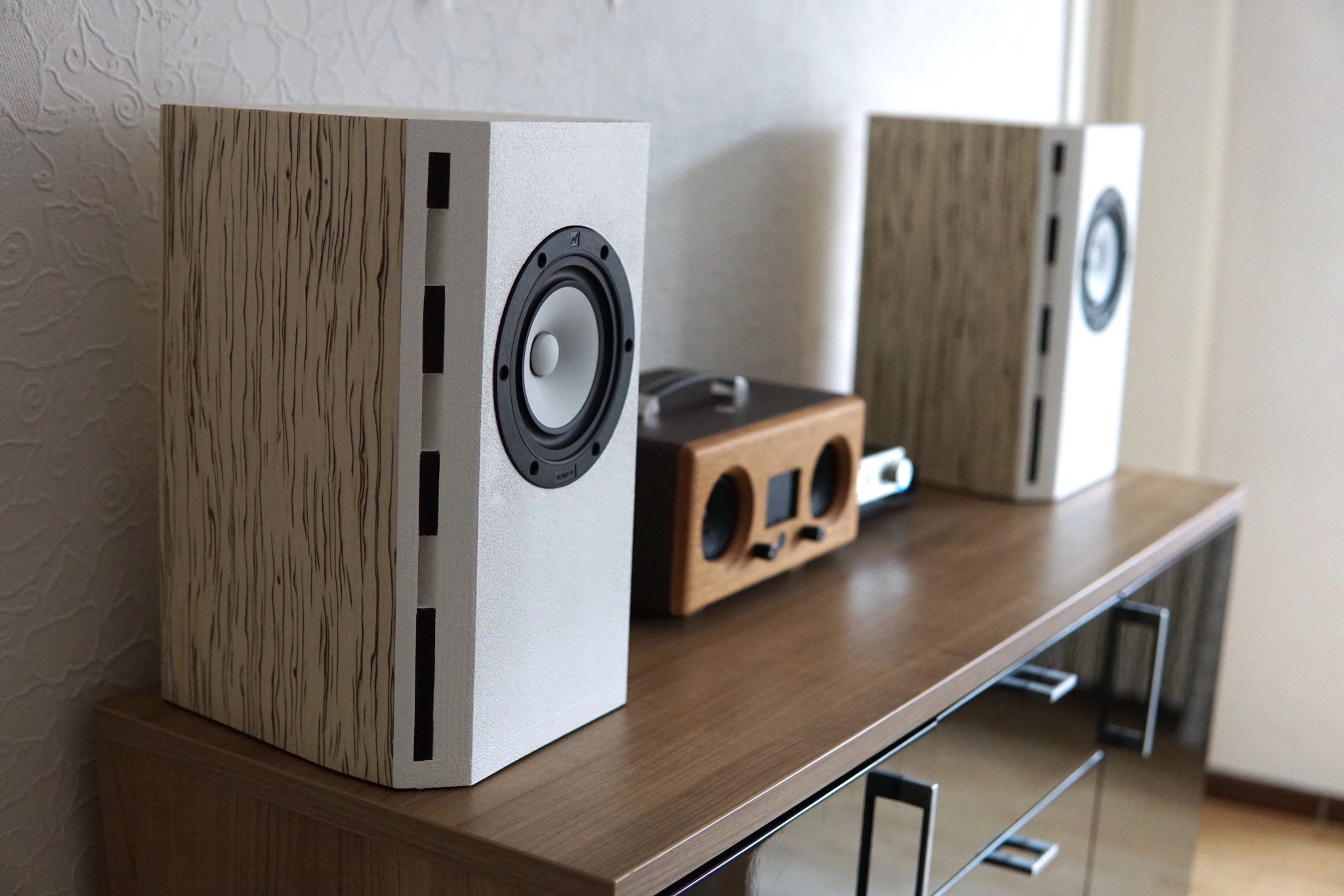

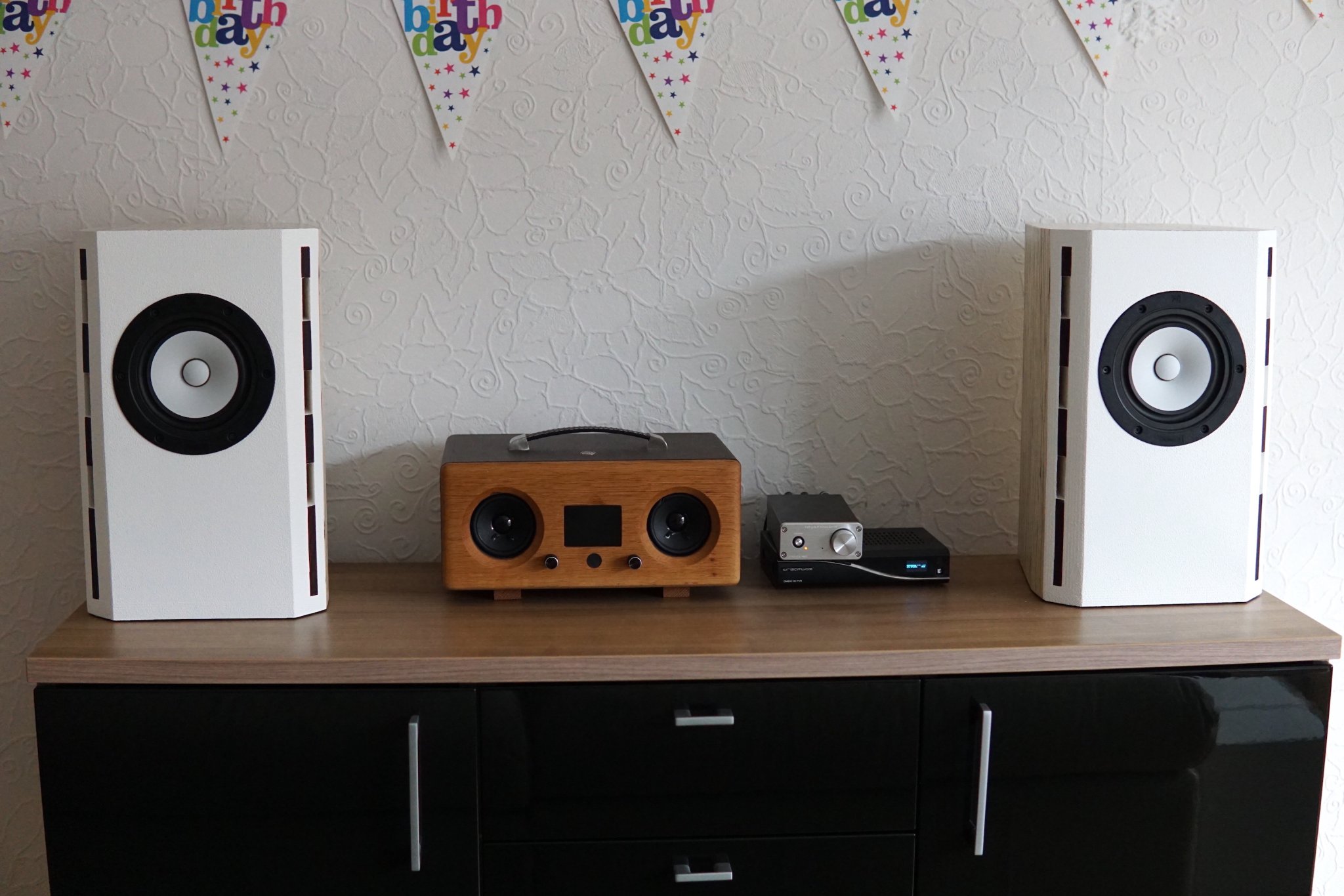

I'm very satisfied with this speakers. 🙂 I had to make stands for them.

Tested them near the back wall today. The drawers about 10cm from the back wall. The sound got darker there. Heavier sound. More body. More support for the base. Perhaps a sound that many prefer. The downside is that there was a little less space.

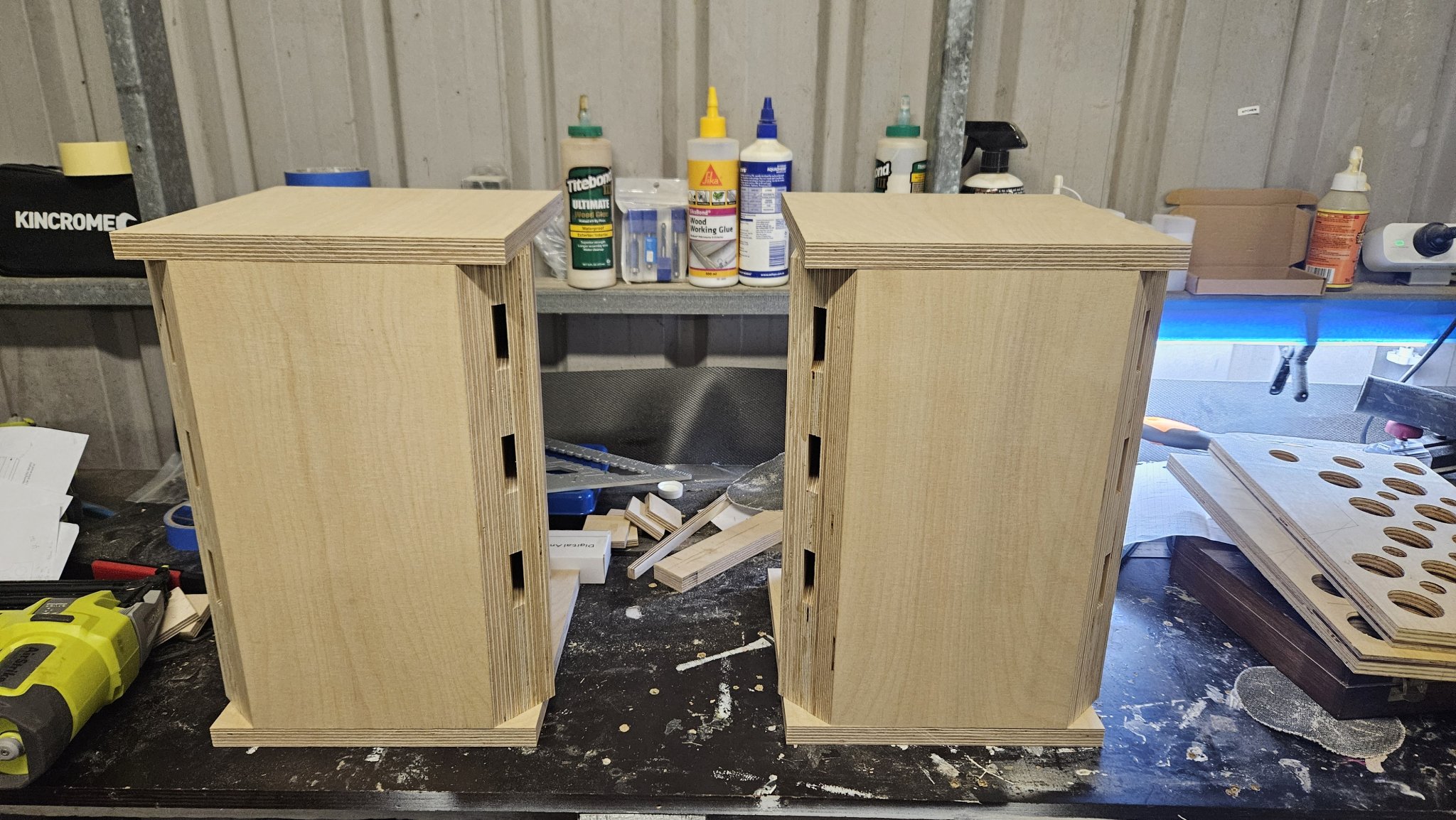

Speakers are finished. Certainly the hardest things I've made so far. Some imperfections which my ocd will just have to love with. I really like the shellac finish and the wood grain. I did around 8 to 10 coats. I lost count. But that only took about 30 minutes as it dries so fast. They sound amazing already, now to break them in. Thanks to my buddies Stu and Mitch for the help and support during the build. Certainly would have pulled my hair out if no help!
