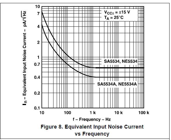

Is it still odd?That's odd, as it should be far less than that for an NE5534, at least at 1 kHz and higher.

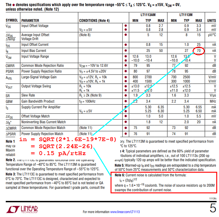

Sure. It's also $10/each.It appears to me that the LT1113 has far less current noise (datasheet MAX) than the NE5534 (datasheet TYPICAL)
I seem to recall that the OPA627 (~$30/ea) is better than the NE5534 as well.
But not everybody finds it reasonable to blow $10-30 on an opamp.

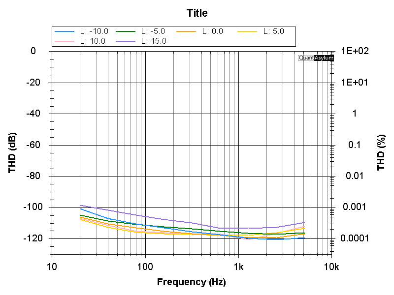

I've just been through some of my stash of random interesting opamps, and noticed the ADA4625 as a plausible replacement for the NE5534/32 that ticks all the performance boxes.
It's JFET input (low current noise), 3.3nV/√Hz voltage noise, rail-to-rail, +/-2.25V to +/-18V, 0.0003% THD (2k load), unity gain stable, and comes in both single and dual forms, SOIC8. Bit pricey though (its got an outrageously low offset voltage)
Here's the distortion v. freq plots for 2k load at various levels (inverting gain = -1)
