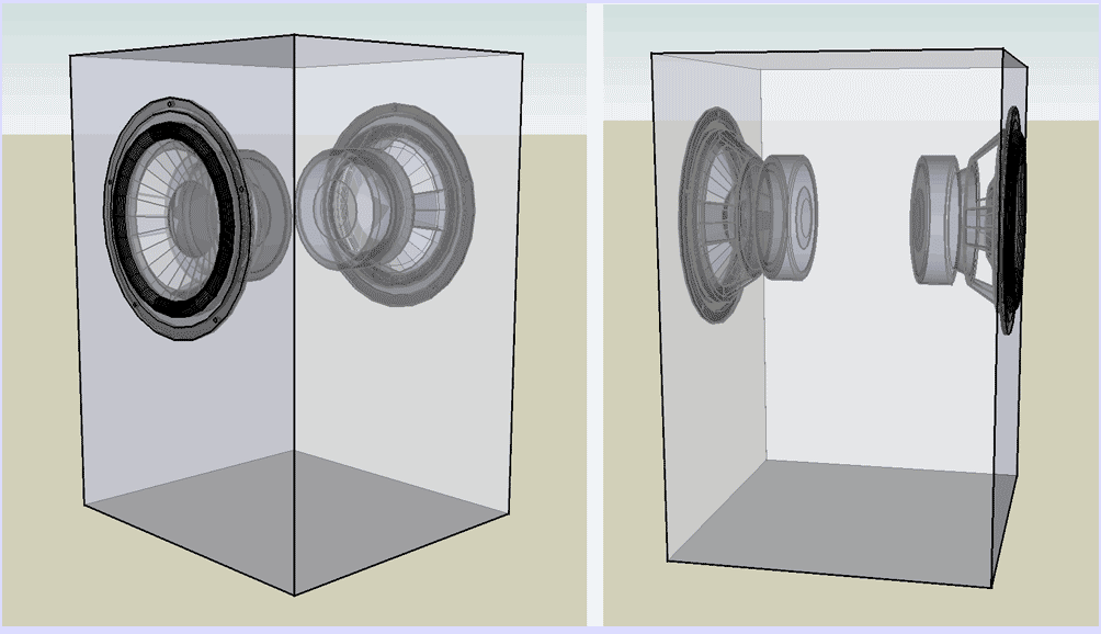

@mattstat I appreciate your idea but how would a two sided sub box work? That's definitely an interesting idea tho.

Mounting on opposite sides as in the image below cancels some box vibrations, so it's often used because of that.how would a two sided sub box work
https://www.diyaudio.com/community/threads/definition-of-push-push.365561/
But you can put them on adjacent sides, one facing in and one facing out, or however makes sense for how you want to use them. You obviously need to wire them so they're both pushing out at the same time, so that can require different wiring polarity if you flip one inside out.

Mounting a second, identical woofer as mattstat pictured in post #51 is your only option. You will get +3dB from the extra cone area and another +3dB from the double power the amp can deliver at 2 Ohm. You now have 4 Ohm, with the second woofer in parallel you get 2 Ohm.
This +6dB should give you quite some extra headroom. As mentioned, you will loose some deep bass, but this is not relevant for you anyway.

If you don't care for the look of it, best would be on opposing sides, of course. Second, have both magnets on the outside. You win a fair amount of valueable volume and have the cooling at optimum. Fix the cabinet in the middle of the trunk.
