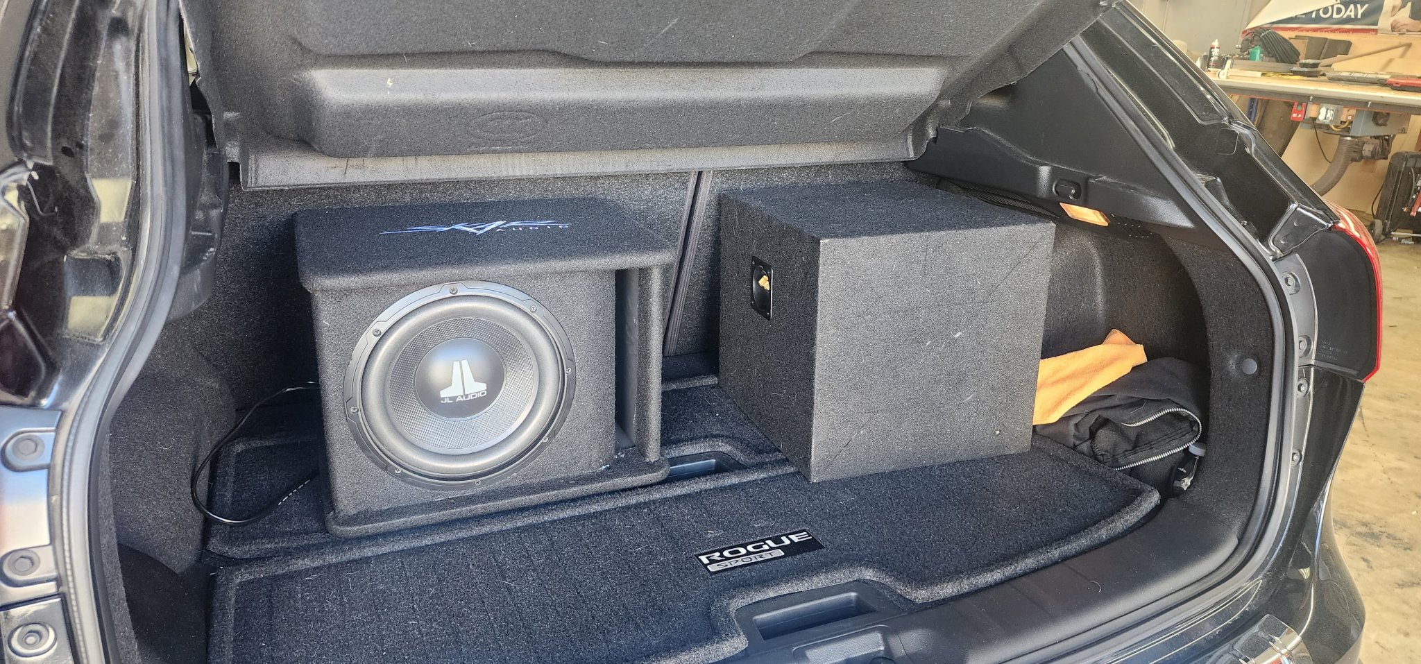

@WhiteDragon how much would it be to design a sub enclosure that takes up as little space as possible for a 2019 rogue sport? Either 10 or 12 will do. Or if it's small enough, 2 10s or 2 12s?
You won't get much smaller than you have for 2 10s. Why not buy another of the same CV woofer, mount them on opposite sides of the enclosure you currently have, inverted. You get more cone area, more power and less power per woofer so less chance of bottoming out.
You can make it easily removable when you need all of the space for groceries. For times when you don't need all of the space, leave it in place.

best way to do it, 2 matching subs.So theoretically if I were to buy 2 of the same sub, could I do both subs facing out or would they have to be both inverted?
they both share the same box, or both can be in separate boxes.
Dont have to be facing each other, maybe thinking of isobaric, different animal.
Both face outward.
Assuming one speaker as a 10" requires 1 to 1.3 cubic feet.
Then you just double the box size for 2 speakers. So 2 to 2.6 cubic feet
Or just run 2 separate boxes with the normal required 1 to 1.3 cubic feet each.

Up to youYes, so my other option is same box as current one, and do a magnet to magnet twin sub? Like post # 51? Or would you still advise keep 1 separate?
On grocery day just remove one box for room.

Run a long cable from the amp and just use a speakon so you can disconnect it easily.
I should probably mention, I enjoy playing Spanish music (reggaeton, banda, corridos) but I also enjoy hip hop, rap, r&b, and some dance and country too.
@WhiteDragon so you have two subs but each is separate huh? So it would be like this pic?
Yes just like so.I should probably mention, I enjoy playing Spanish music (reggaeton, banda, corridos) but I also enjoy hip hop, rap, r&b, and some dance and country too.
2 matching woofers and 2 matching boxes.
And quick disconnect cable when you need to remove one.

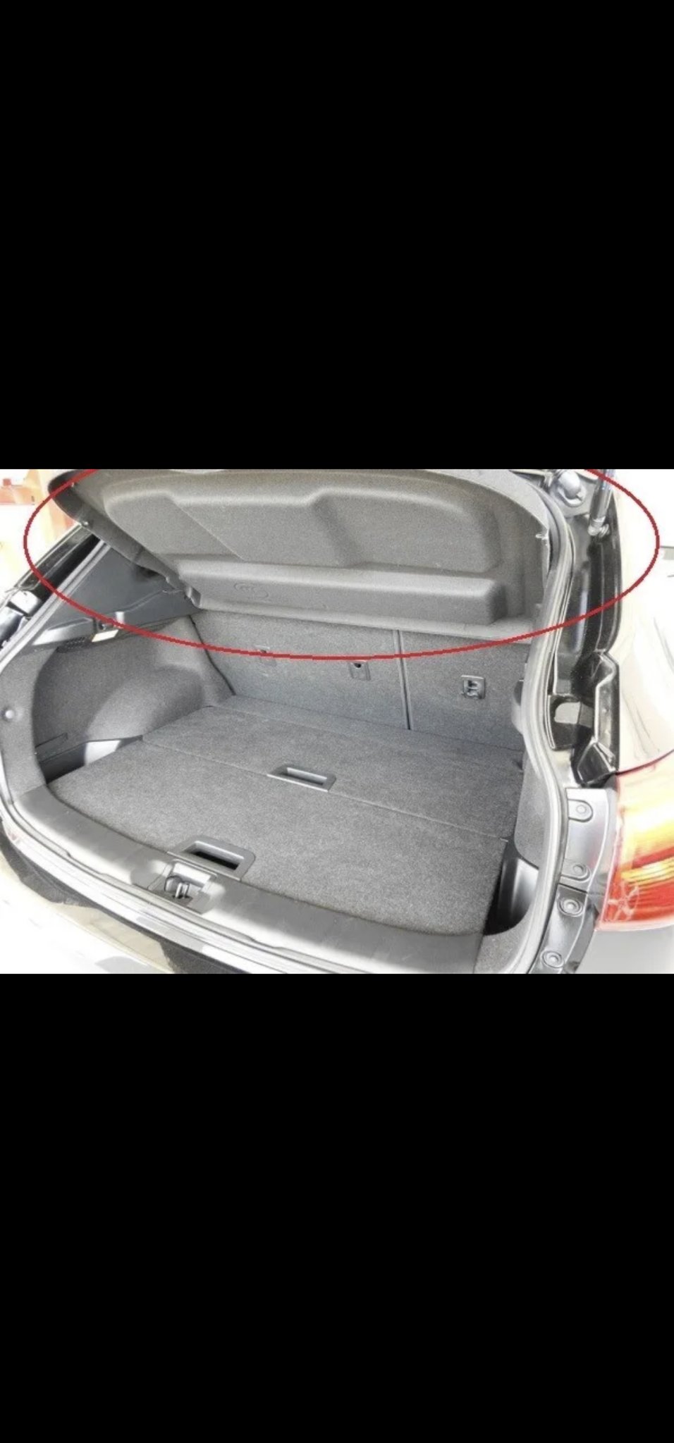

Honestly @Perry Babin I live with my parents still and we all share the car for now (until June ish or so), and we go grocery shopping like once or twice a week.
It's actually kind of a small trunk so can probably fit about 8 or 10 bags of groceries without the sub. With the sub, like half those numbers I believe.
