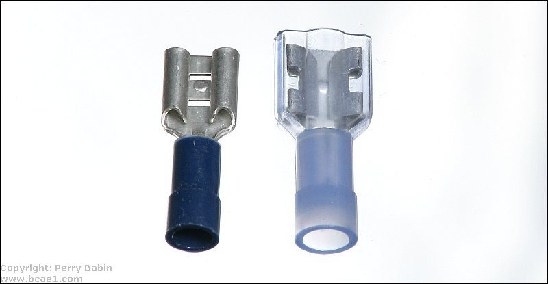

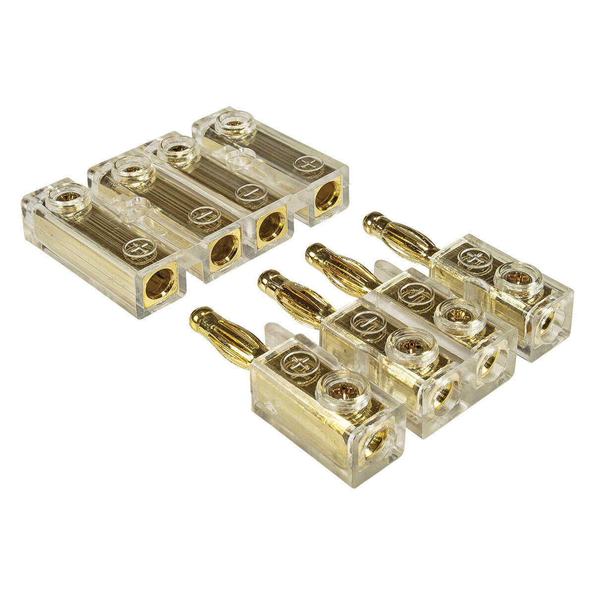

Also: if I needed to take the sub out, could I electrical tape the sub wires? It probably won't be for more than an hour or so at a time!
Electrical tape will be a mess.
SpeakON connectors were recommended. They would certainly work. They're about $15 each. You'd need one male and one female.
You could use Faston quick connects for whatever size wire you have. The ones below are too small but you see what I'm referring to. You'd use fully insulated terminals like the one on the right. Nylon insulation is better than PVC but either will work. Most people use a male and female for each wire pair but I've seen people plug a male and female from an amp output together and that doesn't go well. I'd recommend using two males on one side and two females on the other pair of wires (if you use this type of connector).
Your car audio shop should be able to install some quick connector into the existing wire. Takes about 10 minutes. I undestand you are unable to do anything your self, but usually no job too complicated for anyone with two healty hands. Cold look like this one, but you may only need half of it.
