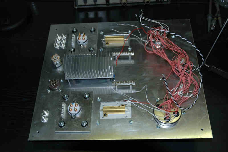

Hello, I have been using my 01a for quite a while now, it's based off of Ale's Gen2 Design, and I am still having noise issues despite redoing my grounding, and shielding some of the signal sections. The hum really isn't too bad unless I turn my amplifier up, but the microphonics are a real killer. So much so that if I turn my amplifier up too loud, even with nothing playing, and tap a valve, it will pick up the vibration from the speaker and ring louder and louder. Also, at higher volumes, the tubes will ring on bass notes. I've bought 5 extra 01a's now and these are the least microphonic of the bunch. My chassis is a 12x12 aluminum plate mounted on wood, bottlehead style, connected with umbilicals to my power supply. I know the mounting isn't doing it any favors, but I didn't expect it to be this bad!
It is sometimes worth trying some vibration-isolator interface. Like a 'Rubber Sandwich' at the tube socket's mounting points.

Will the solid core wires to the tubes pins not create a rigid coupling of other vibration to the tube? Should I use different wire? I will post photos tonight.
They might do, depending on the gauge. I like to aim for maximum isolation, above other consideration, & flexible cable is certainly better in that way.
I like the sub-chassis approach too, especially if the floating part is as light in weight as possible.

I use the same solution. Not the specific brand Rod linked, but the same vibration damping bolt/standoff.
Amazon (US) sells them for quadcopters, etc. in m3, which works well for tube sockets, IME.
I get mine from ebay, plus threaded mounting blocks from Burklin. Mounting block | Burklin ElektronikI use the same solution. Not the specific brand Rod linked, but the same vibration damping bolt/standoff.
Similar system to Thomas Mayer.

Put the volume control on the output
I use a TVC on the output, which adds another layer of isolation.Put the volume control on the output
That is exactly what I did, it's the best way to quiet those tubes.I use a TVC on the output, which adds another layer of isolation.
I had a box of 10 tubes, all very microphonic until I added the volume at output. It works with a resistive volume control as well but the TVC works even better. I went to Dave Slagle for mine

Without low output impedance transformer (for example next stage /SiC/FET source follower, or -at least- CCS/gyrator as active load of tube) it's a bit optimistic advice. :-(
01a has very bad behaviour to such complex load (very high inductance+not so low capacitance) as AVC/TVC. Low output impedance driver helps a lot.
