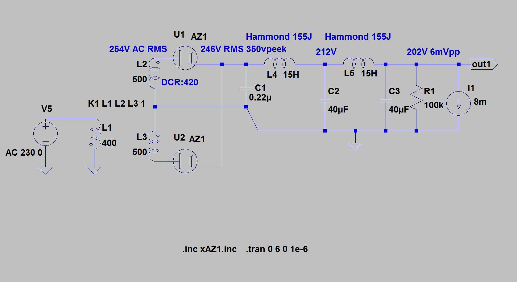

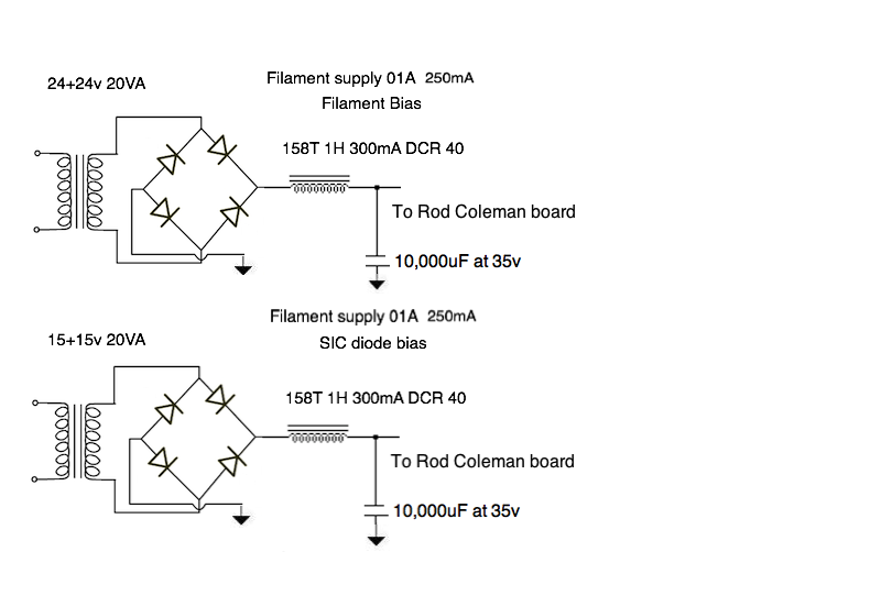

PSU schematic for 01a pre (with filament SiC bias)
Hi everyone!
What's your latest/best PSU for the 01a preamp?
I'm about to start getting my hands on all the parts for this pre and I hope that some of you (and hopefully Mr. Moglia himself) would share their PSU schematics with me because I wasn't able to find out what PSU design is the current best/ recommended one.

It's easy to work out a B+ supply and there are plenty of variations. But if you use choke input, which is nice, you have to allow for critical inductance which may need a bleeder resister to ground depending on the size of your choke.
The filament supply is critical, so don't ignore it. I use choke input and then a Rod Coleman reg. A hammond 158T is good for choke input - 1H at 300mA. I use SIC diode bias rather than filament bias for the 01A, and so does Ale Moglia who I took the idea from. Here's a rough idea:

Thanks for your response with the filament supply, but what about the B+ supply feeding the gyrator? I know that, as you mentioned, it is not hard to design one but I'd like to hear what you or other people who have built this preamp are using/ what worked best.

Any diode recommendations for the filament supply?
I regularly use MBR1635 ...45 types.

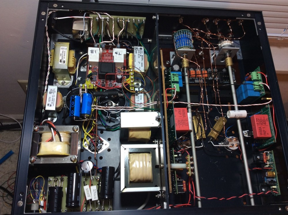

I used a 21st century Maida regulator so I could dial in a desired power supply voltage.
Entire left side of pic is just my power supplies for the 01A

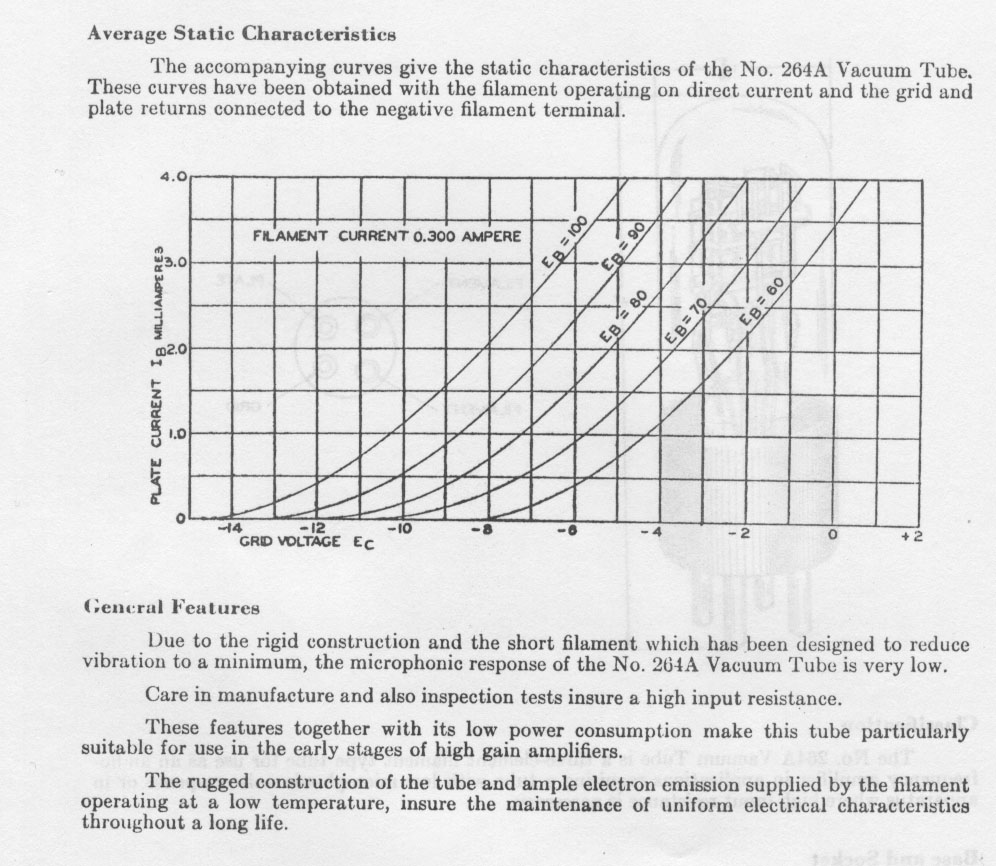

Looks like putting an 01A into the audio path creates far too many problems. The 264 & 864 are built for low microphonics. A better starting point.![]()
I don't know the 264 or 864. They do have more filament current which is generally a good sign for lack of microphonics. But this puts you squarely in 26 territory - a much more common tube, plus you can put 7mA through it. The 01A doesn't suit all uses - I don't use it because of its low current. But it's thoriated and it sounds wonderful in the right context.

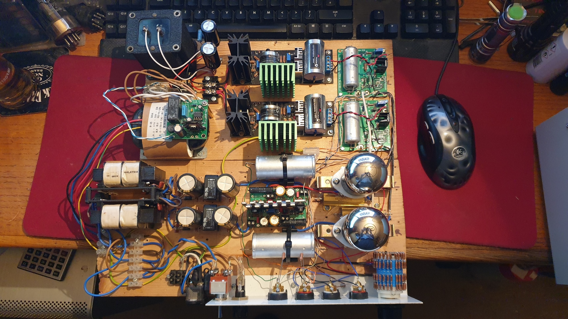

Another CX-301A amplifier is born. I had been using a 4P1L to drive an F4 amp for many years, similar to Ale's Siberian Gen 4 but with a K&K audio shunt reg feeding CCS plate loads. Loved that amp, but the 01A builds had me intrigued ...with covid lockdown and "working from home" there was no time like the present to experiment.
Recipe is almost identical to Ale's 01A, Salas SSHV2 regulators feeding into Gyrators with a BF862 in the lower position, cathode biased with Coleman regulators.
Colour me impressed, vs the 4P1L it initially sounded softer, but having spent a few days with the 01A i have come to appreciate how nicely balanced it is from top to bottom, with a lovely sweet mid range making vocals and acoustic music just sound great. This amp is definitely a keeper so i have to start planning a permanent enclosure to build this thing for real.

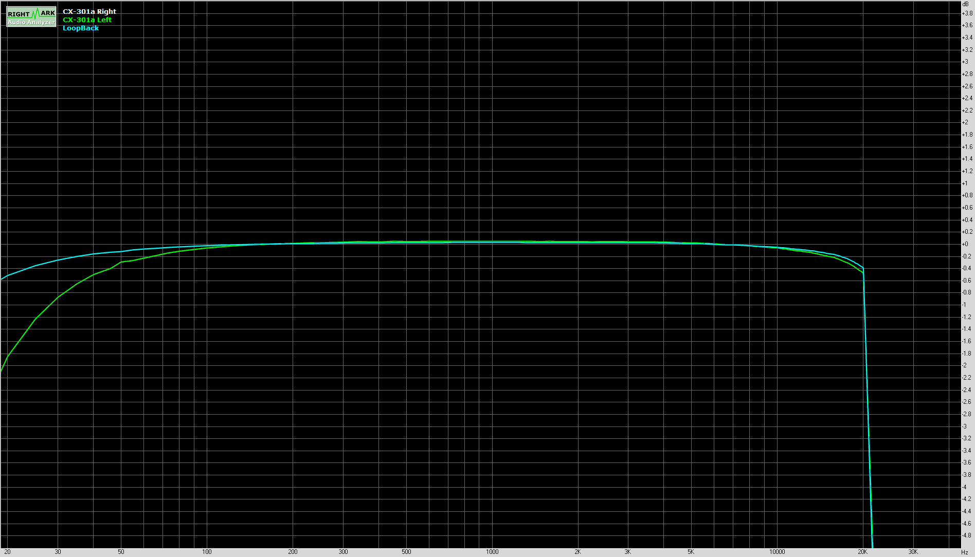

Initial testing was a mixed bag, i hadn't used RMAA or my Millett interface in a long time so connecting it up was a bit of a faff. Long story short, i am seeing a little more low end roll off than i was expecting, but cant say for sure how accurate my testing setup was. I am not using the source follower setup, just a .22uf cap on the output so i may just need to increase its value.

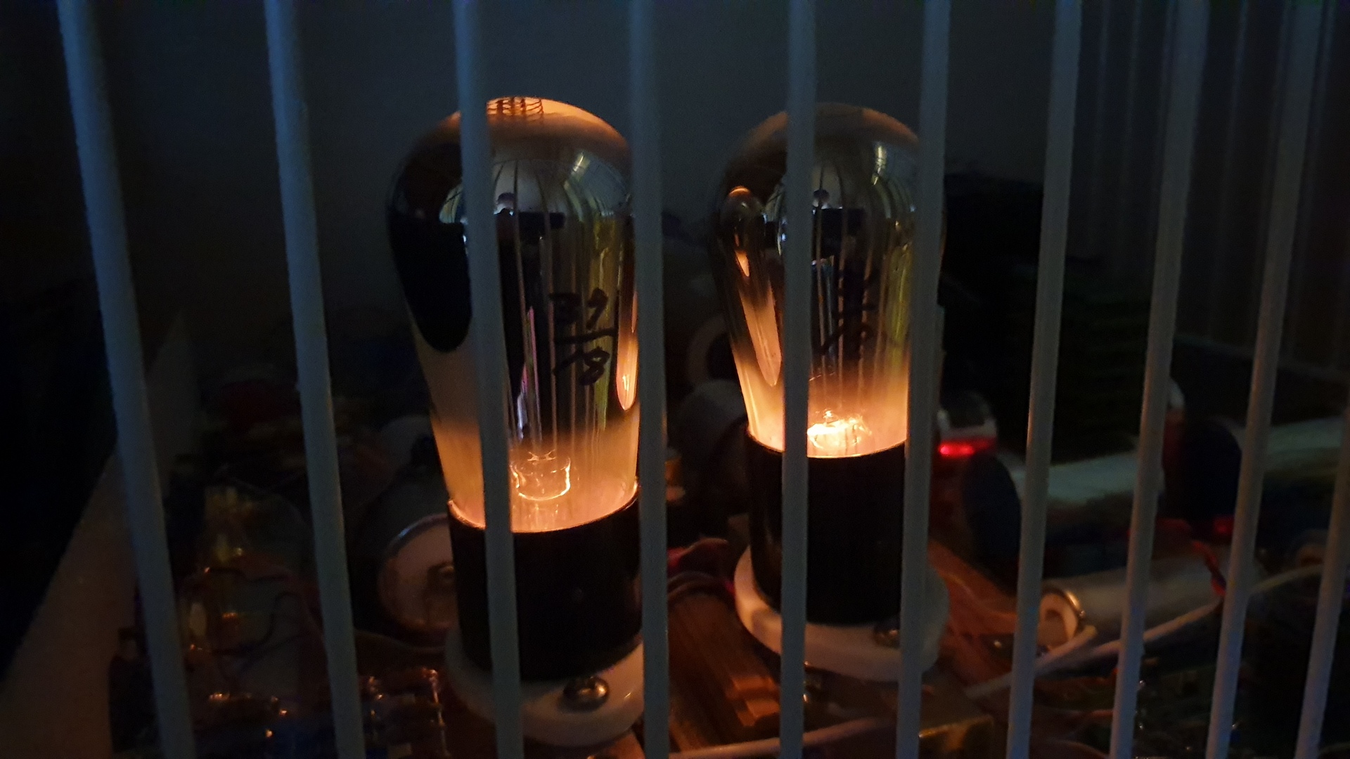

Lessons learnt: These tubes (CX-301A) are fragile, i bought a cheap set of five tested tubes from eBay, by the time they got here from the US two had open filaments, and i managed to kill another one during testing. If you are building an amp, don't start with a pristine matched pair, buy some cheap sacrificial ones just in case.
