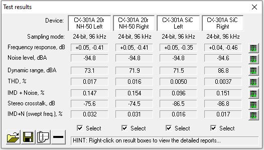

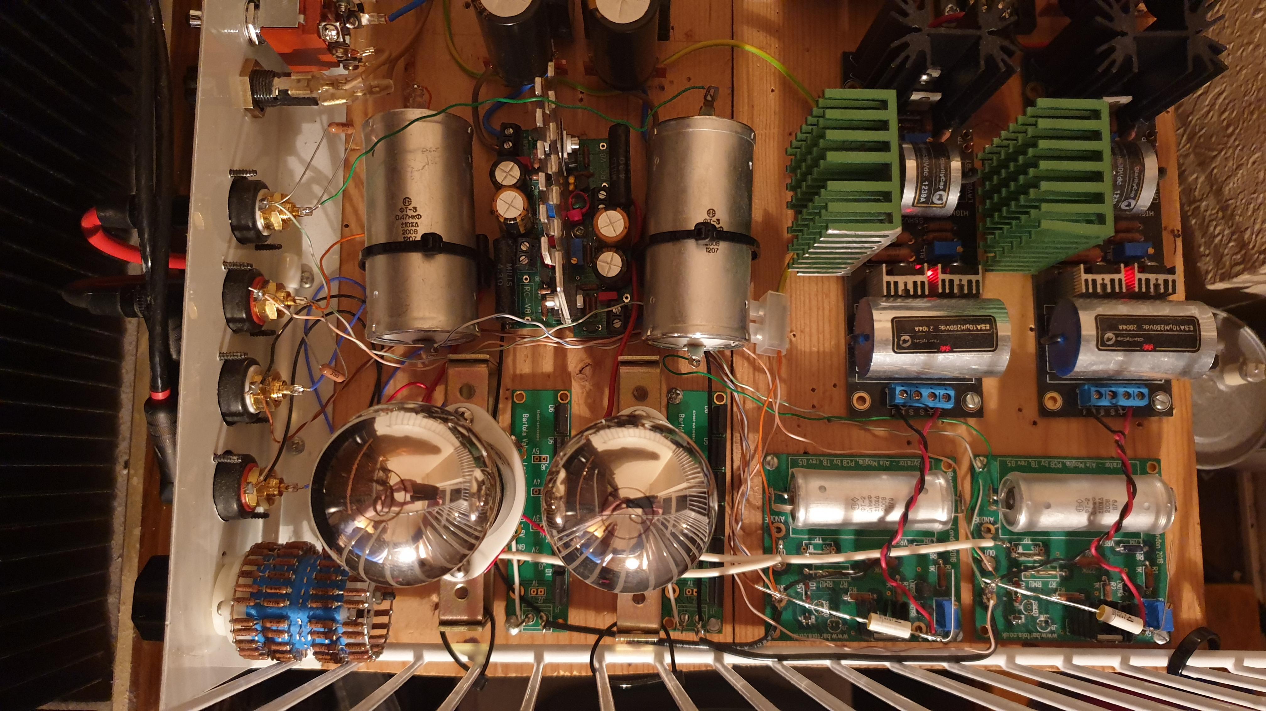

Switched out the biasing resistors for the SiC boards during the week.
As expected it did clean things up a bit, measured results where a little surprising to be honest, and bordering on the limits of my test setup for frequency response and noise floor. I just wish a had measured the harmonic content before and after as i believe that would have been far more telling.
Musically, there is a noticeable improvement in clarity, dare i say the old setup was a tad smoother and more romantic sounding, i suspect there was more harmonic content in there making it a little more warm and cuddly.
I can absolutely see why someone would prefer it that way, and i will admit i wasn't immediately sold on them, it took a few days of listening to come to the conclusion that the SiCs are right, and that they are staying. I will be using this amplifier for everything, Music, Vinyl, TV, Netflix, Youtube videos you name it so the cleaner option is the better choice for me.
Still deeply impressed with this pre amp, you know you are onto something good when you cant stop feeding music through it :D

Switched out the biasing resistors for the SiC boards during the week. Dare i say the old setup was a tad smoother and more romantic sounding, i suspect there was more harmonic content in there making it a little more warm and cuddly. I can absolutely see why someone would prefer it that way.
How flattering - that's me! Romantic, smooth, warm and cuddly. I always knew it.
I'm back on filament bias. For me smooth does it. My 01A stage is driving my EL12n outputs in my current main amp.
Glad you like it. The SiC bias arrangement was a great thing to land on. I’m very happy abs haven’t found anything to sound better on the cathode of this preamp. Who knows, we may find it In The future!
