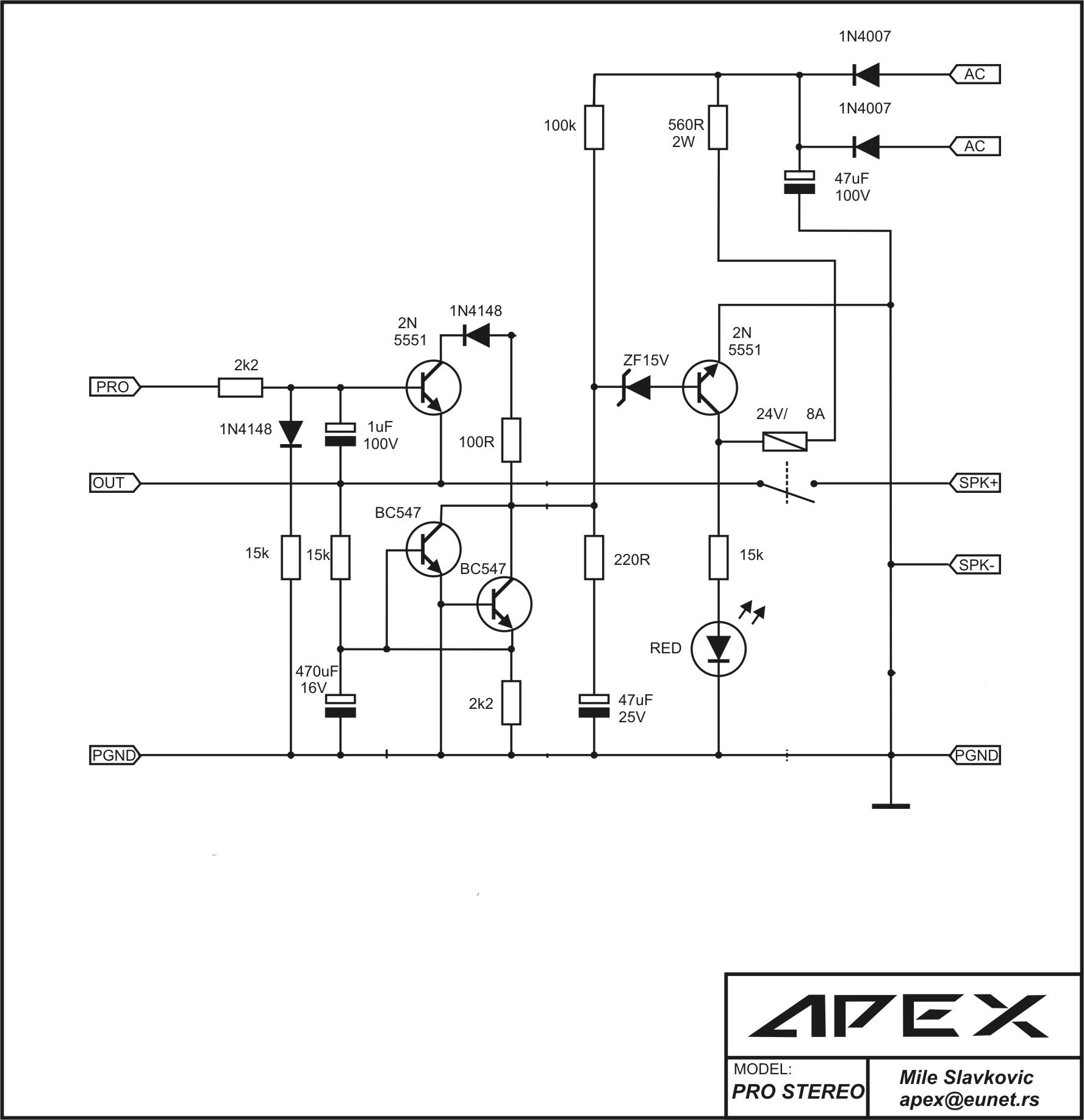

Mr. Miles,
can this over current protection be used with UPC1237 , if not what changes can be made? here is pic of datasheet. and link http://www.tecnotre.it/audio/tecnica/upc1237.pdf

upc1237 does not have built-in OCP, as they say, due to patent reasons, you have to add external ckts to sense the V across the emitter R or other means to determine a OC condition and then drive pin 1, past 0.67V to de-energize the relay.
For an example look at the way they did it on a Sansui G-7500 but they used a HA12002 part instead. Or use the Pioneer protection ckts as an example.

Thanks for your reply, but what i wanted know was if original APEX OCP can be used in as is condition or with suitable mods so that its suitable for UPC1237. see my quoted text in #9323 refering to Mr. Mile's original post # 200 http://www.diyaudio.com/forums/soli...timate-fidelity-amplifier-20.html#post2235618upc1237 does not have built-in OCP, as they say, due to patent reasons, you have to add external ckts to sense the V across the emitter R or other means to determine a OC condition and then drive pin 1, past 0.67V to de-energize the relay.

upc1237-pin1 max current is 3mA, so you have to choose R31 to meet this requirement. 0.67V to turn it on.
If the supply is +45V then 45V/3mA=15K min, 47K as shown, would work.
If Id = 6A, it is enough to turn on Q15, which then turns on Q16

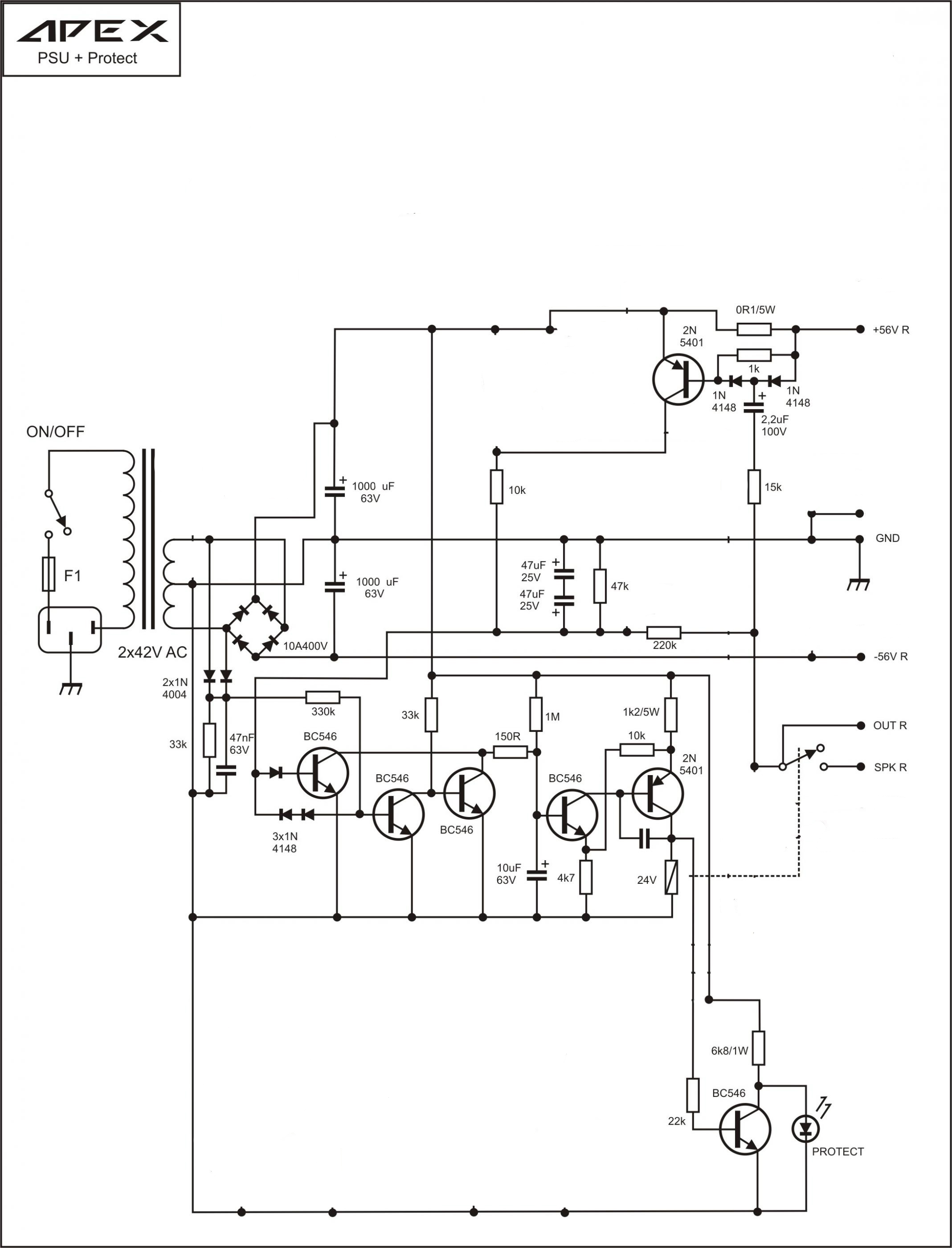

Hi sir Mile
i need a protection for B80 darlington amp
it must protect for short circuit and DC with pro pin
thank you
Use PSU100 there is all protections.

PSU100 is made for FX100 but it can be use for any stereo amplifier.
http://www.diyaudio.com/forums/solid-state/162081-dc-servo-mosfet-amplifier-61.html#post4624521

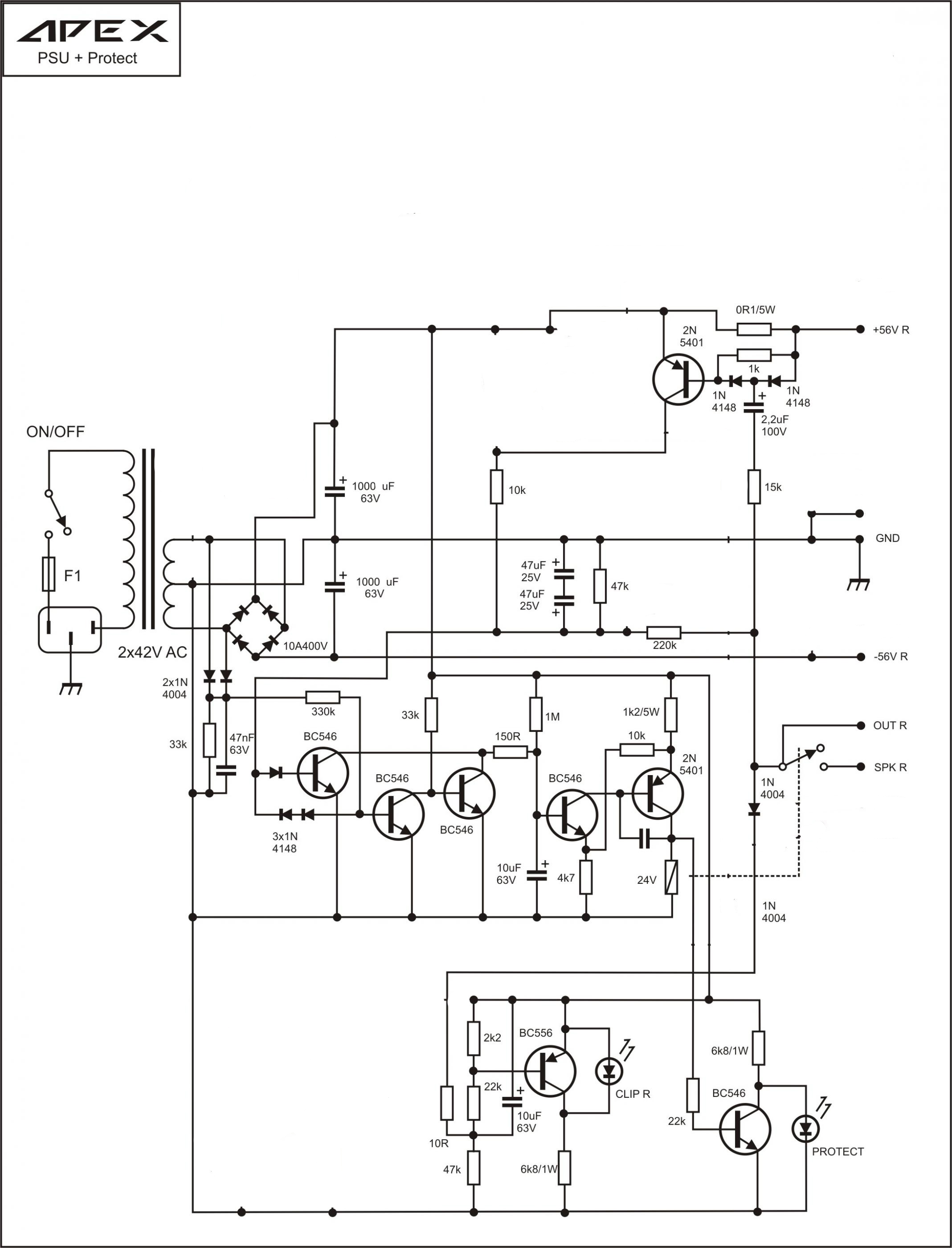

Hi
sir Mile
is this OK for protection?
from my experience...
i think protector unit using a different AC source is better than using single AC source or i mean 2 trafo

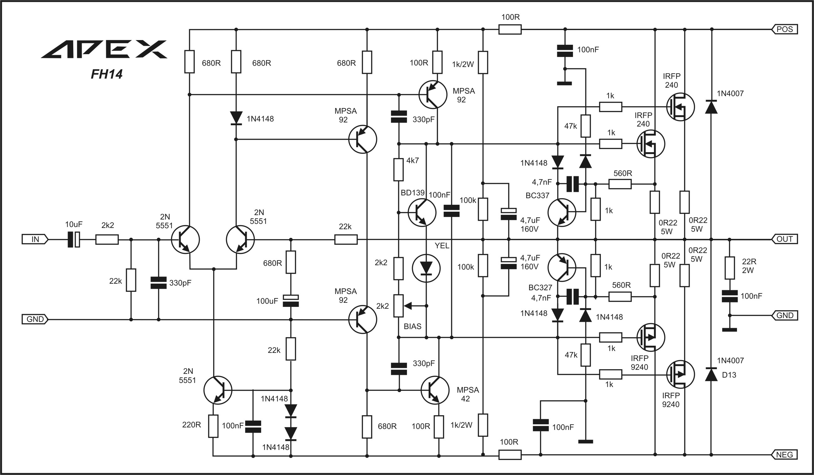

I'm going to be honest, I'm not an expert or circuit designer I only try to do my best way possible I will leave the files here it came out too big but is better because the traces are a bit thicker than what I usually do that is 1.5 mm this are 1.75 to 1.80 mm I have already simulated and it came out 1.5Vp on the output please if some one see an error let me know
