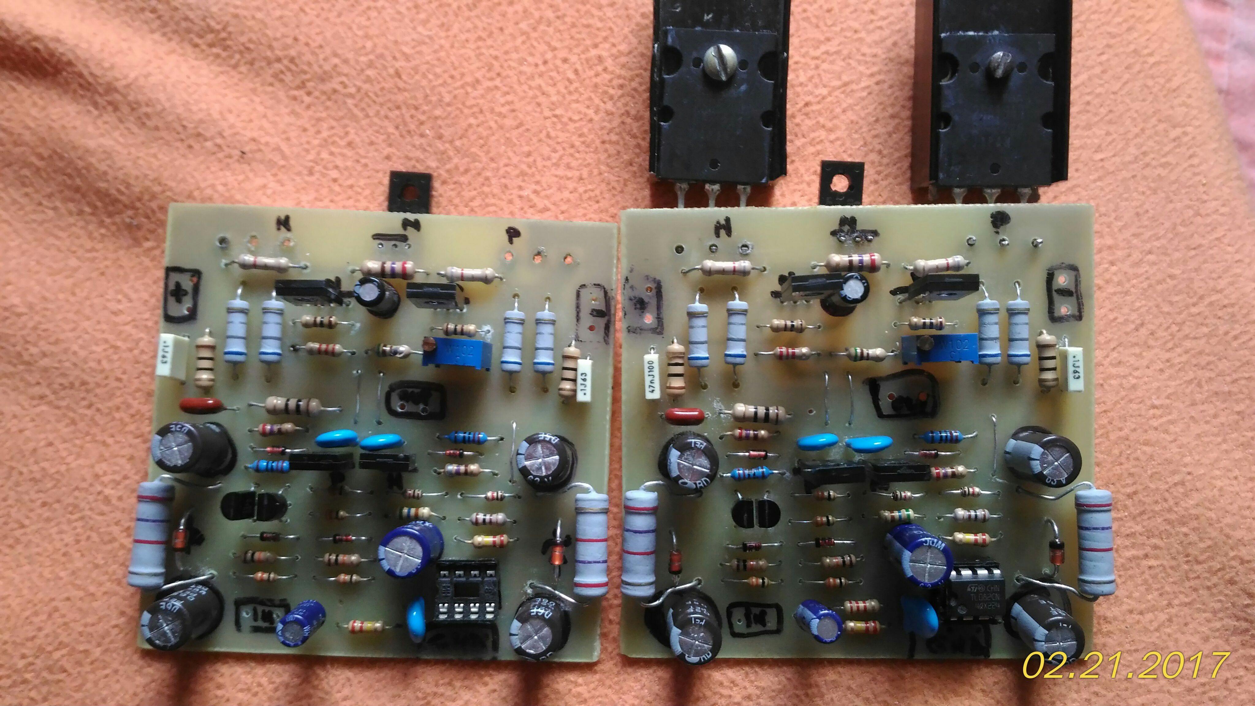

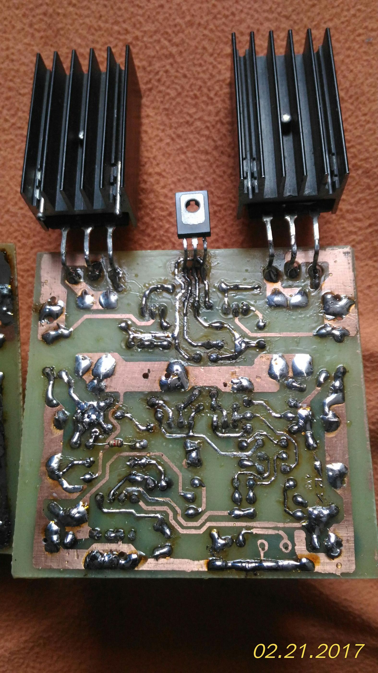

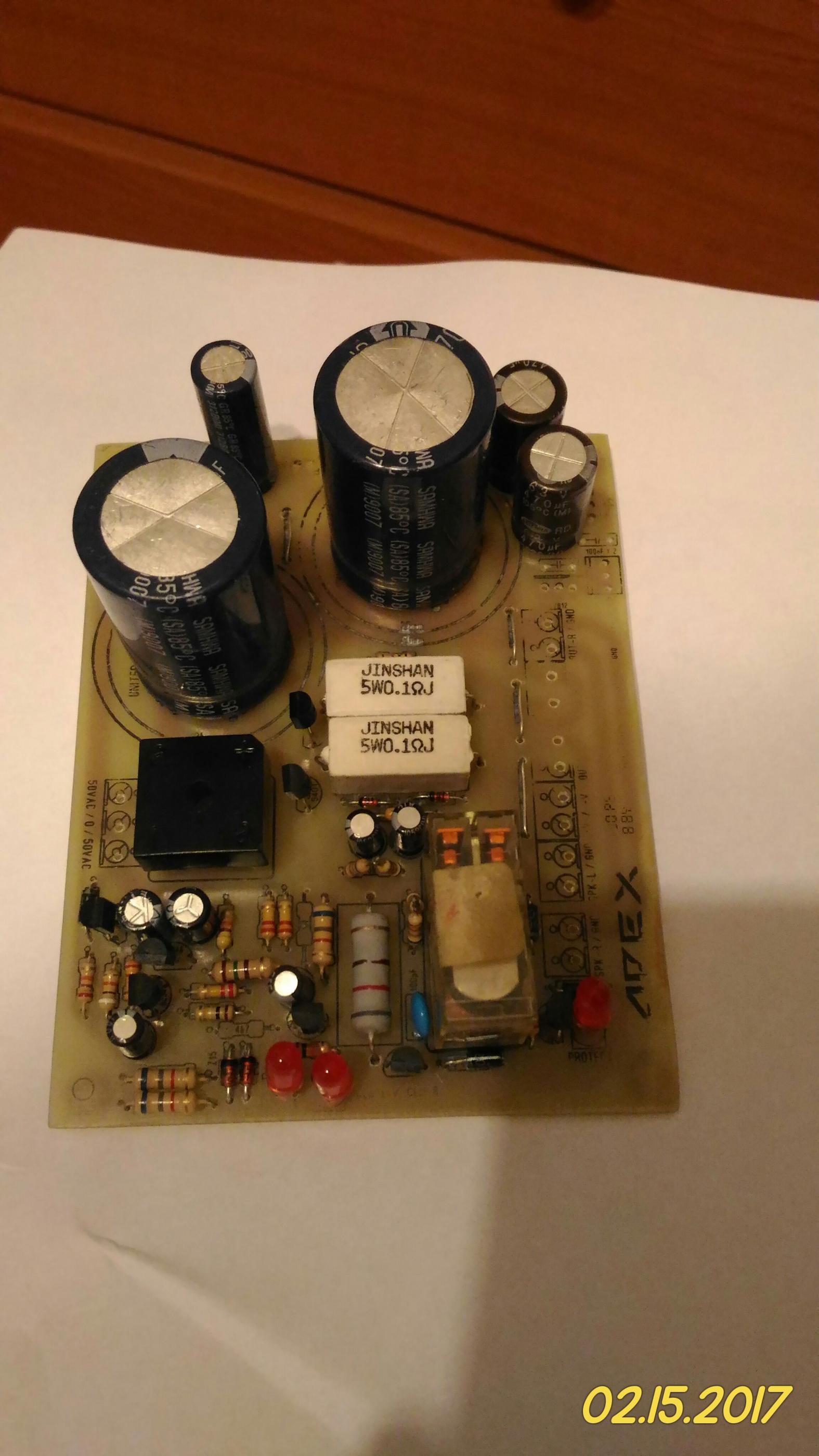

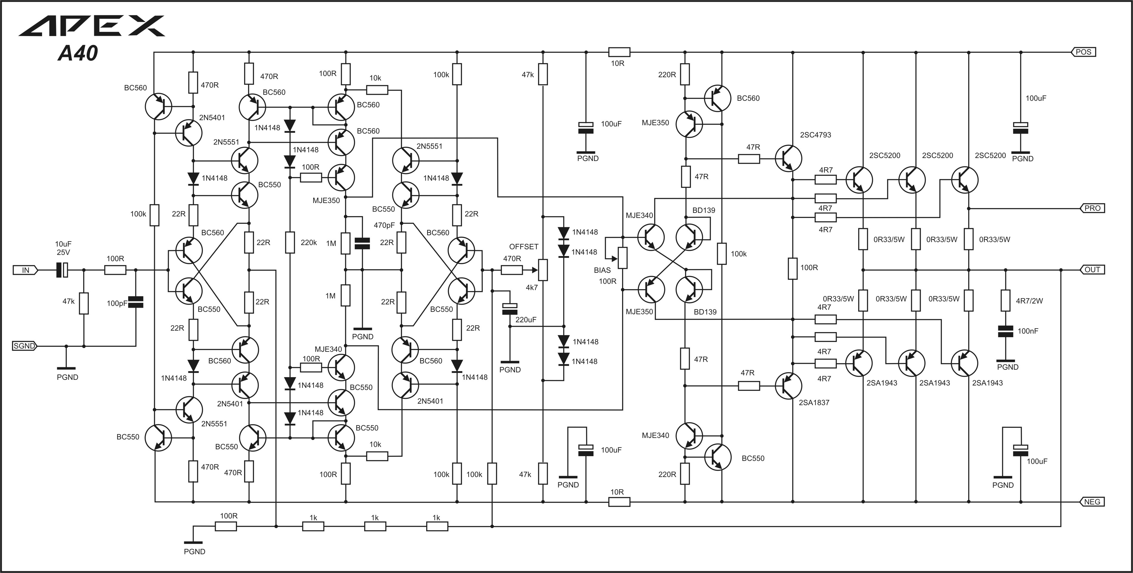

Hello everyone!
I've finished and tested sound wise Apex AX9 and PSU100 together. My Ax9 it's modified from input to the VAS like A9. Drivers and outputs are like in the schematic. With the schematic ax9 values, gain was to much for me. With input shorted it was still hum in the speaker when my hand was next to the amplifier..... With values of the A9 schematic looks better and no more hum in the speakers with input shorted. The gain is lower than the original. Is it OK if I do this modification? Is there any other way to get it done properly. I use it with +/-38,5Vcc.
