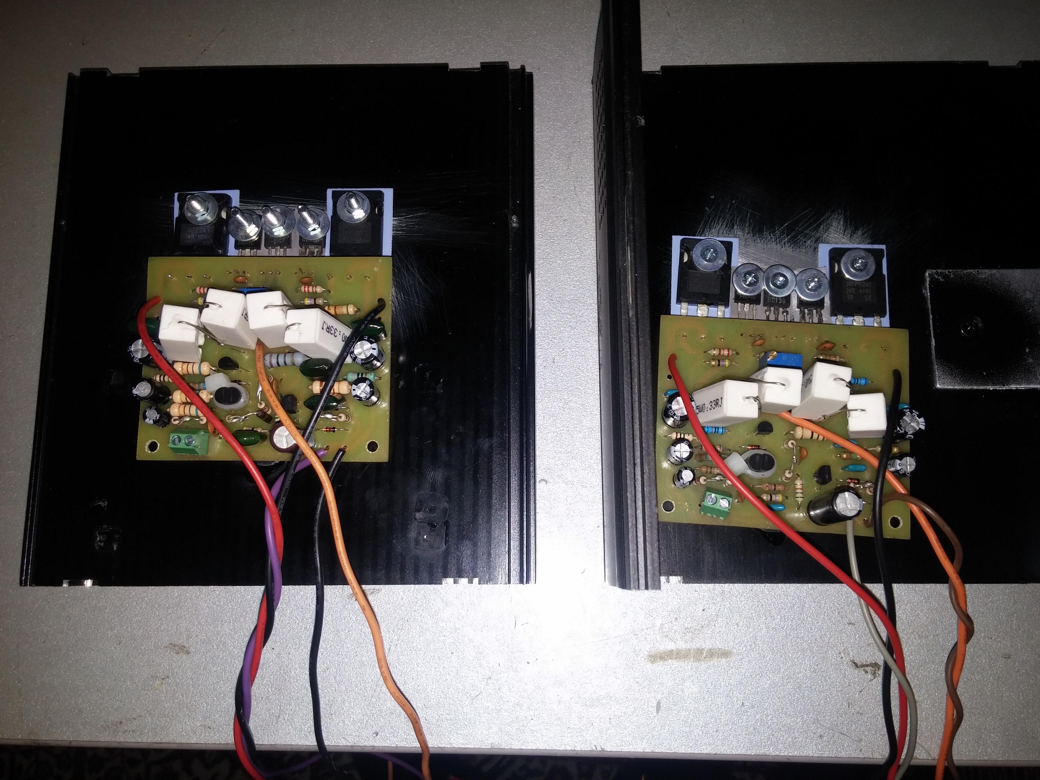

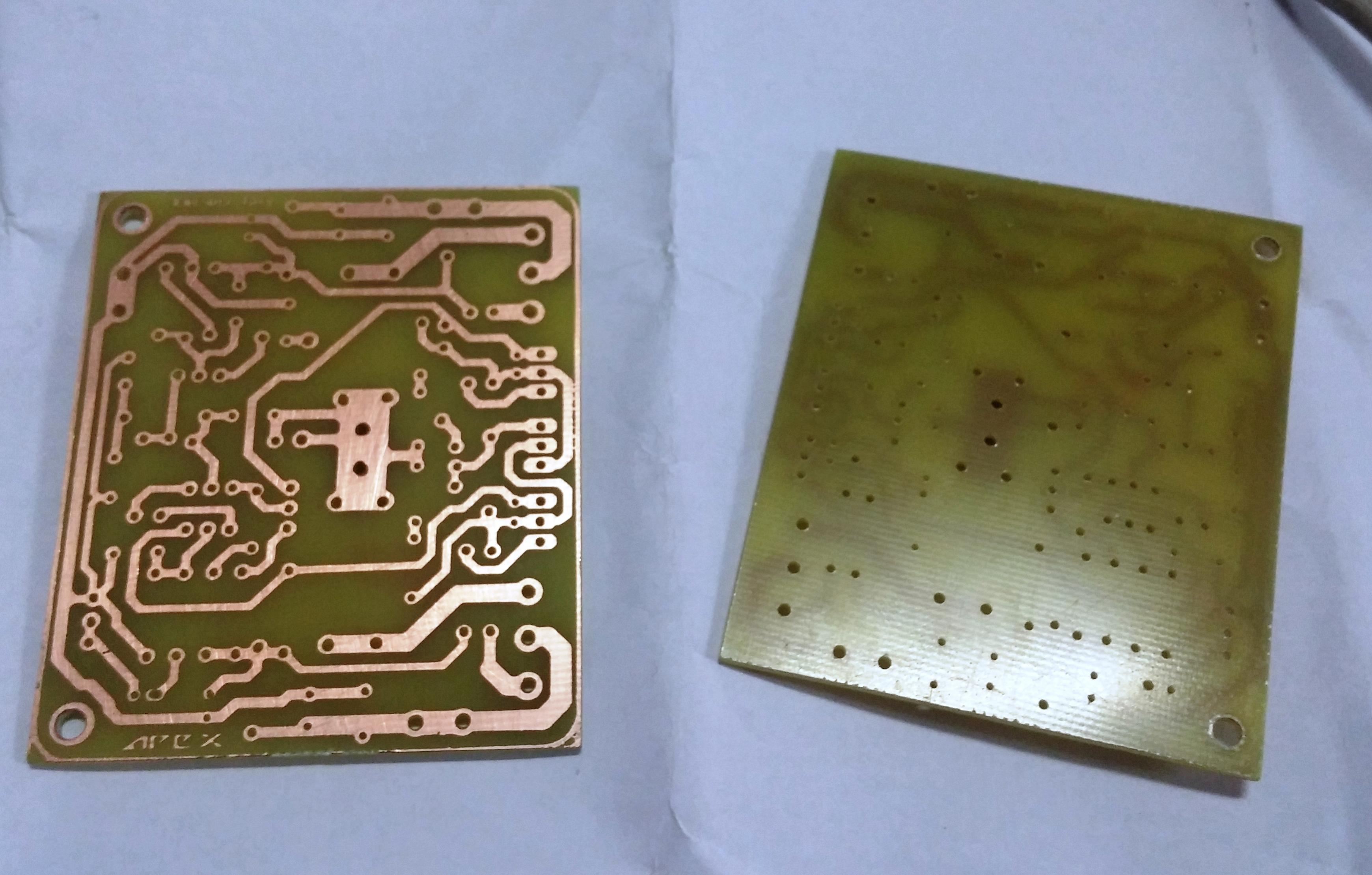

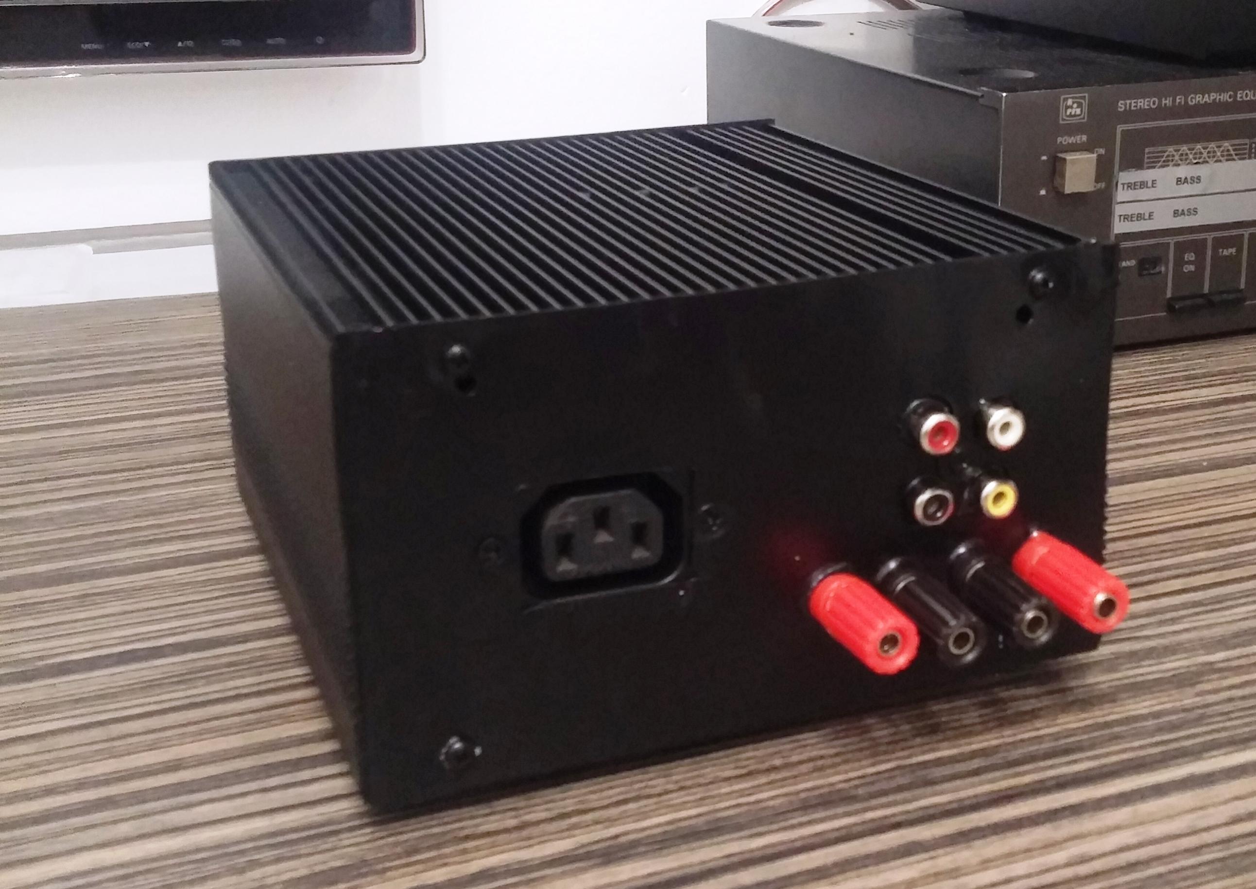

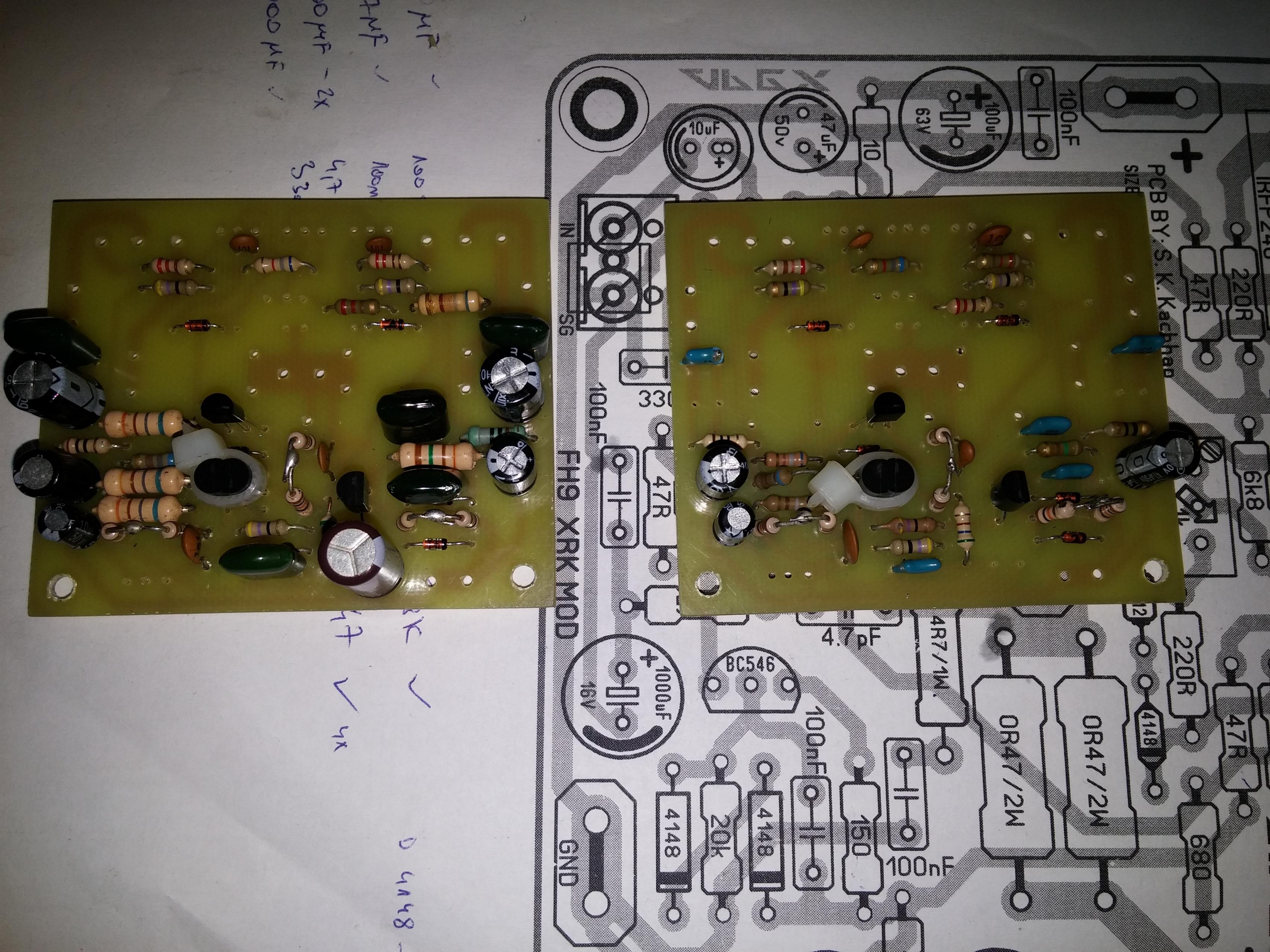

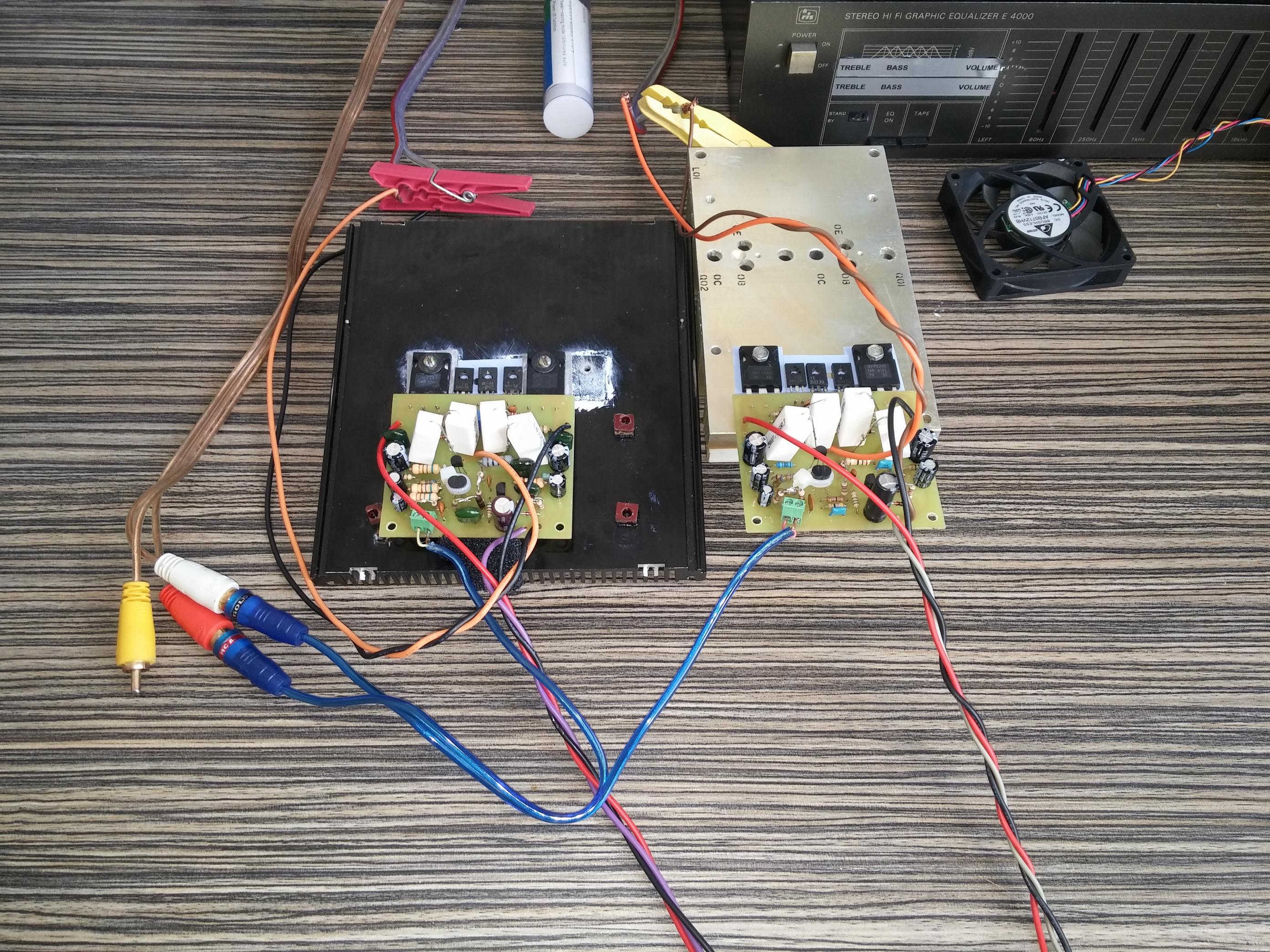

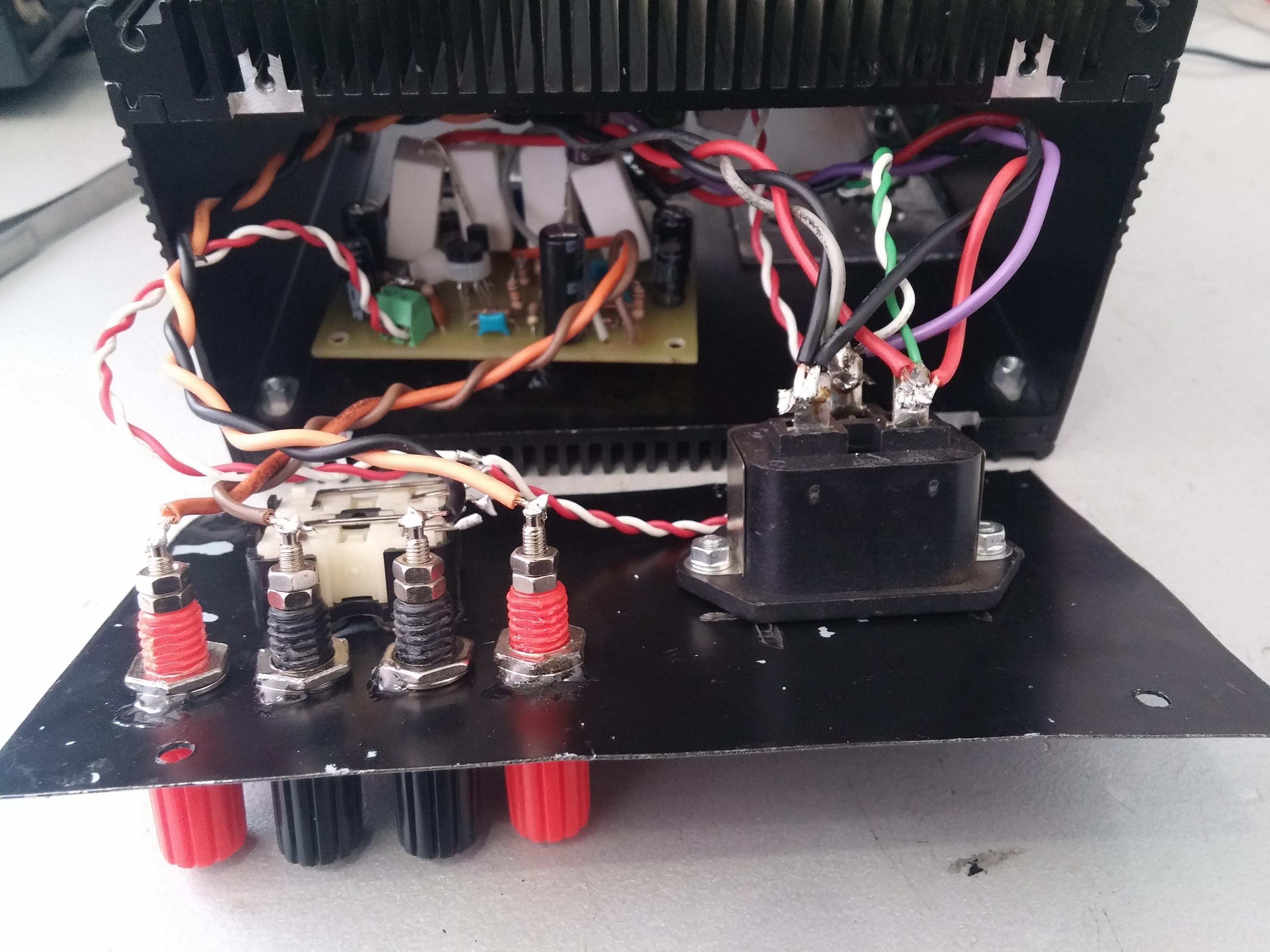

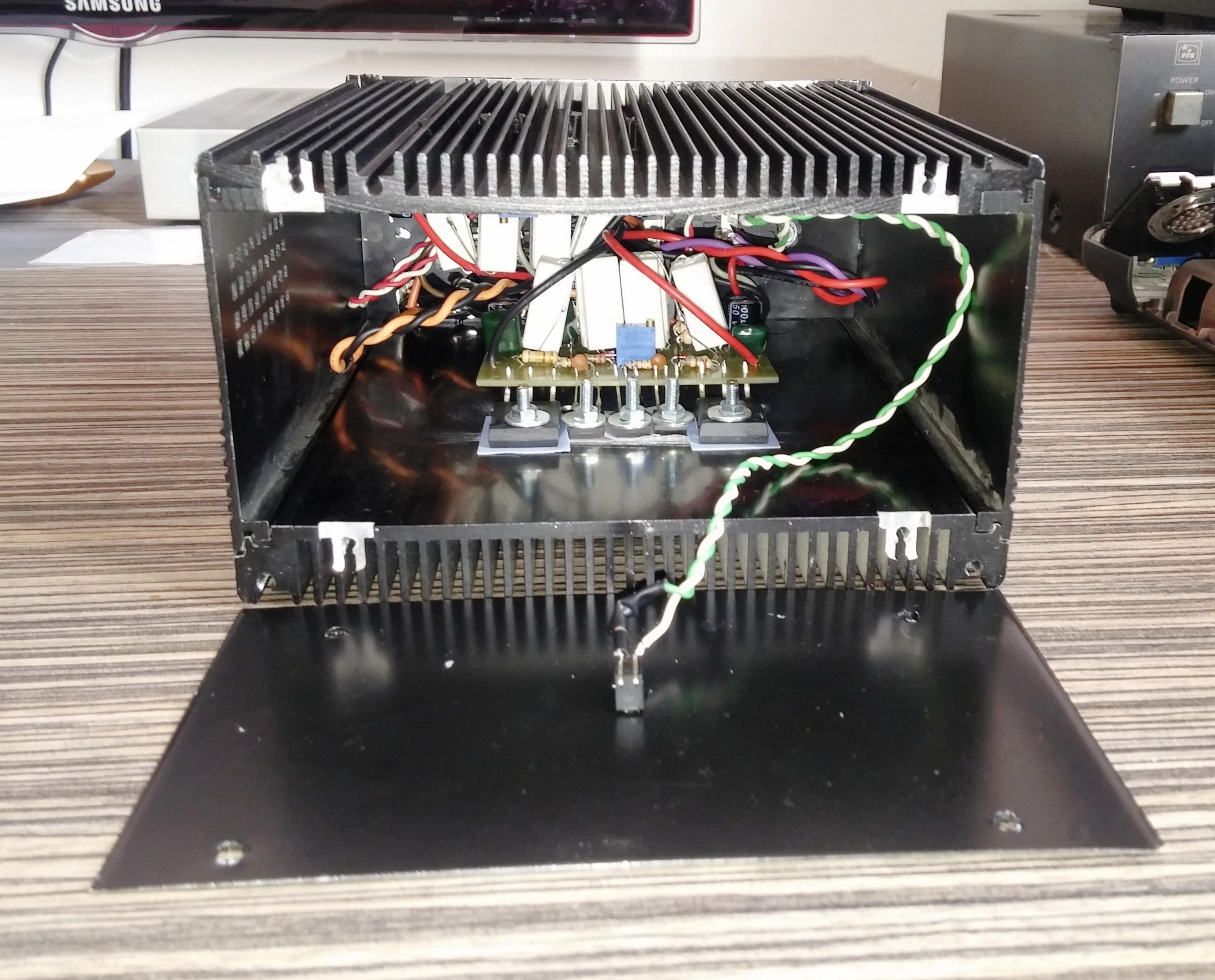

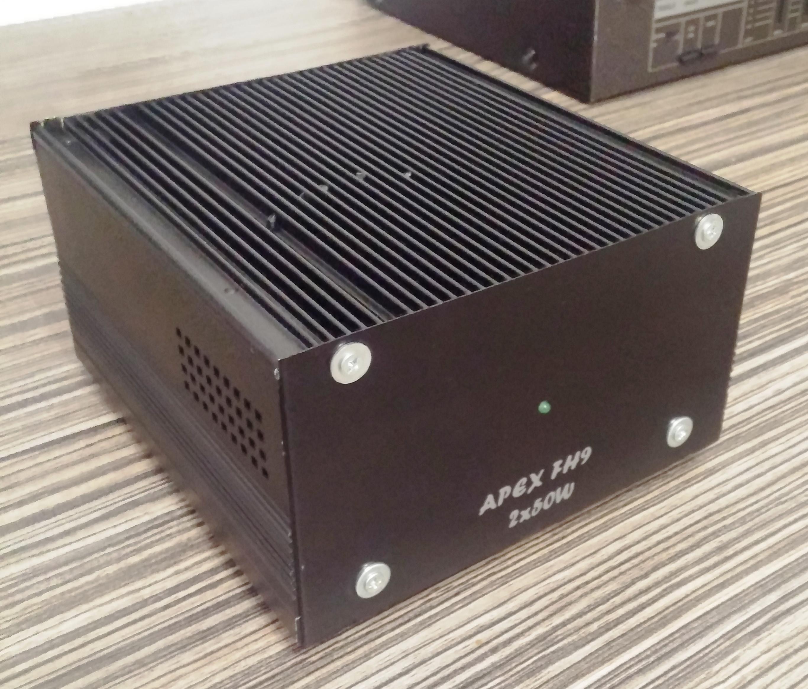

Hi to all!
I finally finished APEX FH9 XRK mode last night, everything went without hickups and with no smoke 🙂.
Sound is awesome, bass is great and details are very close to my JLH 1969 so I'm very pleased. I think it is more suitable to modern type of electronic music than JLH, but I need more listening time for finall impressions. I made it partly with scrap electronics, IRFP devices are new, bought on ebay and housing is from old Antec Phantom series PC PSU. PCBs are home made. I use external 2x22V PSU for now. Thx to mr. Mile, XRK and Sonal Kunal for this great little amp!

Hi strawa,
are you about achieving a Darwin award? You've used the wrong IEC inlet!!
Best regards!
Best regards!
Thx guys!
That inlet is standard in my home 🙂
I'm using it for connection to my external power supply, not for 220V. Salvaged from computer PSU.
I think both of you are refering to 220V inlet - as you can see in pictures there is no tranformer nor any other 220V device in the box. I simply use that inlet to connect to my 2x22V amp power supply, so no worry here. Not commercial product hehe.

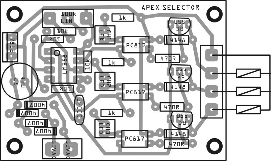

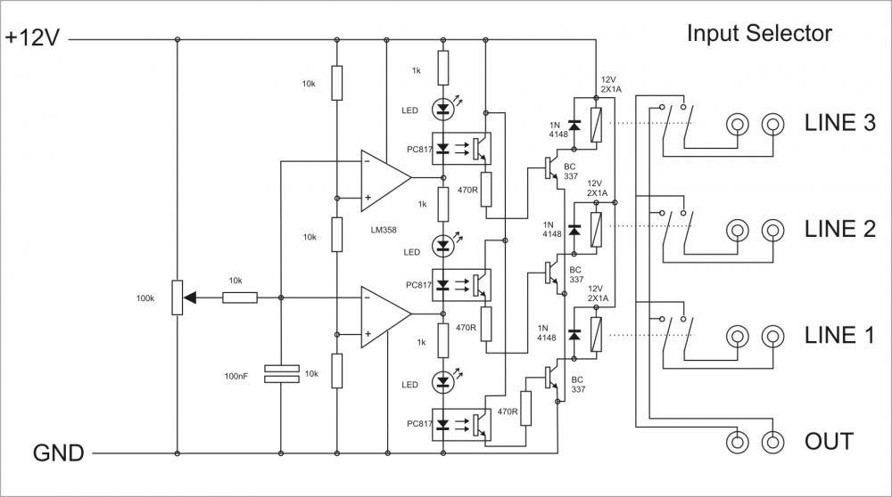

Input selector with pot.
https://www.youtube.com/watch?v=L3wJsOFejoc
Hi sir do you have the schematic and pcb for this selector? Thanks in advance!
I have only schematic
