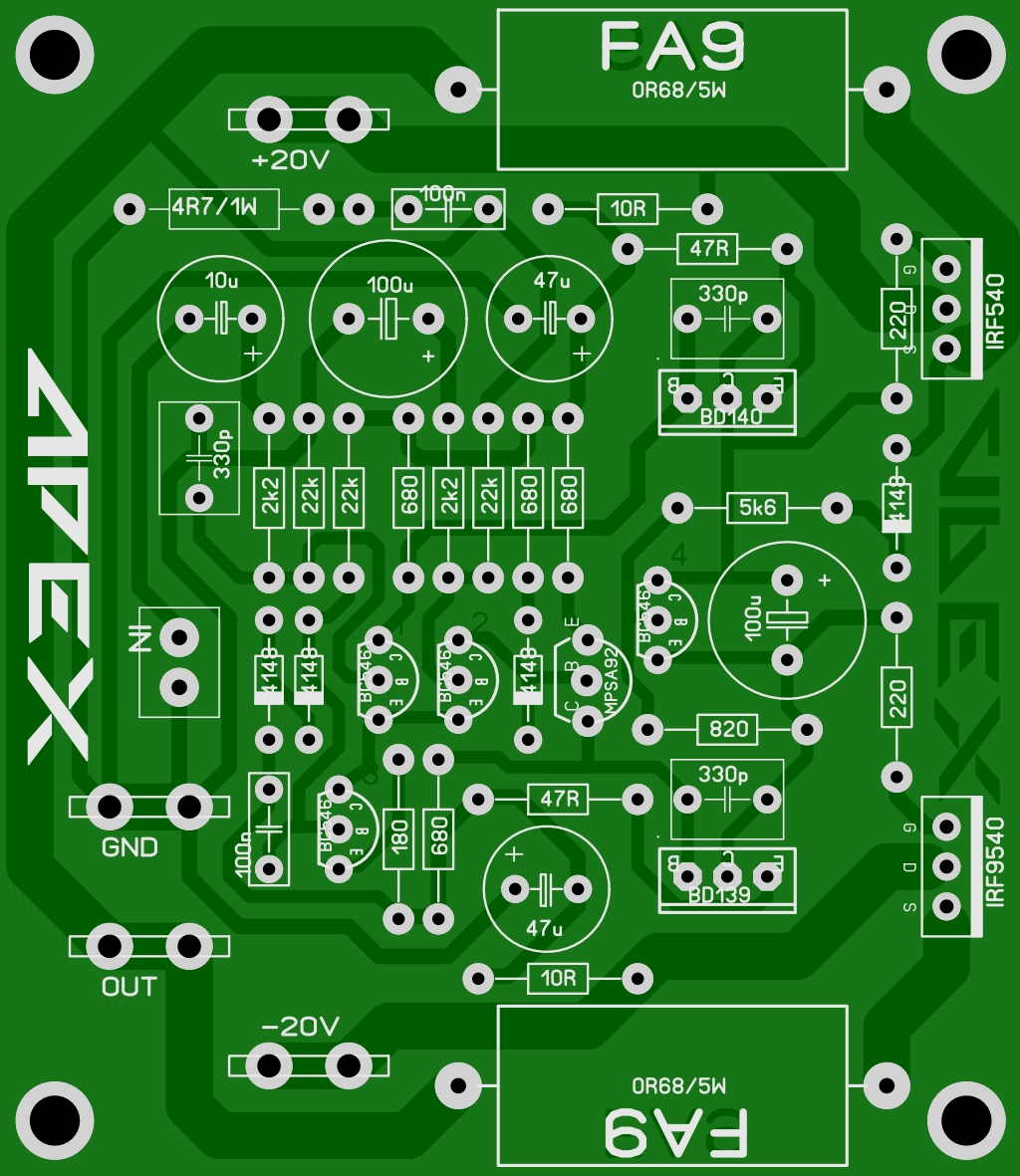

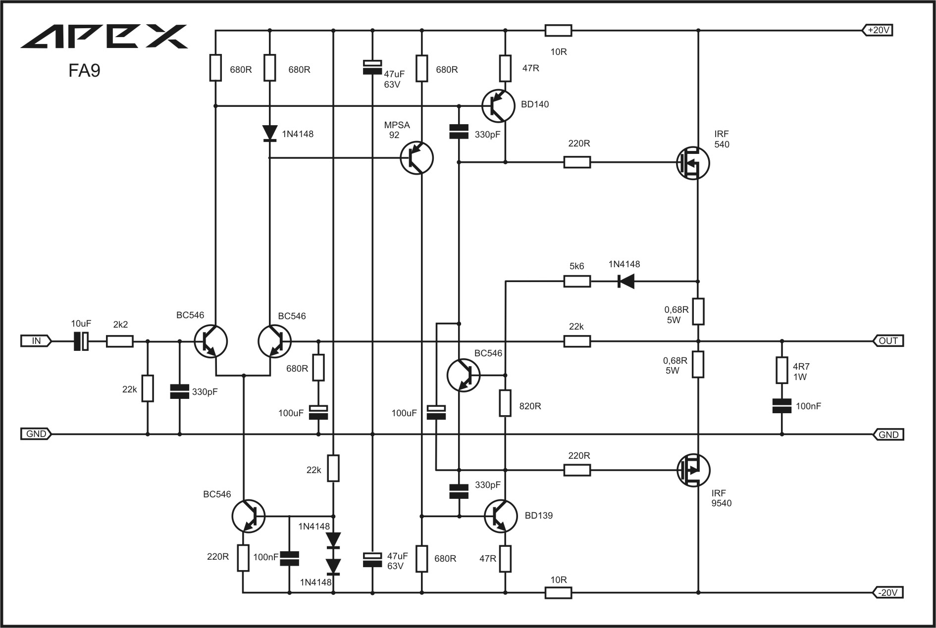

with 15k back I get 15mV --> 22mA
Remove 15k, or use 10k trimpot instead 5k6 to set bias. Heatsink temperature must be 60deg maximum.

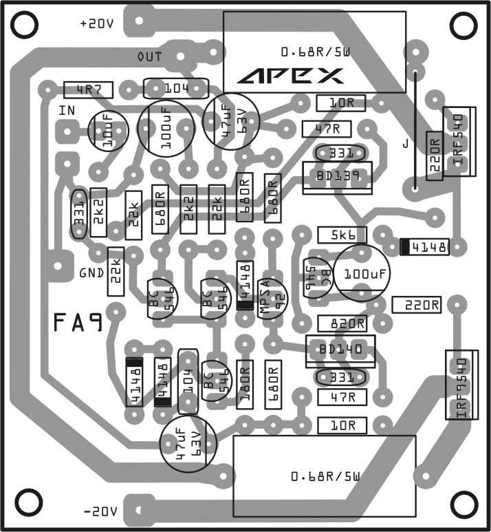

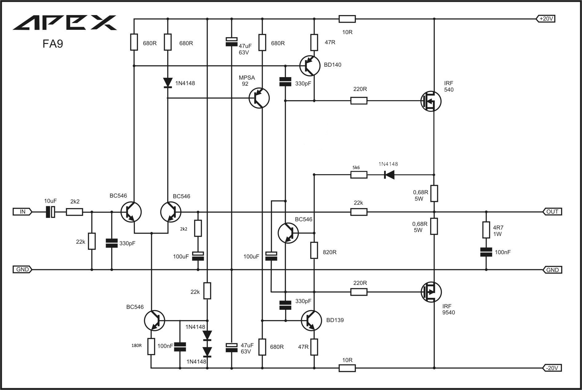

Post the final schematic as built, pcb artwork and pictures in the same post to help others![]()
FA9 sch and pcb
FA9 sch and pcb

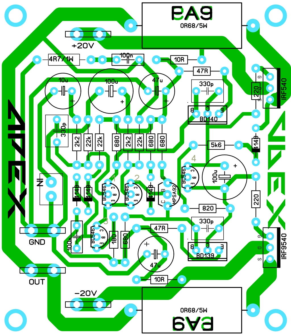

ok it`s olafk time to post the blak&white home etching friedly pcb.
Here is the Sprint-file as I built the amplifier. It sounds really good.
regards Olaf
What about heatsink temperature?
Hi, what can I say? I listened 10 minutes to the music, then it was too hot. The heat sink was too small (0.9 K / W), or I should have set a lower current.
Anyway. A new set of fets and everything goes again
Thanks to Mile for a nice amplifier!
regards Olaf
Heat sink is too small... use some fan if you want to do more tests. Heat sink must be minimum 3x larger than your.
Or build a class AB amplifier
Yes everything correct. But I like the little IRF's. They have a very nice sound. And so what! It was clear that the heat sink was too small, but I'd like to build a Class-A amplifier at first time. I will get bigger heat sinks and build a nice housing.

IRF540 is little TO220 but 100V 28A 150W, compare to IRFP240 in TO247 with 200V 20A 150W.
AA9 and FA9 is new reference in diy class A amplifiers.

Unfortunately, specs quoted are of little relevance when these transistors are used in audio circuits. In fact, IRF540 fails frequently even in low power AB class circuits if Vbe multiplier is not implemented. Big heatsink is necessary!
