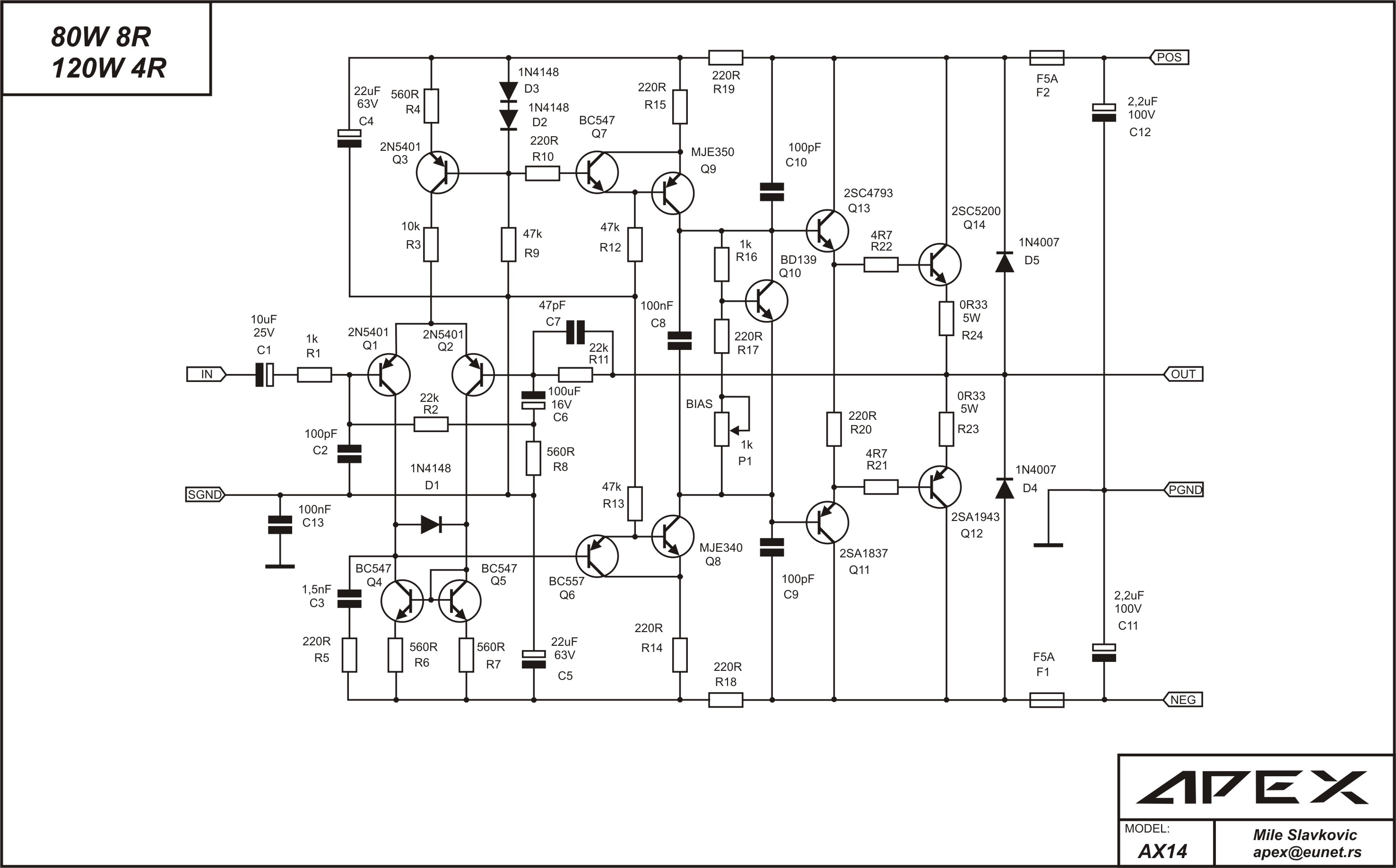

Good Afternoon Mr.Mile,
Can I use C3856/A1492 instead of C5200/A1943, if yes then do i need to change anything using rail voltage +/-56V, and which will be better c5200 or c3856 in terms of sound qualtiy and stability.
Yes you can without changes.
HI ALL !!! hI Apex,
Can I use darlington MJ11032 / MJ11033 with Apex B500 with 80 VDC ??
Yes

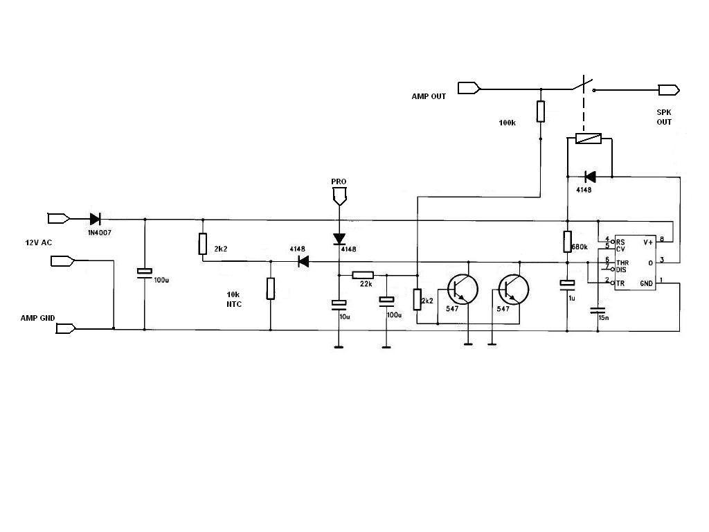

One more question, do we need speaker protection for this amp?
Thank Mr. Mile, I will extend it to 6cm more and find the way to use chassis as heatsink.

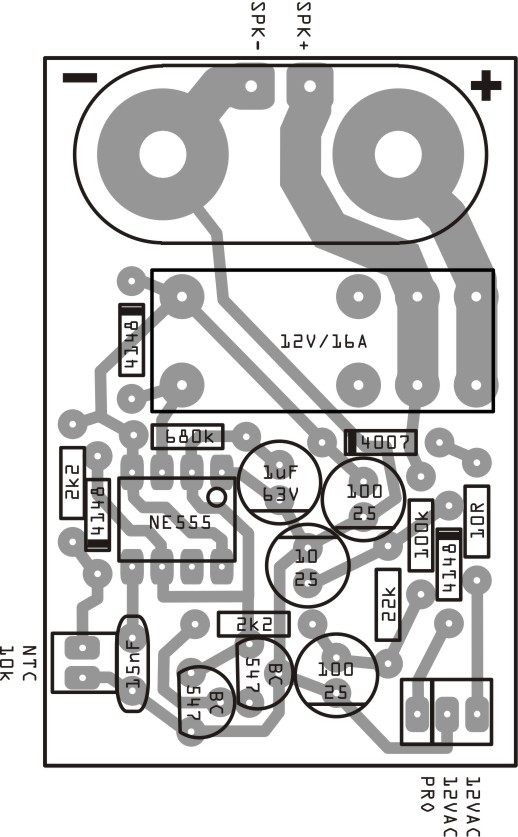

Yes use DC protect with NE555 and NTC for thermal protect.
Did you mean this one?

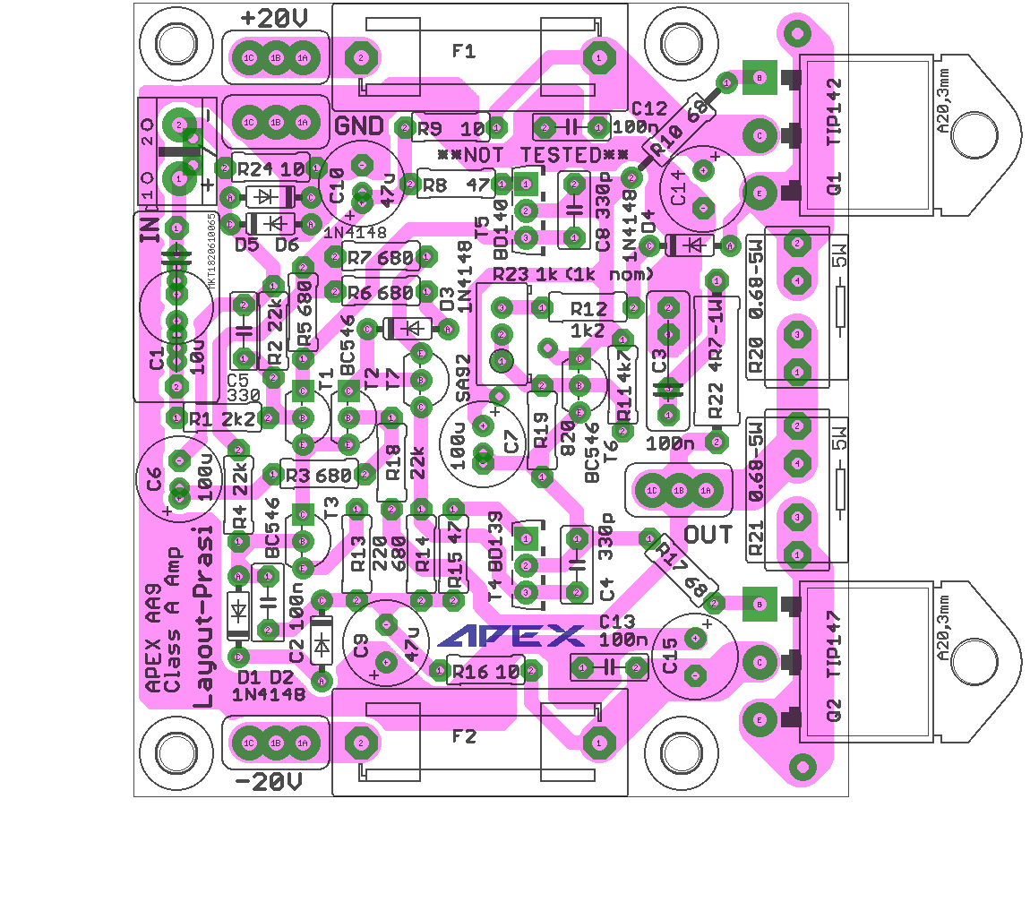

Mr. Mile,
I have added rail decoupling near the o/p device and also ground lift.
Is it recommended?
+some reduced the PCB size to 68mmx75mm
reg
Prasi
PS; many revisions, but i want to make it as good as possible.
edit: the black jumper is optional jumper to reduce the trace length from C7 to C of T6.
Hi Bob53,
here are the pdf for rev3 Apex AA9. All views are from component side.
regards
Prasi
