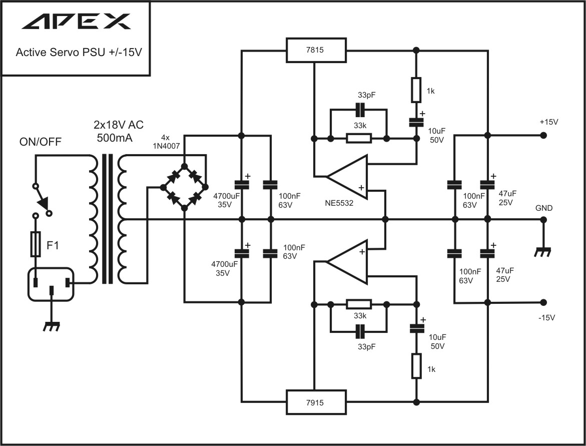

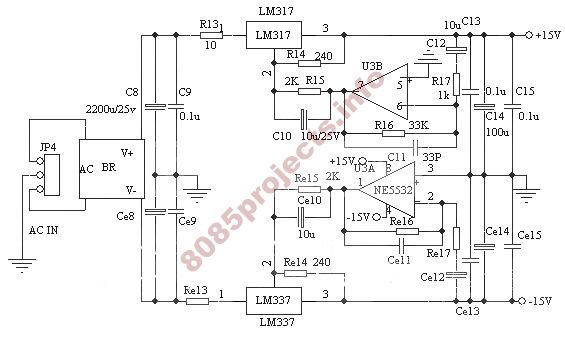

Hello.Concerning active servo psu from earlier post i found some schematics on the web.In the lm317/337 variant i will replace the 2k2 resistors with 5K trimmers to have variable output.There are versions with the value of feedback resistor being 33K and others being 3.3K.Which one to use?
Use 33k

Use active servo psu with LM317/337

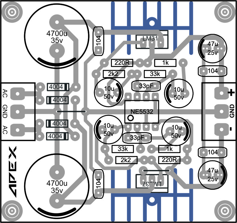

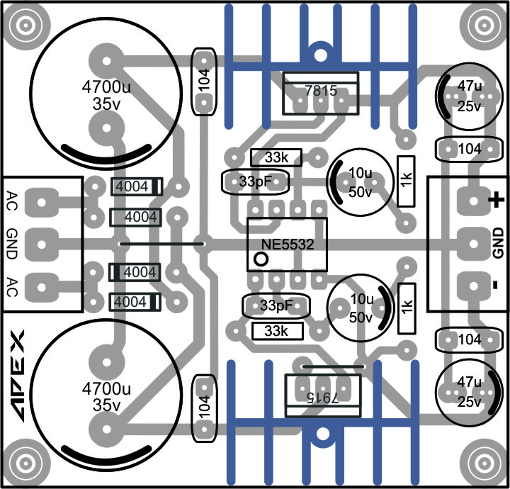

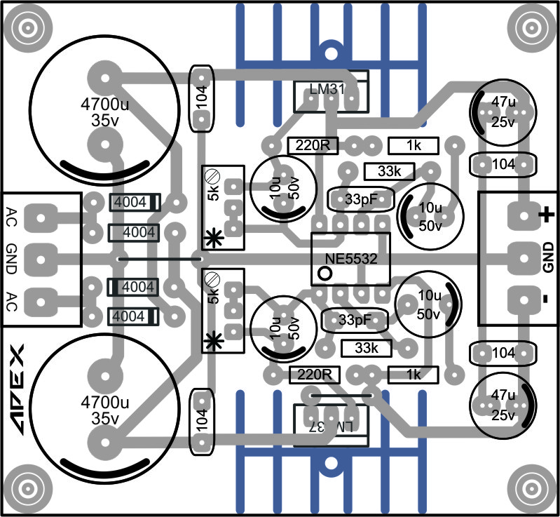

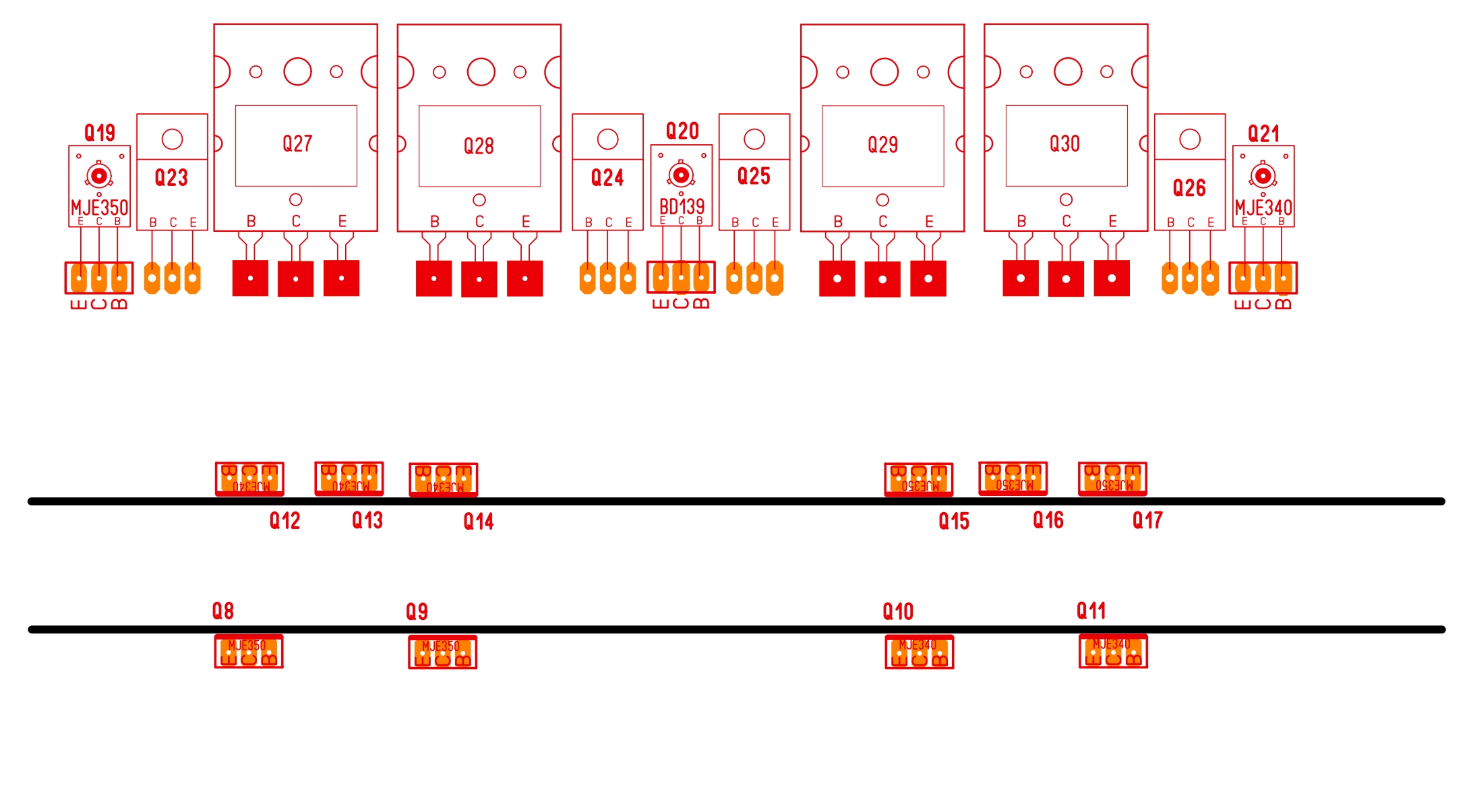

Please check this layout, i attach psu with 7x15, LM317/337 with and witout trimpot to adjust output voltage. If ok, i'll provide pdf files.
Regards
do you do the layouts for apex?, they are almost same
in my opinion, its better to keep the trim pot.+ there are some requirements as per data sheet of LM. do read it.

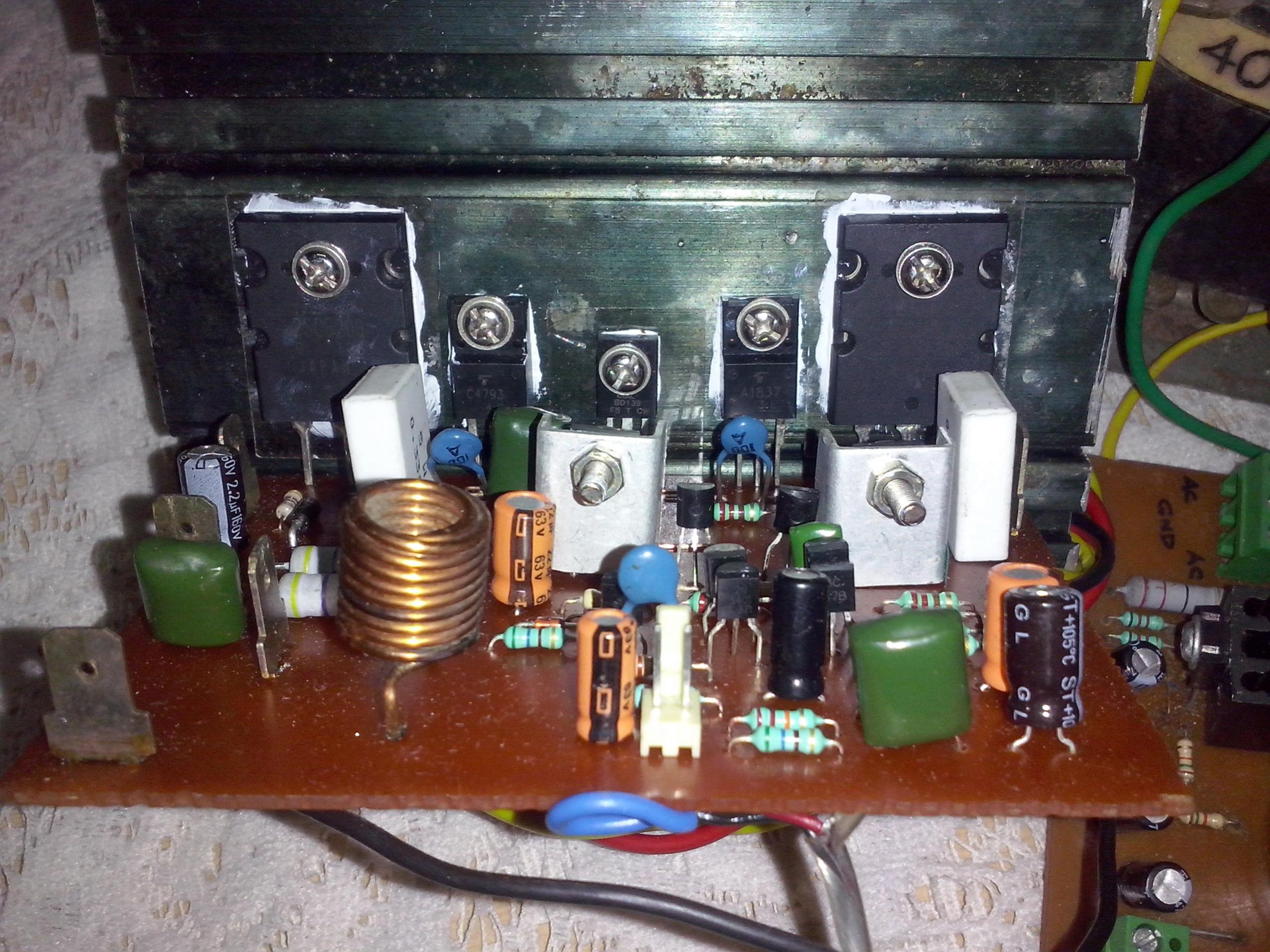

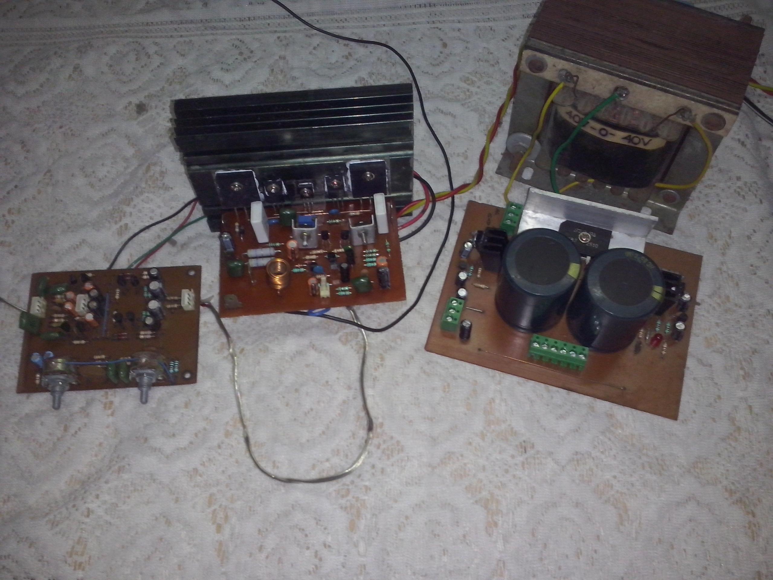

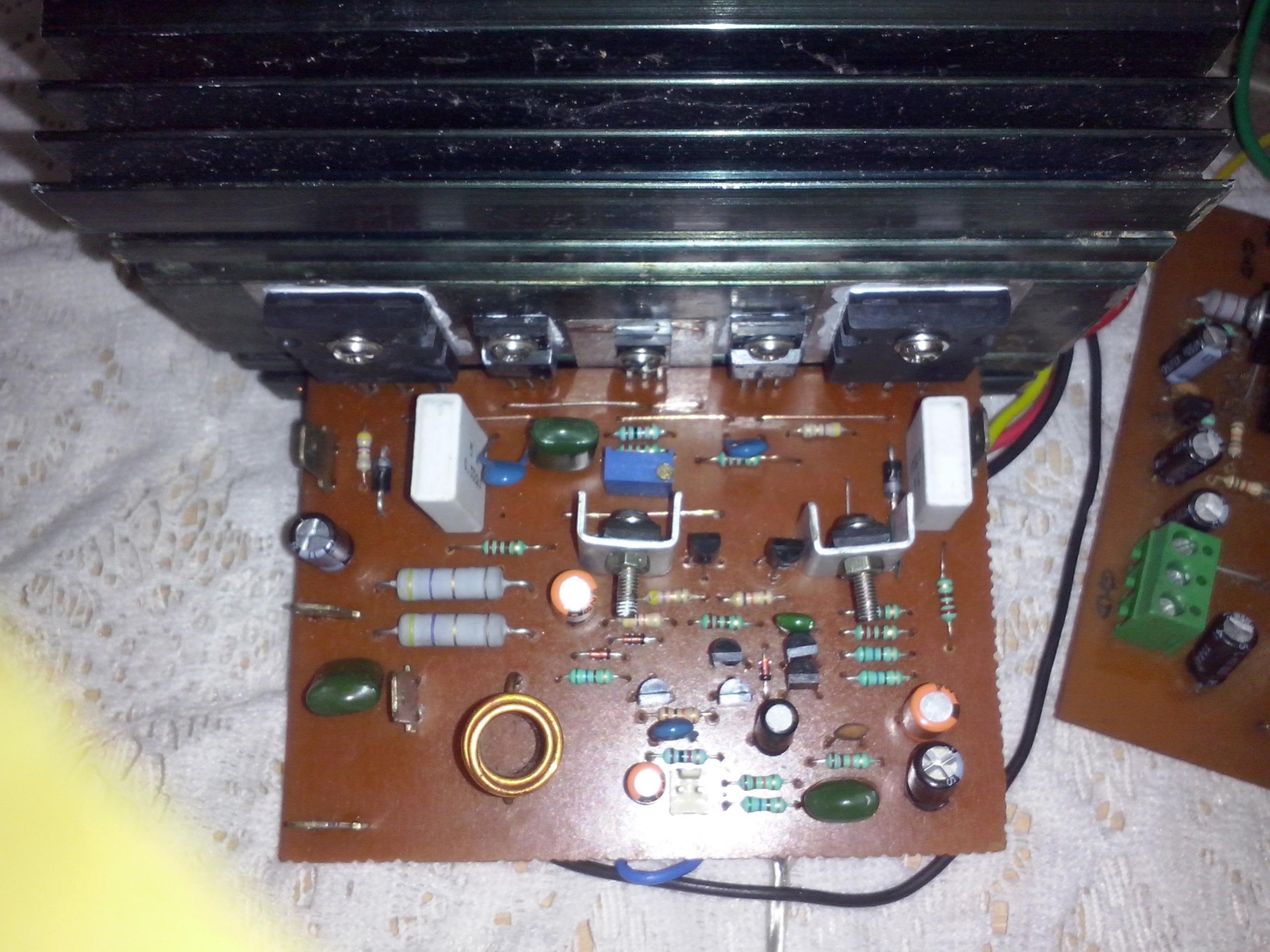

Apex AX-14
This i made as a test amp, now I'll build a stereo version in a single board. Need some more help from you regarding protection circuit.

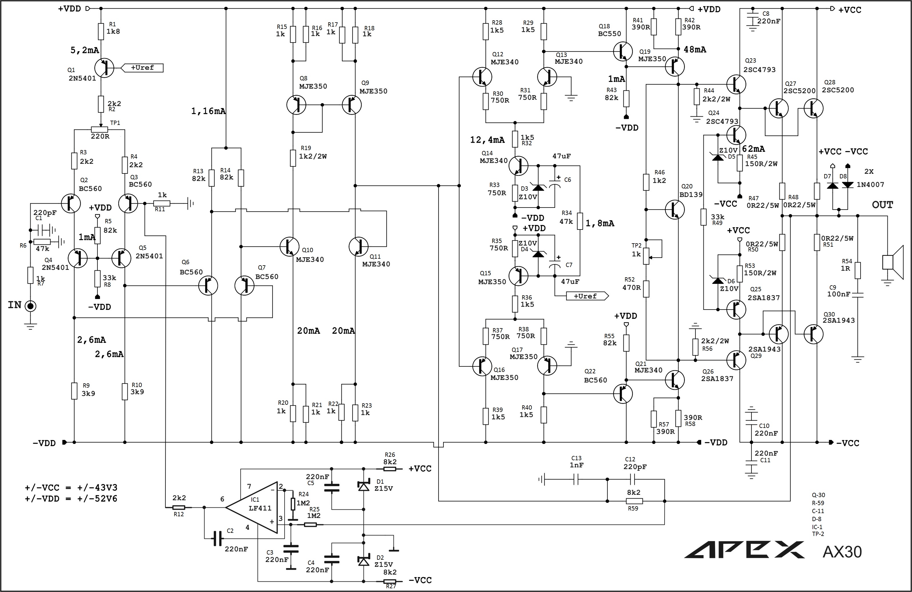

I haven't check for possible wrong connections but i must say that is a clever clear schematic diagram!i have done some prepairing to draw a pcb for APEX AX30:
