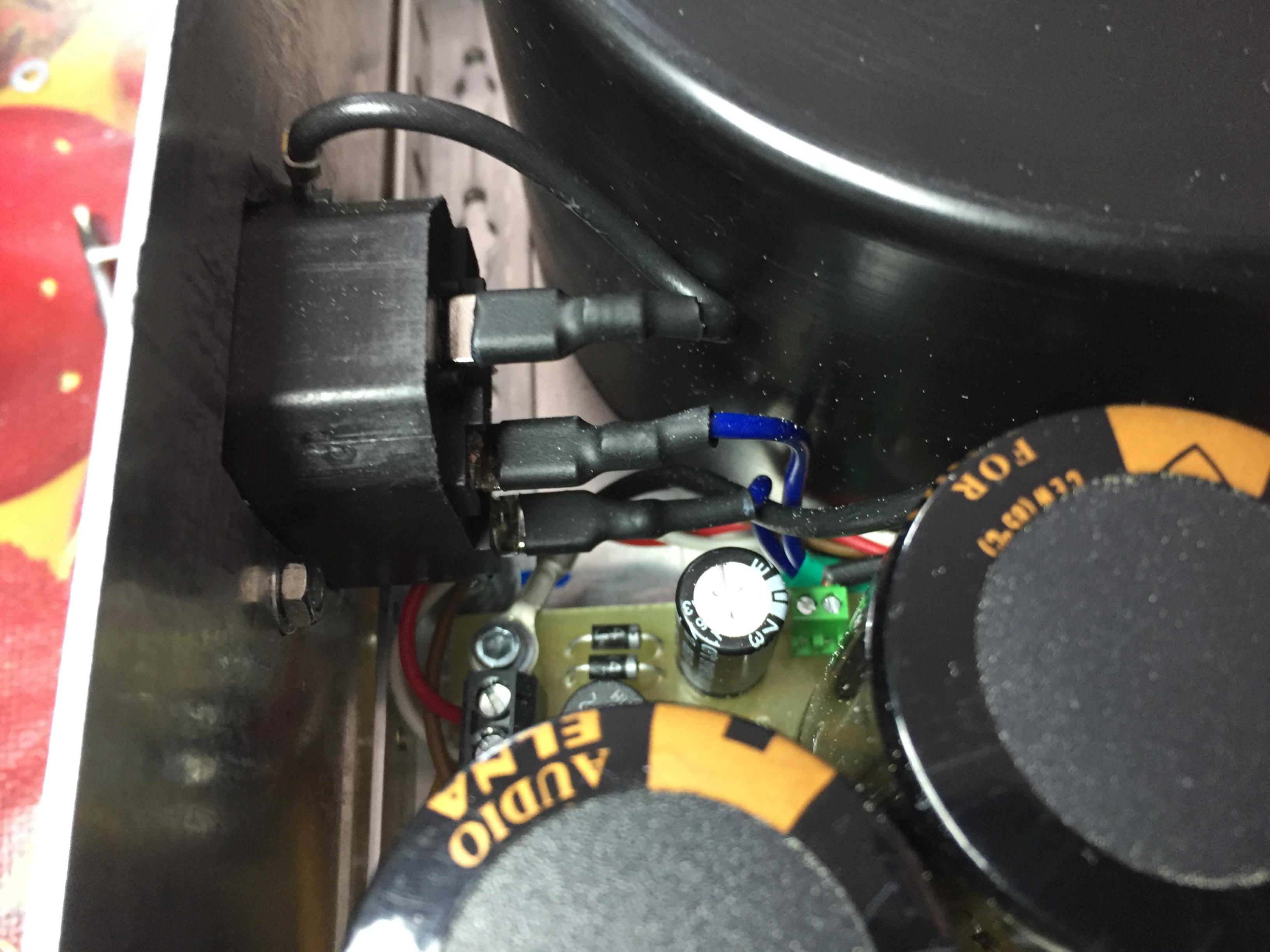

Nice clear work but i can't see the safety GND connection.
This is absolutely necessary for your metal chassis.
Safety reasons!!!

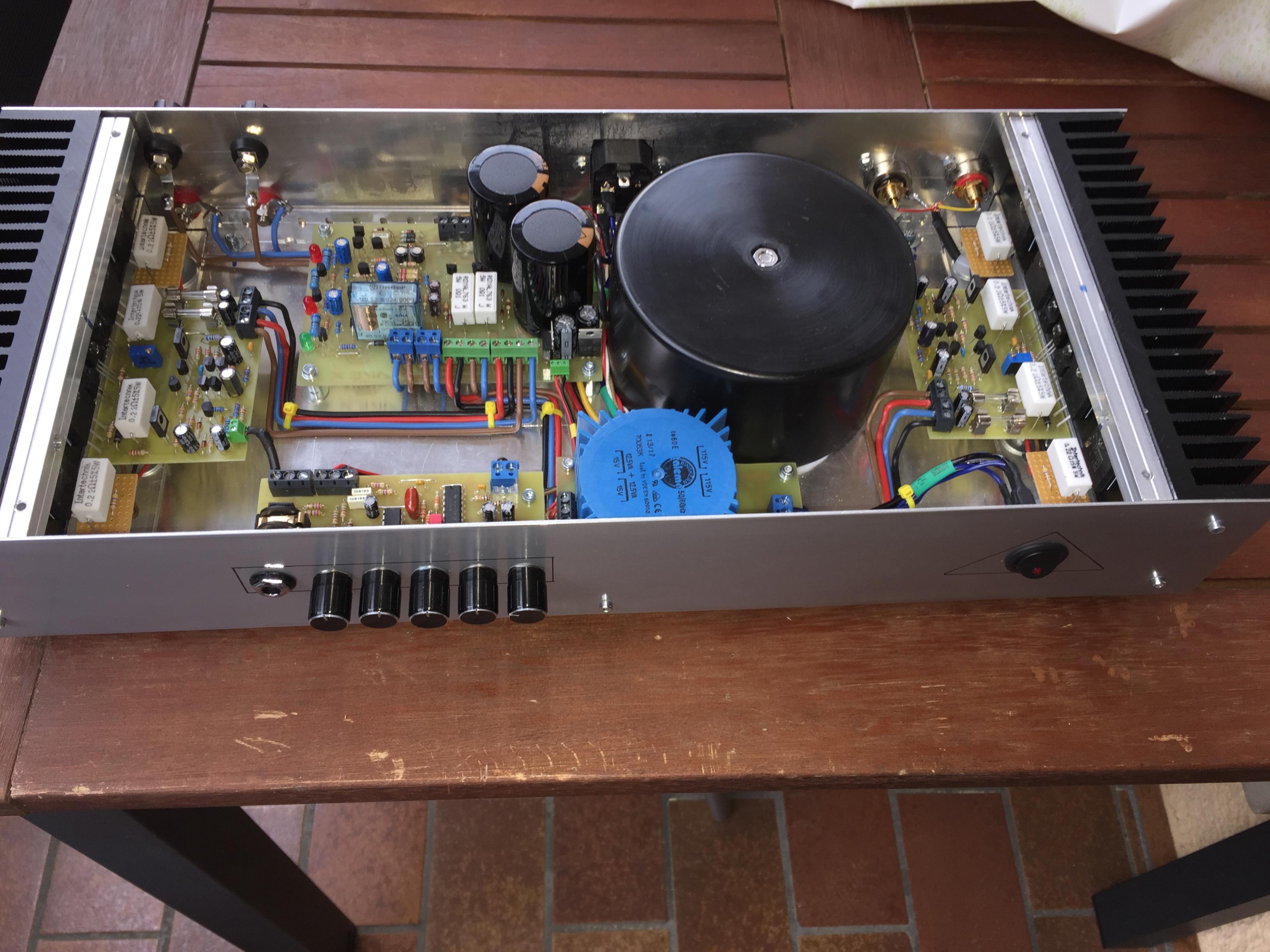

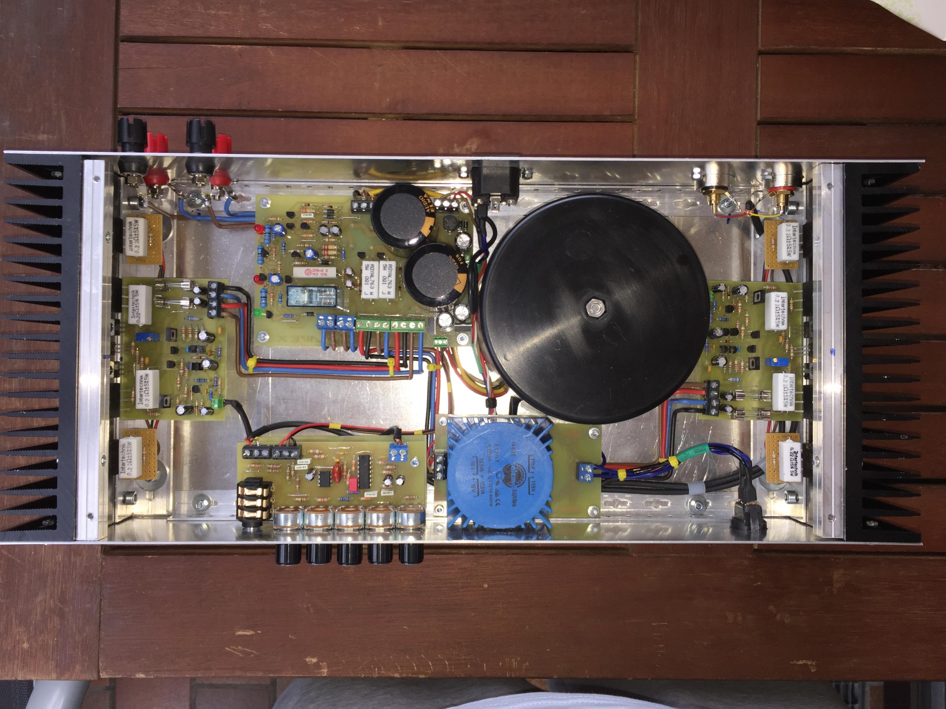

DC 50-0-50,bias 45mA, offset 3.4mA
Thanks to Mr. Mile and the members of this forum
Very good case and buid Fuego
Which tone control you use for your AX-14
thank youNot safe yet!
3mm screw isn't enouph for a safety GND connection.
Use Y cable and connect the second cable at the bottom
of the metal chassis using at least 4 mm stainless steel screw and grovers.

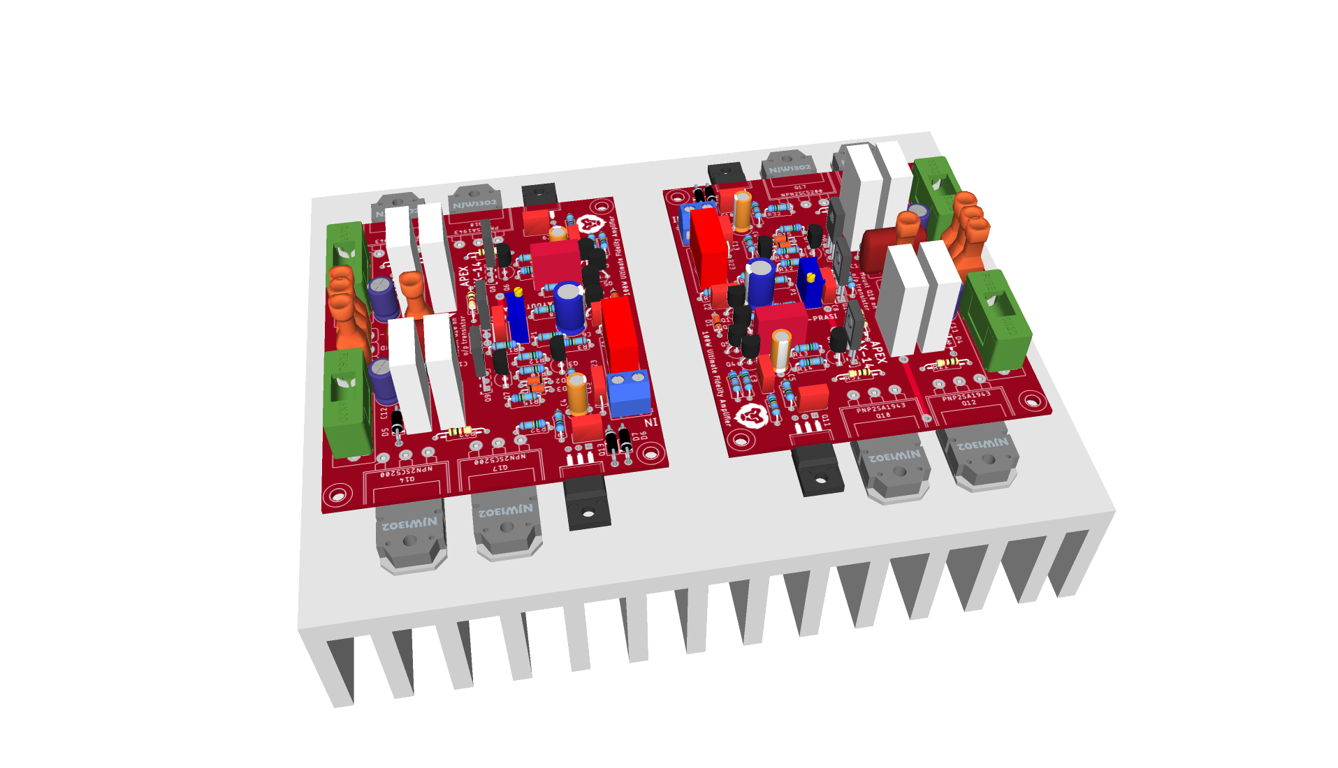

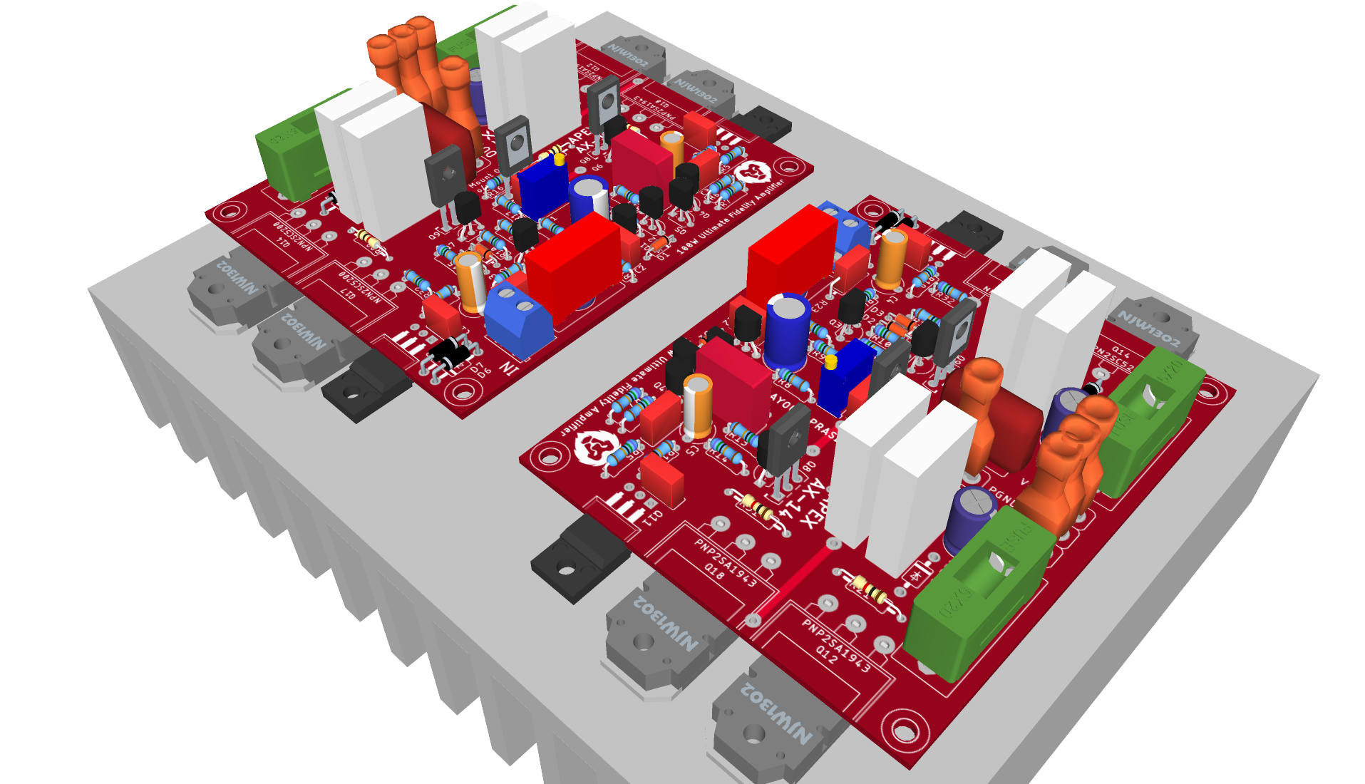

2-pairs AX-14, stereo can be fitted on 196mm x 150mm heatsink 196MM width/150MM length extruded aluminum heat sink.
fan cooling for keeping things cool.

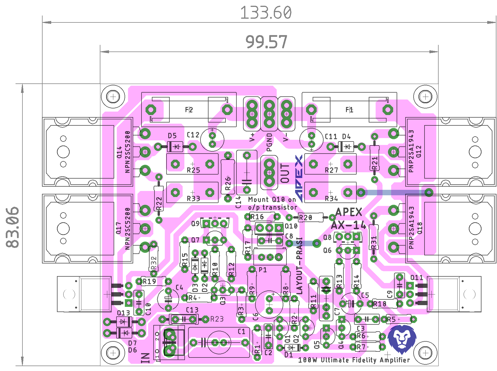

Excellent Mr. pcb!
I like this configuration with +/- wires close together.![]()
Thanks Mr. DIY!

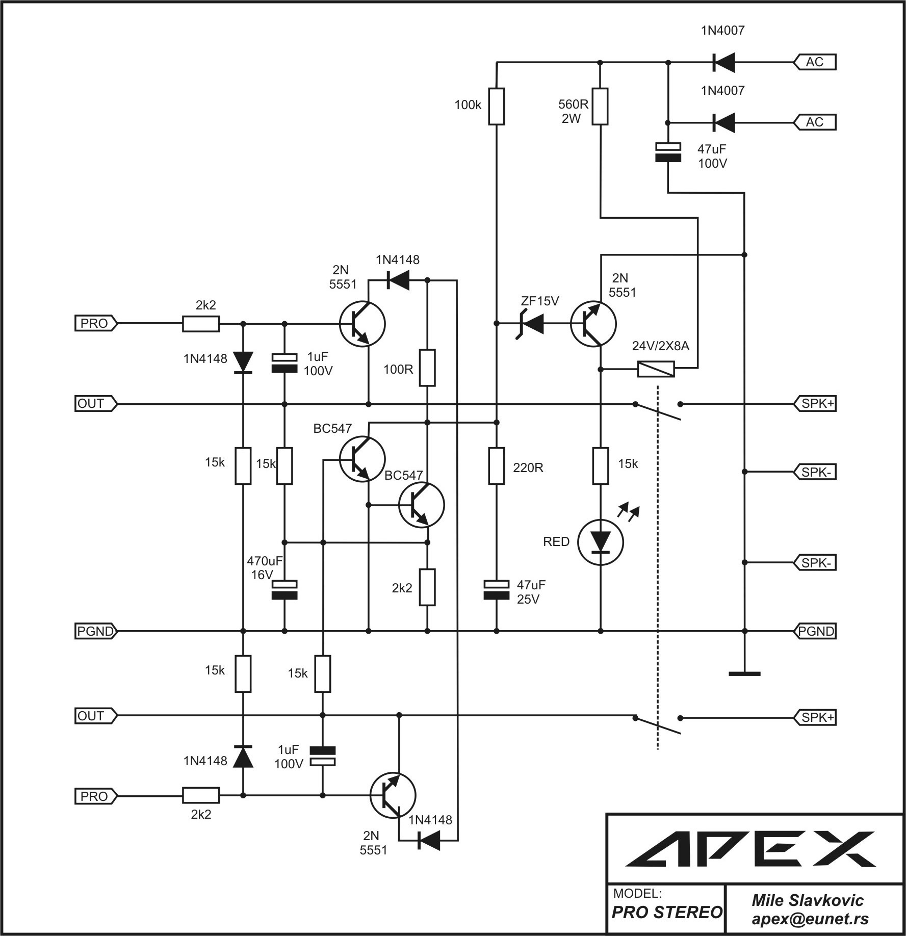

Hi friends,
Posting here a PCB layout for "APEX Stereo Protect" kindly see and suggest me something I am missing, so that I can improve, once verified I will post the PDFs.
Thanks and regards.
Anoop
Dear Anoop,
Please post the schematic used by the side of the PCB or in the same PDF file. This will help a lot of questions.
--Sarma.
regards
Prasi
Nice! master pcb..
regards
Prasi
Prasi perfect [emoji122][emoji122][emoji122]
