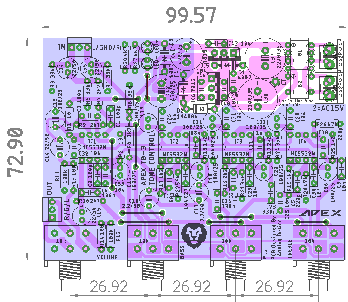

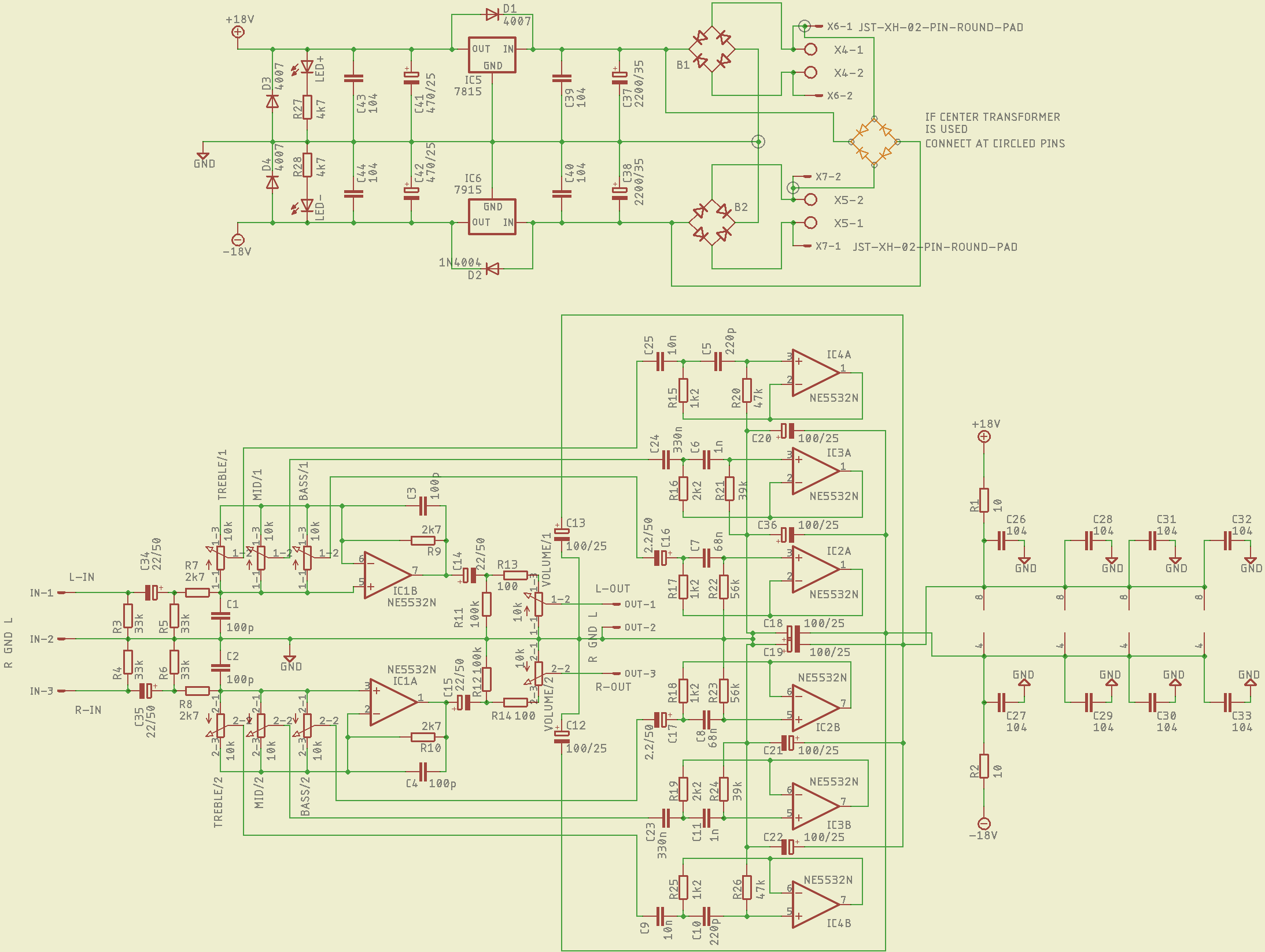

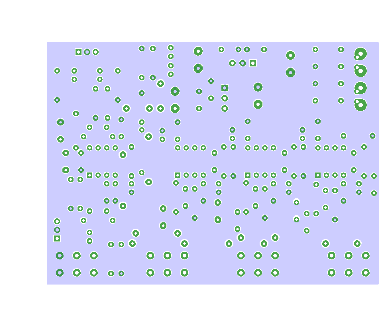

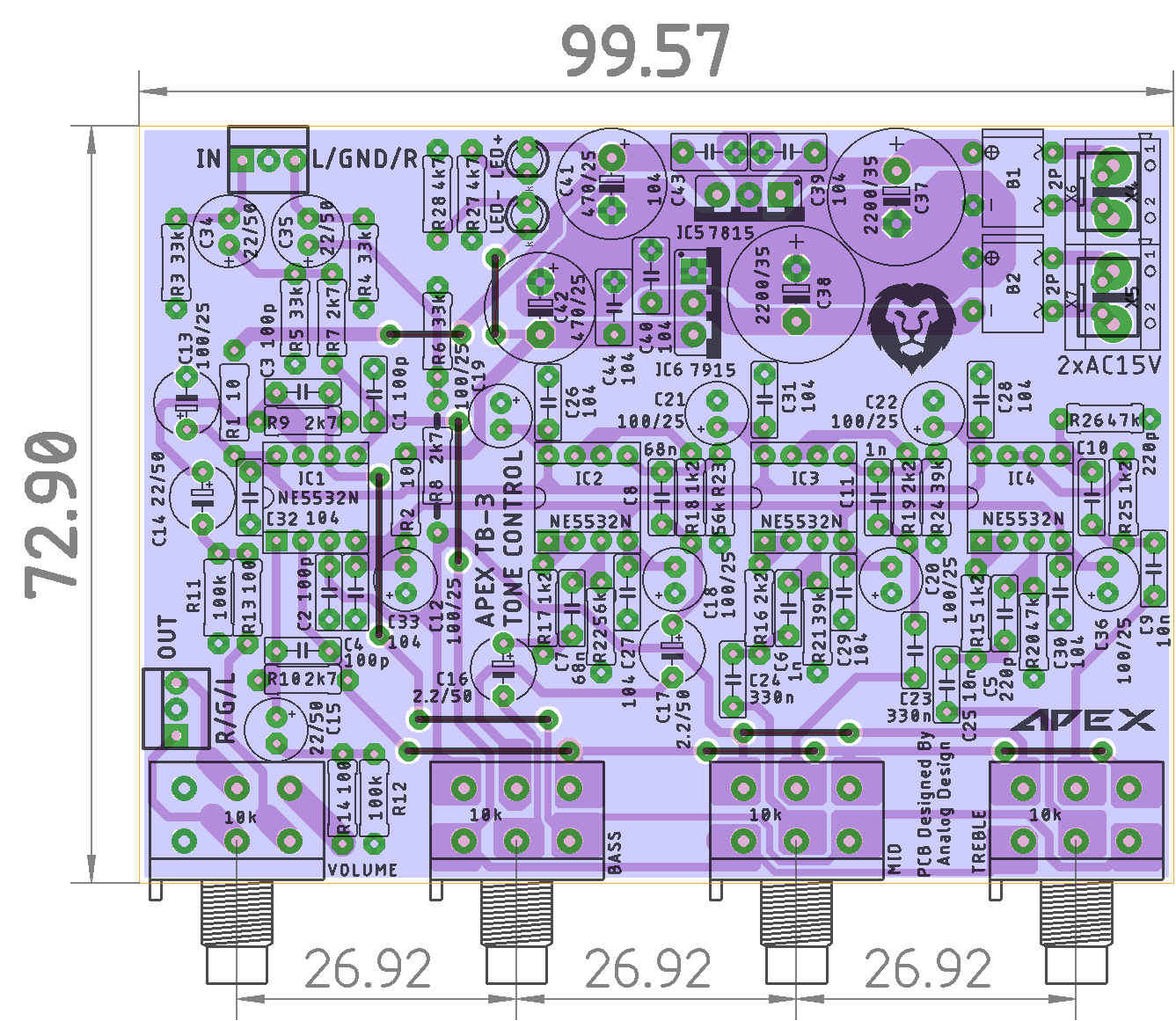

Mr. Mile,
A version of TB-3 with supply. Could you please check the schematic ? Is layout ok?, although quickly done and not refined...
blue is top ground plane. not diy friendly, but cheap to manufacture.
regards
Prasi
here is refined ver, still using jumpers so as to have contiguous ground plane without slots. second attachment.
regards
Prasi
Nice design. LM317/337 are known to be better than 78XX/79XX for PSU.
Sumesh

here is a version that can use either dual secondary or center tapped. Hopefully, I got it correct, If not some one please correct me.
For dual secondary , connections are straight forward, as per the earlier schema.
For CT, one could populate single rectifier at circled pins, AC wires also at circled pins of termi blocks and CT wire at the circled via on ground.
Also changed grounding a bit to isolate high ripple areas and incorporated 'safety' diodes. Basically the psu is almost same as that of ESP P05-rev0

So are many others, including LM317/337+ shunt regulator (by Nazer) for which I did a GB some time ago. + few more.
However, for this kind of circuit, LM78XX is more than adequate and I want to limit real estate taken up. You are free to experiment with your own versions / variations of PSU

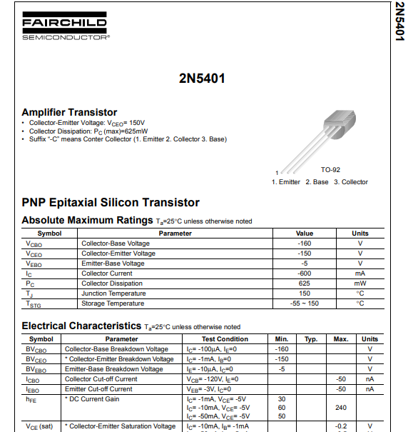

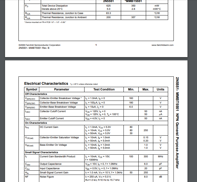

Bot transistor pairs are still available, both of them high voltage transistors a good replacement will be more difficult to get or more expensive.
Thank you gaborbela for the quick reply.
Yes, both are still available. But I am finding difficulties in finding genuine ones from local shops.
Also, I am concerned about the hFE difference between 2N5401 and 2N5551(attached the spec) from Fairchild. Does it matters for A40? I might be wrong. Please advise.
Thank you.

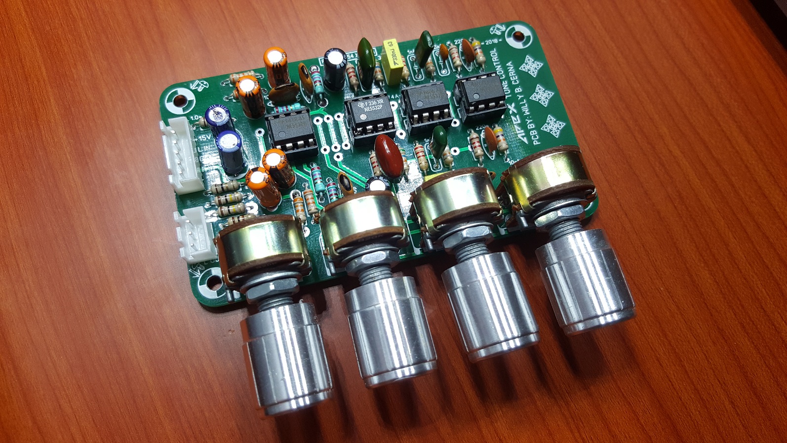

Nicely done, very professional build.

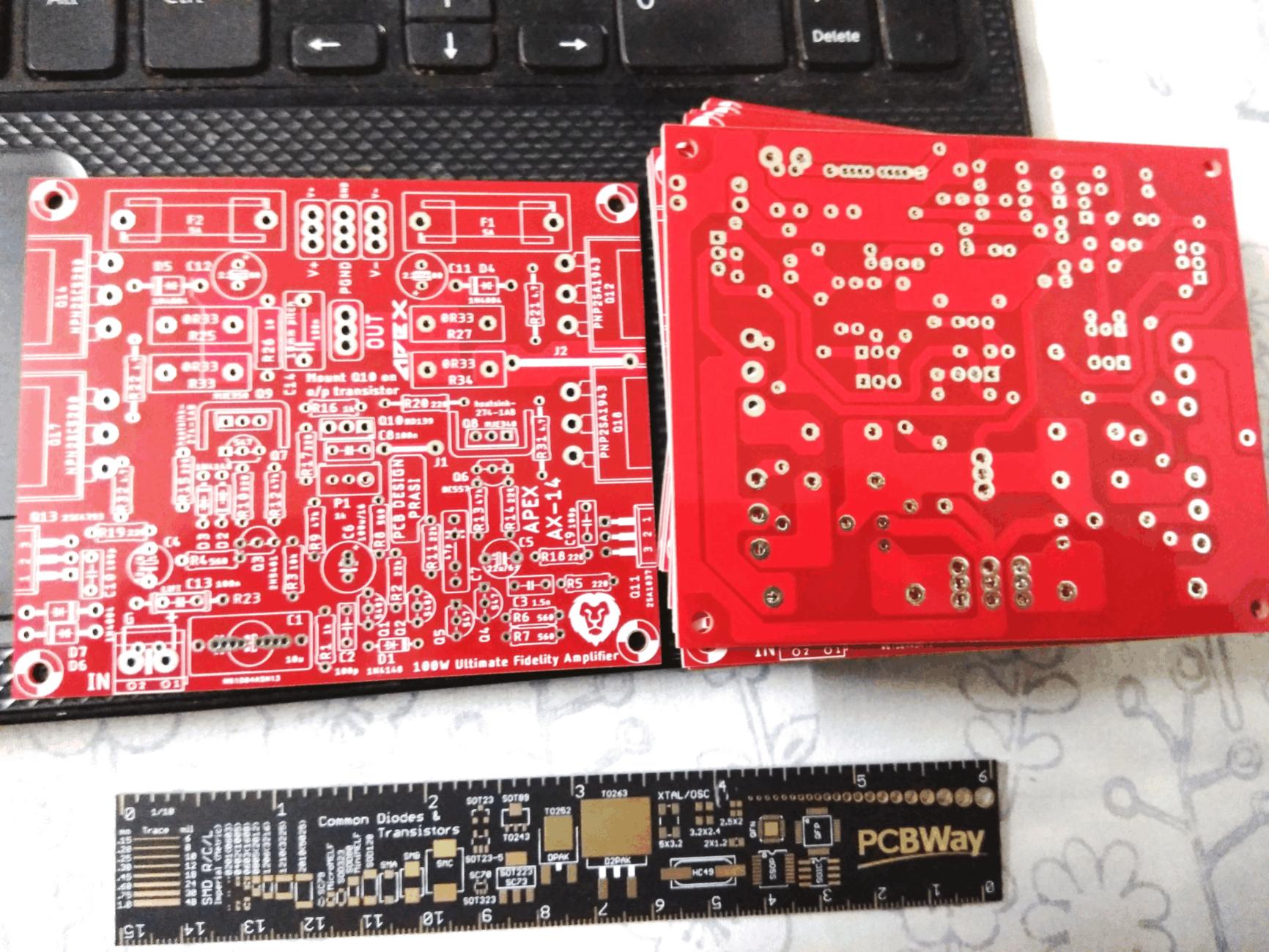

Nice little PCBs from PCBway ! also look at what a nice little free gift PCBWAY included in exchange for some accumulated coupons. It gives a very good visual perception of different devices and trace widths, which is not so apparent during PCB designing. Being loyal to boardhouses has its advantages
