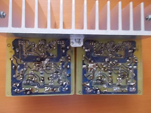

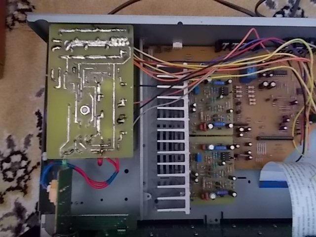

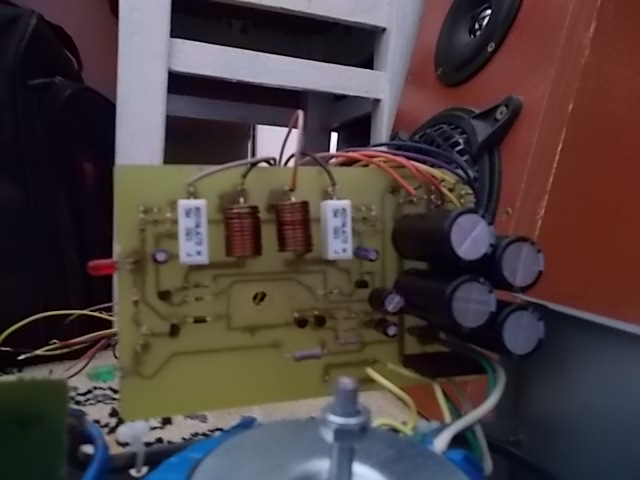

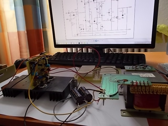

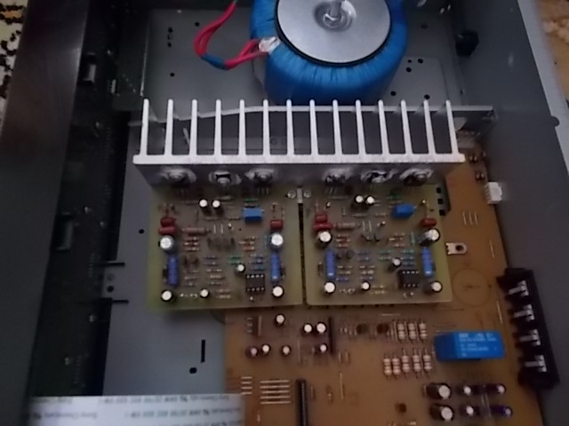

Hi to All,
Thanks to Mr. Mile for shared so many projects and to Sonal Kunal for PCB.
First I built an A9 channel and tested it. Working from the first start. + 35 0 - 35 V rail, offset 1,4 mV, 30mA biass and perfect sinewave on scop, no oscillation, hum or noise. Nice sound. On out I had 42 Vpp, 42 x 0.707= 29,7 V, 29,7x 29,7/8 = 110 Wrms. It is correct ?
I use my old Sony TA-F261, replace STK 4182 with two A9, PSU and protector.
Rail is + 41.5 0 - 41,5 V cc, transformer has 200 VA. I can't adjust bias, I have 56 mA and 36 mA. When connected the speakers, at one channel both IRF's are distroyed ( drain to source is wire) I use those speakers on Sony TA-F330 and I had no problems.
It is to much rail?? For this rail to be replaces IRf 540/9540 with IRF 240/ 9240 ??
Scuse me my english
Regards
Cornel

Hi Cornel,
Although I couldn't locate sch, from layout posted here
100W Ultimate Fidelity Amplifier
and here
I think 42V might be too high for BD139 and BC550/560.
and from the second layout, it is evident that you can use IRFP240/9240
sorry i am not able to help you further, may be olaf or apex will shed more light?
regards
Prasi

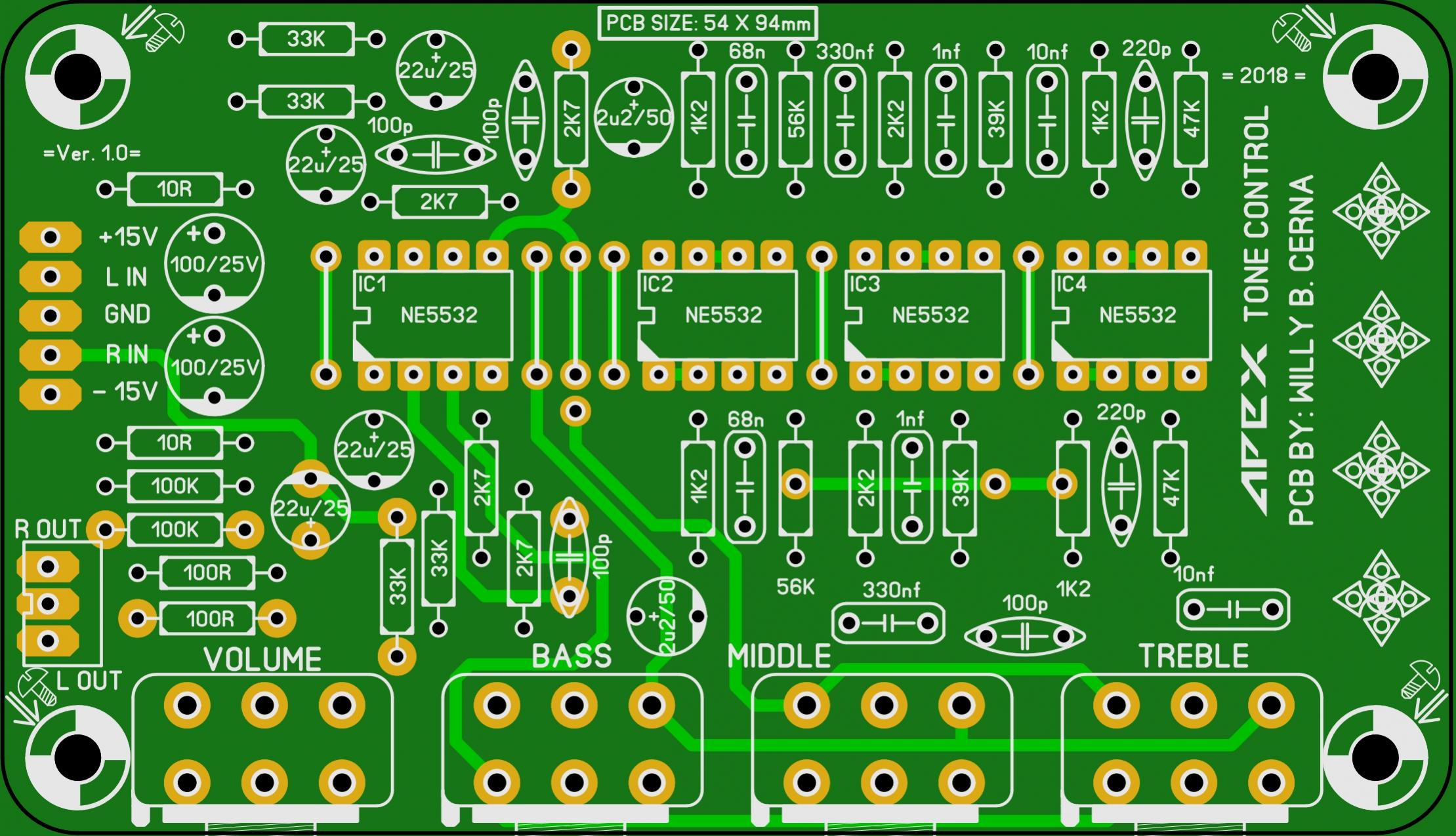

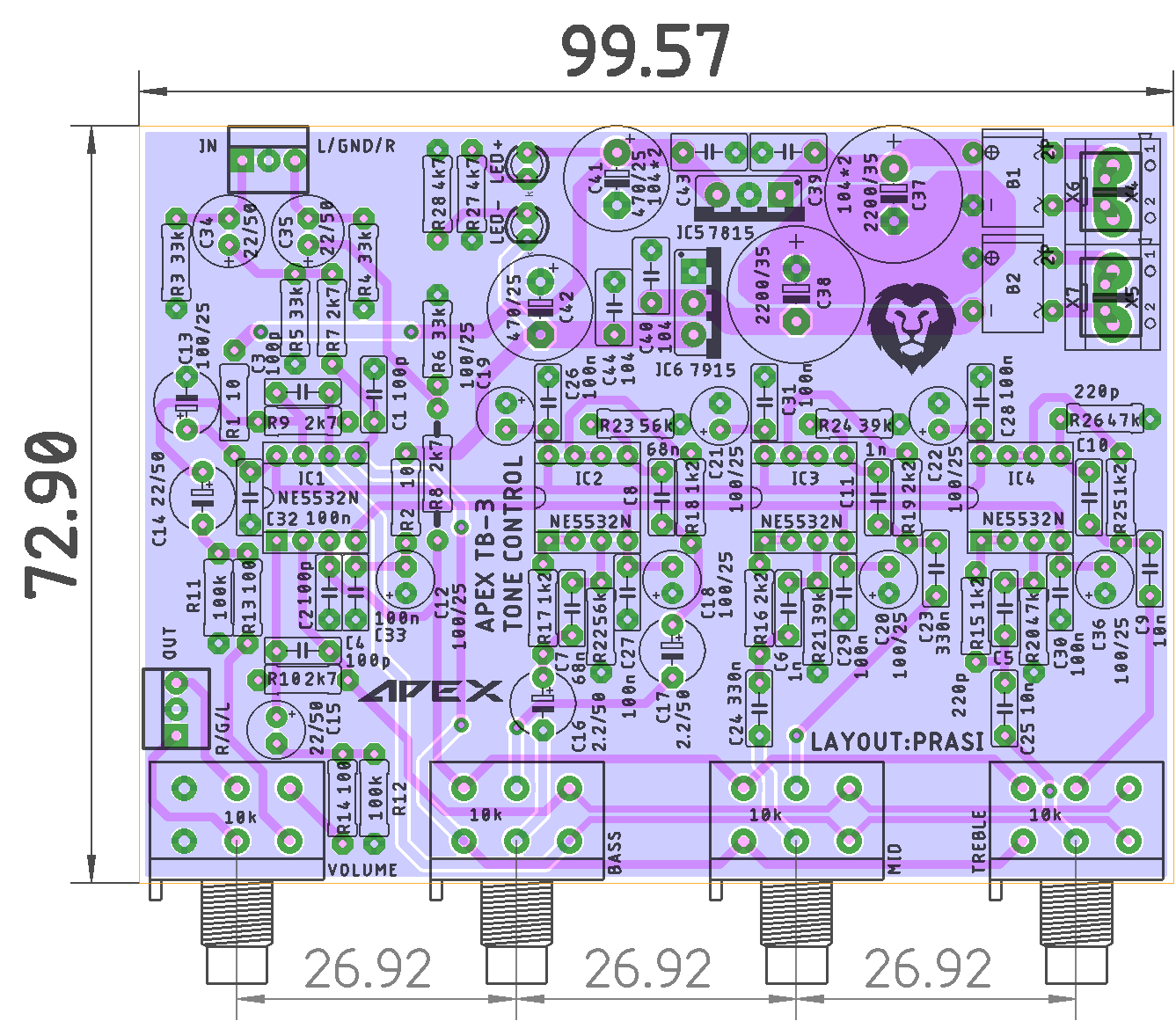

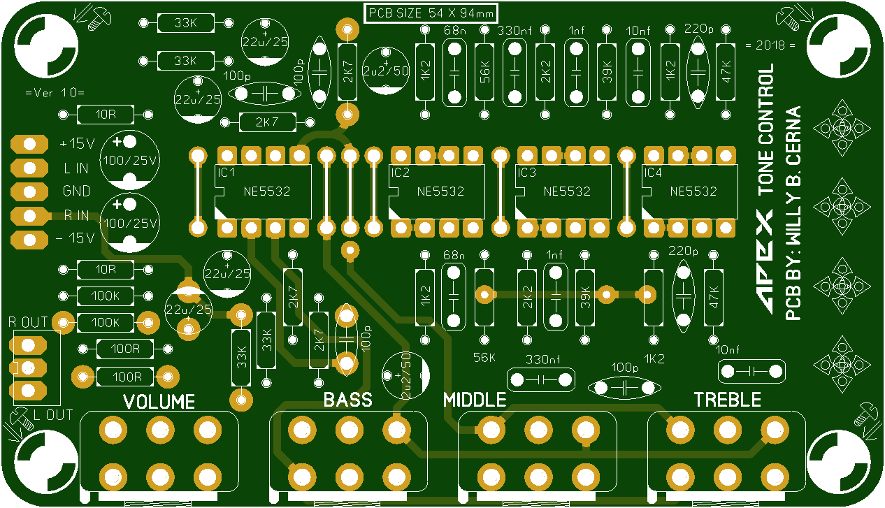

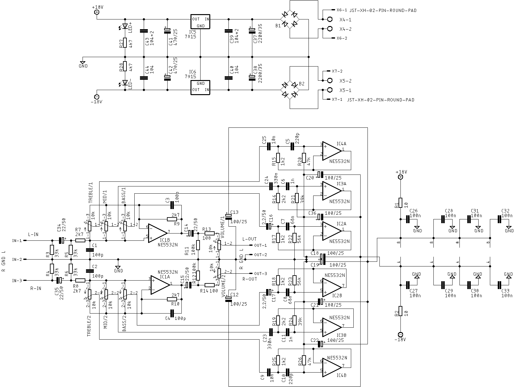

Hello Willy,
Nice!. I dont see 100nF cap across pin 4 /gnd and pin 8 /gnd. Is it smd located on bottom?
regards
Prasi

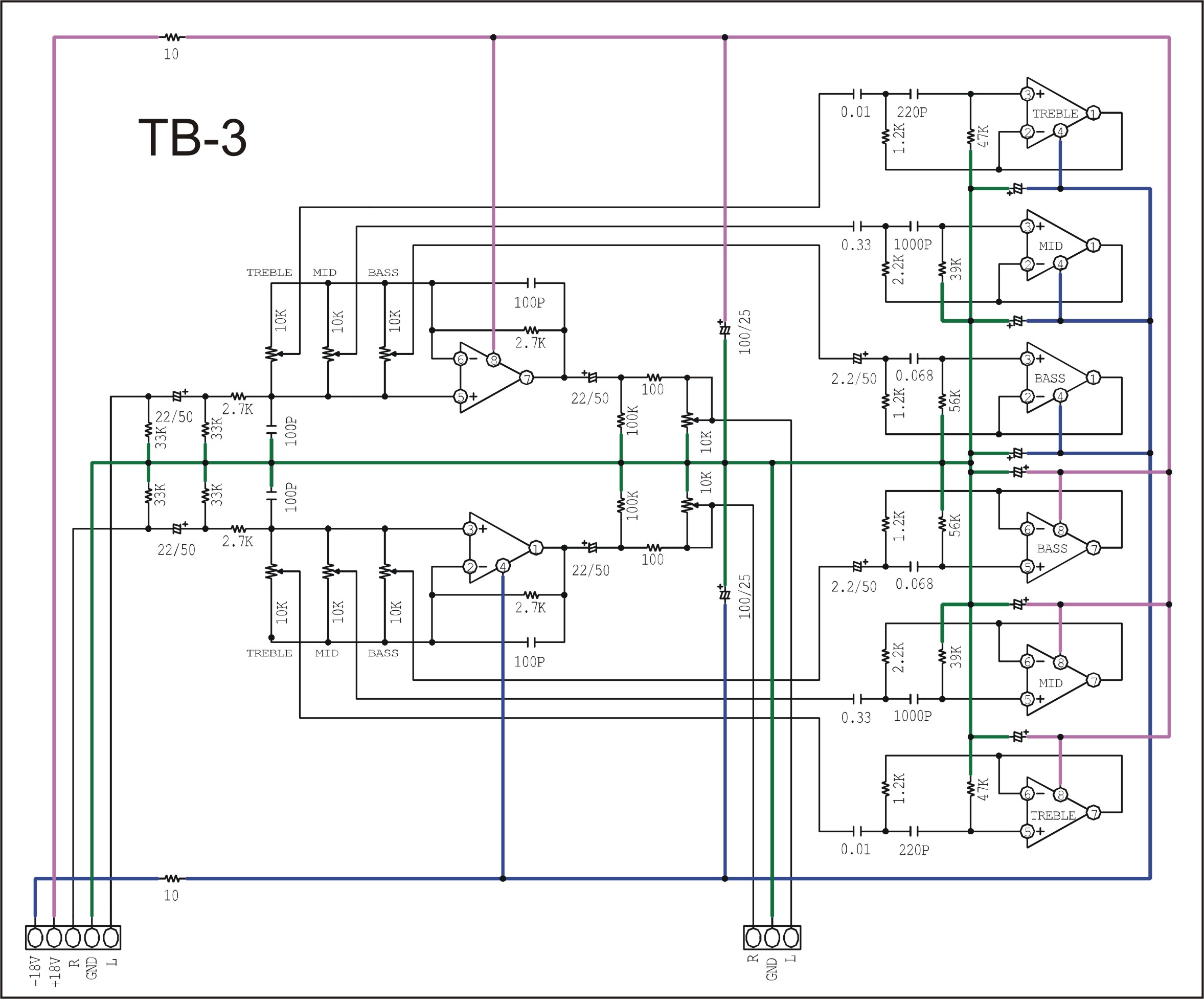

Hi Prasi,
Can you indicate which cap your referring on the schematic?
You maybe right 100nf caps are necessary but i can add it on my next revision with integrated psu after my test.

Hi Prasi,

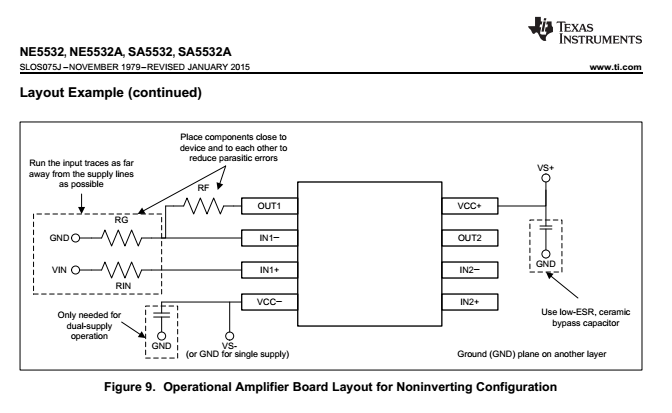

Hello Willy,
The caps in Mr. Mile schematic are not shown, here is a scrn shot from NE5532 datasheet, which gives a guideline for layout.
easy to solder x7r ceramic smd on the bottom as I think in your board, you have power and ground traces running under the op amp.
All the best for your build.
regards
Prasi
Hello Willy,
regards
Prasi
Hi Prasi,
Thanks and I Agree with you for Texas Instrument opamp, but in other brand not stated.

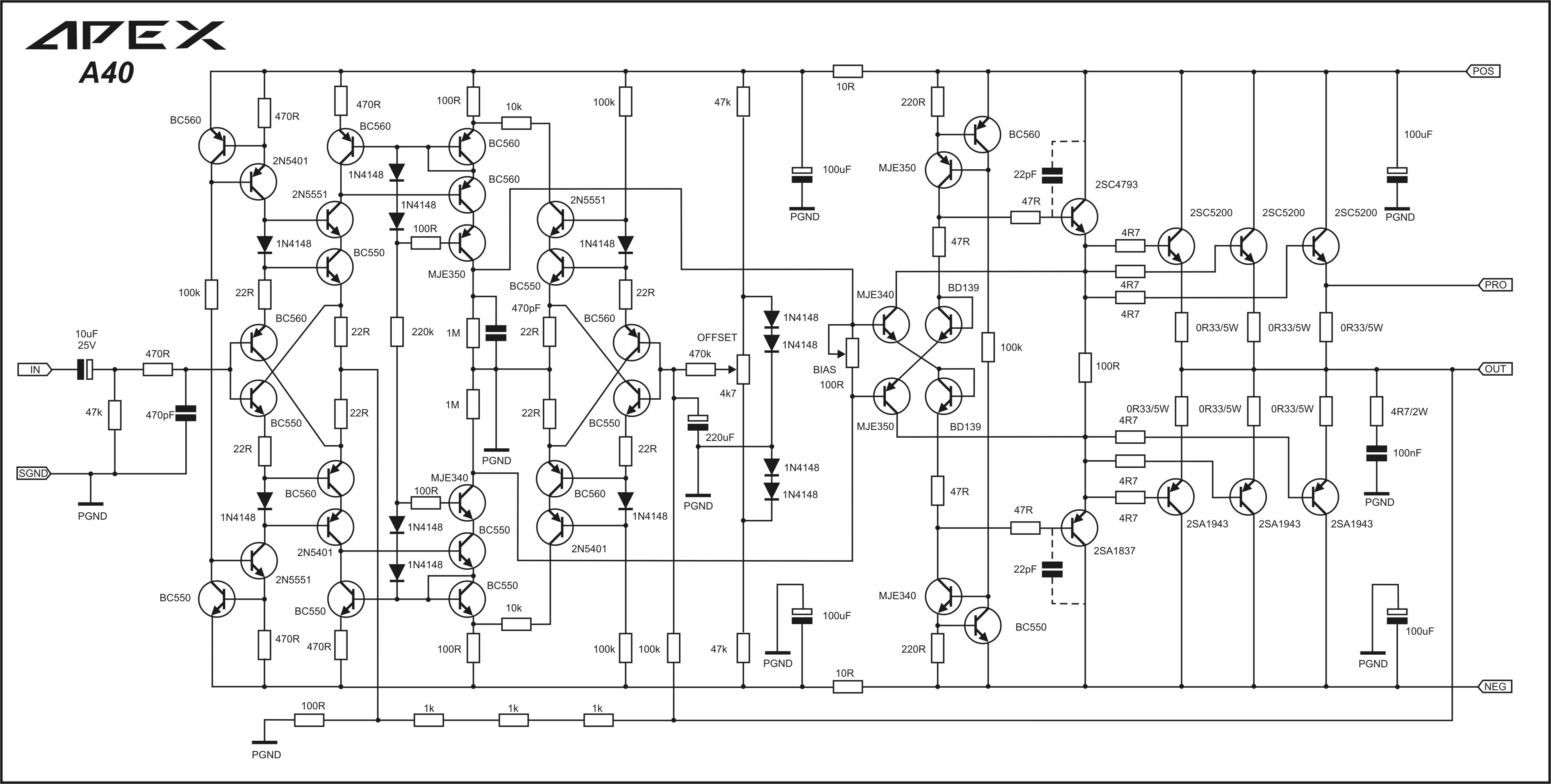

Hi Mile Sir and other experts,
I am planning to reuse the toroidal trafo of my dead Denon PMA1520 amplifier for the Apex A40 build. The trafo specification is 44-0-44 volt AC (no VA specification). I am getting around 62V DC after rectification.
Should I make any changes to the A40 scheme to use this trafo? Or could I directly use this without any modification to the scheme.
Please help me out on this.
Thank you.
Sha

Hi Prasi
I searched in thread and I found some answers. Fist I will replace IRF's, check connections in boards. I am affraid to have a shortcircuit and don't see it. Still remains bias adjust. I will change rezistors value in VAS. What can go wrong ? Worst case scenario: to burns some componets, but I find the
the answer to the questionans: increases or decreases :D
All this will take some time because I'm working on this project after timework and in weekend family first.
B plan: build AX9
Regards
Hi Prasi
B plan: build AX9
Regards
Hello Cornel,
Sounds like a good plan, all the best. Also if you are not doing it already, power the circuit up with mains bulb tester (MBT) before the transformer and safety resistors (100ohm 1-2W in line with +/- amplifier supply) to minimize chances of burning components and smoke. If the bulb lights brightly, you will know you have a short.
regards
Prasi
