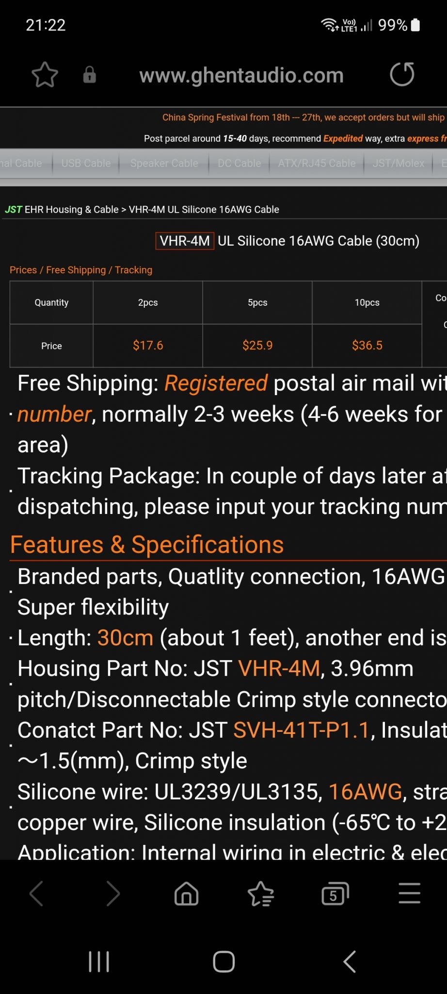

Yes, they fit the 4 pin output connector on the board, with a 3.96mm pin pitch.Are these direct replacements?
Apologies, although the above should fit, the correct cables are:
http://www.ghentaudio.com/item/jst/vhr3n-cable.html For the AC connection, (middle pin not used)
http://www.ghentaudio.com/item/jst/vhr4n-cable.html For the speaker connections

Do you know the practical difference between the VHR-N and the VHR-M it seems to be some type of "Electric Shock Prevention"? Although Ghent doesn't list the 3 pin "M" version, other sites do have it (because I assume this would apply more to the 3-pin power connection than the speaker connections).Apologies, although the above should fit, the correct cables are:
Is it just that it covers the pin slots where the tab pops out to secure it (making it harder to change them later)?
I've tried to find a description of the differences, without success. I think it ids as you describe, the pin release is shrouded on the -M, requiring a different method to release.Do you know the practical difference between the VHR-N and the VHR-M it seems to be some type of "Electric Shock Prevention"? Although Ghent doesn't list the 3 pin "M" version, other sites do have it (because I assume this would apply more to the 3-pin power connection than the speaker connections).

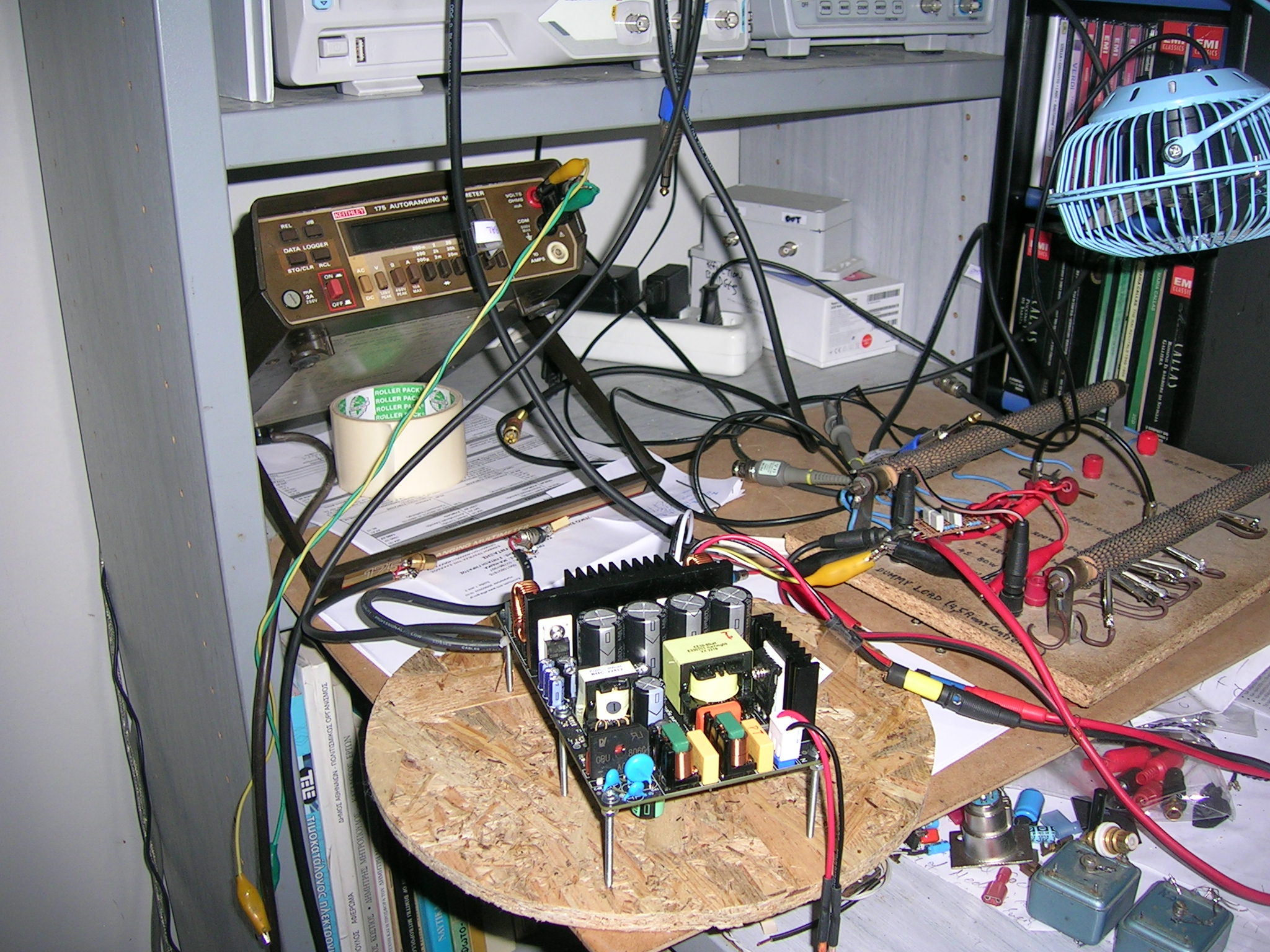

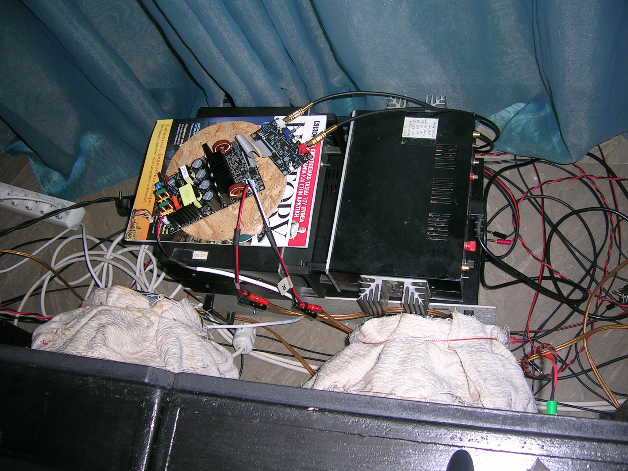

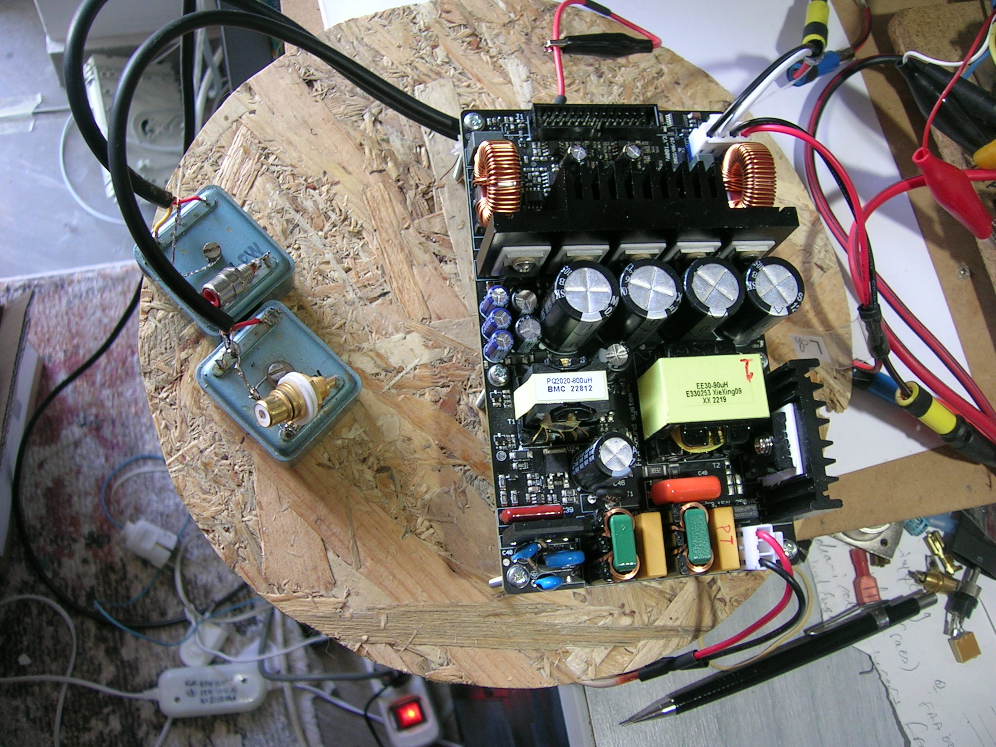

Hi George. Beats me. Static charge smote the LED. Understandable but I've got $3 amps that are 5 years old and the LED's still work fine. This Eric Amp is mounted on a wood plank along w/ RCA interface. Two conductor power in. The one mounting hole with ground symbol is grounded to earth. Still using the amp - love the sound.
Hi bonjo.
Nice to hear that the amplifier is intact. Please check if the floor carpet is synthetic. Thousants of volts build up simply while walking over the room.
If floor carpet is synthetic , you have to discharge yourself before touching the hardware.
It is a week now that I have received a second unit.
One module is playing music 18 hours per day, the other is being tortured on the test bench for the same amount of time.
No causalties yet.

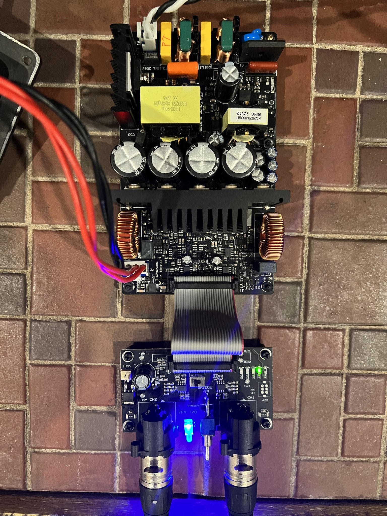

I tested the amplifier board today and it sounds really good for the price!
I was really impressed!
But it lacks a bit of texture (in comparison to my Denafrips Thello) and a bit of detail and separation.
Obviously that for the price is excellent!
Even though, Is there a way to improve this module a bit?

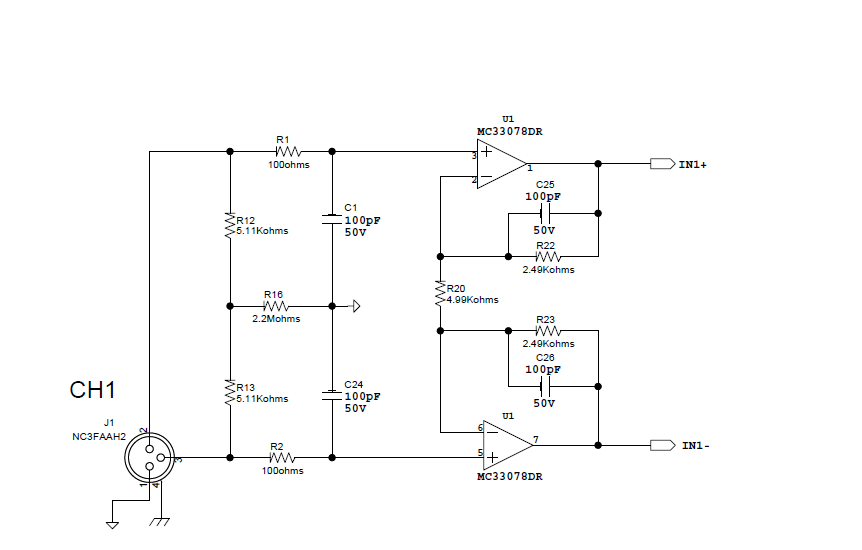

An easy and risk free way is to bypass the input buffer and drive the main board directly, differential or single ended. It is a bit of low Rin (around 7kOhm differential, 3.5kOhm single ended)
