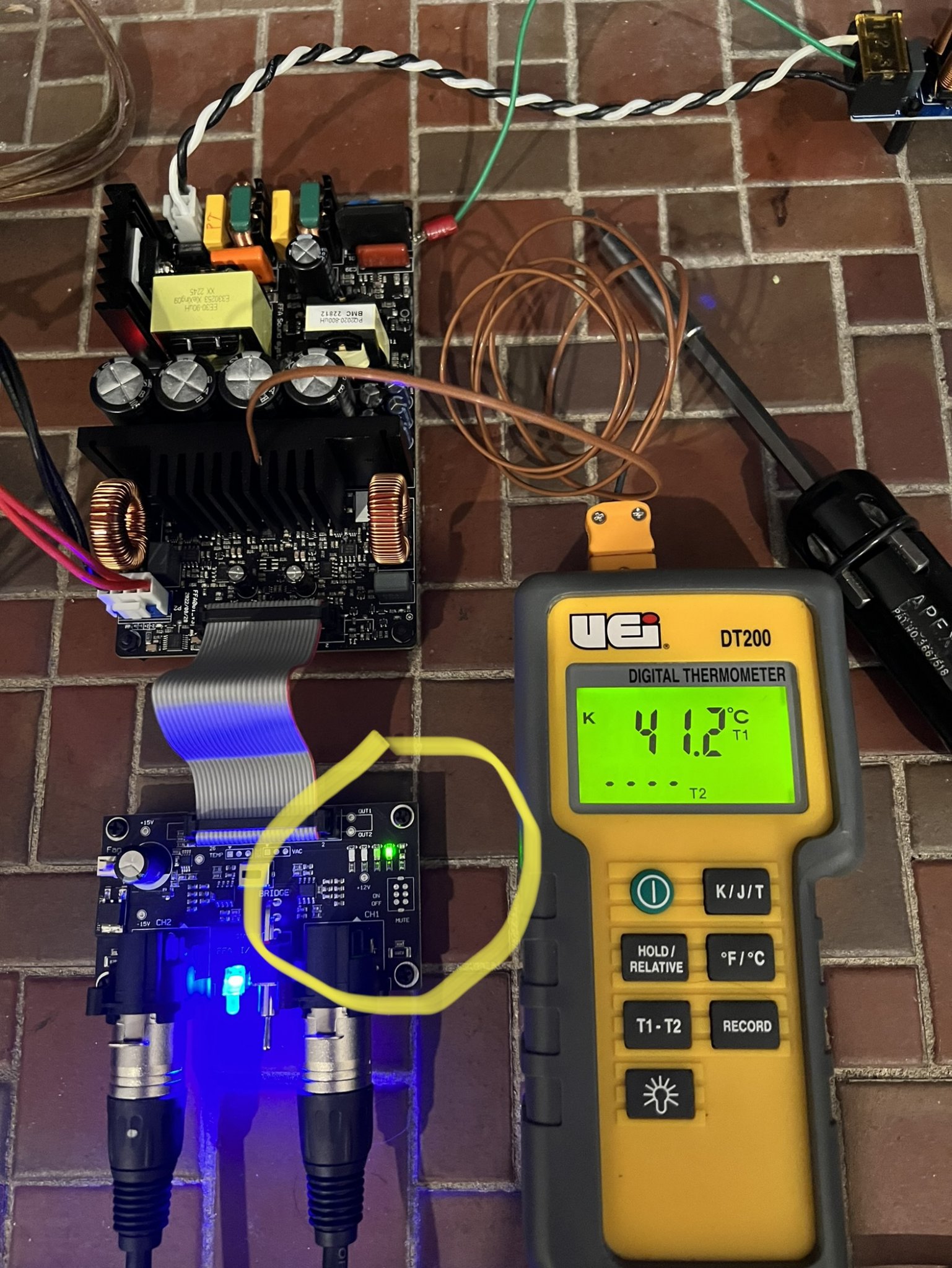

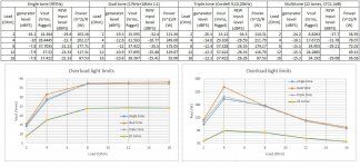

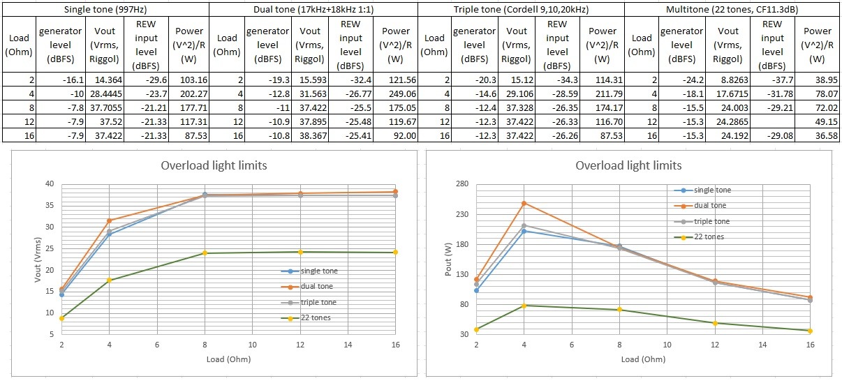

I have investigated the operation of the two clipping (or ‘overload’) red LEDs (the two innermost leds on the input buffer board).
Shown is the output voltage and output power level at which they start to glow (actually 0.1dB before LED turn on dim, just visible under dark ambient background).
I tested operation under four different loads and I used four different test signals.
George

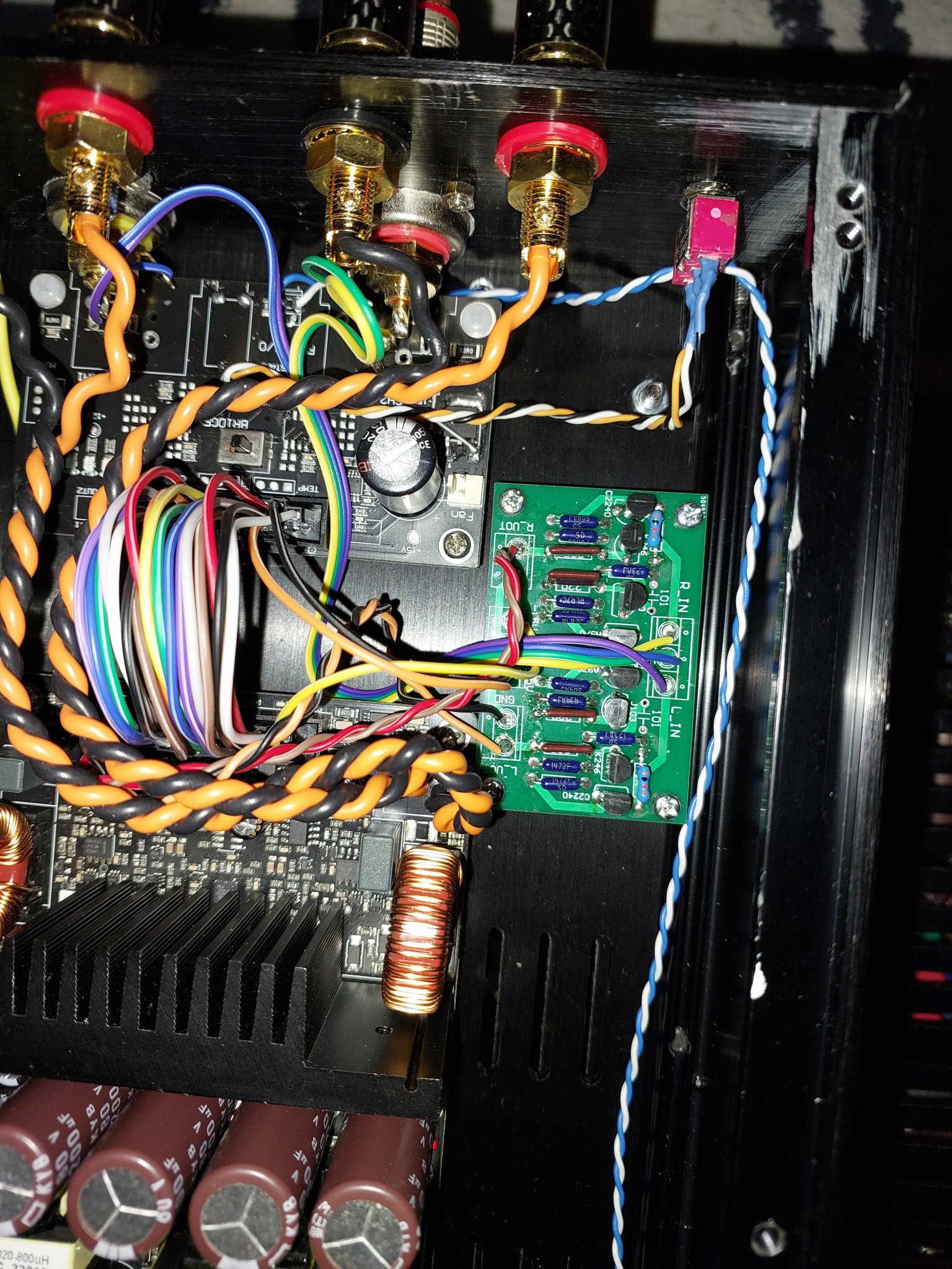

I tried using my input trans in the SE:BAL configuration, bypassing the op amp stage on the IO board. It doesn't sound appealing due to the low Rin, I guess. I switched to discrete FET buffer, without the Op amp stage on the IO board. The amp is sounding so impressive now. Opens up the soundstage. Less forward than the op amp stage, but there is much better separation and there are some micro details in the music that I didn't notice before. And without the gain of the IO board, the sensitivity of the input is now very acceptable for use with my preamp.Hi Ian
An easy and risk free way is to bypass the input buffer and drive the main board directly, differential or single ended. It is a bit of low Rin (around 7kOhm differential, 3.5kOhm single ended)
Cannon fodder, b1 buffer is
https://www.passdiy.com/project/preamplifiers/b1-buffer-preamp
George
The FETs are closely matched and it is DC coupled to the amp inputs.
![up :up: :up:](https://files.diyaudio.com/forums/images/smilies/up.gif)

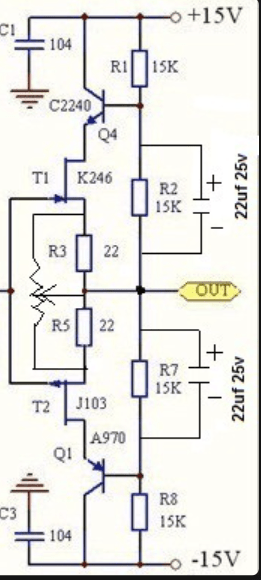

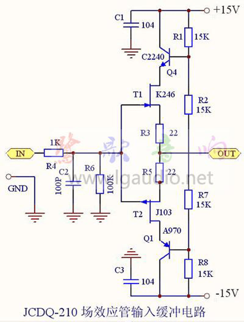

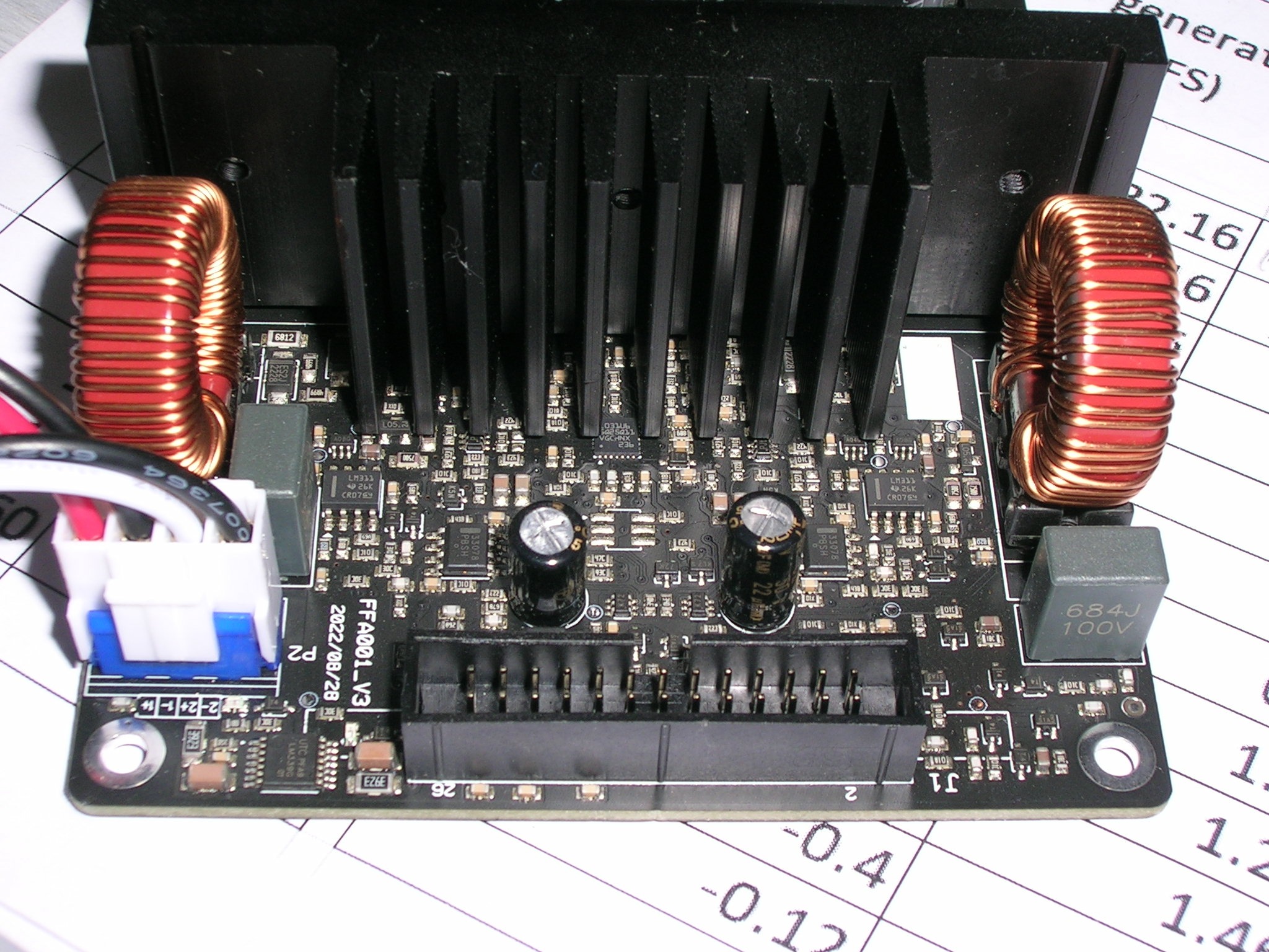

What is the schematic? I see four semiconductors per channel
George
it seems to me a version of this one.What is the schematic? I see four semiconductors per channel
https://www.aliexpress.us/item/2255800641349314.html?gatewayAdapt=glo2usa4itemAdapt&_randl_shipto=US
Folks, yes it is the one posted above, but i matched the FETs and installed trimmers to null out the dc offsets. The trimmer pots are under the board, you cannot see it in the picture. I removed the 100pf caps at the input upon some member's recommendation somewhere. Ignore the 22uf caps across the 15k resistors.

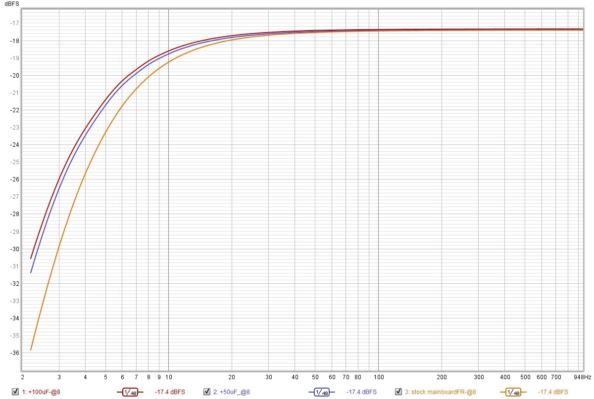

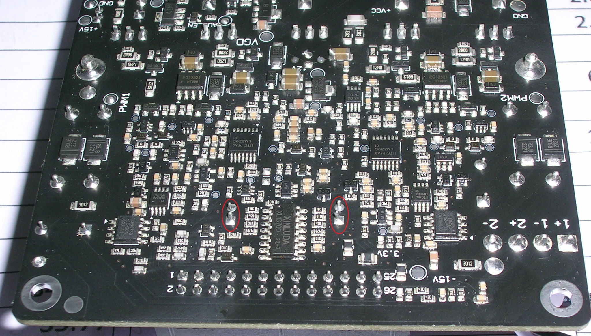

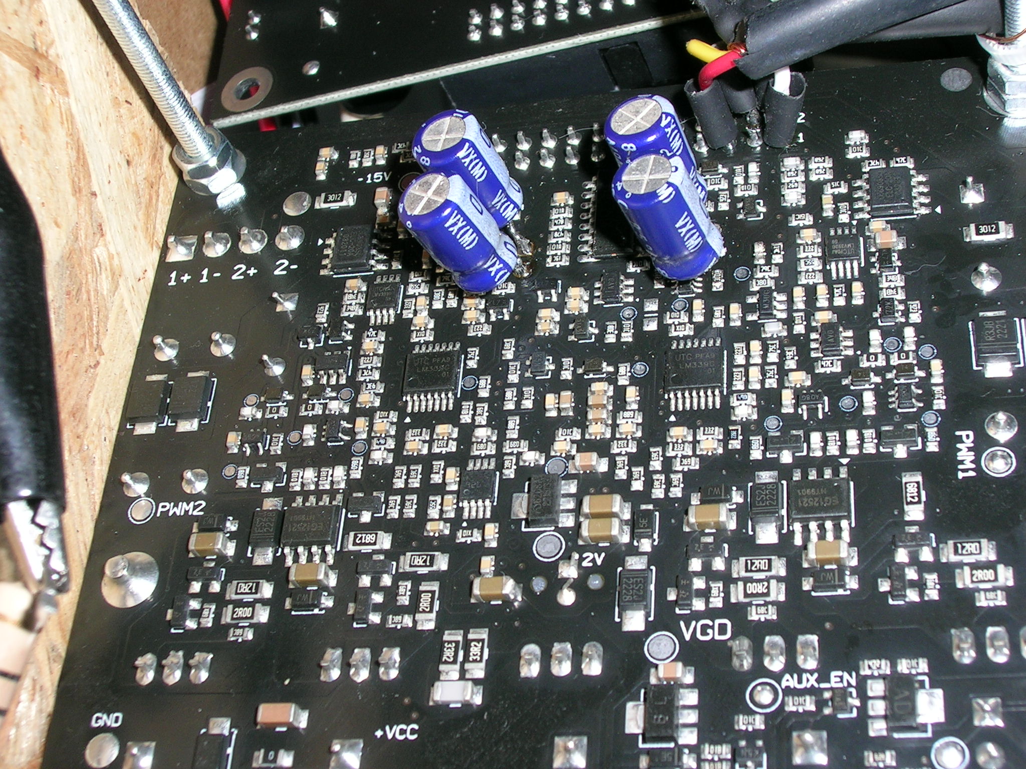

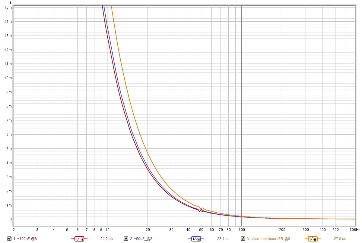

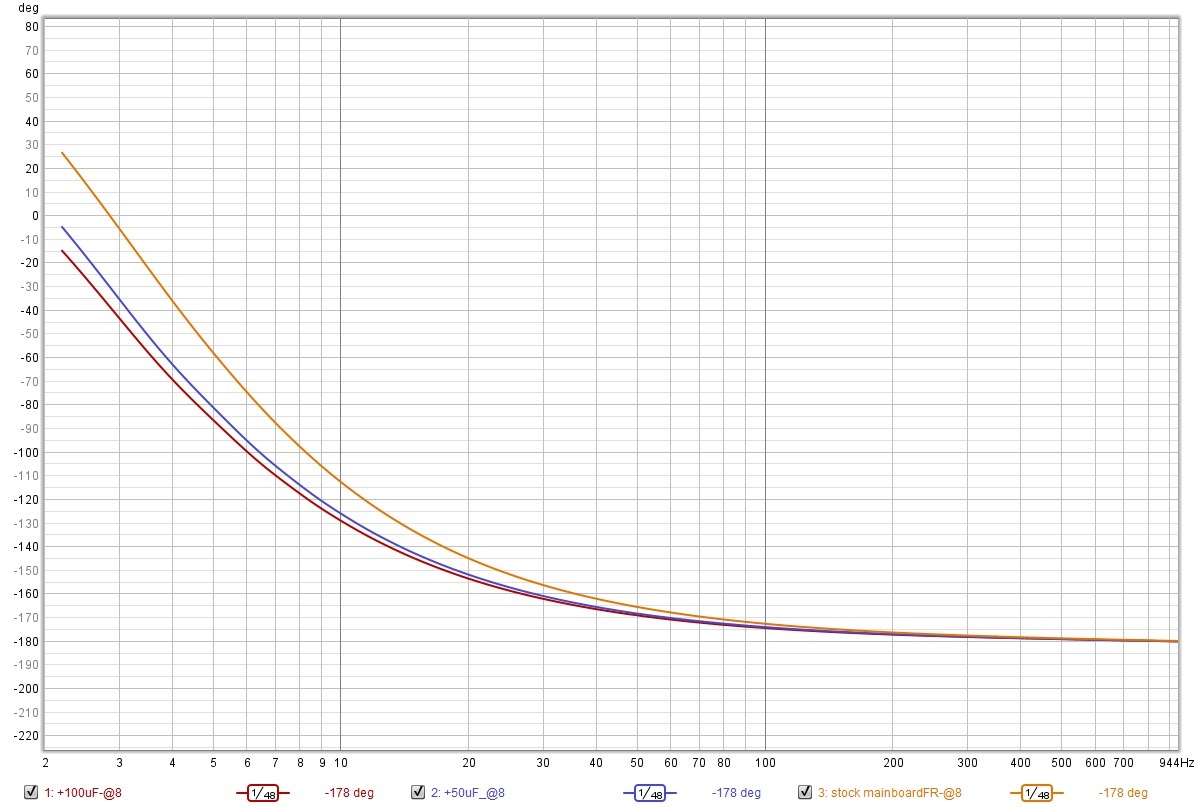

Now the low bass can be improved by increasing the capacitance of the two 22uF bypolar electrolytic caps found close to the multipin connector on the main board. The easy way is to parallel some bypolars by soldering them across the pins of the existing caps at the underside of the board.
I didn't have bypolars. I tested with back to back polar electrolytics.
1st diagram is freq response at low end. 2nd diagram is phase, 3rd is group delay.
Light brown is with the stock 22uF.
Blue is with an added 50uF (total 72uF).
Red is with an added 100uF (total 122uF).
George

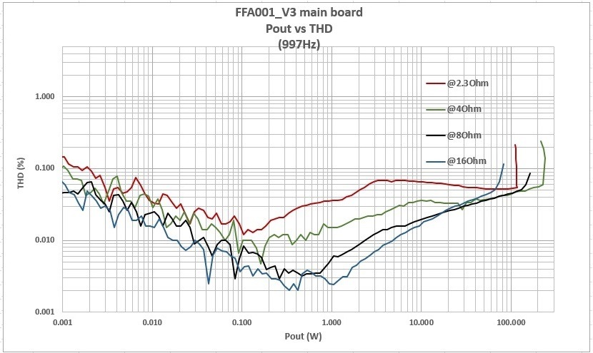

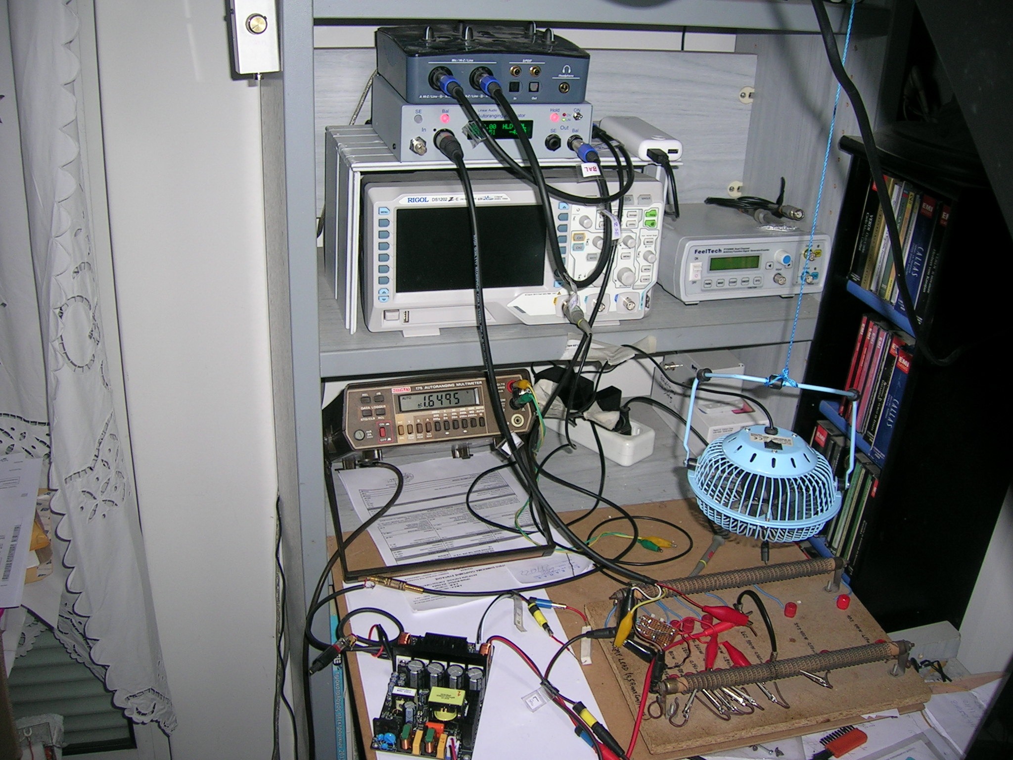

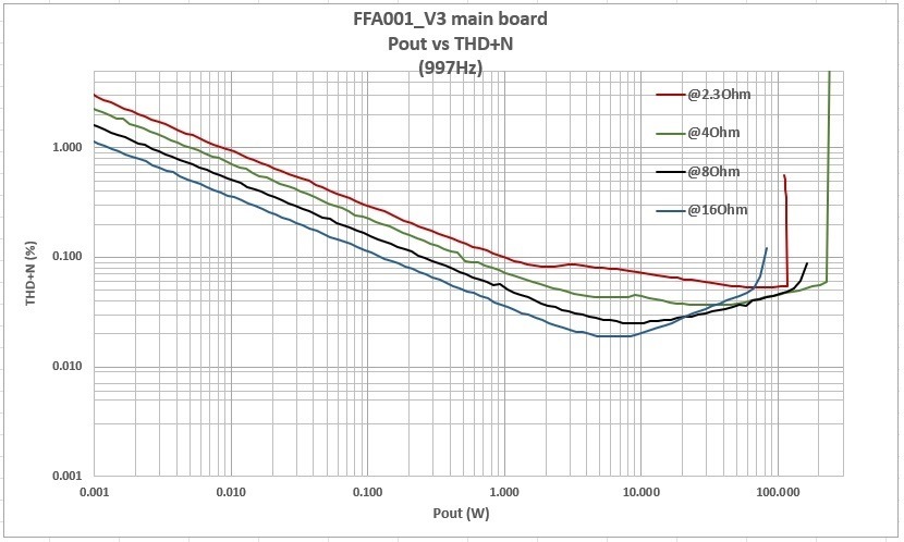

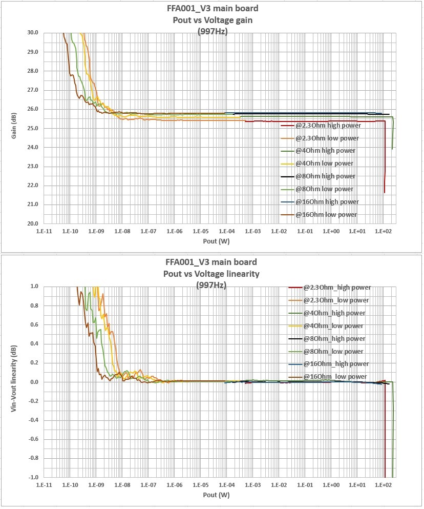

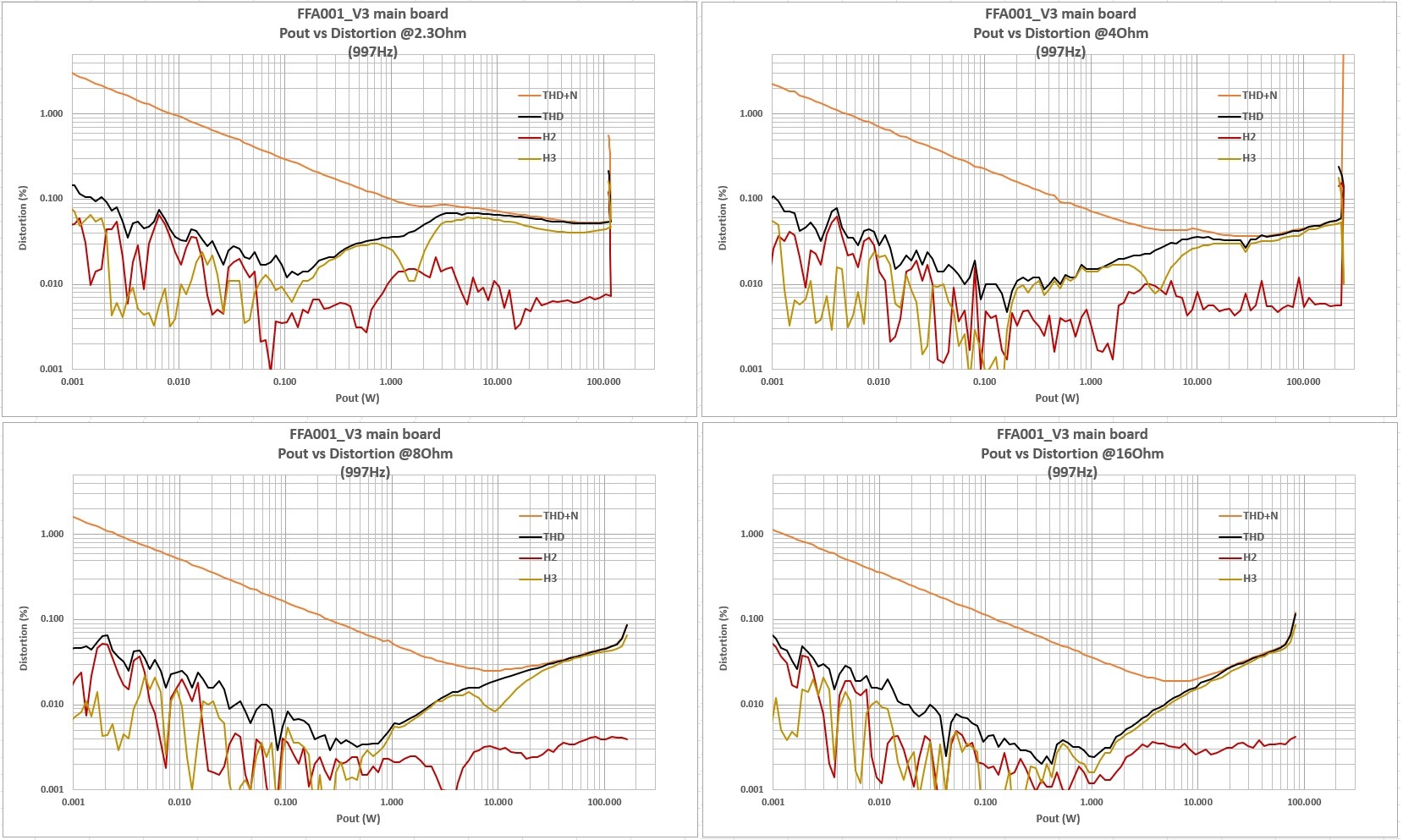

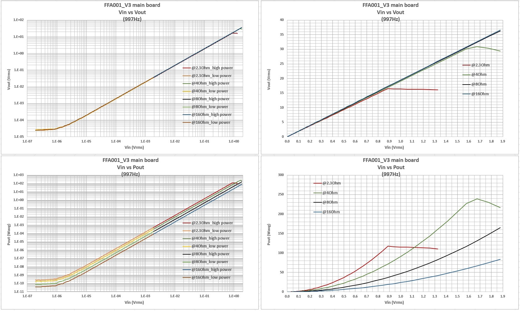

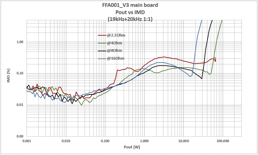

Some measurements on the FFA001_V3 main amplifier board (no buffer board).

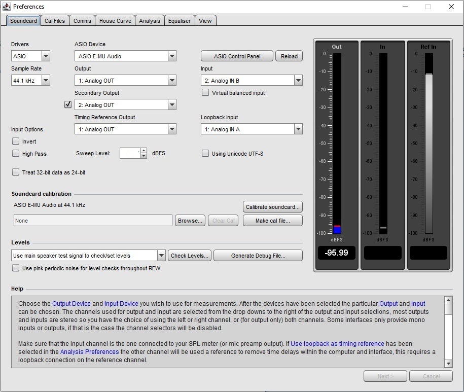

Amplifier in stock form (one channel only) driven single ended from the line-out of an EMU 0404 soundcard.
Load is a home made set of dummy load power resistors.
Vout goes to Jan Didden's Autoranging attenuator (manual mode) and from there to soundcard's input.

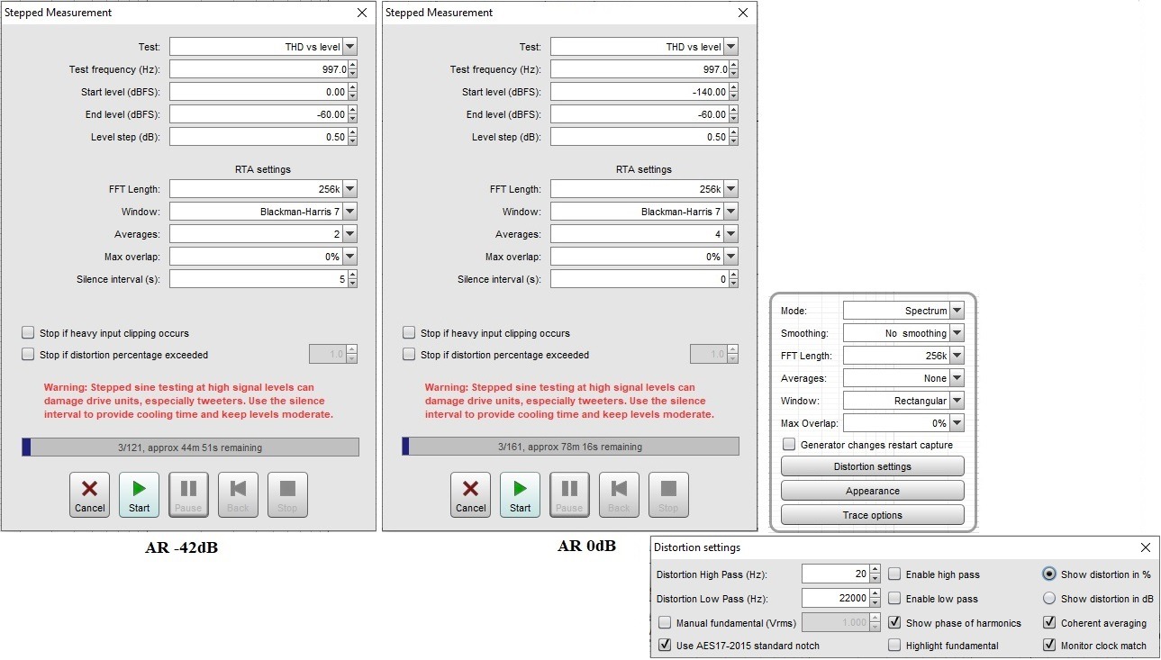

Software is the excellent REW. The measurement files are exported to MS Excel for convenient and uniform presentation.
Vout, Pout, gain, linearity.
44.1kHz sampling rate. A passive 33.7kHz 12dB/oct LP filter btn dummy load and AR
Step Level distortion.
