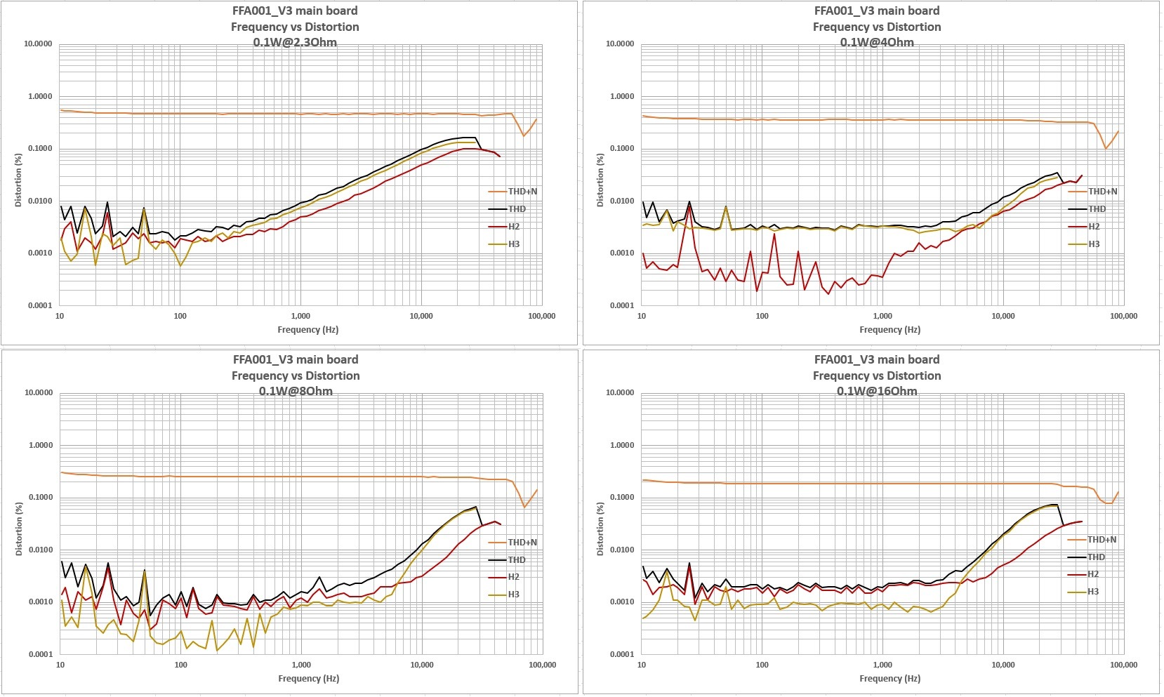

Step Frequency distortion
192kHz sampling rate. No LP filter btn dummy load and AR

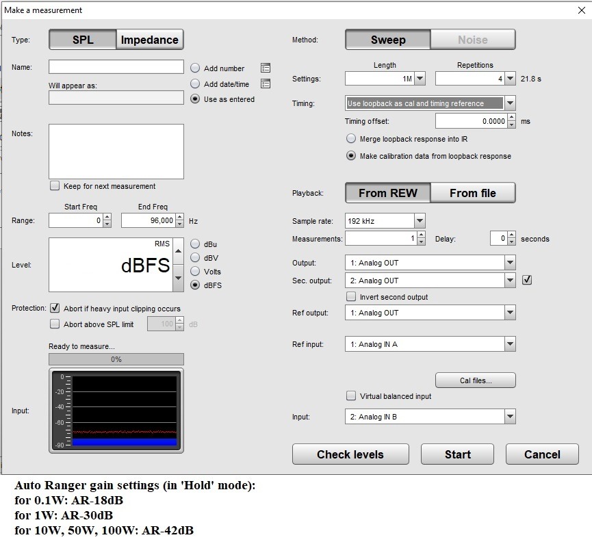

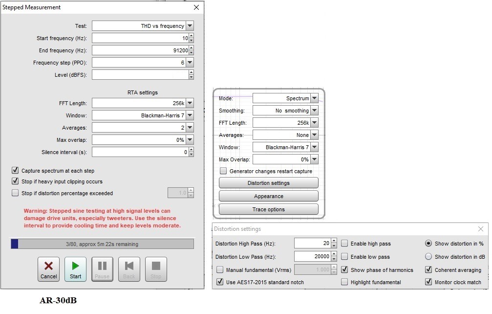

Joined 2002

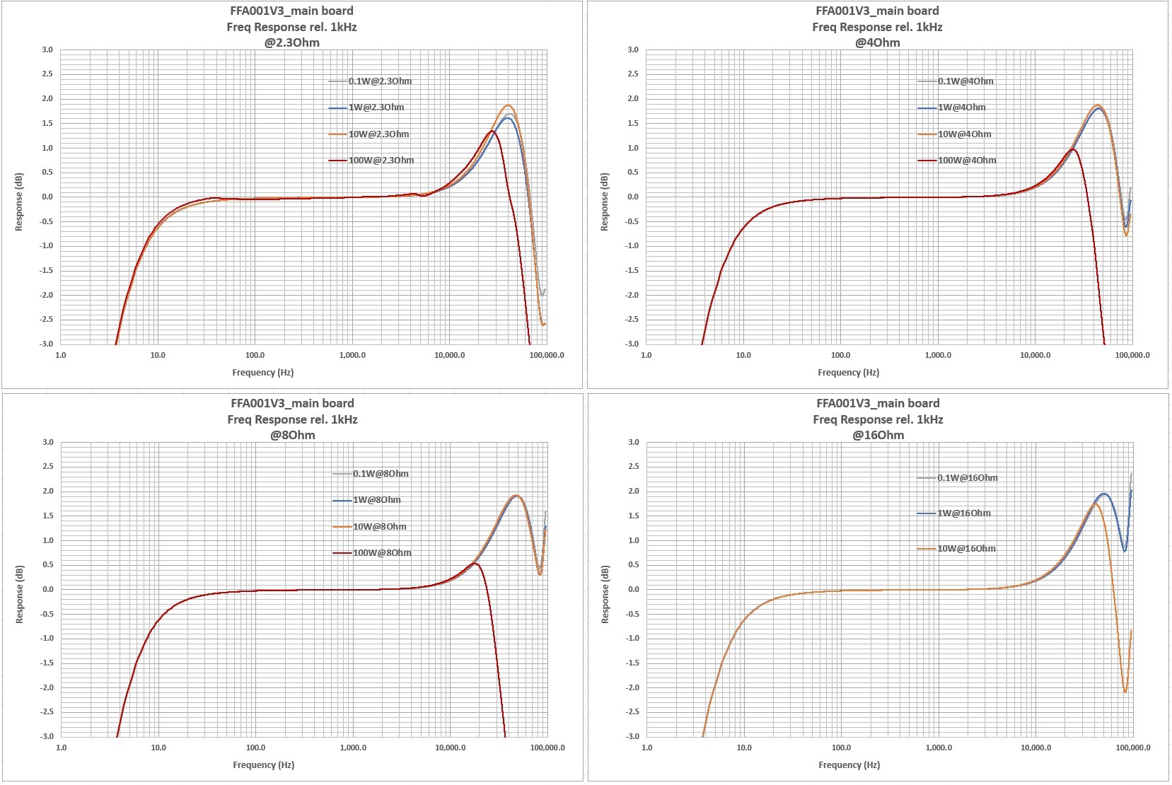

Frequency response
George
Reactions: 1 user
Step Level distortion.
44.1kHz sampling rate. A passive 33.7kHz 12dB/oct LP filter btn dummy load and AR

Thank you zoom.
Now the low bass can be improved by increasing the capacitance of the two 22uF bypolar electrolytic caps found close to the multipin connector on the main board. The easy way is to parallel some bypolars by soldering them across the pins of the existing caps at the underside of the board.
I didn't have bypolars. I tested with back to back polar electrolytics.
1st diagram is freq response at low end. 2nd diagram is phase, 3rd is group delay.
Light brown is with the stock 22uF.
Blue is with an added 50uF (total 72uF).
Red is with an added 100uF (total 122uF).
George

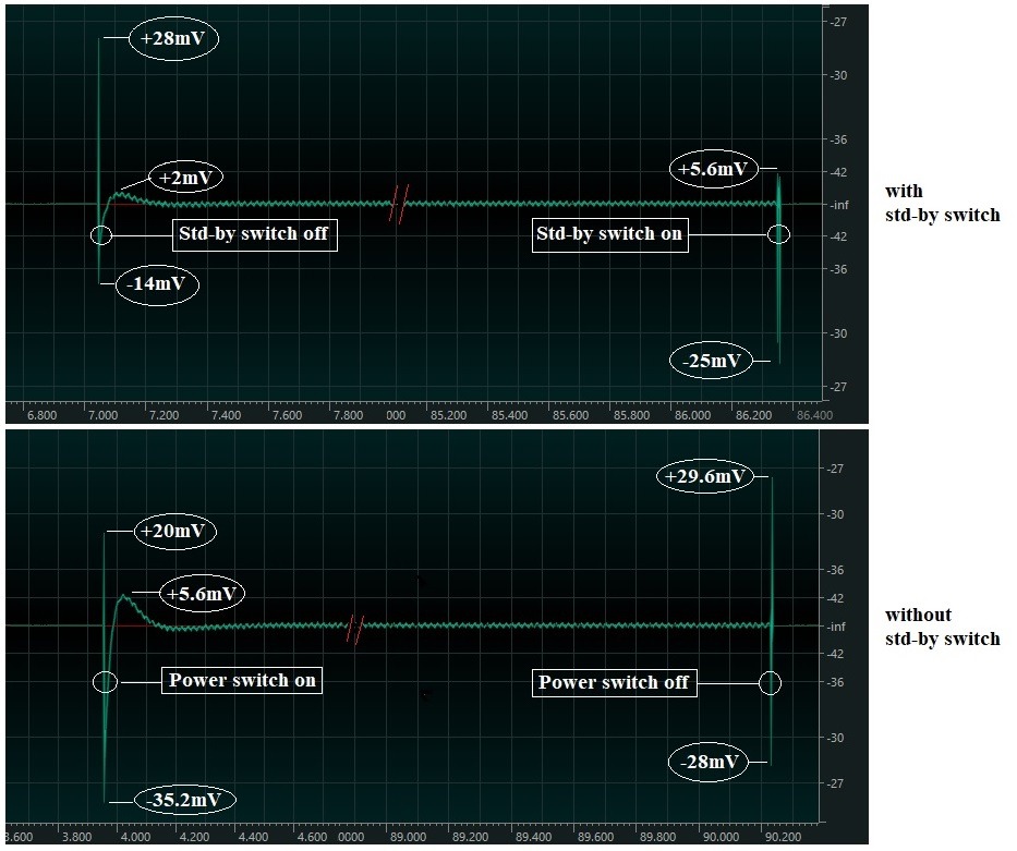

@George, with a larger input coupling cap value, I am getting an audible pop upon turn on. Have you experienced this ?
Joined 2002
Hi zoom
This is typical when increasing the C.
With an added 50uF I don't notice it.
With 100uF and more, yes.
I had measured the non audible ac thumb with the stock 22uF (measurements across speaker terminals@8Ohm, see attachment). I haven't meaured it with added capacitance.
George
Reactions: 1 user

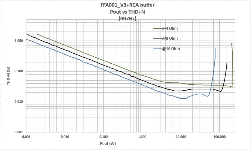

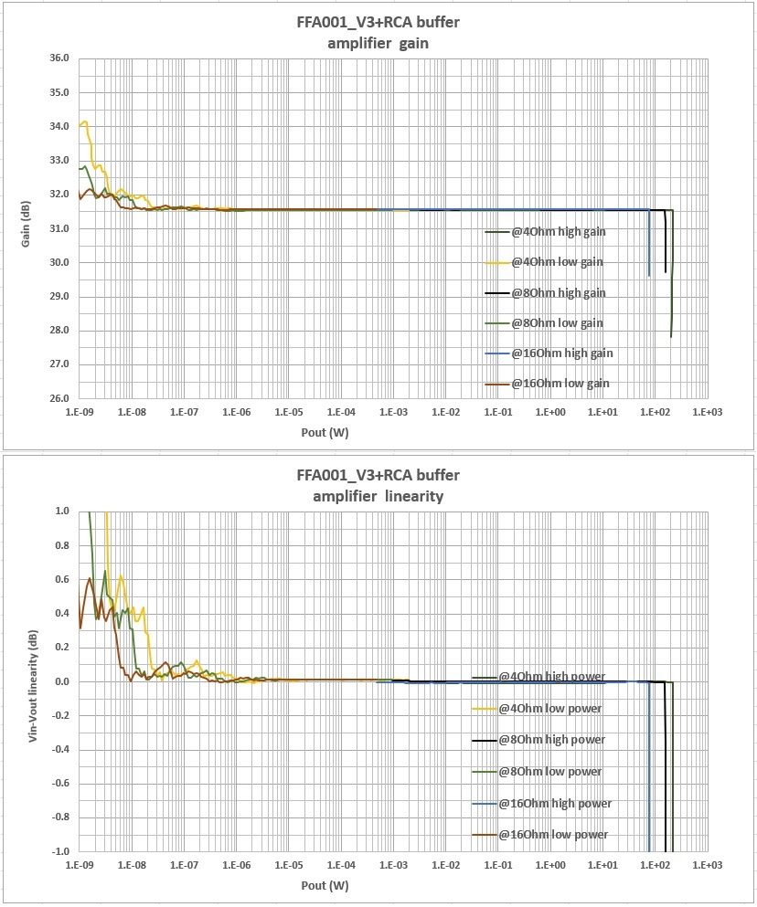

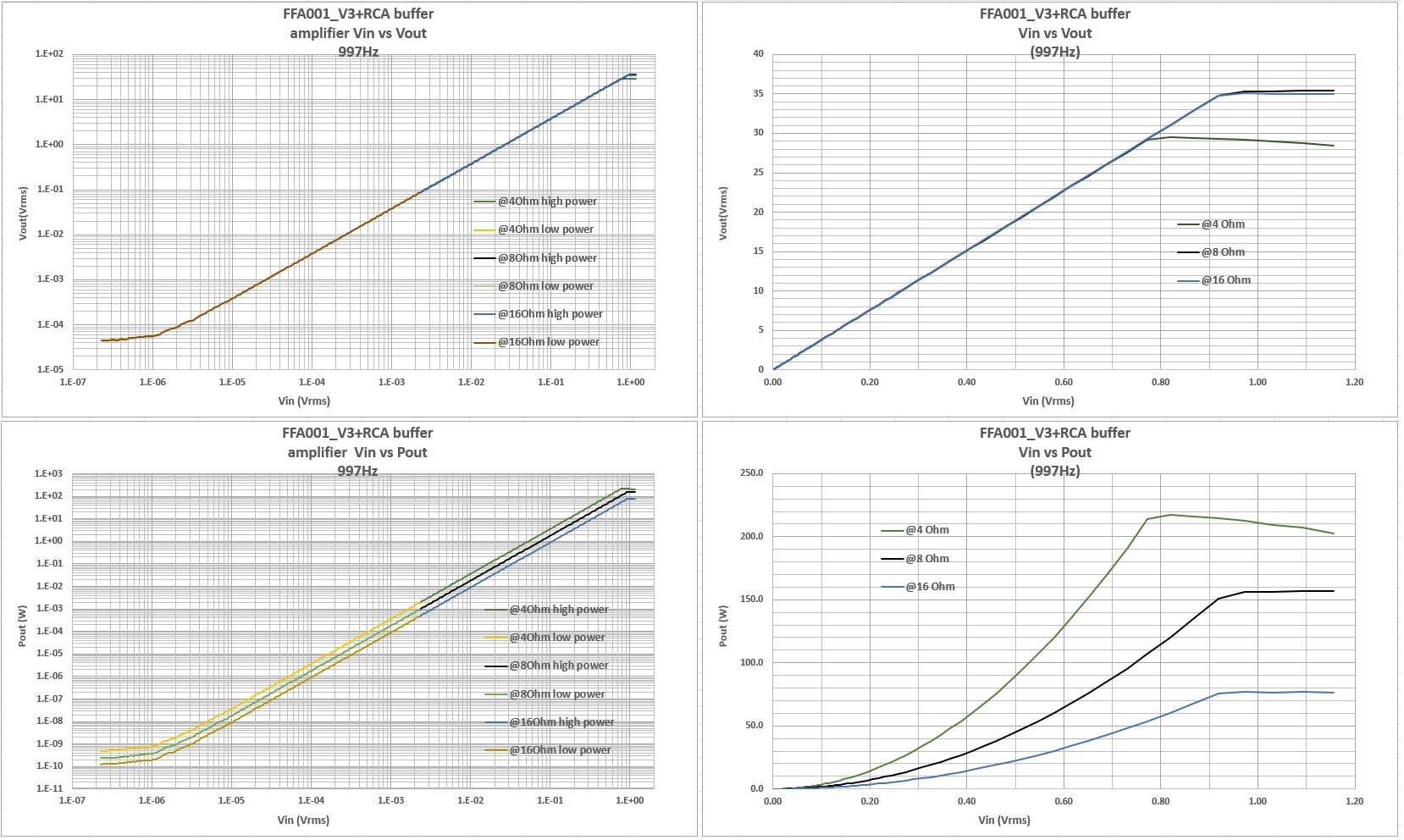

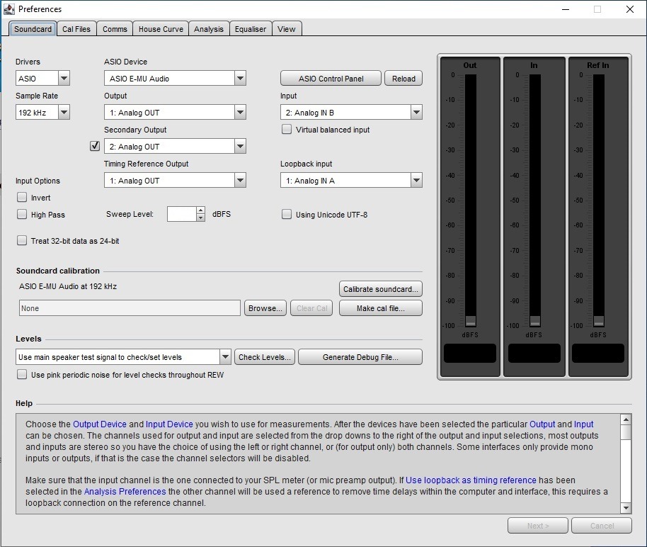

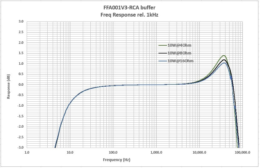

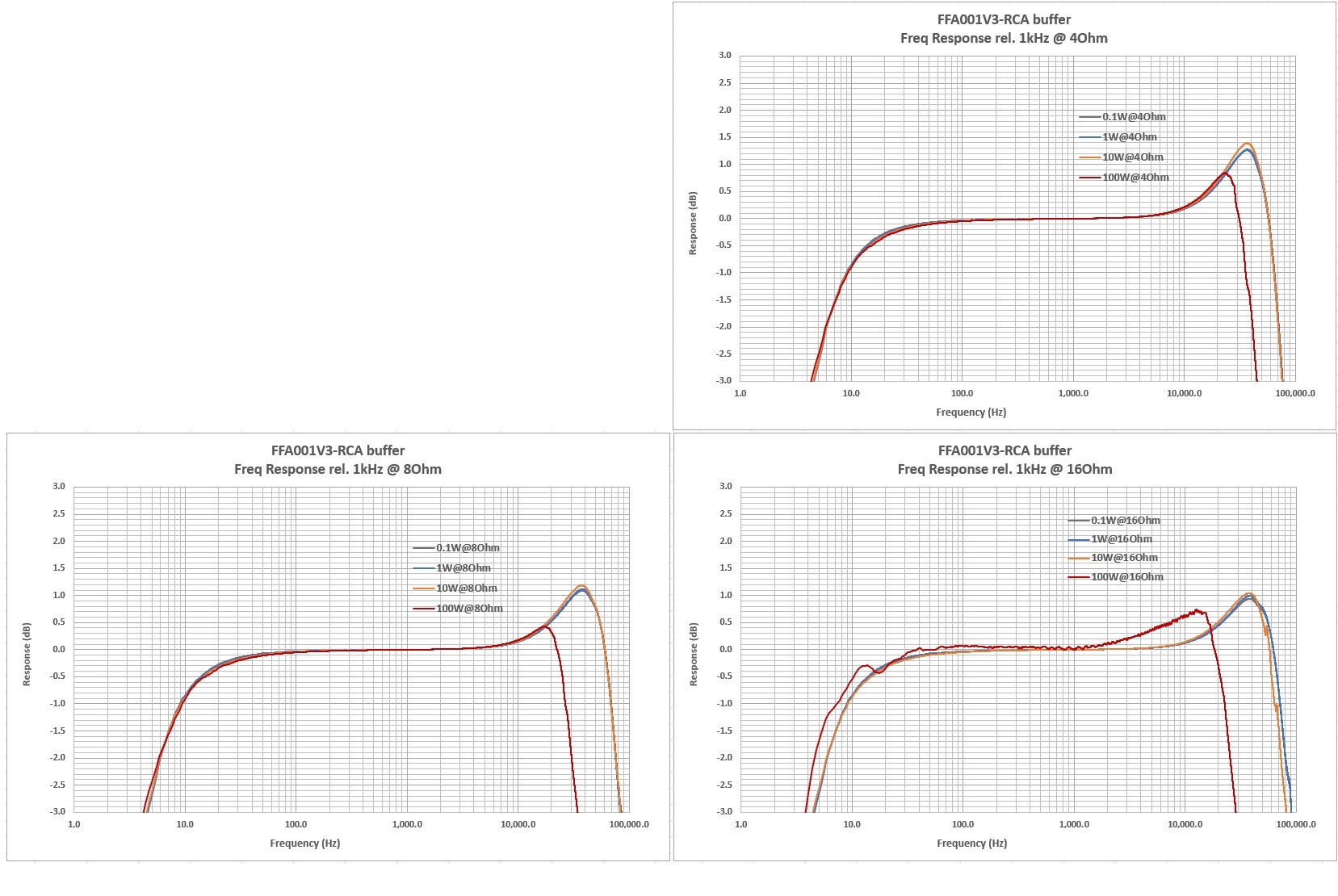

Joined 2002
I had spoken of some measurements on the FFA001_V3 + RCA buffer that e_fortier asked for .
These were actually made two weeks before those of the main board I have shown in posts #518 to #522 and were of another’s module unit. They remained as raw data for the time being.
Measurements at 2Ohm load had not been taken then.
In general these measurements -par the input voltage and amplifier gain- don’t differ from what I have shown so far.
I can say that the RCA buffer does not degrade the performance of the main board measurement wise.
Anyway, here it goes:

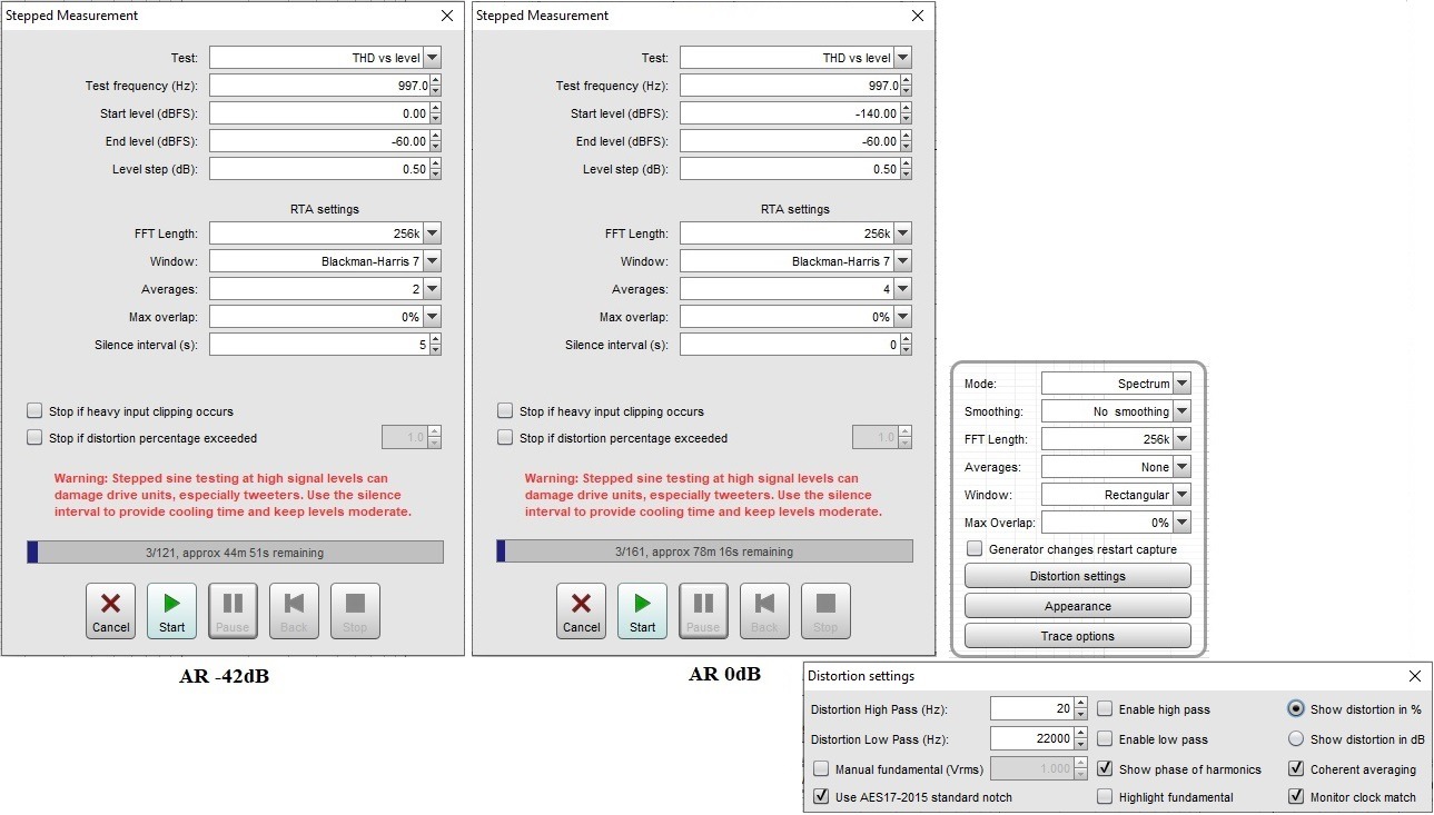

Amplifier in stock form (one channel only) driven from the line-out of an EMU 0404 soundcard.
Load is a home made set of dummy load power resistors.
Vout goes to Jan Didden's Autoranging attenuator (manual mode) and from there to soundcard's input.
Software is REW. The measurement files are exported to MS Excel for convenient and uniform presentation.
Vout, Pout, gain, linearity.

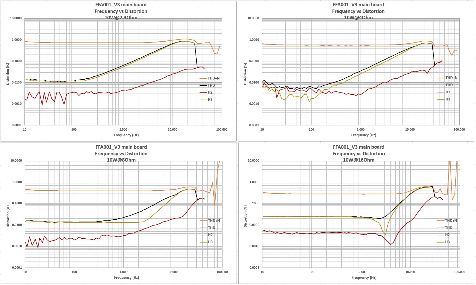

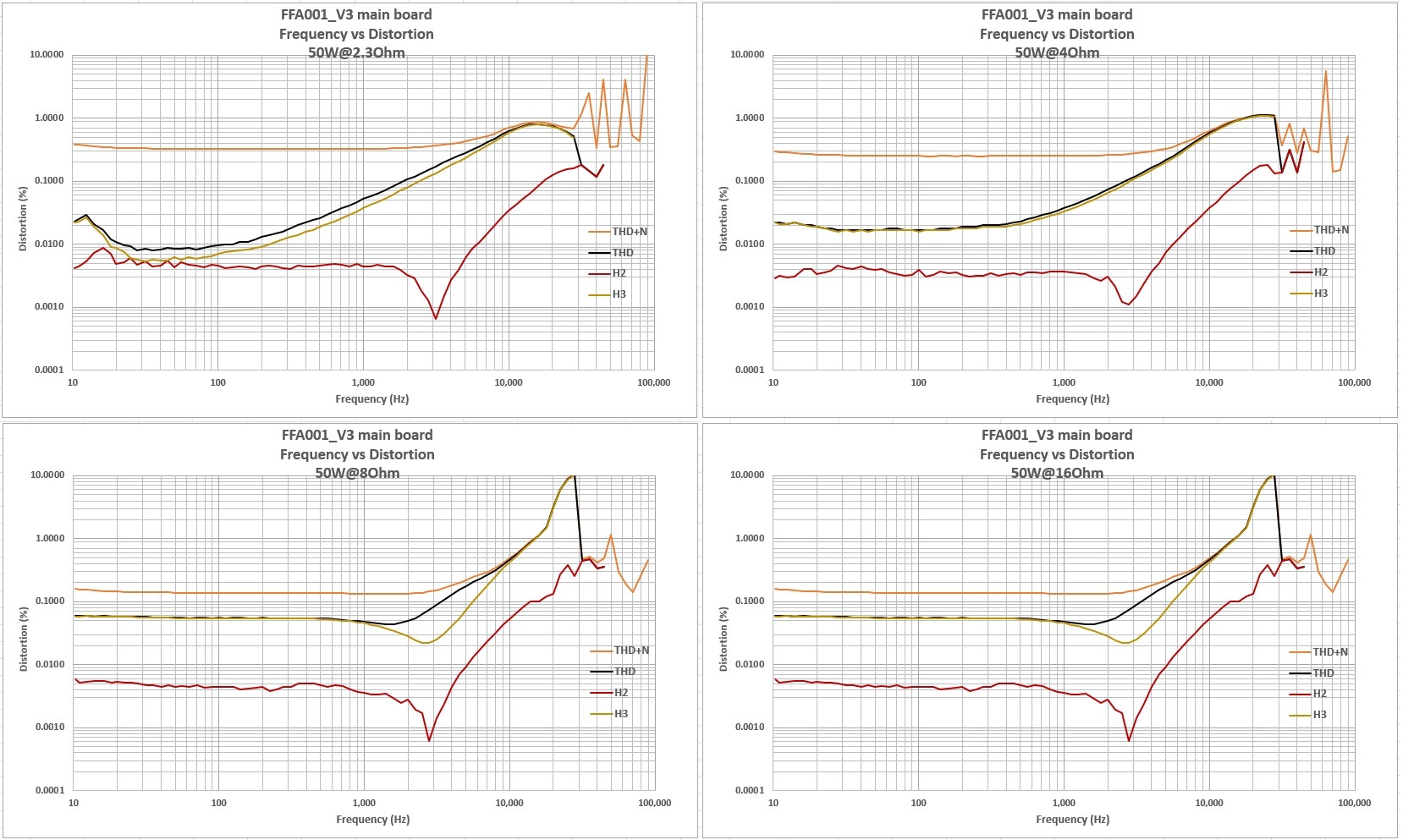

Joined 2002

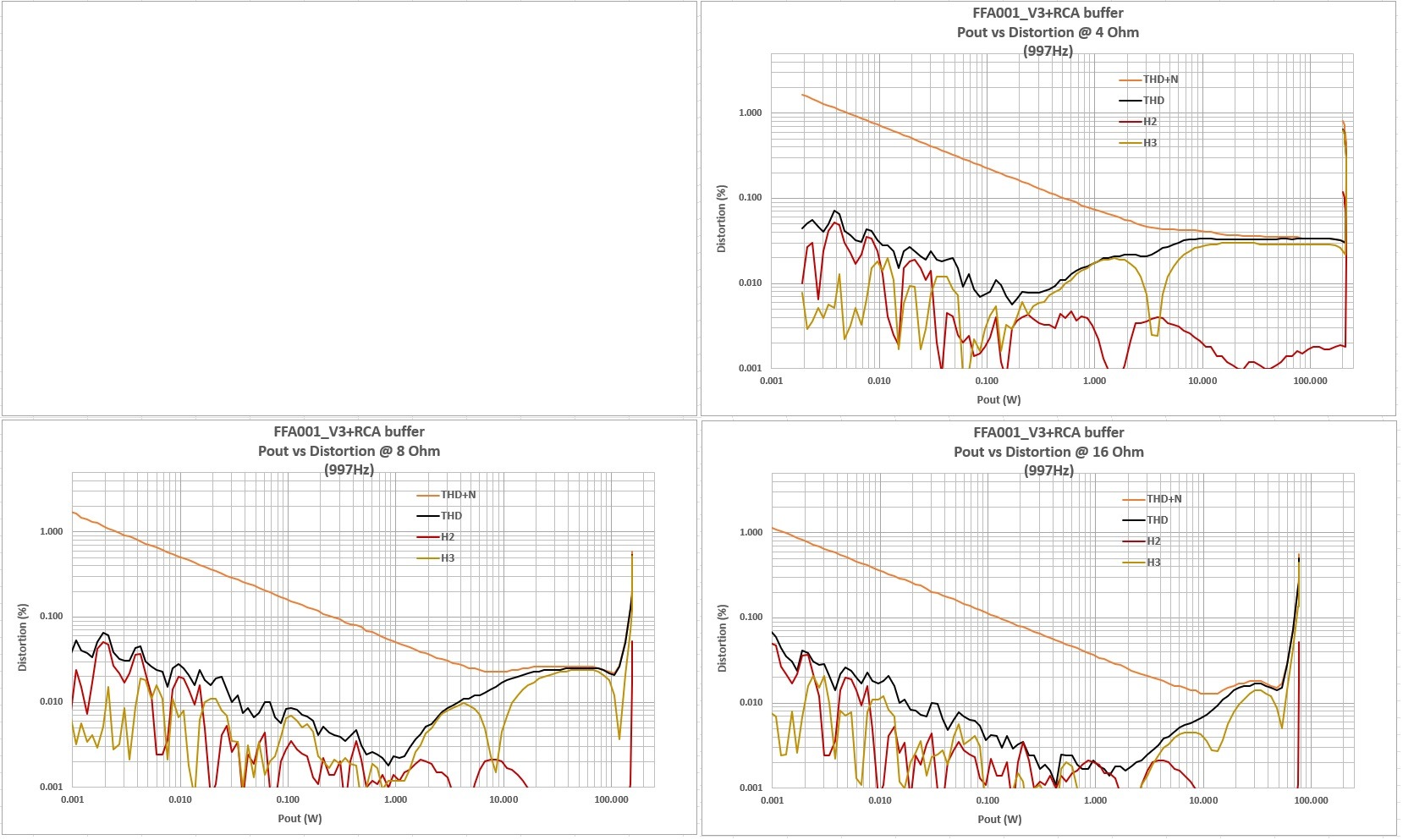

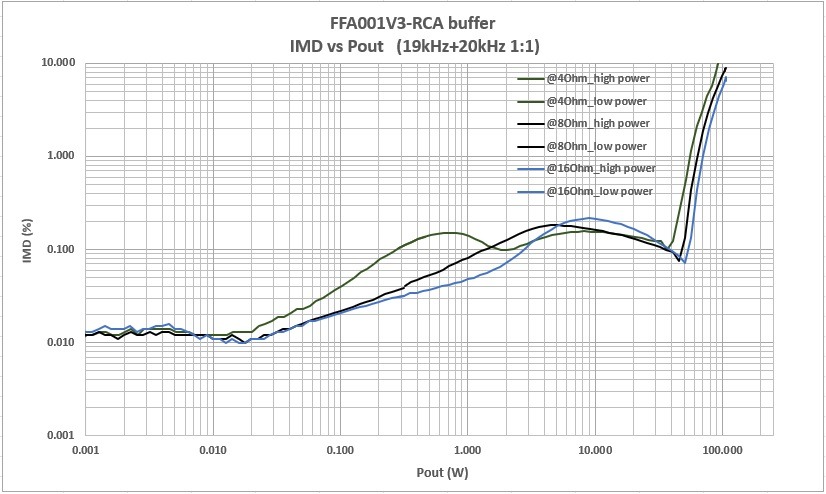

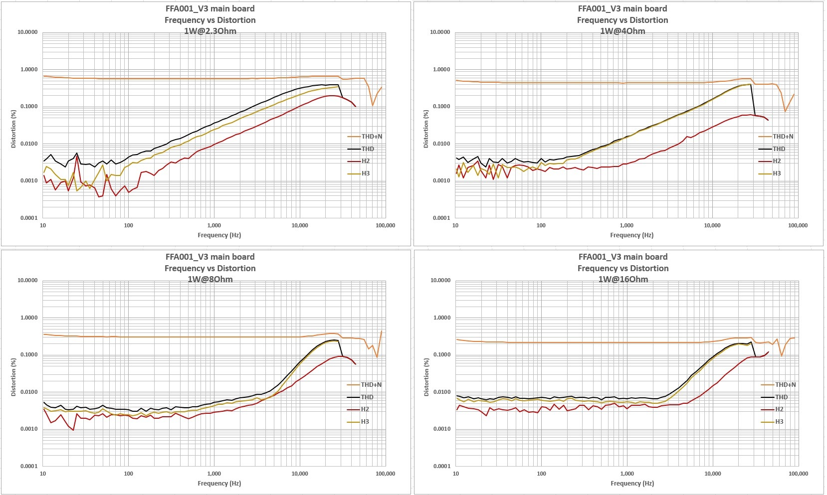

Joined 2002
Frequency response
George
