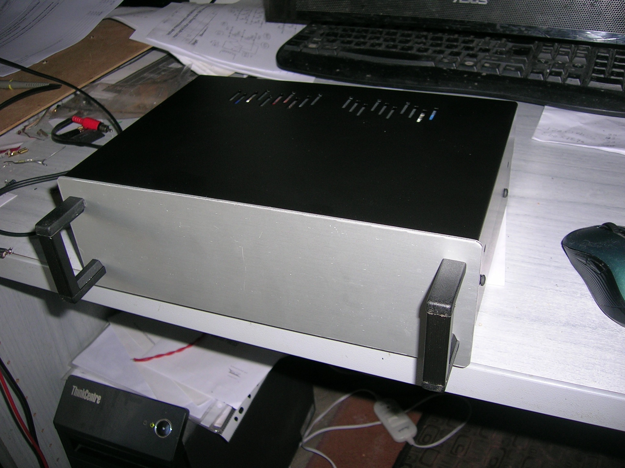

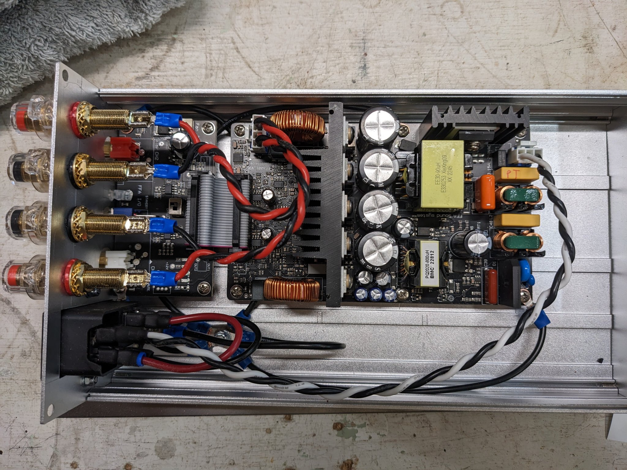

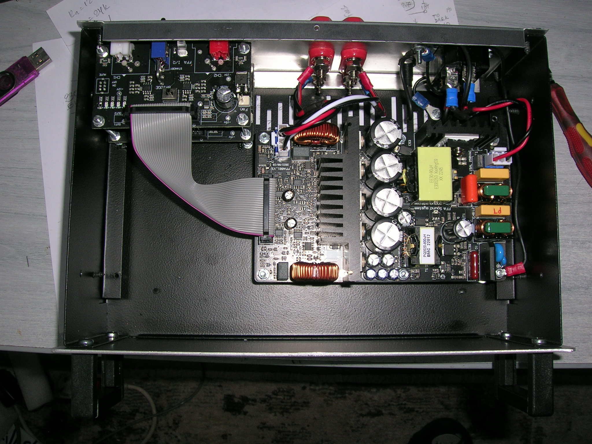

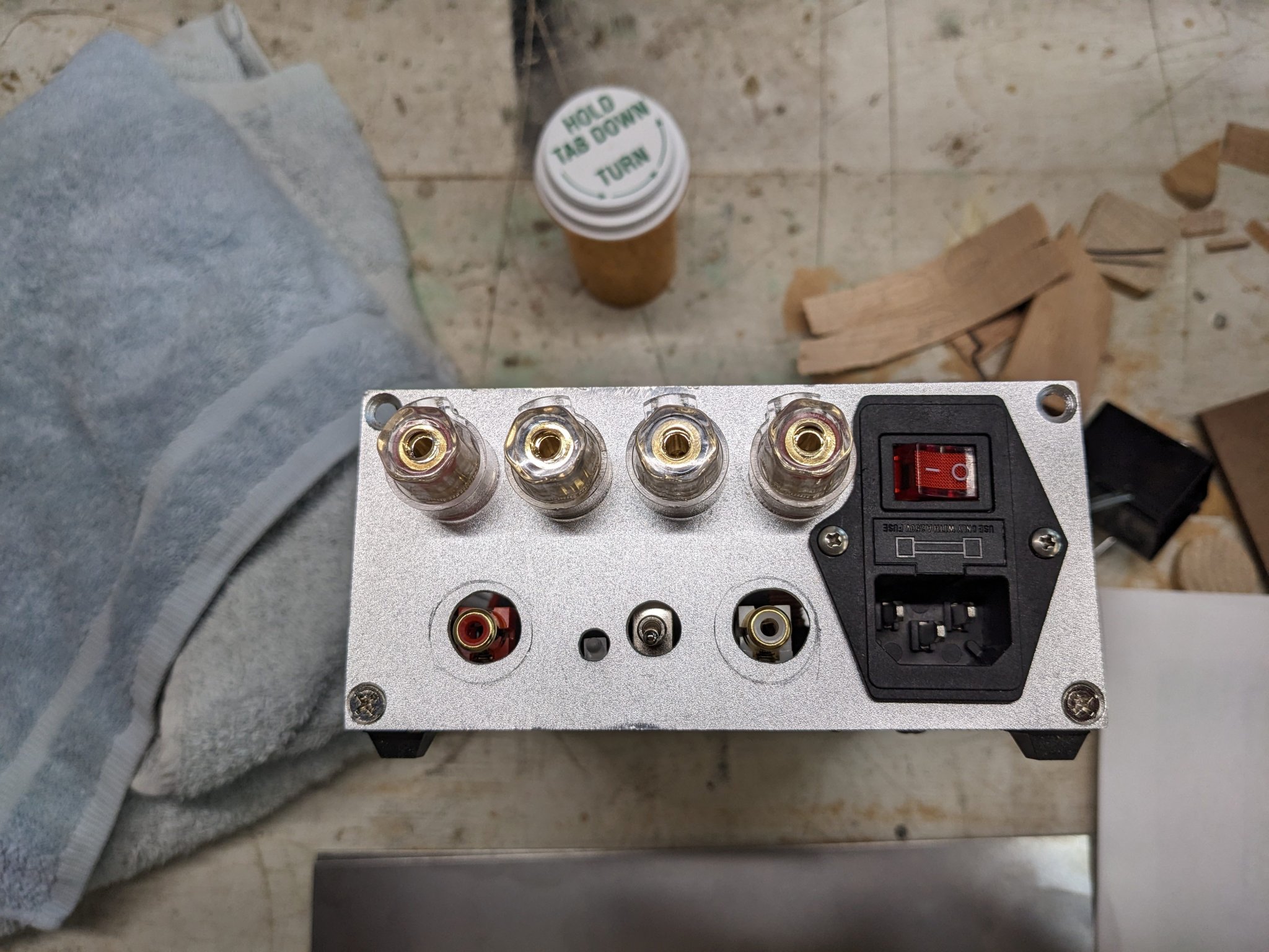

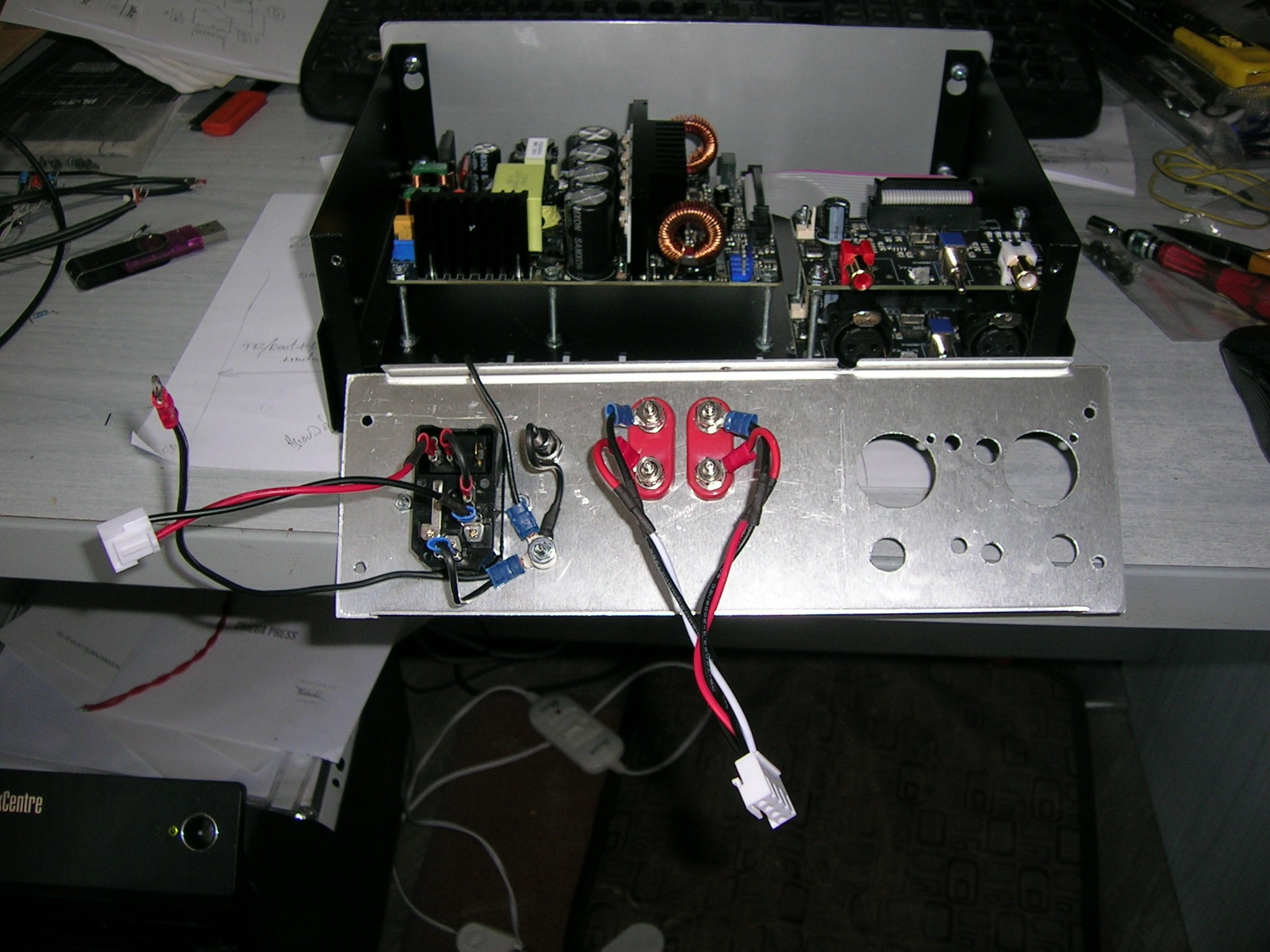

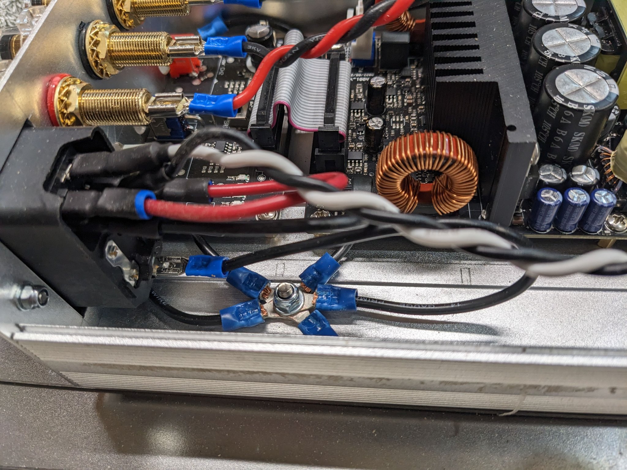

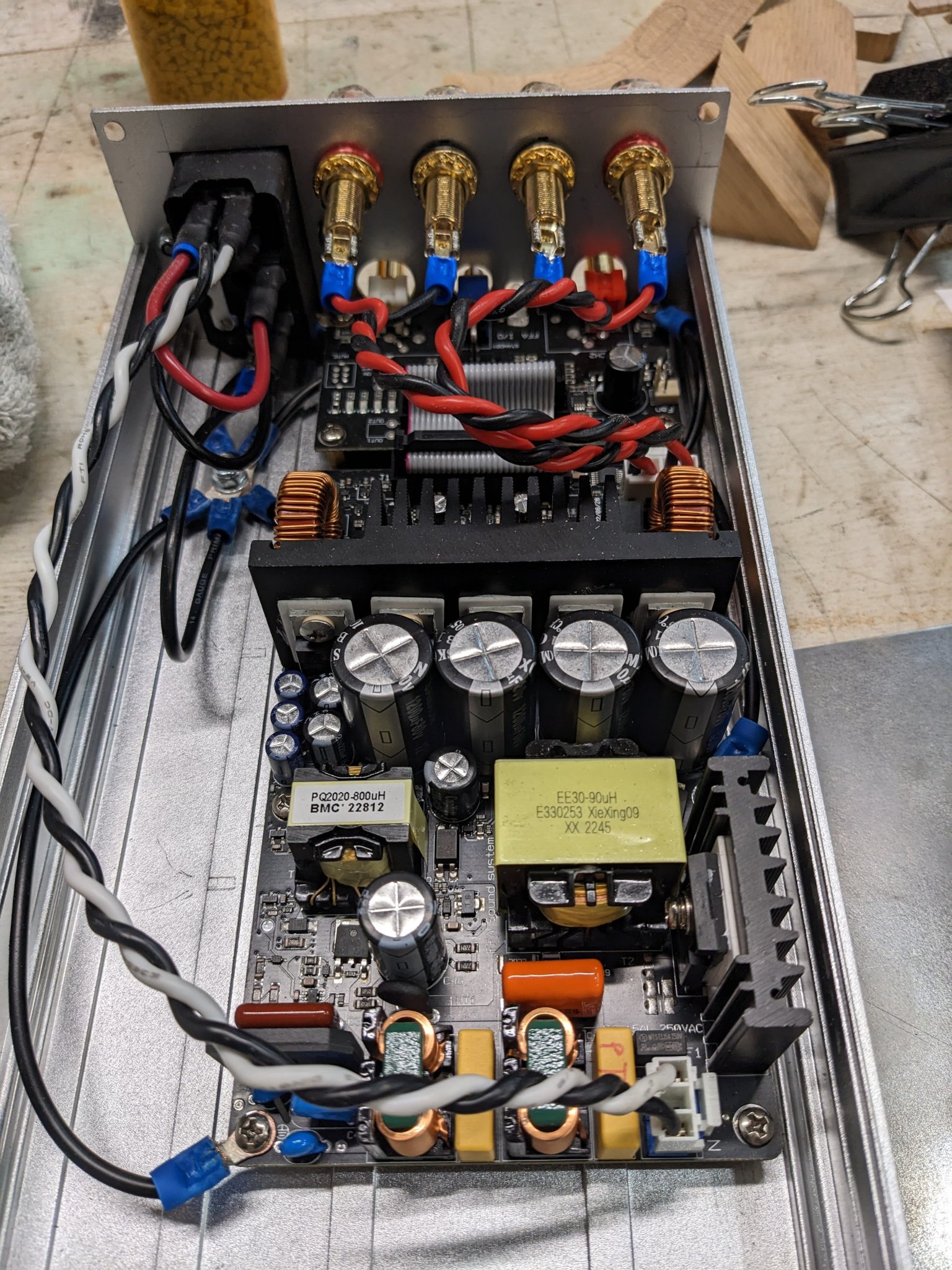

On the grounding practices, any issues with this arrangement? I think I got the ones mentioned, but skipped the optional ones.
Or other issues? Probably should have put the power inlet on the other side, I wasn't thinking and ended up with that heatsink close to the side.

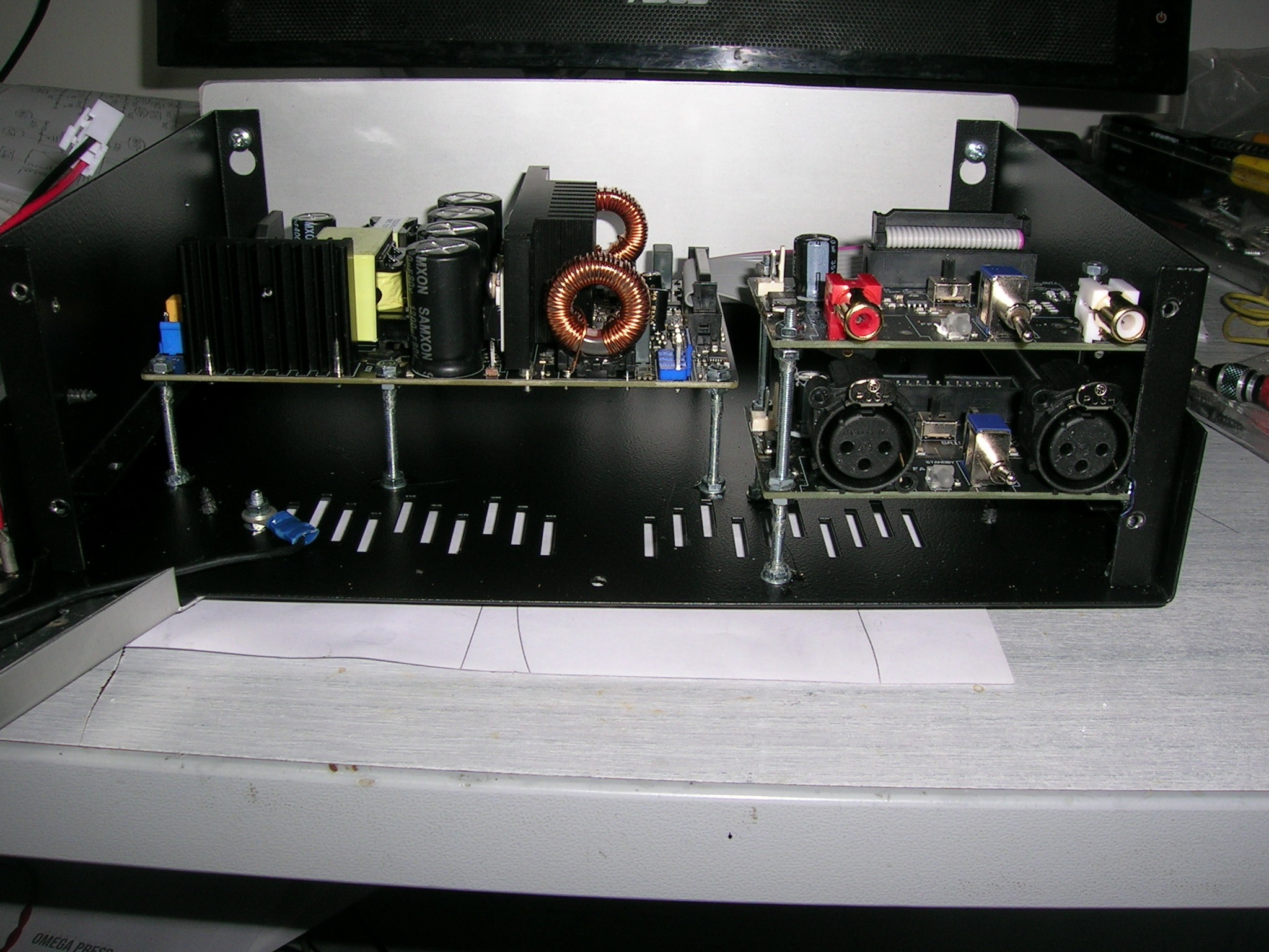

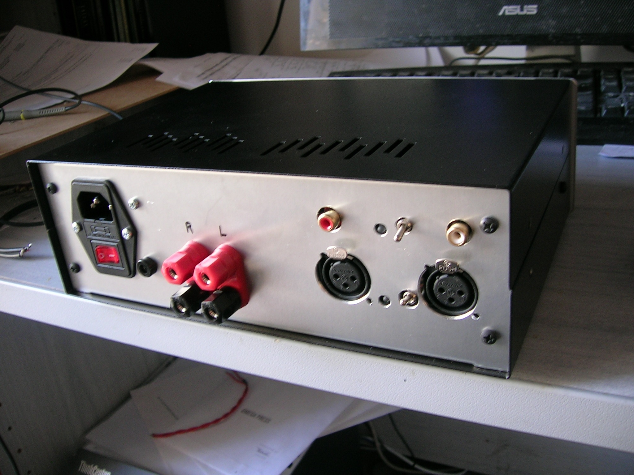

This box wasn't meant to be pretty, just done. The pretty one will come later, and use the XLR inputs, but someone kept reminding me every six months...
The 5th module is the one to be enclosed in a box.
25Euro chassis. 255mm W x 170mm D x 80mm H (internal dimentions)
George
George
