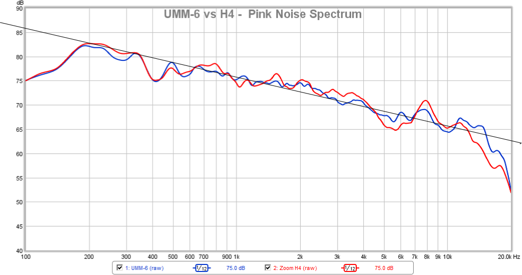

That is a Zoom H4N, a newer and different model than my Zoom H4 used here. Back in post 137 I showed the response of the H4 vs a calibrated UMM-6 with pink noise as the source. I don't think there is a treble lift at 5kHz like the 4N. It is actually a little depressed above 15kHz but within 2dB around the 5kHz range. It maybe that the drivers have a mild naturally rising response and since Round 2, I stopped applying a -3dB low Q high shelf as baffle step compensation. I match SPL between the woofer and full range near the XO point but if the driver has a self rising response - it is left alone and that may be what you are hearing.
Here is the H4 vs calibrated mic with pink noise.
But this is against the raw UMM-6 microphone correct? That means that the correction file has not been applied to it?
The UMM-6 has a naturally rising treble also as seen from typical calibration files. Like these from here (Serious Audio: Should You Get Your Measurement Microphone Professionally Calibrated?)
![All+Three+Cals.png](https://2.bp.blogspot.com/-cOx0M8ahijY/T5iK_UBisQI/AAAAAAAAABw/C6CK9h1mXG8/s1600/All+Three+Cals.png)
Plus we can see from your pink noise plot compared to an ideal pink noise 10db/decade line that there is some signature. But this is not bad.
![503596d1442011406-subjective-blind-comparison-2in-4in-drivers-round-4-zoom-h4-vs-ideal-pink-noise.png](https://www.diyaudio.com/forums/attachments/full-range/503596d1442011406-subjective-blind-comparison-2in-4in-drivers-round-4-zoom-h4-vs-ideal-pink-noise.png)
Maybe the brightness we hear in all the recordings (compared to the references) is just the +4db peak of the zoom H4 at 8khz that we see above when compared to the idea 10db/octave line.
The brightness seems universal in all the recordings so it does feel like it is part of the recording process (mic, preamp, room) so it should not effect the relative impressions of the drivers. Maybe next round you can try some test recordings with the UMM-6 and Zoom H4 and see if the UMM-6 looses some of that brightness compared to the built in mics.
But yeah maybe it is just the loss of the -3db baffle step correction from previous setups. But we should see that in your measured FR plots (once you release them), yes?
