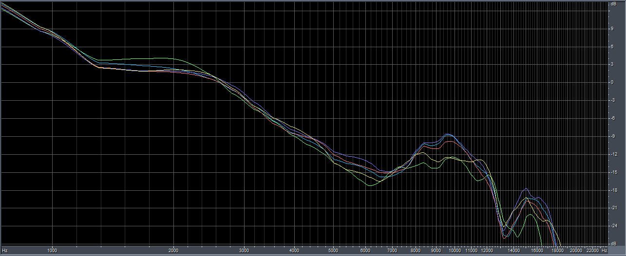

not quite pink
A 42k sample of clip-2 with 128 point FFT averaged window for A,B,D,E and F:
This looks very similar to X's pink spectrum comparison of UMM-6 and H4 microphones, but peak is shifted up. I've listened to this 0.875 clip continuously looping while applying PEQ of various depths and widths at various points in the spectrum. Elements of drivers frequency response can be more similar, but doesn't change the character of how the drivers seem to fill the recording space. EQ doesn't change polar pattern of drivers. Based on driver documents and looking at 30 degree and 60 degree off axis responses, they show significant differences. Differences in rate of roll off and peaking behavior in off axis responses has big impact in a highly reflective room.
Headphones/earbuds are best way for getting into X's recording space.
