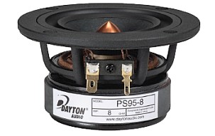

My secret surprise entrant was the Dayton PS95-8: a $24 alloy framed, paper coned, inverted surround, full range driver with a phase plug. It is a bit bright on-axis, so I did a passive "EQ" by pointing it 30 deg away from the mic to balance the response. It has received some votes and I think in general the votes seem to indicate that these are ALL great drivers and you can make a great sounding speaker with them.

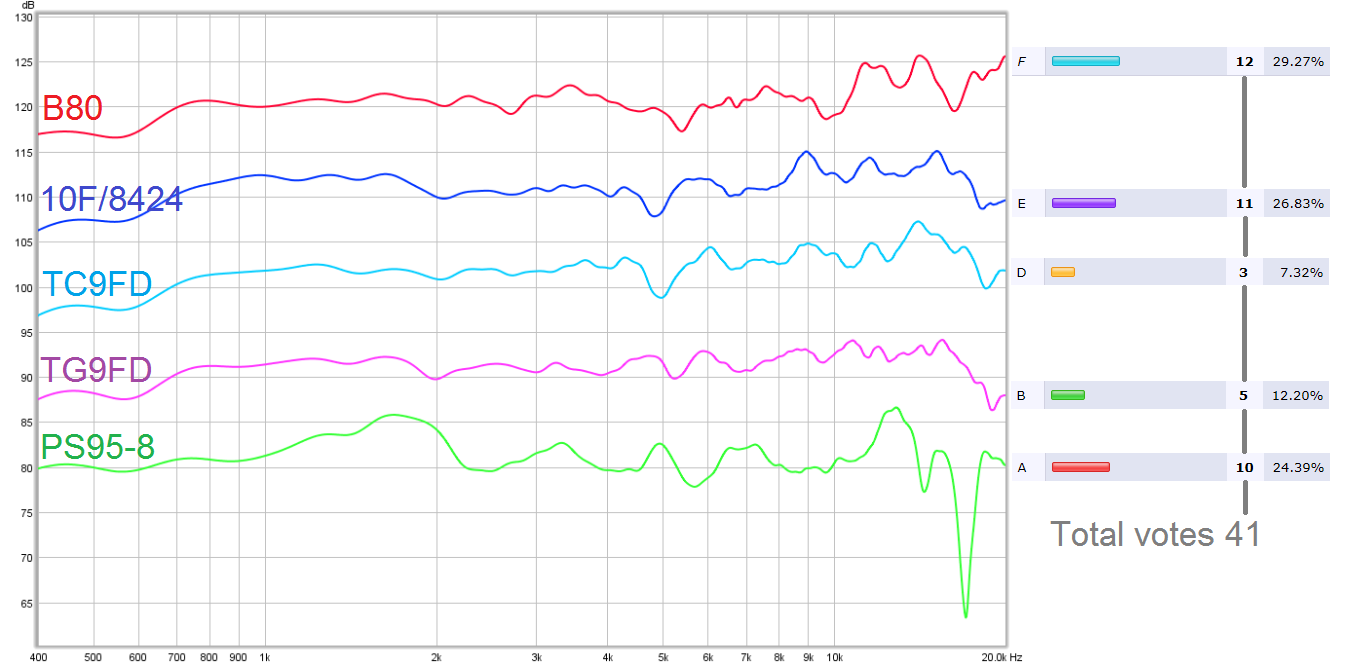

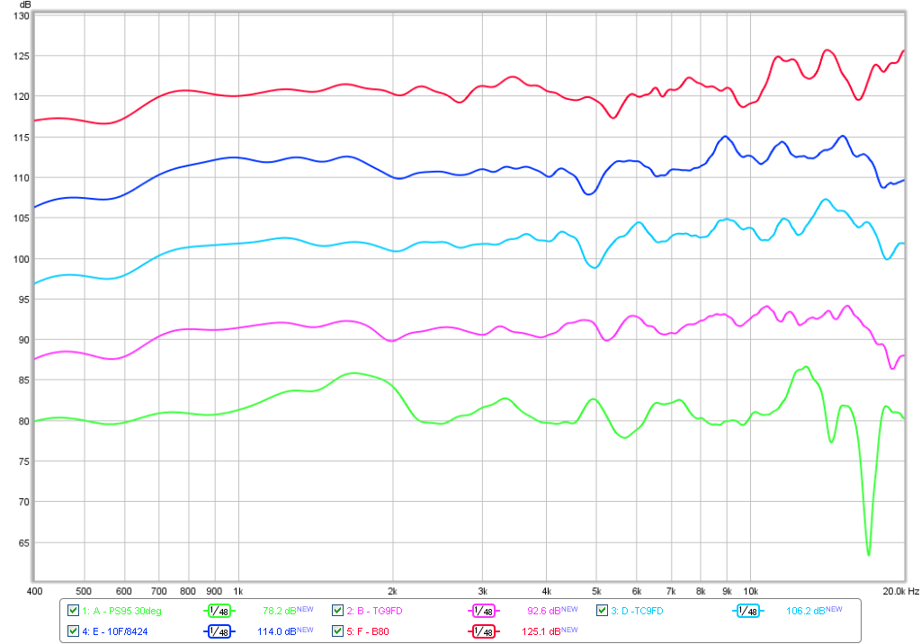

Here are the measured frequency responses (4 ms gated and 1/48th oct smoothing, 10dB shifts to allow viewing):

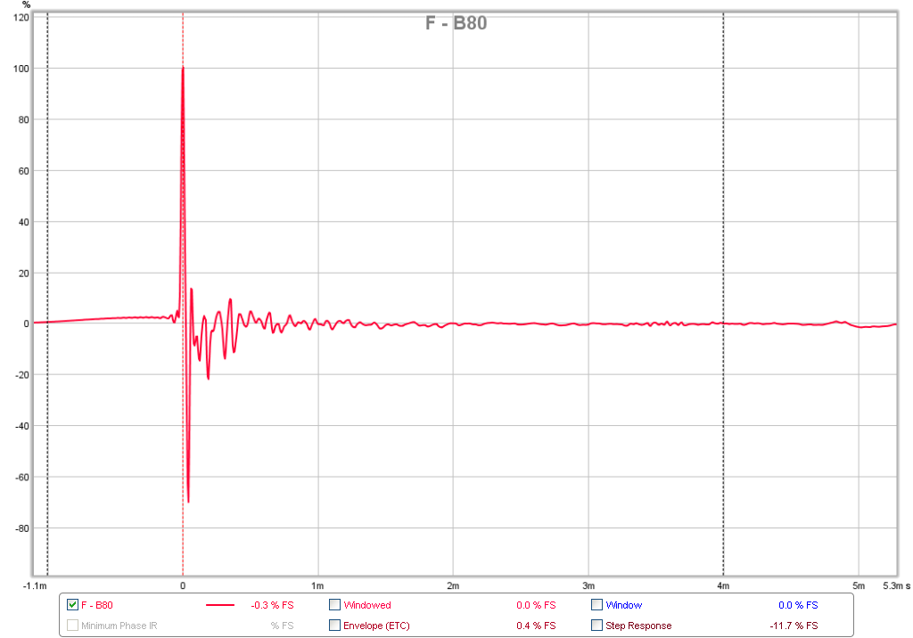

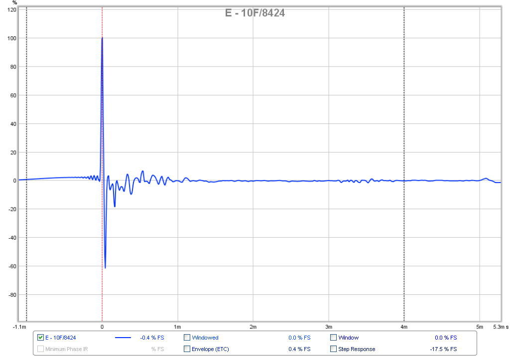

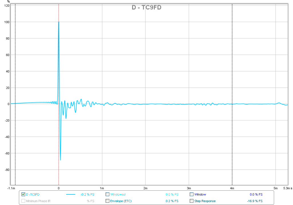

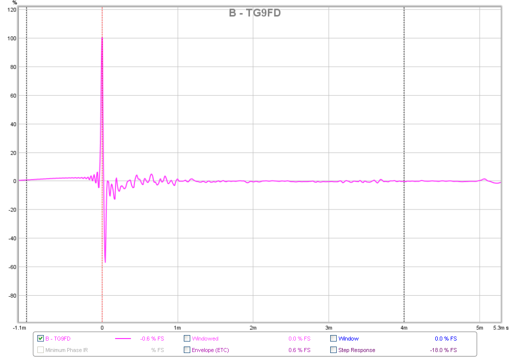

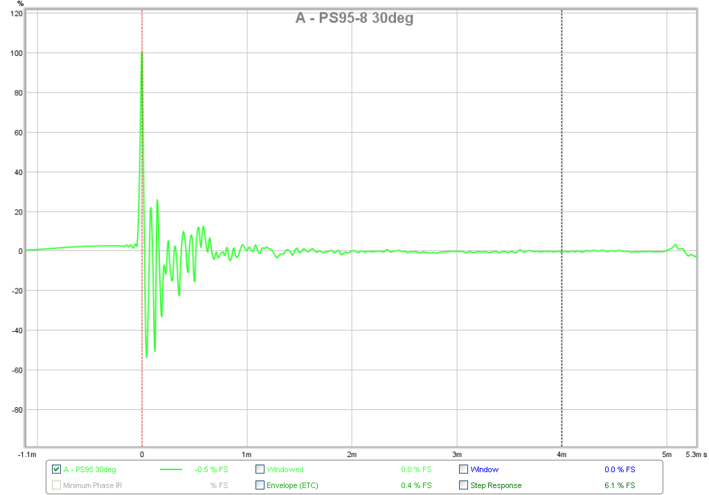

Corresponding Impulse responses
PS95-8 at 30 deg off axis:
![504224d1442325845-subjective-blind-comparison-2in-4in-drivers-round-4-ps95-30deg-ir.png](https://www.diyaudio.com/forums/attachments/full-range/504224d1442325845-subjective-blind-comparison-2in-4in-drivers-round-4-ps95-30deg-ir.png)
TG9FD:
TC9FD:
10F/8424:
B80:
It seems that there was a clear preference for the B80, 10F/8424, and the PS95-8. There is a similarity between the B80 and PS95 construction: phase plug, paper cone, large cast vented baskets. But the PS95-8 is something we can all afford, and more importantly, FIND in the U.S. easily. The B80 is almost impossible to get in the U.S. Although not getting many votes, technically, I think the TG9FD has the flattest frequency response and I would not hesitate to use it. The fact that the $12 TC9FD even made it into a competition against a $100 ScanSpeak says volumes about how capable it is. Don't discount it because it did not get a lot of votes. Finally, I hope everyone got to experience the sound of these drivers virtually and that it was useful.

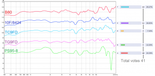

xrk971,
Thanks for fun interesting round to squeeze data from
Below summary from all rounds it seems baffle/woofer-system from round 2 verse round 4 change how its F10 or TG9FD that win flattest frq response on axis, at round 2 10F was micro flatter than TG9FD but reversed here at round 4 .
Round 4:
Round 4:

Thanks for the summary. The change from the trapezoidal baffle to the rectangular baffle used in Round 4 probably increased ripple due to diffraction effects. Diffraction should theoretically be less with trapezoid and that seems to pan out. The Nautaloss spiral sealed TL is also 3 feet long vs 12in long Dagger so there is more room and more volume for the drivers to "breathe" with the earlier rounds. Perhaps I need to go back to Nautaloss and trapezoid but keep woofer sealed with RS225 like in Round 3? That configuration is indeed much more flexible as it can accommodate 5in drivers.
I picked the B80 by a whisker. The 10F was right on par, and for that matter so was the PS95. Apparently this was about what everyone else thought too.
I liked the TG9FD the least.
Now for the critique: I thought all the drivers sounded pretty bad. They were quite congested and the sound was not very resolving or realistic. Presumably this was due to the cumulative effects of the playback electronics, the recording mic and electronics, and the mp3 compression. I suspect the latter was a large chunk of the problem, but compression would be tough to avoid for this sort of internet test. There's also the issues of cabinet cry and room reverberation. At least these things are equal for all the drivers.
When everything is sort of fuzzy, the most obvious difference is the frequency response, and it doesn't surprise me that ratings have sort of tracked FR in earlier tests. However, this is also the most easily corrected issue. I am mostly concerned about the ultimate potential of a driver. High distortion cannot be corrected but FR can.
The other issue is that sometimes a cheap and cheerful fuzzy driver can be flattering with a less than perfect source, whereas a super clean hifi driver will make it sound grating and horrible. IMO, the best fullranges, even the most resolving ones, balance these qualities somewhat.
That said, clearly this test still was useful (and fun). We certainly learned something, as people were able to consistently pick out the arguably better drivers. Also, it's better to do something than nothing, despite imperfection, which is unavoidable anyway...
So kudos to X for conducting it, and kudos for those who lent the drivers.

I wouldn't mind that if it cures the upper tilt that wasn't there in round 2 but did throw me off a bit in round 4. Like Jay I was searching for those lovely Nora Jones vocal sounds and I know I like Ann Wilson. But somehow that wasn't present in this round. Closest for me were the D and E drivers somehow but they did have too much on top. Seeing the frequency response explains it a bit.
