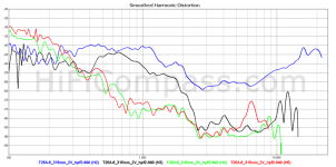

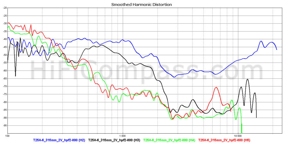

The N26 are in my Cecropia Supremes, and are the most transparent design I've done. The TLabs are however higher in second order than the 27TAC, EVEN IF lower in 3rd. Used correctly, I think either is top notch, but theTLabs are now NLA.
