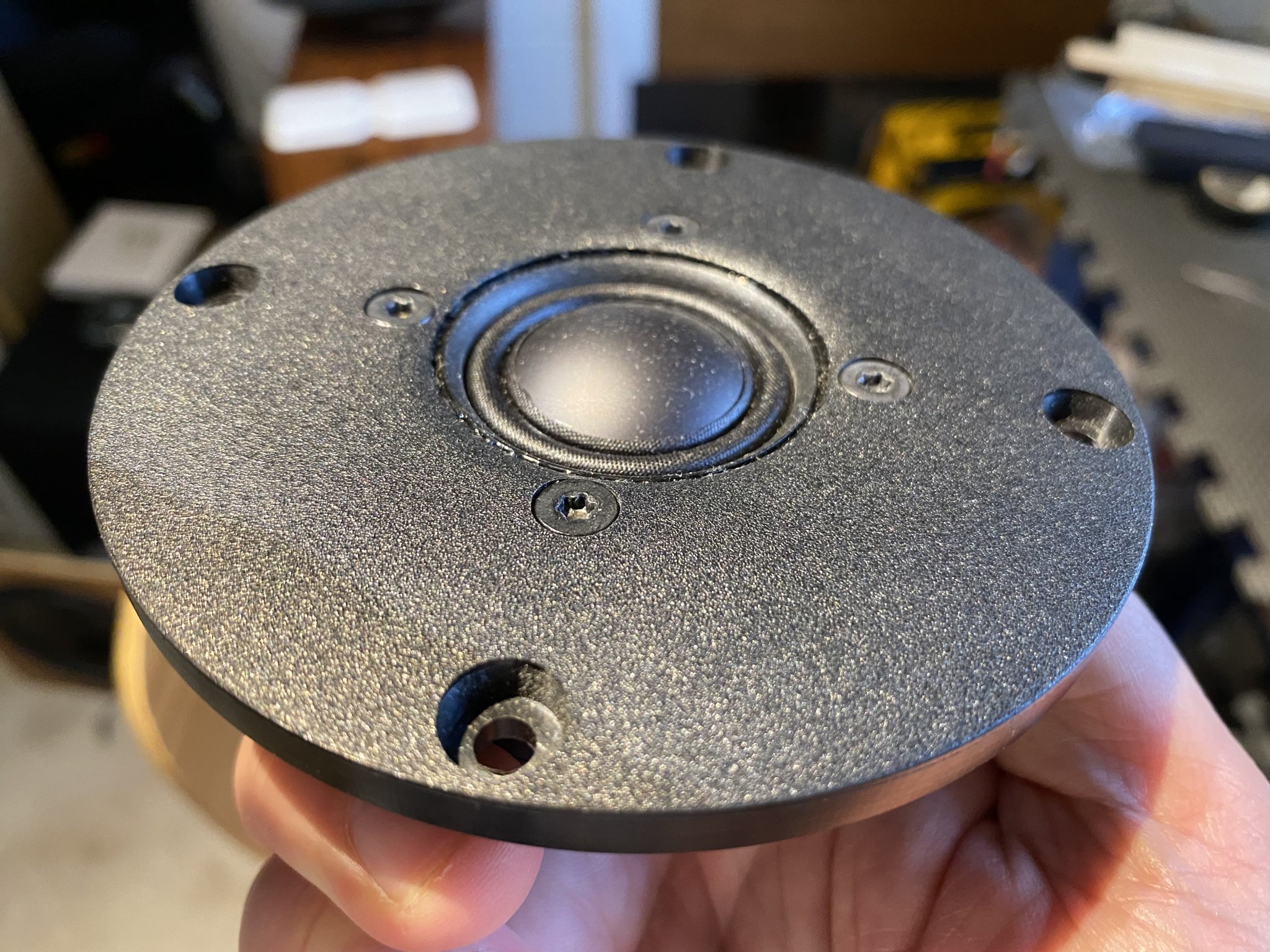

Grill removed. Reveals a ~1mm deep circular trench, to which grill was glued.
![IMG_1995.jpeg IMG_1995.jpeg](https://www.diyaudio.com/community/data/attachments/1143/1143040-50a5520bc64b6c77af4440851e7796d6.jpg)

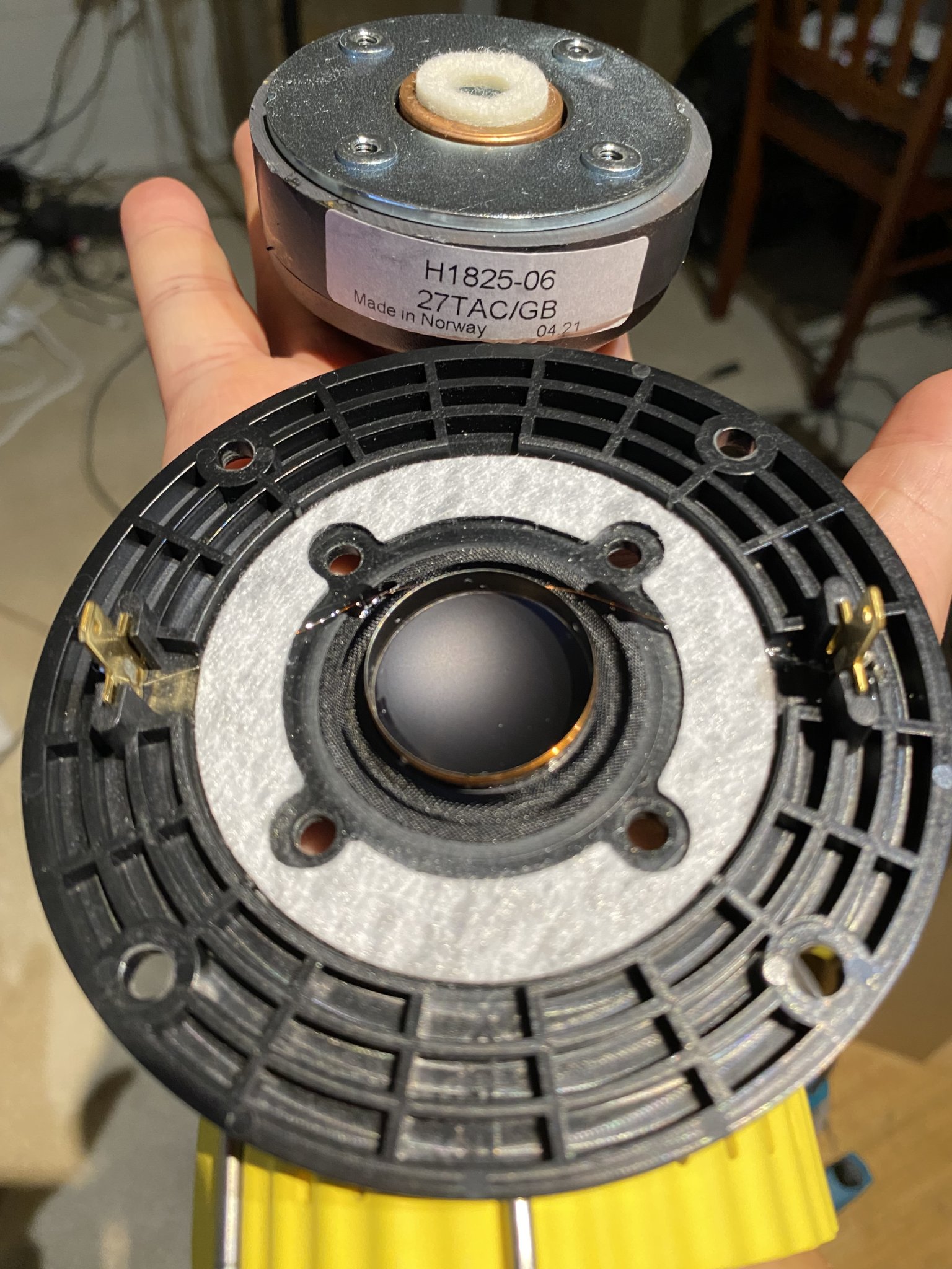

I suspect that circular trench is what is responsible for the dip at 20KHz. Furthermore the faceplate is not completely flat, and the VC is integrated onto it, like other plastic faceplated SEAS tweeters, as @profiguy and @5th element surmised.

And I can confirm that the WG148R leaves a big gap due to both the circular trench that the grill goes into, as well as the non-flat faceplate.
The WG300 may be adaptable, or a custom WG, of course. But It's a low priority for me at this stage,
