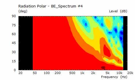

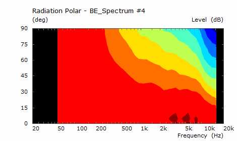

Driven by mode 0,1 (horizontal/vertical and diagonal polars).
My knowledge is quite limited to follow the discussion following this post...
This pictures attached shows that this design is not correct? I compared to the pictures shown in post #7029 and the ones from my design look quite different (I assume worst).

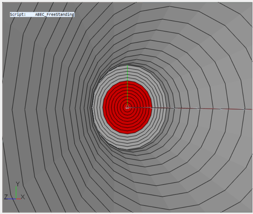

Paste this into the ATH model config file to get 2" 0,1 instead of spherical cap :
Should make the ABEC drawing look something like in the attachment
Mabat posted the Source.Contours few days ago.
