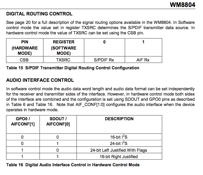

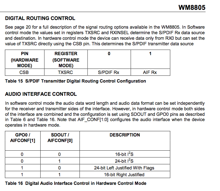

WM8805 does support a 16-bit word length, but encapsulated inside the I2S frame which has 64-bit length (plenty of 0 bits). You will need the logic for the AD768. I recommend you test it on a breadboard first![]()

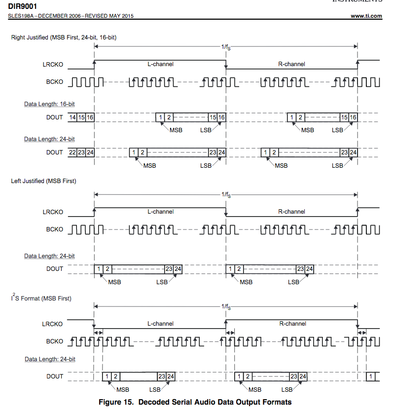

Yes offcoure but I think that word total frame length are 32bit. LE or WCLK is 32bit. Each bit is one SCK...
4 x 8bit shift register needed. Last 2 not used. Left justified format, with MSB inverted.
IF I2S format used one simple circuit has to be added to delay LE/WCK line for one BCK and make Left justified format from I2S format.
Inverter from BCK to FlipFlop clock pin, from -Q output is new delayed WCLK, set and reset pins to +.

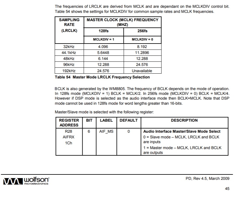

According to the datasheet the fs (file sample = LE = WCLK = LRCLK) is 64bit length. BCK for this fs is generated from MCLK and it is divided by 2 or by 4 resulting to 64 ... am I wrong?
![spin :spin: :spin:](https://files.diyaudio.com/forums/images/smilies/spin.gif)
If it is 64 bit WCLK length, that is for L/R chanels, then the one chanel is 32 bit. So for 16 bits first 16 bits are word other are 0, and for 24 bit the same first 24 are data word rest up to 32 bits are zeroes.
For DIR9001 Yo have 2 options:
1. 24bit Left justified
2. I2S (also left jusified with WCLK 1xBCK prior to the MSB) You need simple circuit to make Left Just. format

For WM8804 and WM8805 You have 3 options to choose. Again with I2S choosen You will ned simple correction circuit.
I will post the circuits

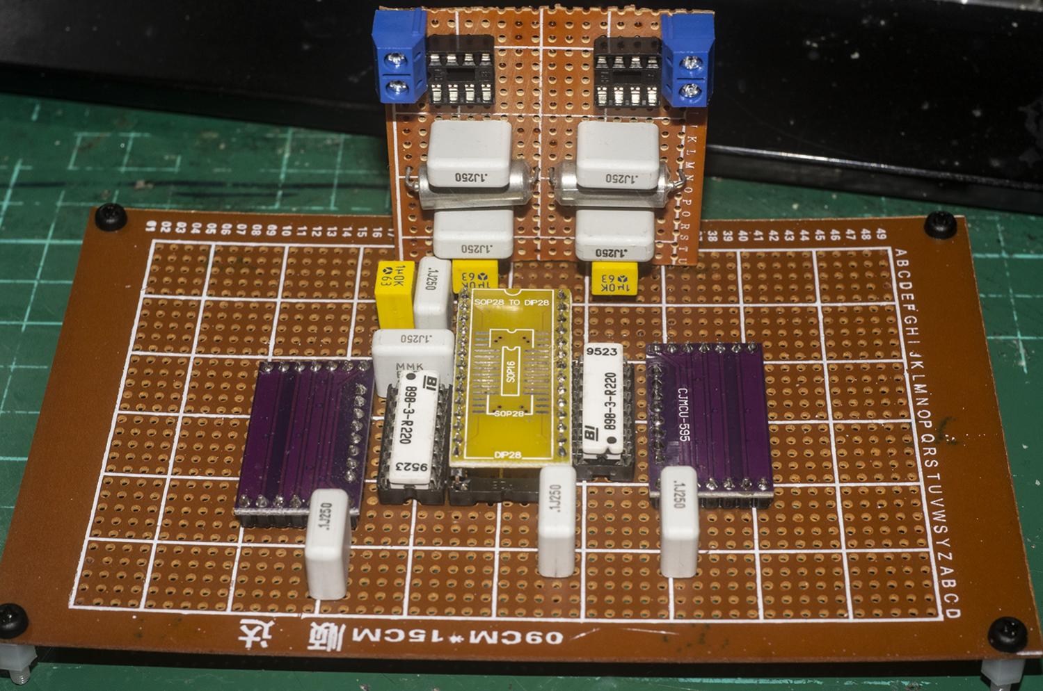

I've made a start putting this thing together. I have used resistor arrays in sockets so if the 220r value proves to be too high, it's a simple job to change it.
The vertical board is the power supply for the DAC chip, I wanted to place it as close as possible, hence the orientation. Some ofthe decoupling caps could fit on the main PCB, the white ones are EVOX MMK 0.1uF, the yellow ones are 1uF, not sure if they are polyester, polycarbonate or polypropylene, just using what I have. The silver cylinders are 100uF tantalums.
The 595 modules had to be mounted upside down to have the pins in the right order to match up with the input pins of the DAC. I haven't soldered those modules in place, just pushed them into the holes on the PCB to check if they will fit. There is plenty of room to add more logic, I won't solder any of the logic in place until we have finalised the designed, I just wanted to put the DAC chip and it's power supply arrangements together to get an idea of how things will fit together.

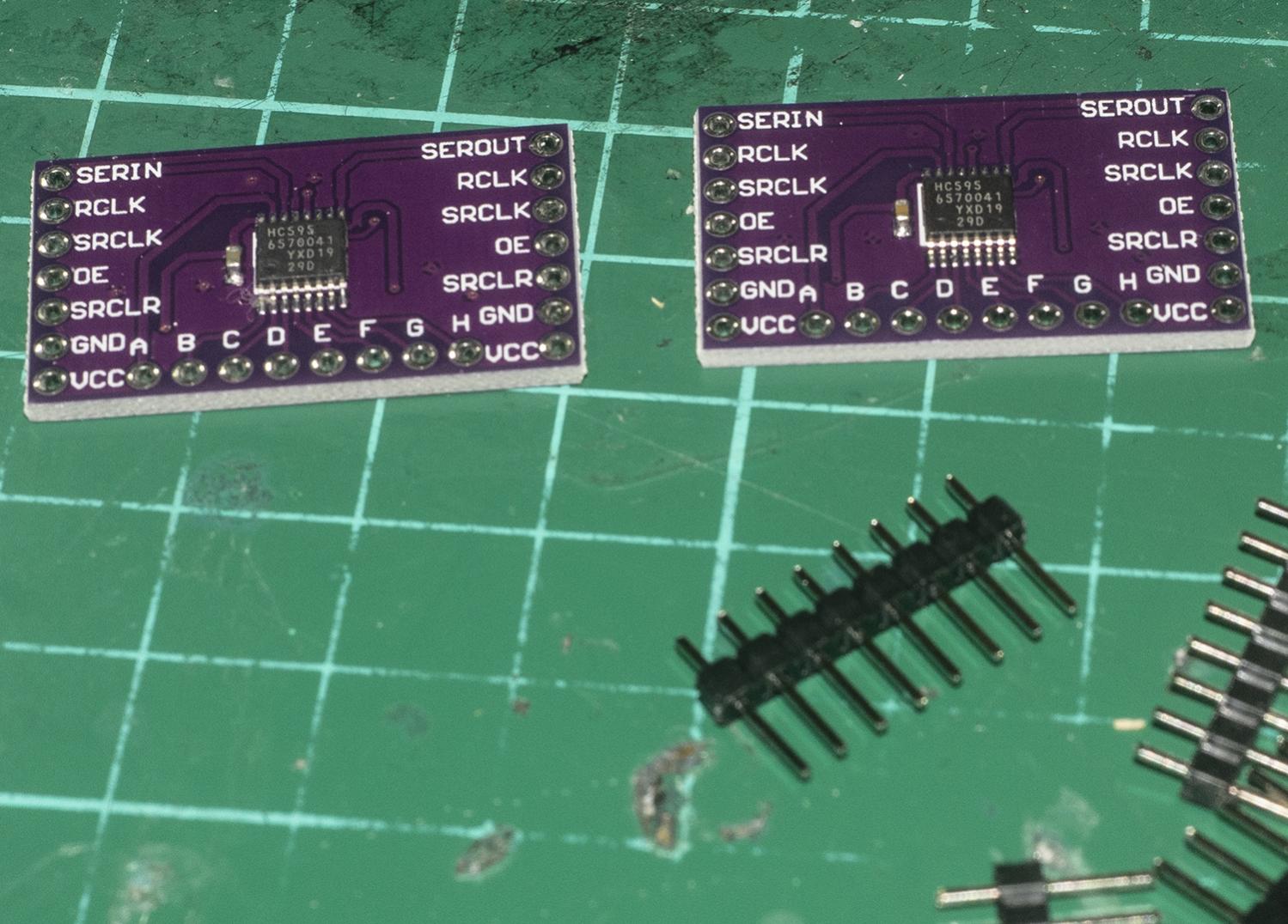

Hi
2 options for serial to parallel data.
One with 164 familly (tested and working with I2S input Diskrete DAC serial interface)
Second, with 595 familly logic, (I tested with DSD format, but it will work for this purpose). Enable is negative and could be use as MUTE when connected to +V, or HI
