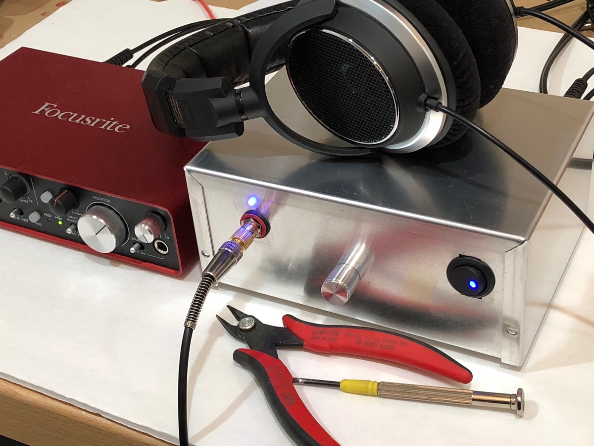

I have been listening to this preamp configured as a hot running headphone amp (HPA) for past couple of days. I have to say that it is a very impressive sounding amp. It has the resolution and articulation of a DC coupled amp. The smoothness of a SE Class A amp and the dynamics of a push pull amp. Overall a great balanced performer that does not disappoint. As a preamp or headphone amp the volume control is butter smooth. No grain or scratchy sounds as you adjust. Finally, absolutely no turn on or off pop or thumps. Just silence - no matter when or how you turn on or off (no delays or relays needed).

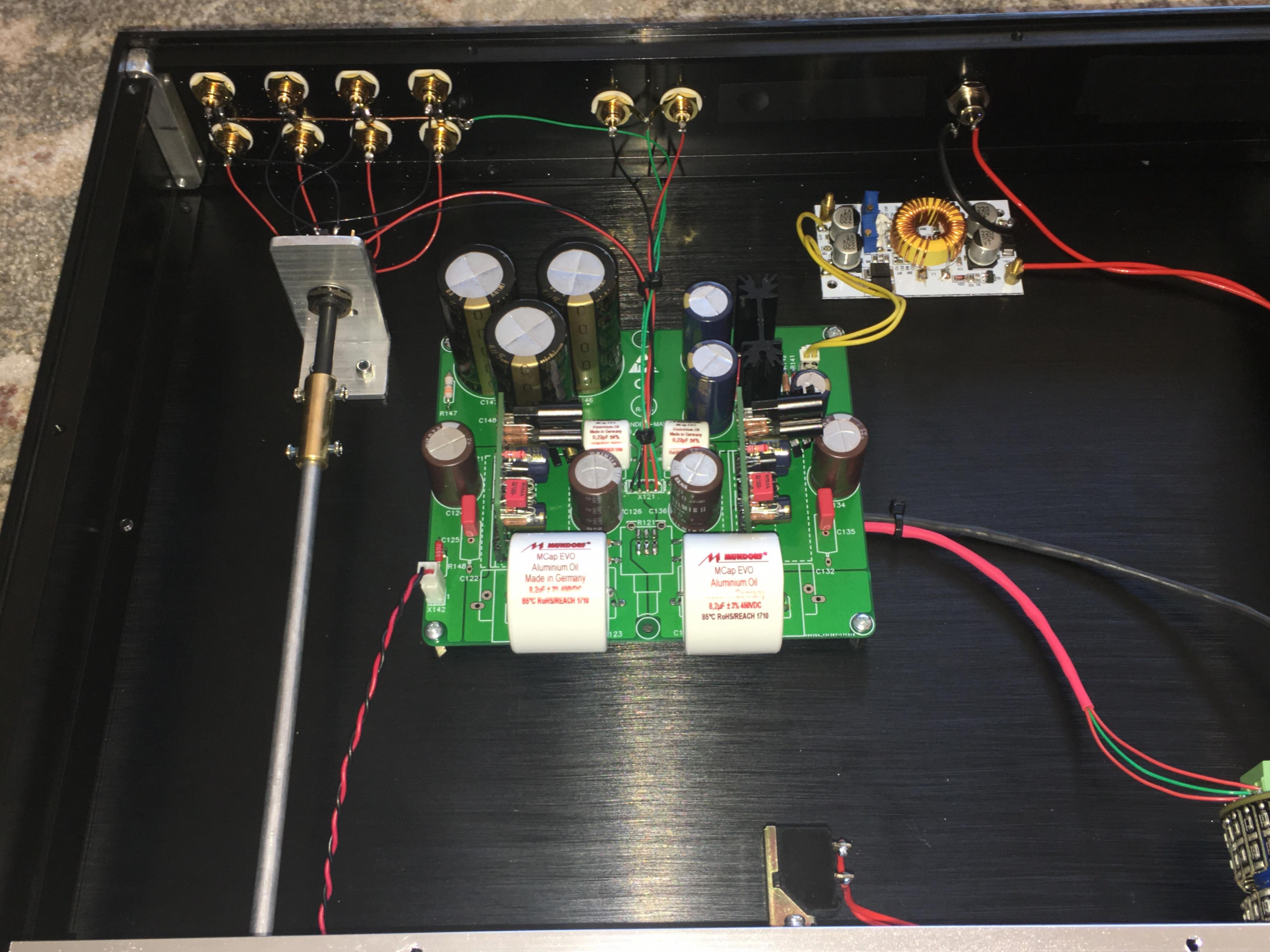

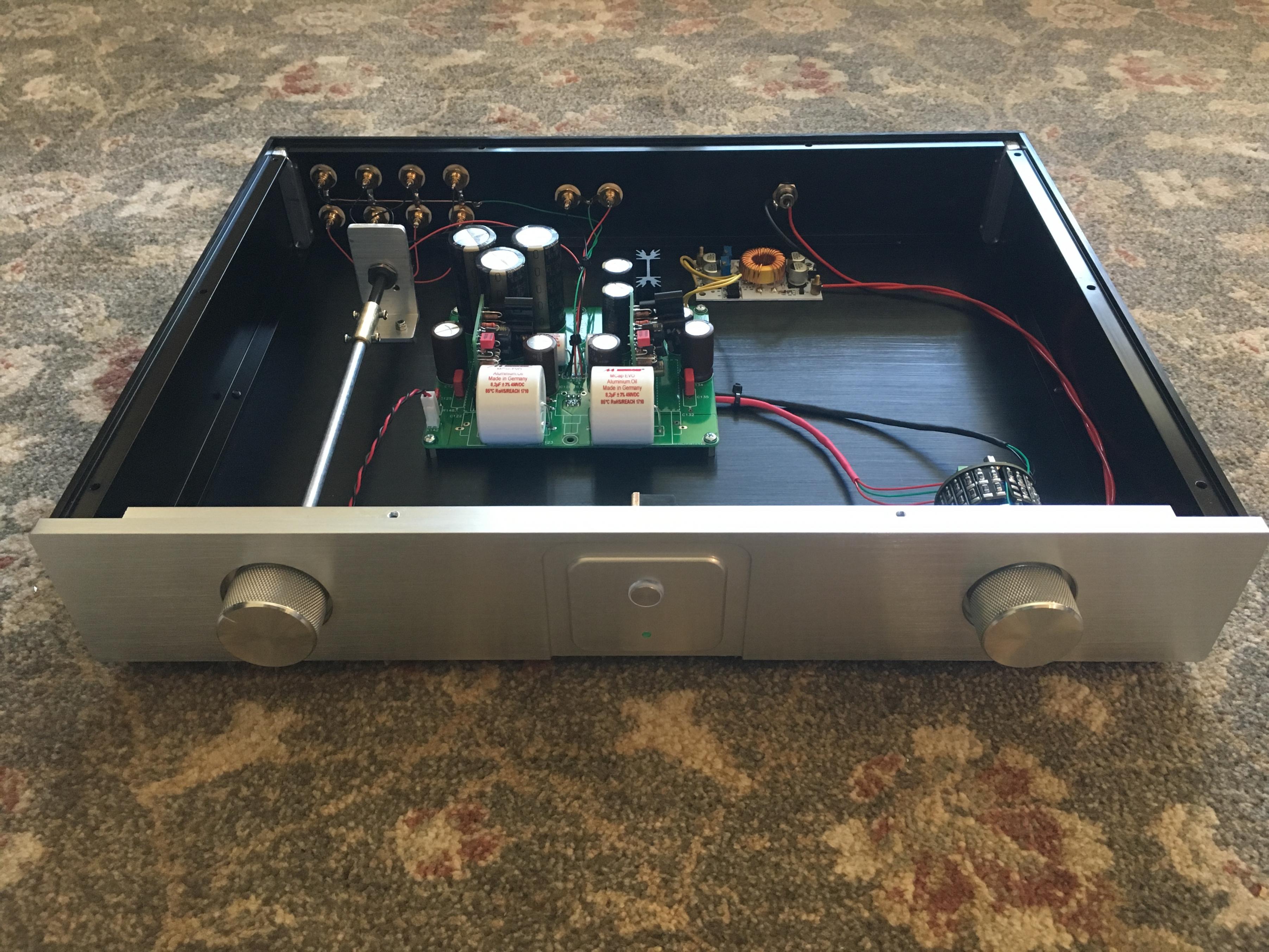

Just wanted to share my AKSA Lender preamp project.
I’ve been on a mission to get my AKSA fired up..... SUCCESS!! She is paired up with my Big MoFo and playing sweet music right now🙂
I can’t believe the low frequency information that I’m hearing, not that it’s emphasized, it just wasn’t there before. Still very early to ‘critical listen’ but this combo sounds excellent so far.
I’m running at 40.5vdc after the cap Mx.
Q4 and Q5 run pretty hot, is that ok? I bent up a couple of small heatsinks to help but as you know, it’s a real tight spot.

Vunce,

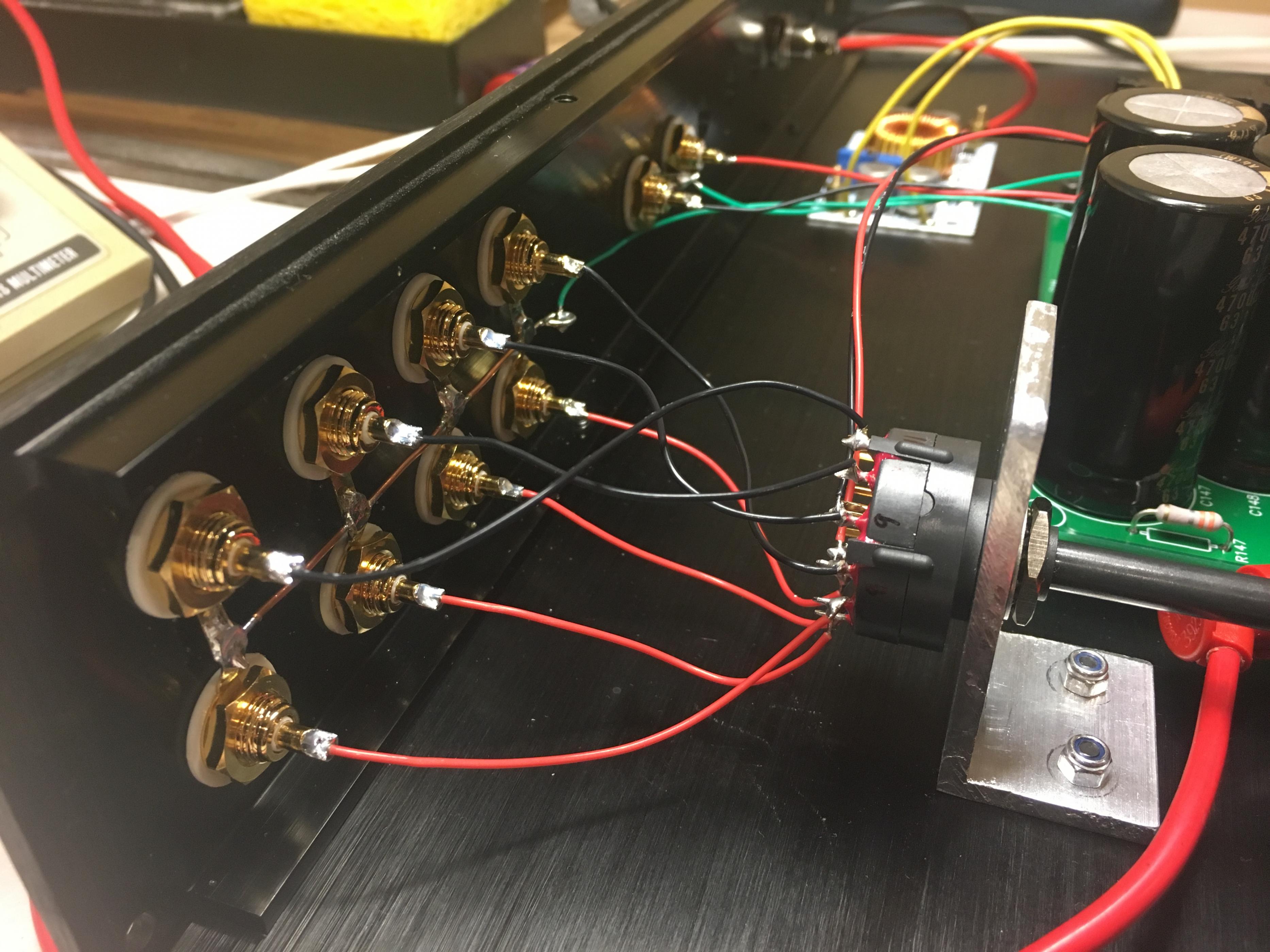

Brilliant, artisan work! I love the Al angle bracket, even rounded to take out of the sharp points, elegantly done. Very nice wiring of the selectors, and really well earthed. You could have done it all in a box three times smaller!
When I penned the preamp circuit I never expected it would be so good. Thank you for showing it to the world - you and XRK are best!
Hugh

Thank you X and Hugh for your kind words and bringing this project to the DIY community!!
The ability to ‘tune’ the preamp boards to whatever amplifier is downstream is great. This potentially could be the only preamp I need. You can also successfully use it as a headphone amp as X has outlined, very versatile indeed.
Yes Hugh, I certainly could have used a smaller enclosure. But, I was originally going to install the power supply inside for a single chassis unit. In the end, I decided against it.
BTW, How does the rug rate, haha!

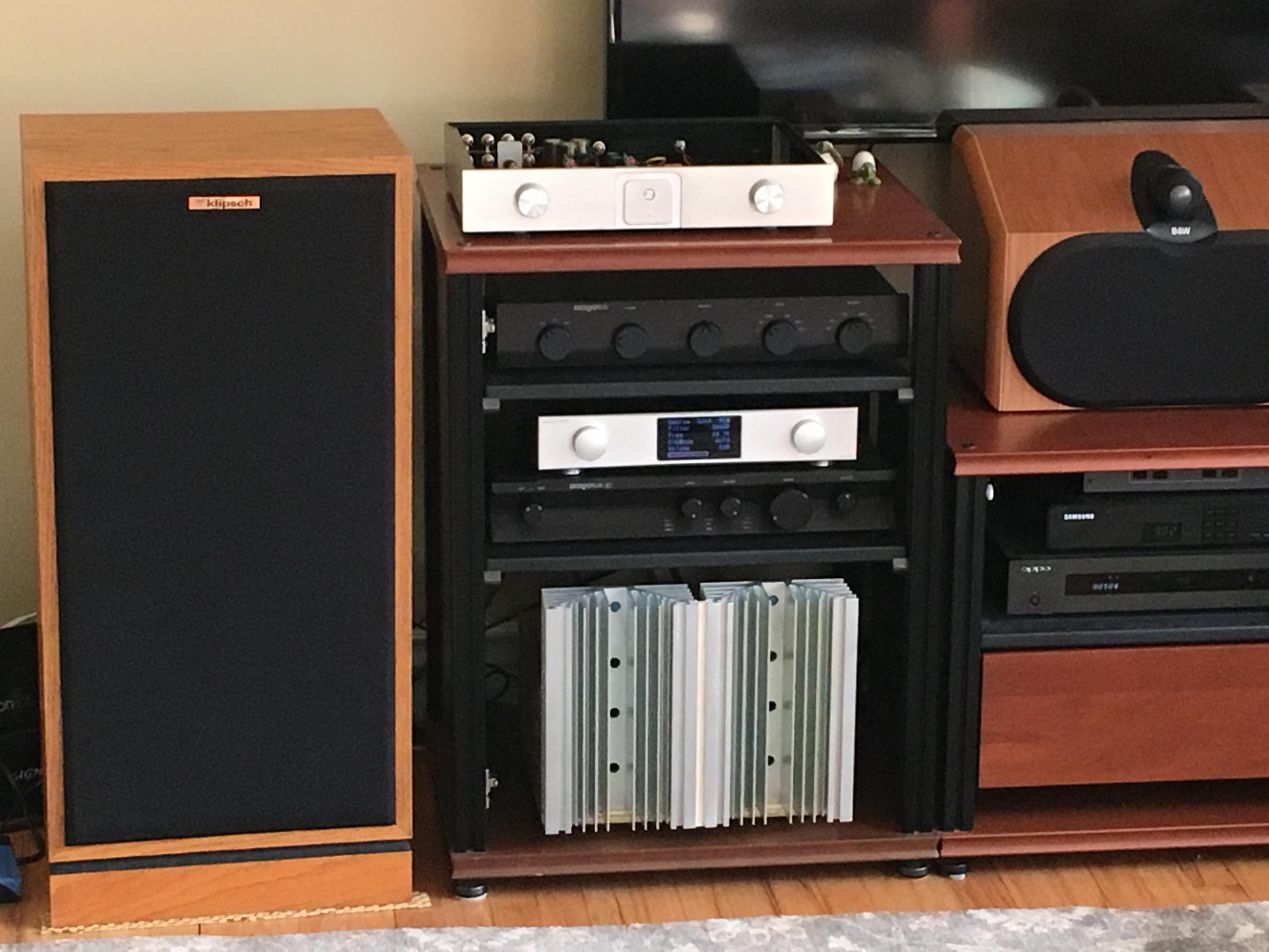

The MoFo is driving a pair of modified Klipsch Forte’s. I was using an
Aragon 18K MkII prior to the completion of my AKSA and that combo sounded good but just didn’t have the slam or volume to satisfy me. When I replaced the Aragon with the AKSA Lender preamp a large transformation happened. It was like a shot of steroids was injected into the system! Very wide soundstage, the ‘capture effect’ was back (that’s one I’m walking through the room and just have to stop and listen), major increase in the available volume. But, the most surprising change is an increase of low frequency information I’m hearing/feeling. It’s hard to explain, I hear/feel music now that sort of comes up from the floor? Weird, I know.
All in all, I’m extremely happy with the AKSA Lender/MoFo combo!

Forte’s are 99dB sensitive so you got plenty of volume even with an 11Wrms amp. Nice.
With an 8.2uF input cap the F3 is 0.4Hz so even 2 octaves above is 1.6Hz. So your response is probably close to flat to 2Hz on the bottom. If your source material has infrasonic content and your speakers can handle it you are probably get 20Hz stuff from the speakers.
Did you ever post photos of your MoFo? Would be nice to see the whole setup with the Aksa Lender, MoFo and the Forte’s. You did a really nice job on the preamp. Super high quality work - thanks for taking the time to make it work and look good. Top of the line coupling caps too.

When you get to build them, I’m sure you’ll enjoy the combination. Efficient speakers are a plus. I like the Mundorf EVO oils, good price/performance and their size is manageable. I posted pics of my MoFo on the ‘Build This MoFo’ thread.
