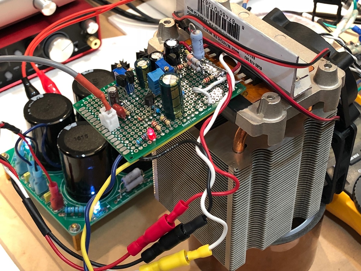

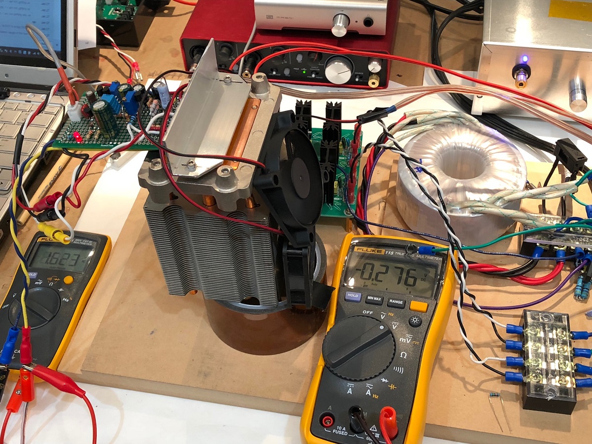

Ok folks, it was a struggle for me but I got the amp fired up and singing finally. Hugh's design which incorporates the Aksa Lender front end, and the Pass Aleph CCS variable current source, with a P-channel MOSFET output stage, so technically it is a hybrid Aleph output stage, hence the name ALPHA. It is a very clever design and has the best of all worlds I think.
I will post in a new thread soon - just needed to confirm that the amp works before doing so. Happy to say it sounds pretty nice. Running 1.16amps bias at present with CPU cooler heatsink only at 31C so plenty of room to go. Very cost effective way to cool hot Class A amps for $12 (vs beaucoup bux for equivalent aluminum finned heatsink).
Here are some first sound photos...
Test rig with +/-24v linear PSU with Prasi./Project16 CRC:
Here is closeup of the amp (the two MOSFETs are clamped under the aluminum L section bar), heatsink temp is 31C with quiet mode fans going:
Here is an interesting fact, the DC offset is 0.0mV and I have no offset adjustment pot! I matched the Beta's on the input LTP and that was it.

I have to say, I am really impressed with how much heat these CPU heatpipe coolers are. Did you know that the heat flux carried by the water vapor inside the pipes can be as high as the heat flux at the surface of the sun for the same cross secrional area? Nothing transfers heat at a higher flux than a heat pipe. Thermodynamics at work. Anyhow, 56w was nothing for this heatsink. I was running a slow fan. I think it could handle 120w no problem with a faster fan.

One reason I like the Dell above is it has a huge copper surface that easily holds two MOSFETs.
