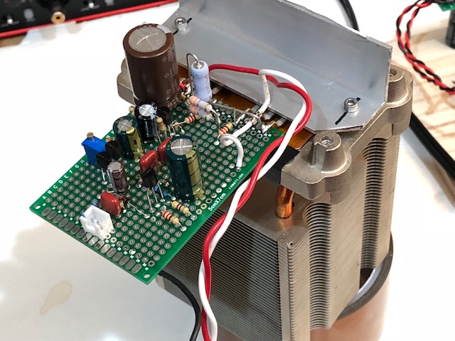

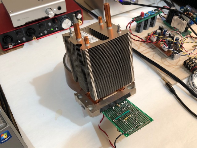

So.... Hugh and I were just talking about this and in fact we have a new power amp to share. But I must first build and test it. It will have an Aksa Lender front end built-in so no need to use your Aksa Lender pre to drive it - although wouldn't hurt to use it for volume control. The amp will be Class A of course, and SE Class A, but with adaptation of a famous CCS. It will use the usual +/-24v and have a bias current of circa 1.6amps. Output power in the range 25w or so into 8ohms. But the special thing is that it will be relatively low distortion for a SE Class A amp, and have the usual nice harmonic profile of dominat 2nd order and monotonically decreasing higher orders. I am looking over the schematic now and debating whether or not to make a layout on copper PCB and hand etch, or just P2P it on veroboard.
Some progress - all built up and now need to double check circuit routing and connections against diagram before applying power. The aluminum bar is used to clamp an IRFP240 and IRFP9240 against a copper block cooled with heat pipes and fins from a CPU cooler. Hopefully good enough for 80w. 😀

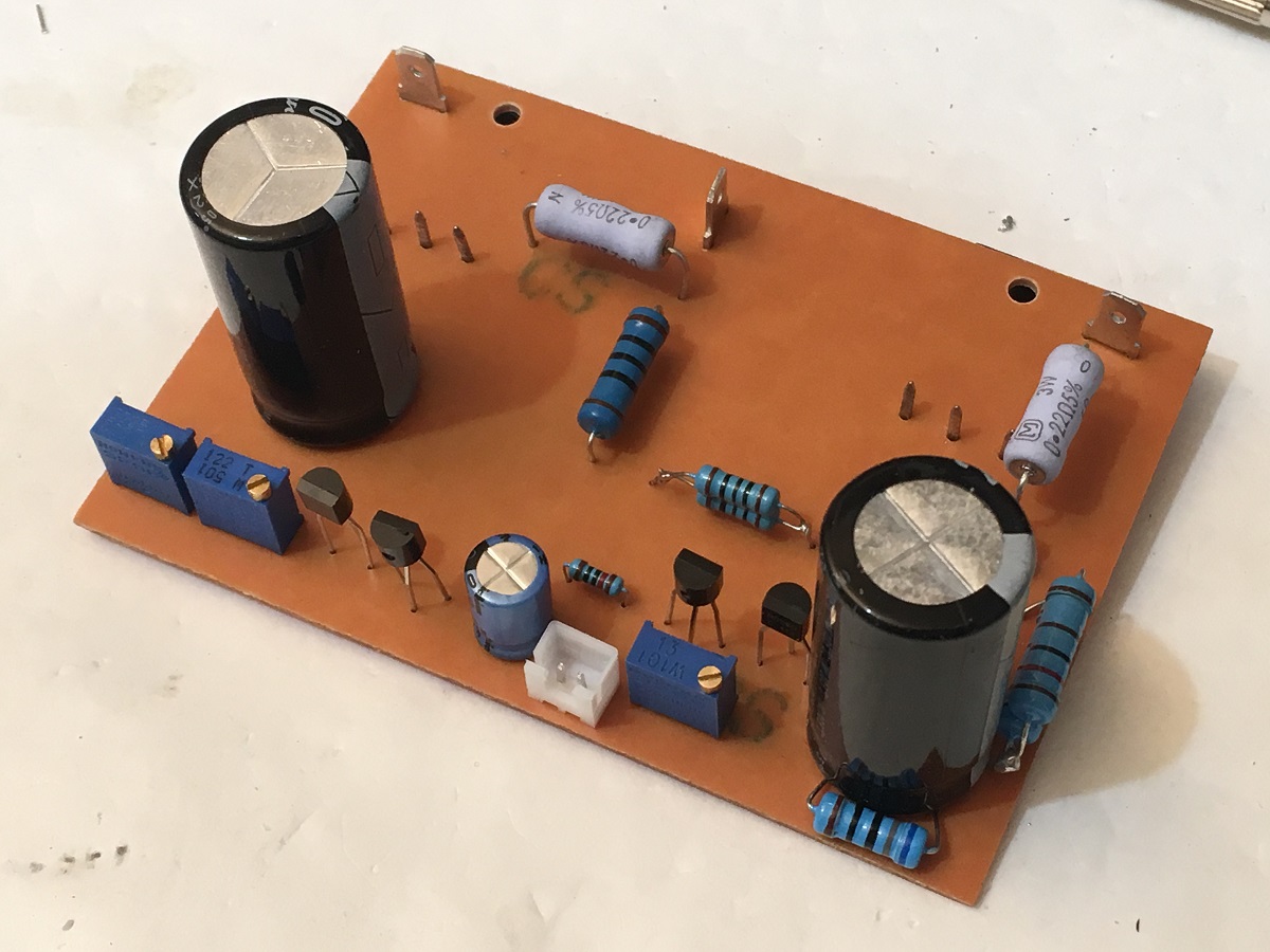

That’s actually something we considered. But in the end, we thought a novel SE Class A design would be more fun. Certainly, you can use the Aksa Lender to drive the wonderful Ranchu-Aksa Quasi amp. That amp is perhaps one of my favorite 50w Class AB amps ever. It’s well documented and proven and highly highly recommended if you haven’t made it before.
My build of Ranchu-Aksa Quasi:
574961d1476621763-very-simple-quasi-complimentary-mosfet-amplifier-dacz-quasi-completed-stereo.jpg

The new Class A amp that I am building above (code named the ALA amp), if using appropriate high dissipation MOSFETs capable of 80w ea and a +/-35v supply will get 53w (unclipped 0.043%THD) into 8ohms in pure Class A. Quite a formidable output with low distortion but the cooling requirements are probably way above what most heatsinks on typical DIY builds can handle. Unless you go fan cooling route (one of the above heatsinks per output so x4 for a full stereo amp).
