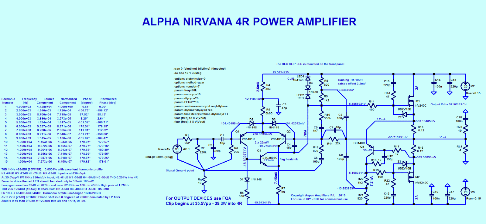

My initial idea was 25 watts at 4 Ohms -> 50 watts at 8 Ohms. With an efficiency a little lower than 43% after the modifications, about 40% -> 125 watts. Maybe up to 150 watts.
In the main room, where I have the Big speakers, 3-ways, 91 dB (with very strange configuration of speakers, crossover and... kidnapped), I could with 240 watts and more but in that small room it is still excessive if it is working more than an hour.
smps power bricks have such high efficiencies, better than linears and quieter too based on my experience...
50 watts into 4 ohms and 25 watts into 8 ohms can only be possible with a very stiff psu, and smps power bricks are one such psu...
the mark levinson ML2 is 25 watts into 8 ohms....and very heavy and the standard by which i look at other class A amps with, anything less than this and i grow skeptical....can you blame me?
What are you looking for in comparison to the Mark Levinson that makes you skeptical? It has oversized passive radiators and probably runs quite cool for a 25w Class A. Most of the DIYA 25w Class A amps work fine with a 4U x 300mm x 40mm deep fin chassis. I have used 24v SMPS on a Class A too. Works quite well. Regarding “stiffness” of Class A PSU’s. They run a continuous load of the same current flow. Stiffness or as I interpret that as low impedance PSU is more important for Class AB where the current demand varies drastically with the music is more important.

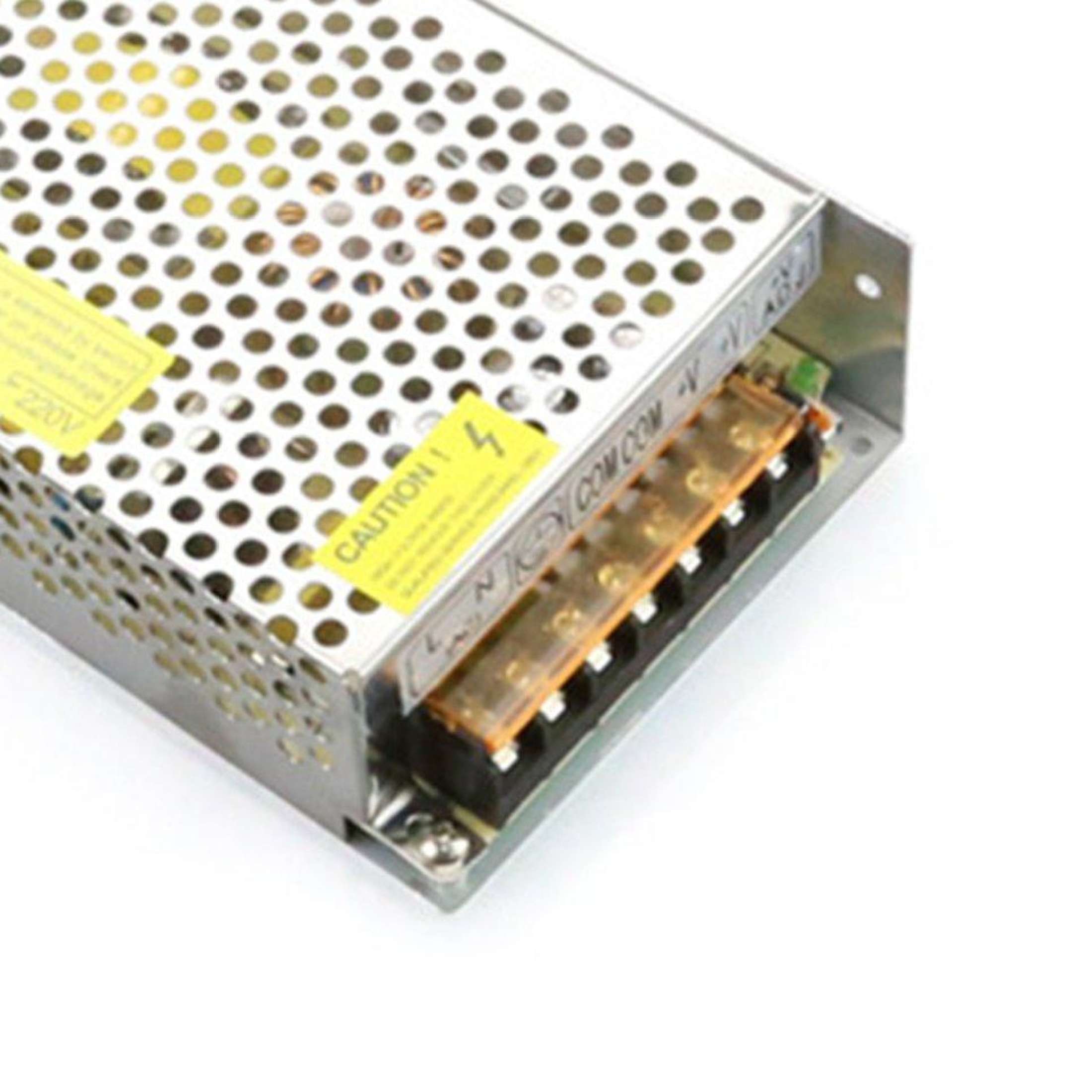

Smps do not readily come as +/_. Making them symetrical requires some trickery, sometimes it refuses to budge and goes into protection. I experimented with this while back (there is a thread about it).
Some cheap 5A 24v SMPS have fake (unconnected earth ground) even though it’s an 3 prong EIC. This means that the negative is floating and you can connect two in series for a handy +/-24v 5A Class A PSU. I did it on an M2 experiment a few years ago.
I used something like this a few years ago. These might be true grounded now as they are supposedly UL certified.
SUPERNIGHT Power Adapter, Transformers, Power Supply for LED Strip, Output 24V DC, 5A Max, 120 Watt Max, UL Listed (Output 24V DC, 5A) https://www.amazon.com/dp/B00LUIKY4S/ref=cm_sw_r_cp_api_i_pLz8DbVVZ9MN9
for safety reasons, the primary side of any smps is isolated from its secondary that provided the dc outputs...
Would a +/-24v SMPS like this do the job?

My one experience with a compact switch mode PSU like this (actually a $150 Connexelectronic 800w unit that looks very similar) showed a lot of noise in the high frequency audio range (hiss) that could not be suppressed. When I changed to a generic stainless steel cased box with screw terminal block high power LED PSU from China, the noise was absent. In fact it was astoundingly good. The amp went from hissy to absolute silence. This was an 800w 48v (adjustable to 51v) smps that I used for a Class D amp. I would imagine two of these in series could make anfine dual rail solution. However, internally the earth protective ground is tied to the -ve (0v) output. This would have to be modified (at one’s own risk) to allow dual rail series connection.
One other mod was that I was using at 1/4th rated power similar to TonyTecson, so I disconnected the noisy internal cooling fan on the PSU. Not needed for such low powers as the chassis aluminum block was sufficient.

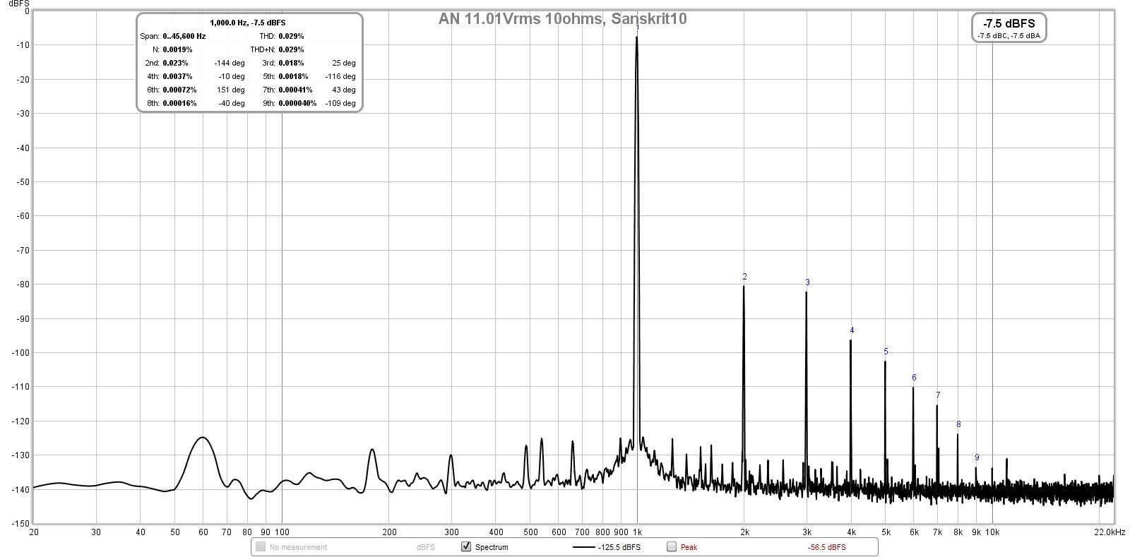

I just got a new desktop DAC hat uses the AK4490. It is the SMSL Sanskrit 10 - under $100 and has DSD capability and 2Vrms output drive. It needs an external USB power supply to work at its best (just the PC USB cable is sub-optimal). It claims 0.0005%THD which has been independently verified elsewhere.

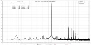

Here is 11.01Vrms (12.1W) into 10ohms. It seems that the noise floor is a bit lower than with the Cayin N3.
I don't think you can run this from a phone. It is for PC/Mac only. There are detailed measurements here showing 6Vpp (2.12vrms) output and distortion:
Review and Measurements of SMSL Sanskrit 10th DAC | Page 2 | Audio Science Review (ASR) Forum
I did not measure output on and O-scope myself but did measure the output of my amp, and this DAC can definitely drive it to clipping levels - more powerful than my Focusrite DAC.
- Alpha Nirvana 39w 8ohm Class A Amp
